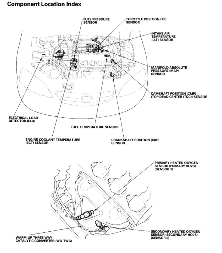

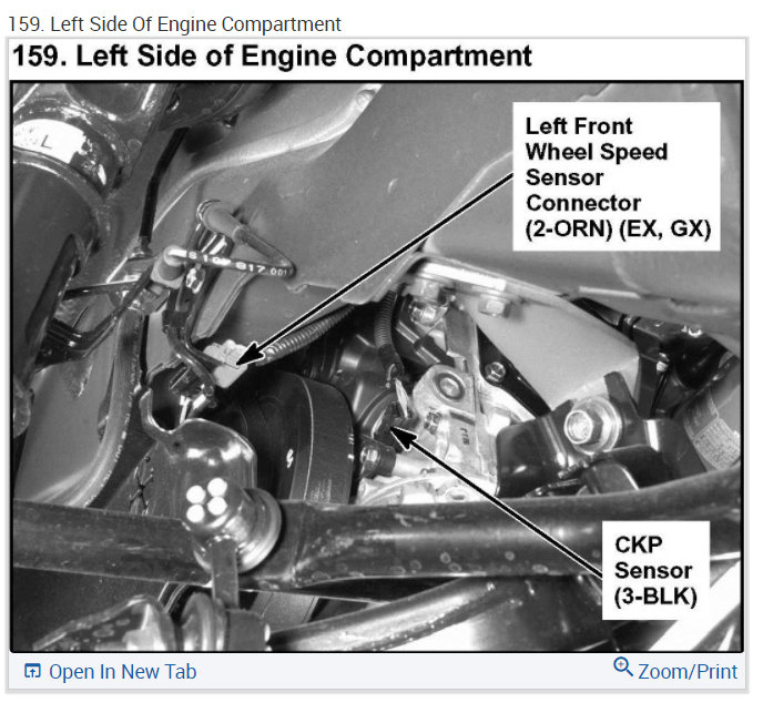

stopped at the store shut the car off came out started drove about 300 feet and it stalled out. Is there an adapter that I can get for my laptop to read codes with?
Apr 1, 2016 at 7:47 AM
HMAC300
  • 48,601 POSTS
9 times out of 10 it will be the crankshaft angle sensor. Here is a guide to help test for spark and the location of the crankshaft sensor in the diagrams below.

Thank you. I did some more looking and found that the FI/ECU fuse was blew out so i put another one in it started for a second and it blew again. I changed the negative battery cable. But it was not a Honda cable I know the Honda cable has a extra connector that bolts to the body. So I got the correct cable witht he body ground and that fixed it thank you for the help though.

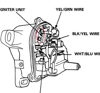

I have a 2000 Honda Civic LX, and the car turns over fine, but it will not start. I checked to see if there is spark, and there is no spark. Now, people told me it could be either the coil or the ignition control module. If it is the ignition control module, how do I replace it? The cam seems to be in the way of the screws to the ICM. Any help would be great!
Nov 2, 2020 at 5:24 AM (Merged)
F4I_GUY
  • 3,302 POSTS
To remove the ICM, you remove all the female connectors going to it. And there will either be two philip head screws that fastener the ICM to the top of the distributor housing, or there will can be 8mm fasteners that bolt up from the outside of the housing.
Once the fasteners are removed, pull the ICM up and straight out. Keep in mind you must remove the rotor to access the ICM

Can you post a picture of your distributor? Honda uses two different distributors and it'll be hard for me to find a picture of both and circle which screws are which.
But trust me, they reluctor wheel shaft is not in the way. Are there screws or bolts fastening the ICM from the outside?
F4I_GUY
  • 3,302 POSTS
https://images.2carpros.com/forum/automotive_pictures/276698_ignitor_removal_1.jpg
This is what it should look like. I highlighted the screws in red
