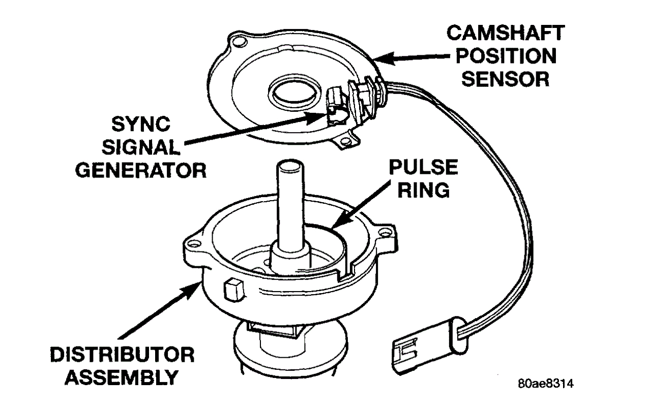

As far as no spark, did you use the original distributor or the one that came with the replacement engine? I ask because there is a pick-up coil in the distributor that functions as a camshaft position sensor. If it is bad, you won't get spark. (See pic 1)

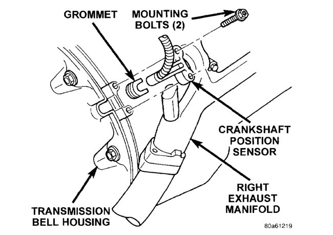

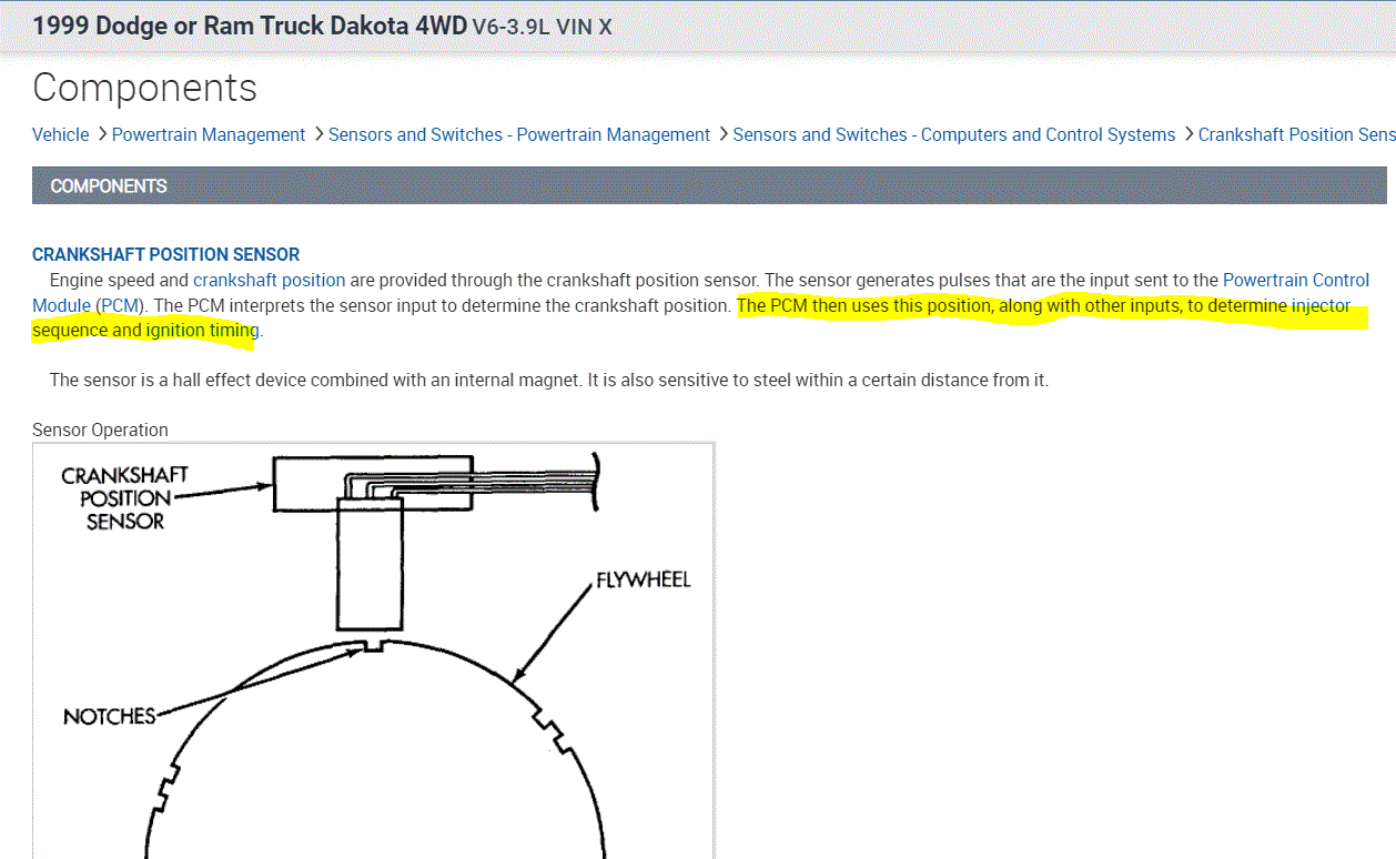

Next, is the crankshaft position sensor good or has it been replaced? See pic 2

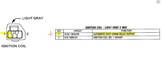

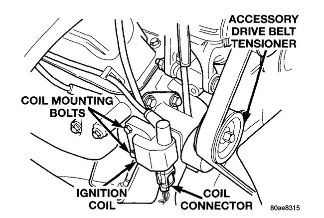

Last, are you getting power to the ignition coil? With the key on, there should be power to the dark green wire with an orange tracer. Check that as well. See pics 3 and 4.

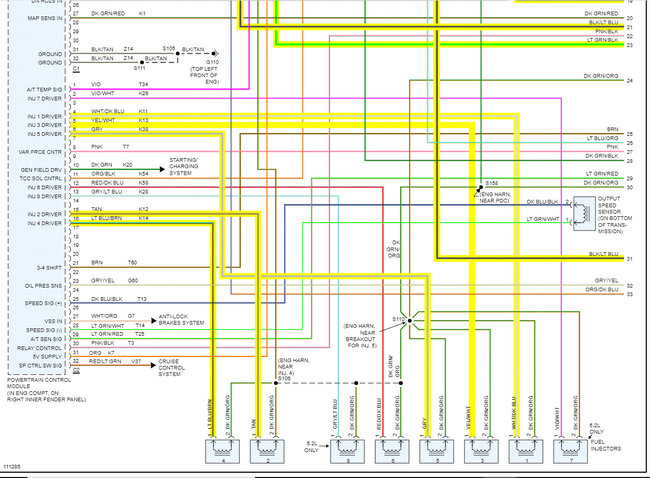

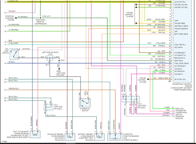

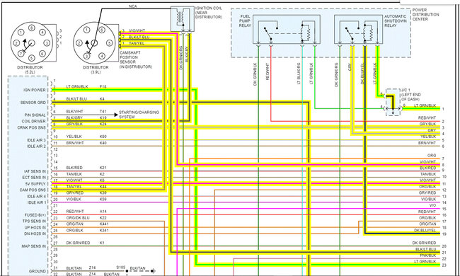

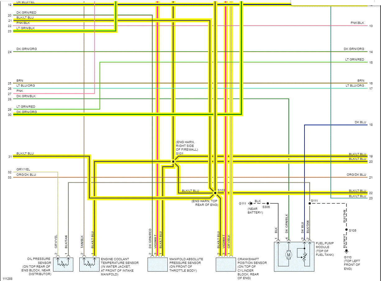

First, please bear with me because I don't know for sure what all has been done.

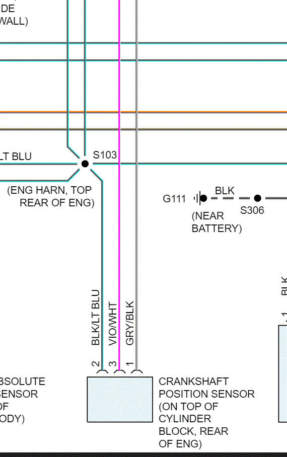

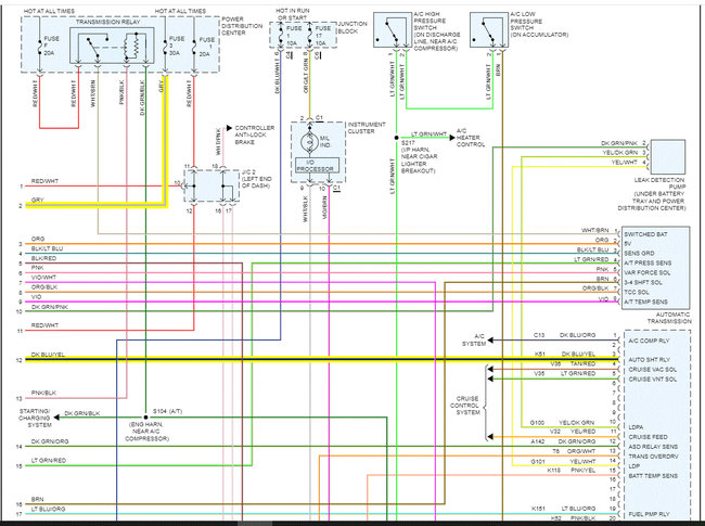

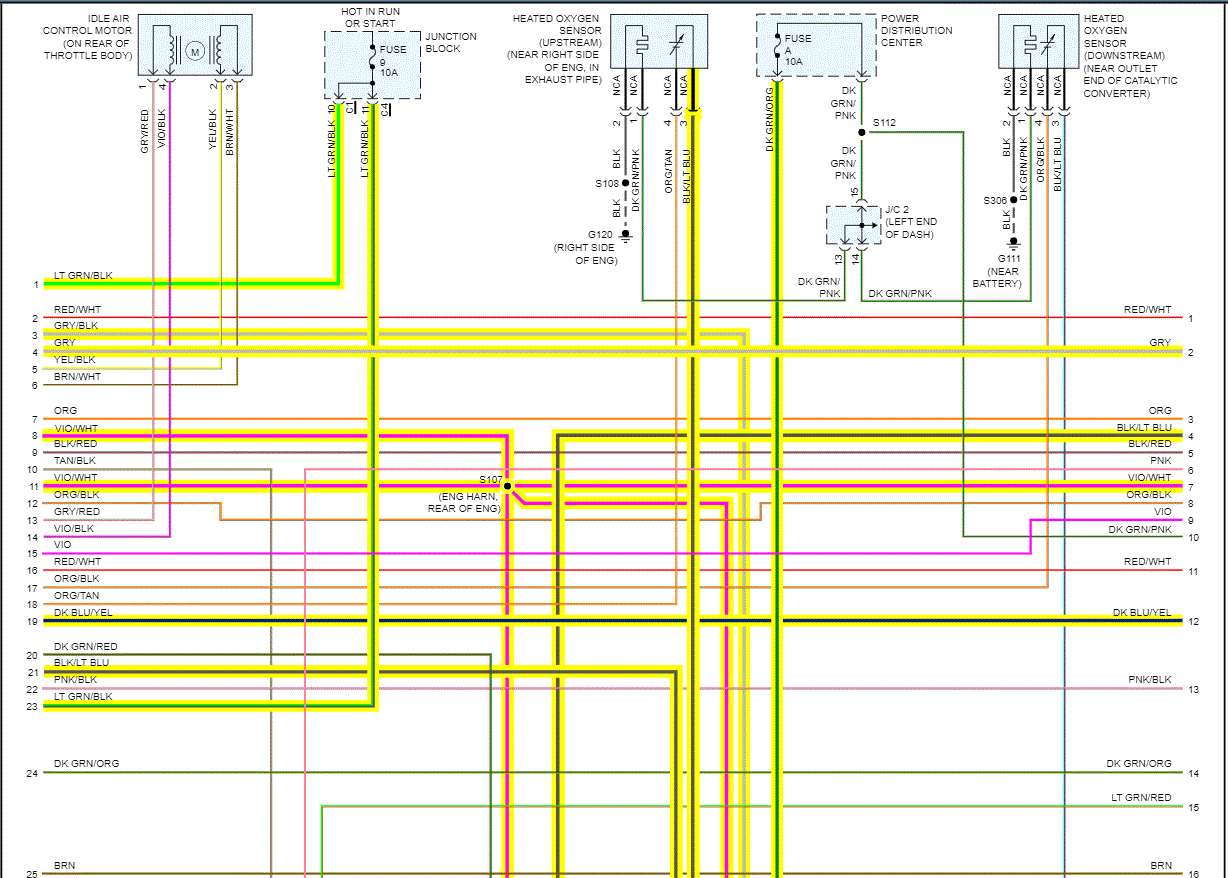

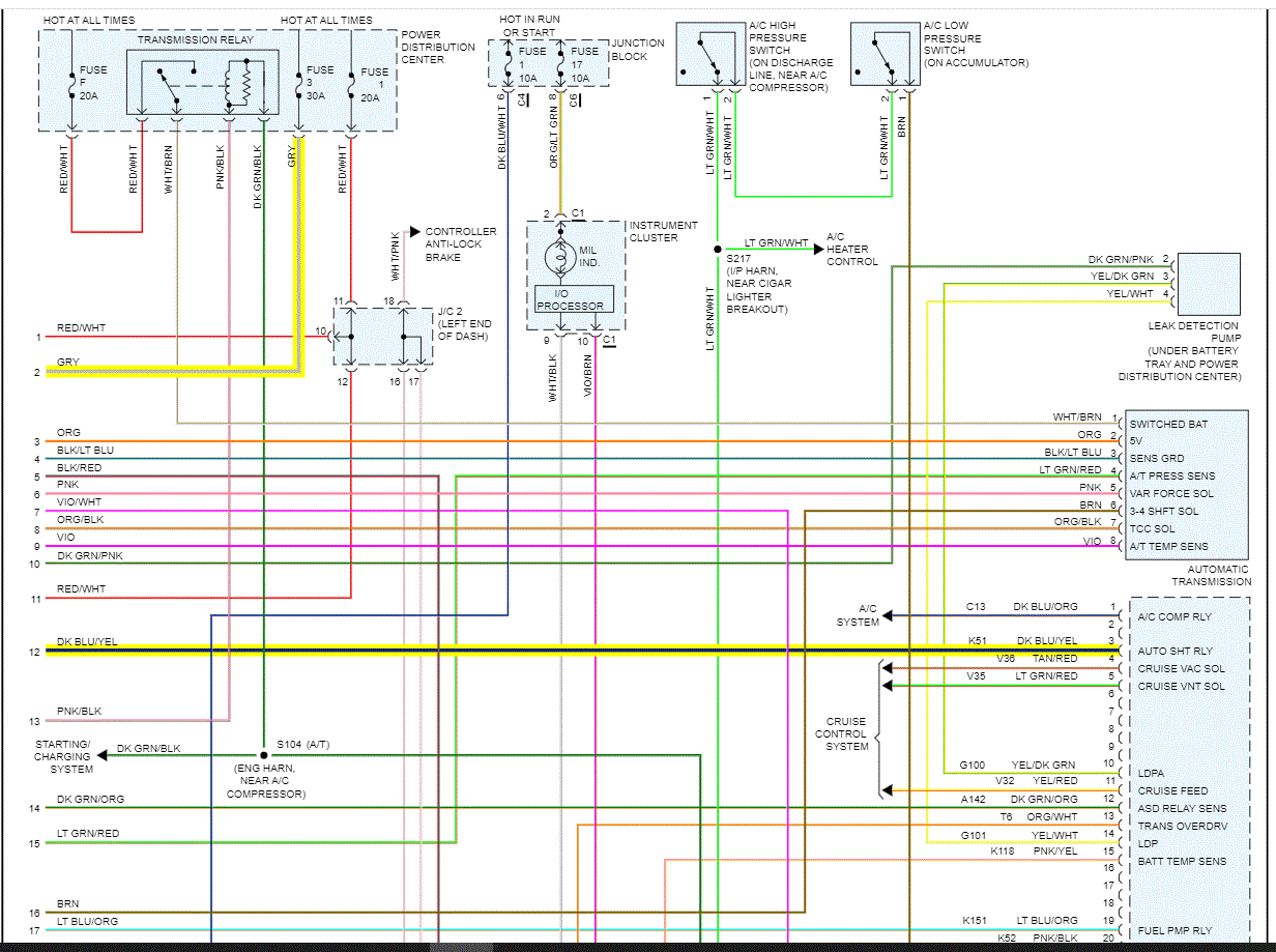

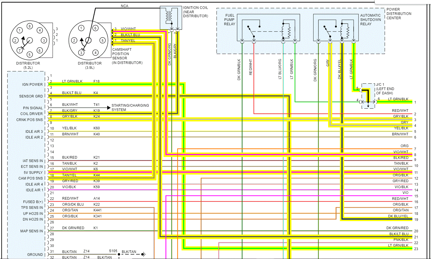

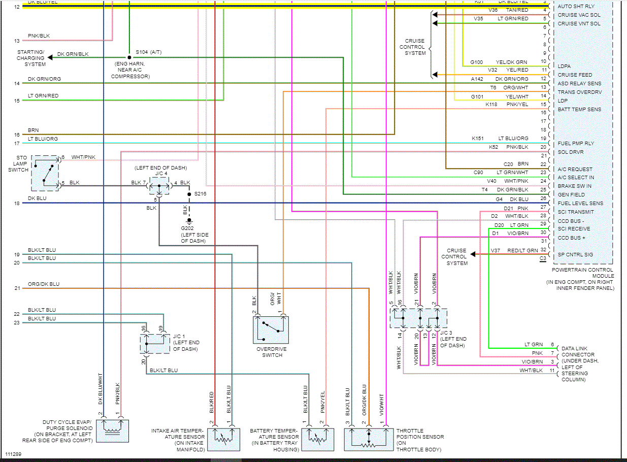

First, I attached the powertrain management wiring schematics below. First, I highlighted everything related to the ignition. Then, I un-highlighted the things you checked.
Here is what I am left with. You have a 5v reference at the CKP. You have ground. Do you have a signal to the PCM from the CKP (pin 8 gray wire / black tracer)?
At the ASD, the light green with a black tracer should have voltage once the key is on. If comes from fuse 9 in the junction box and goes to the ASD and PCM pin 1.
The Dark blue with a yellow tracer provides ground via the ASD pin on PCM (pin 3). Does that wire provide a ground path with the key on?
The gray wire at the ASD gets power from fuse 3 in the under-hood fuse box. Is the fuse good and does that wire have voltage with the key on? If you look through the schematics, note that fuse 3 has a large splice where power can be lost.
If you have no signal from the CKP and it does have the 5v ref and ground, the sensor is bad or the violet wire with a white tracer is open.
If you have no RPM signal, it really sounds like the issue is coming from the CKP. You indicated no signal at the PCM from the CKP which would make sense that the violet wire/white tracer is open or not making a good connection between the CKP and PCM.
There is a good chance you have already checked these things. I just want to make sure we are looking at it from the same point of view.
Let me know what you find or if you have already done this. Also, if you find no power from the fuses, confirm the fuse is good but also check to make sure there is power to and from the fuse.
See pics below/Note: I had to cut each page in half to make them readable for you. I did overlap them so you can follow from one to the next.

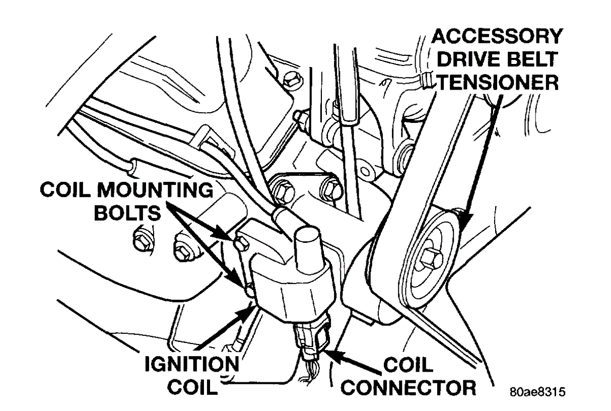

  • 110,241 POSTS

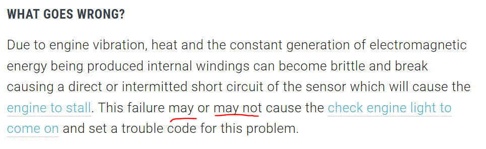

The funny thing about a crank sensor is it can fail and not set a code. LOL Anything to make it more difficult.
Take a look at the pic below. Also, before you jump into a lot of testing, make sure power is where it needs to be.
Also, you indicated you don't know what you're doing. Based on your first post, I find that hard to believe. You are on the right track. Hang in there. We'll figure it out.
Take care and let me know what you find.

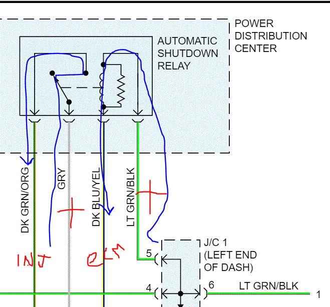

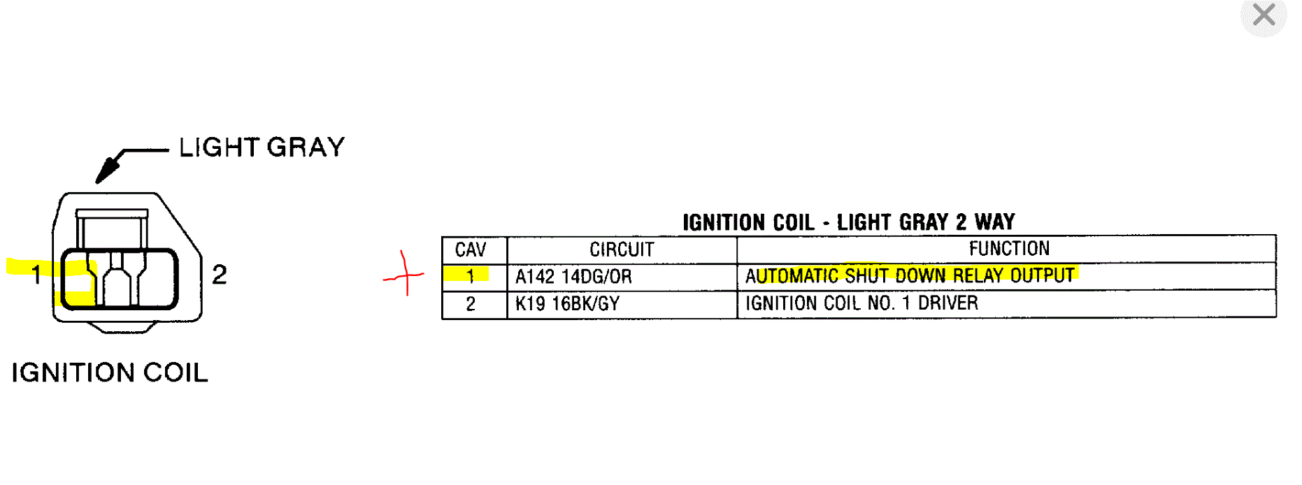

  • 110,241 POSTS

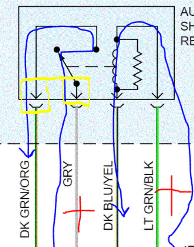

If the key is off, the only wire that should have power is the gray one. The light green wire with a black tracer will get power when the key is in the run or start position.
The dark blue with a yellow tracer gets a ground path from the ECM. If it is dim, there could be a corrosion issue in the connector at the PCM. The dark green with an orange tracer has nothing until the relay energizes. At that point, the switch in the relay closes and power runs from gray wire through the relay and out the dark green/black wire to the injectors and other components.
Is that what is happening? Take a look at pic 1 below. Sorry it's so poorly labeled. I placed a + on the power supplies to the ASD relay. The gray wire is always hot and receives a ground through the injectors. The light green gets power with the key on and finds ground through the ECM.
Let me know if that is what you find. Also, confirm the ground (dim light) isn't pushed in, corroded, or damaged in any way.
Jan 2, 2022 at 10:51 AM

With the key on, the light should have two power supplies turning it red, the gray wire and the light green/black wire. If that is the case and the dark blue/yellow receives ground to the ECM, that should cause the switch (relay) via electromagnetics to close and send power to the injectors. Again, if there is ground via the dk blue/yellow, power to the gray and power to the green wire/black tracer, the relay should close sending power out the dark green/orange wire to the injectors. Are you getting power to the injectors? If not and the wires mentioned are functioning properly, either the relay is bad, there is a bad connection at the relay, or the dark green/orange wire has an open circuit.
Since you are getting a dim green light for ECM ground, that is where the problem likely is located. Now, it could be a pin in the relay box, partially open wire, or the ECM itself.

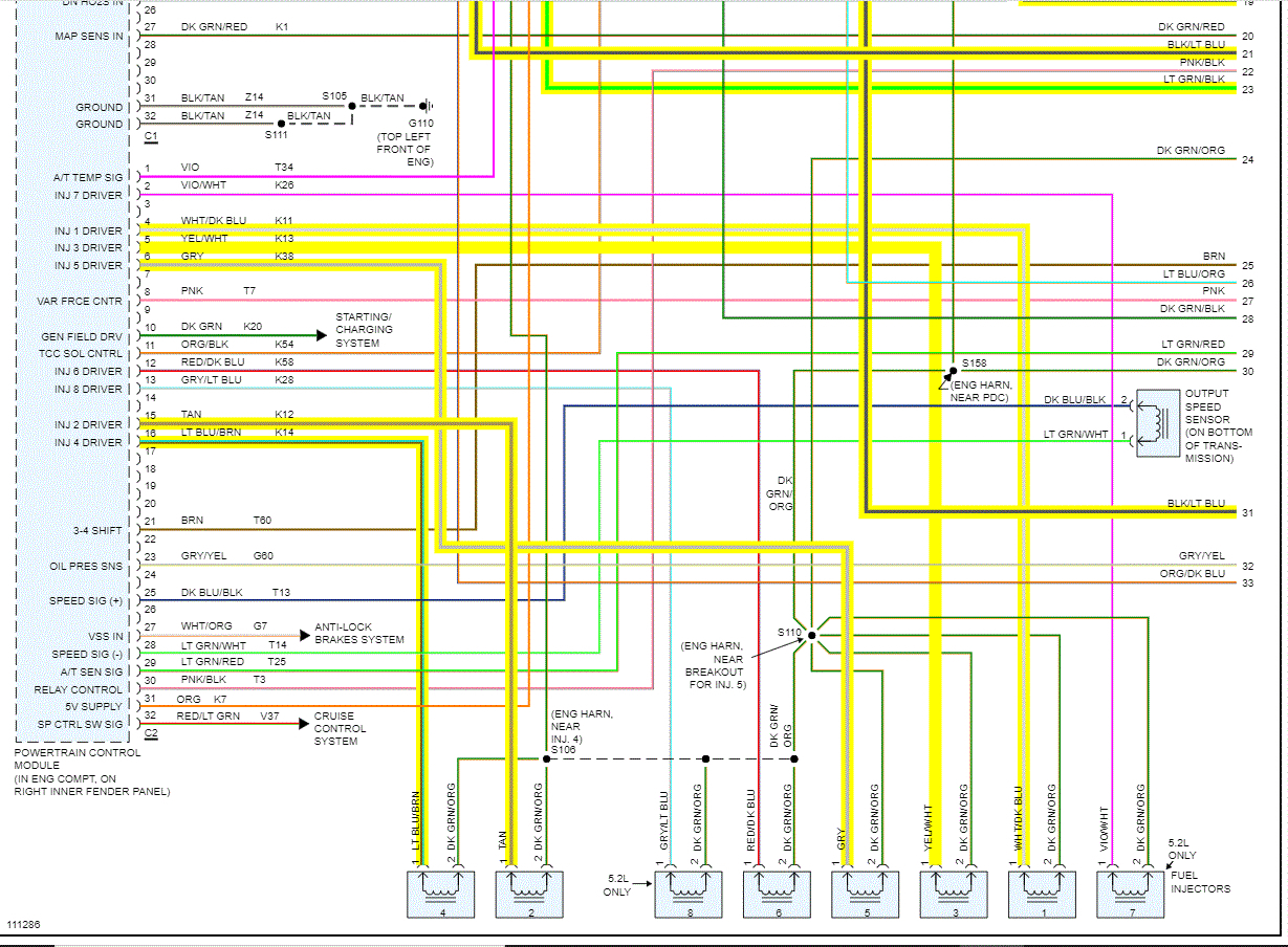

Try this. take a jumper wire and jump the two wires circled in yellow to see if the injectors get power.
Let me know what you find.

  • 110,241 POSTS

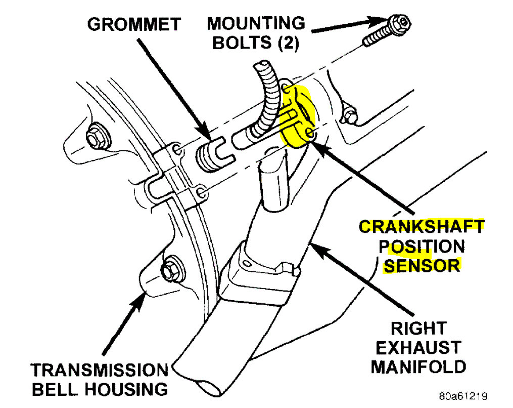

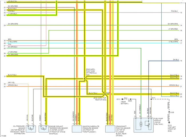

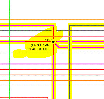

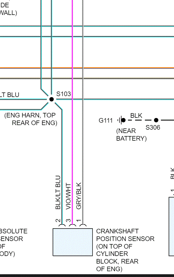

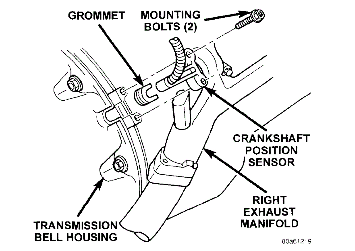

If you have power to both and no pulse, it is related to the crankshaft position sensor. See pic 1 below.
Here is how it works. The coil/inj has 12v at all times. They receive ground via the PCM based on CKP information (along with other things). If you have no pulse, the PCM isn't providing the ground path. So, either all the ground leads to the PCM failed at the same time, the PCM failed, there is no connection between the PCM and the injectors, or there is something missing to create the pulse.
When you replaced the CKP, where did you purchase it from? Was the connector and wiring to it good? It's near the exhaust manifold, so the heat can cause wiring problems.
Here is what I need you to do. Go back to the crankshaft position sensor. Unplug it and locate the violet wire with a white tracer. With the key on, there should be a 5v reference. If there isn't, next we need to locate a splice. It is a splice (S107) in the engine harness, rear of the engine. If there is no power to the sensor, there is a good chance that the splice (which is known to corrode and fail) was damaged when the engine was removed and replaced.
You will need to open up the harness to locate it. Locate the violet/white wire in that harness and follow it to the splice. Inspect it for corrosion, damage, loose wires, and anything that can prevent a good connection. If it appears good, check at that point for the 5-volt reference.
If you do originally find a 5v reference at the sensor, test the black wire with a light blue tracer at the same connector for a signal ground, key on. If you don't have ground, in the same wiring harness there is a splice (S103). Do the same thing. Open the harness, locate the black/lt blue wire and check it at that point for signal ground. Again, the key must be on.
Once you get to that point, let me know.
If both wires check good, let me know. Also, let me know where you purchased the CKP. I have seen so many faulty parts being sold.
Pic 2 below shows CKP, Pic 3 shows power splice, pic 4 shows signal ground splice.
