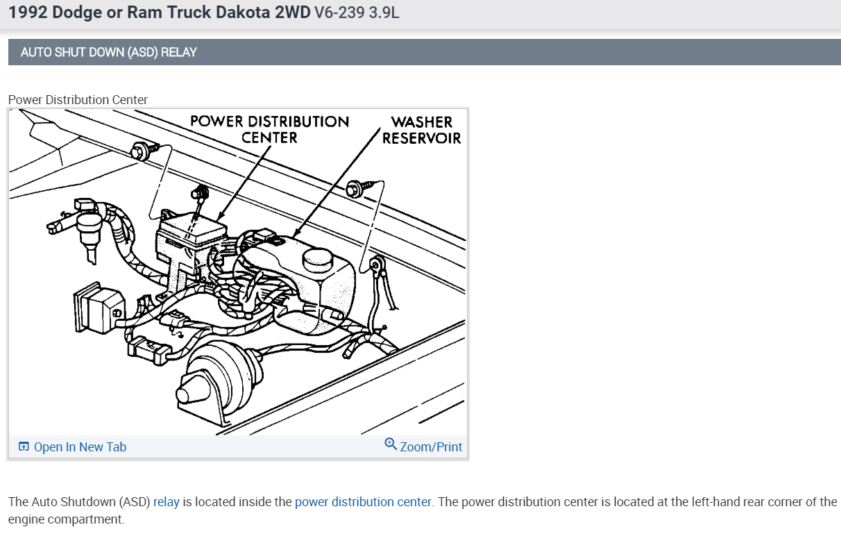

truck won't start because their is no spark to coil. no spark to the crank angle sensor. that was changed and still no spark to the coil.
Apr 24, 2010 at 6:24 AM
BMRFIXIT
  • 19,053 POSTS
Check fuses Locate and check or replace ASD relay Check if have power to coil when key on and engine cranking If so check and suspect coil. Here is a guide to help check the ASD and the location of the relay.
Apr 24, 2010 at 10:58 AM
LOISSHANNON
crankcase sensor was changed, still no spark to coil through computer (original) replaced computer with one from salvage yard still no spark to coil tried computer different year and got spark won't start! Then got a new ASD started right up! I love this site.

Ok took cover off of entire harness from pcm to pdc discovered the garage we paid to install a new wiring harness used one from a diffrent year and had to splice all the sensor connections with the ones from the old harness the factory splices you mentioned were found i found about 6 total within 3 feet from the pcm. all factory splices are perfect. However the masses of tape the garage used to retape after there splices was full of chalky yelowish green powder i think it is wire corrosion in fact i almost know it is but it was all through the tape does this happen? i havent had a chance to check these makeshift splices the garage made. i ran out of daylight so guess thats for tommorow.Also the part of harness that is split by a big plug and runs down to crank sensor and back along the transsmision to the vss and heated o2 sensors all the wires that rest on the back of the engine head are stuck together not melted there just all fused together do you know if they used an adhesive on the wires? im surprised that i the crank and cam sensors circuit are still good despite the mess this harness is in. its killing me to know why the computer holds a constant ground on the coil. i know the coil circuit is good not shorted to ground.

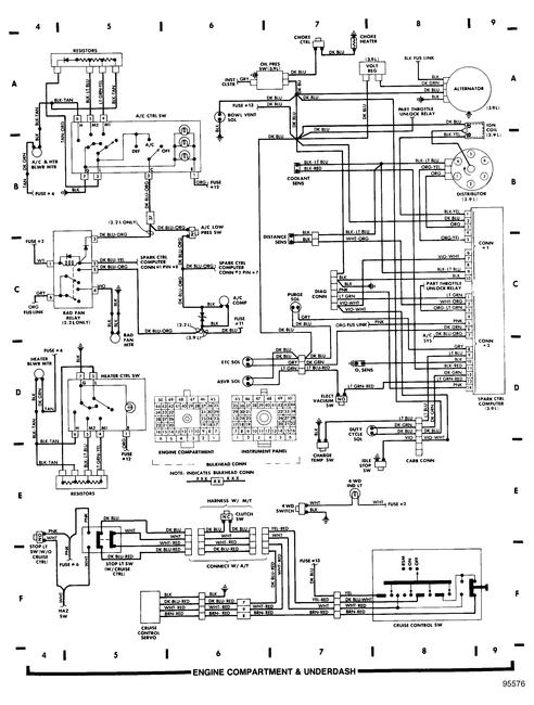

Where Does The Coil Get It's Current From ? I Can Not Get A Spark To The Distributor If The Coil Does Not Have Current From Where Ever It Comes From To Enable It To Be Able To Sent A Spark To The Distributor. So You See I Need To Know Where The Coil Gets It's Current From So I Can Check And See Why It Is Not Sending Any Current To The Coil So That It Can Send A Spark To The Distributor.

The coil is a transformer. It needs a 12v power supply and a pulsing reference signal to work. Use a noid light to test for correct signals arriving while cranking.

It's powered off the voltage regulator on a dark blue wire. This also powers just about everything else in the engine compartment so I really doubt that supply is missing.

Since the coil gets it's power from the voltage regulator, would this mean that the voltage regulator controls the power flow from the alternator (right) if this is true, then it would seem to me that the truck would have to be running before it could send current to the coil. ( is this right ). If this is right, then this would explain why the coil has no current on it, since the truck is not running. And if this all is right then there would be no way for any fire to reach the distributor. Is all this right or not ? Just checking...would the spark computer have anything to do with anything ?
Jul 30, 2019 at 6:17 AM (Merged)
WRENCHTECH
  • 20,760 POSTS
Looking at the diagram again, that may be power going to the regulator, not from. Test both sides of fuse #13 with the key on using a test light.
