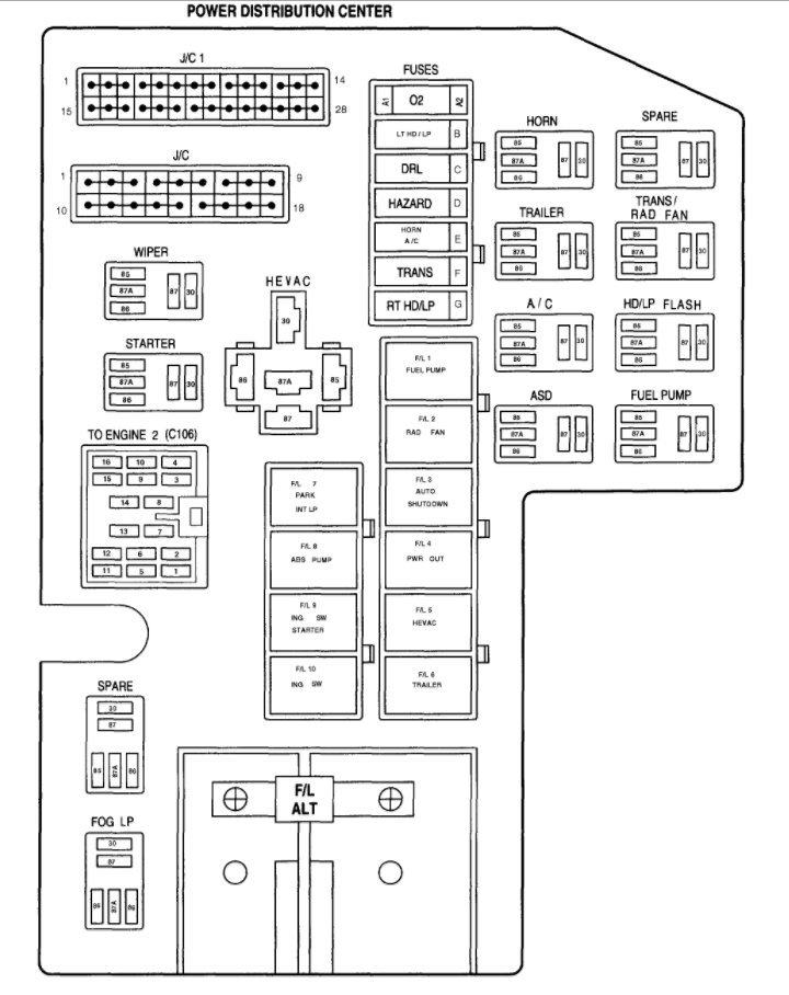

Hi guys. Check for voltage at the ignition coil primary "positive" wire, any injector, or either small wire on the back of the alternator. You should see twelve volts there for one second when you turn on the ignition switch and you might hear the fuel pump hum too for that one second. What is important is if that voltage comes back during cranking. If it does not, suspect the crankshaft position sensor just mentioned.
Code 42 is related to something shorted on the line coming from the automatic shutdown (ASD) relay that feeds the ignition coil, fuel pump, and injectors. The clue there would be there is no twelve volts to those items for that first one second when you turn on the ignition switch. That is best tested with a test light. Most digital voltmeters do not respond fast enough for you to see that voltage.
You might try swapping the ASD relay with a different one like it. They do not fail very often but you do not want to overlook something simple.

I have a 1999 Dodge Dakota v8 5.2 and I am having the same problem no spark. I can hear my fuel pump kick on and my PCM relay and I know my PCM is good because it has already been re-manufactured. I have replaced my coil pack, cam sensor, and my crank shaft sensor but my brother in-law put it on and he is lazy so I am wondering does your crankshaft sensor have to be hooked up a certain way because I have narrowed it back down to this been trying for the last two weeks its has to be the crankshaft sensor.
Jul 7, 2017 at 7:06 AM
  • 55,536 POSTS

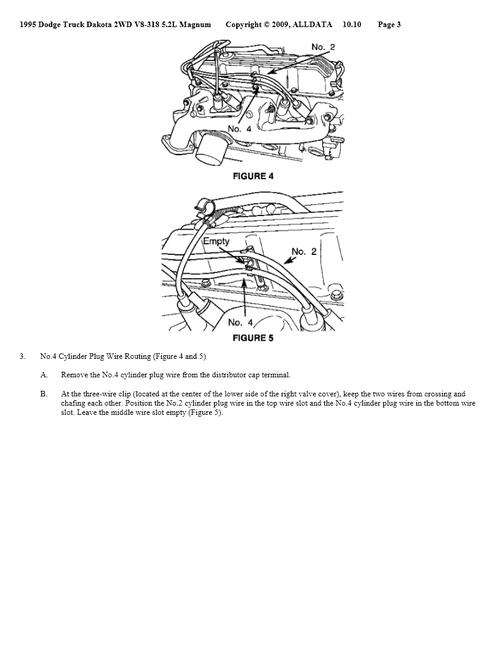

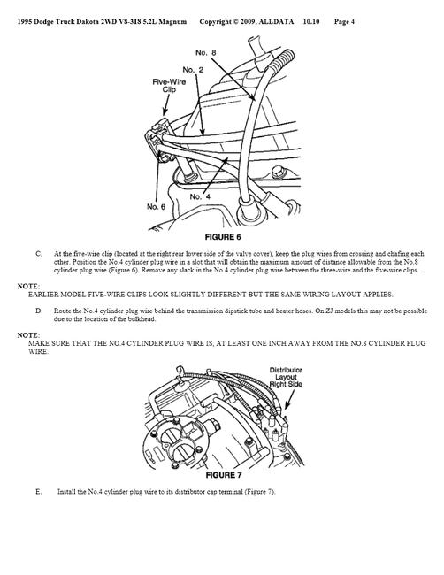

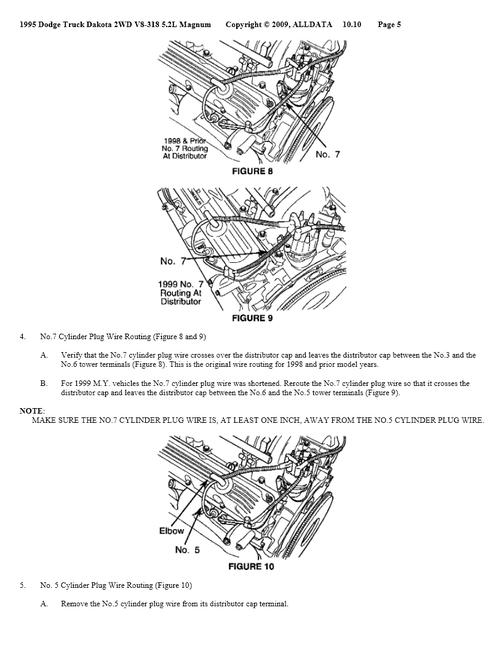

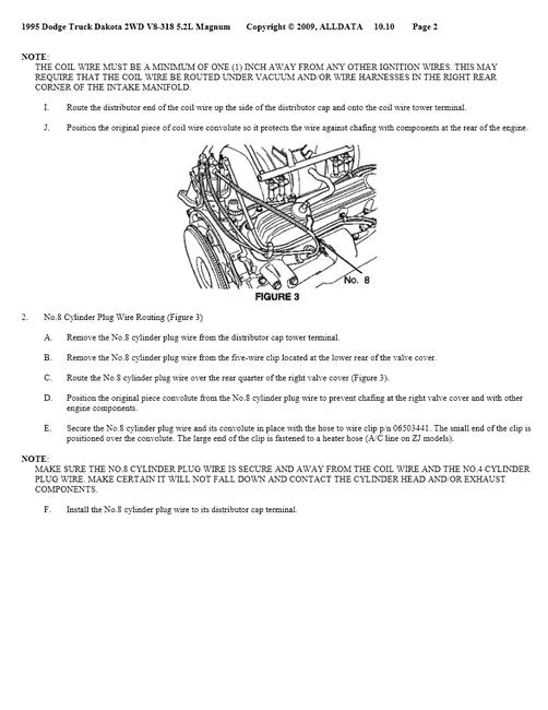

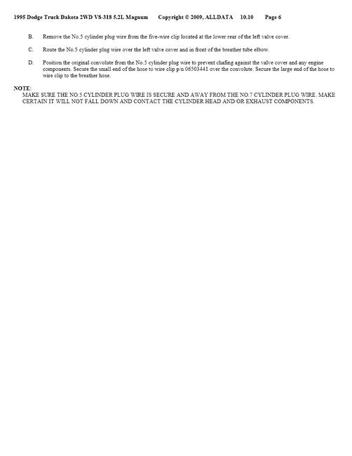

This ADS relay in these trucks had big problems.Here is a guide and a diagram (below) and a guide to help you confirm the relay failure:
and
Please run this test and get back to us we are interested to see what it is.
