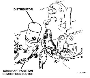

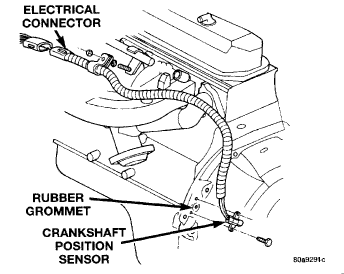

After replacing Distributor, pickup module, wires, cap, rotor and coil we still have no spark. Testing lead wires to coil with switch on shows no power to coil. Someone suggested checking the crankshaft sensor but we haver to this moment been unable to locate the darn thing. Any suggestions or direction would be greatly appreciated.
Monday, August 12th, 2019 AT 12:30 PM (Merged)
  • 75,992 POSTS
Inspect and test the camshaft and crankshaft position sensors.Location-see below:
https://www.2carpros.com/forum/automotive_pictures/12900_cmp_1.gif
The Camshaft Position (CMP) sensor is located in the distributor.
https://www.2carpros.com/forum/automotive_pictures/12900_ckp_1.gif
The Crankshaft Position (CKP) sensor is located near the outer edge of the flywheel (or starter ringear).
