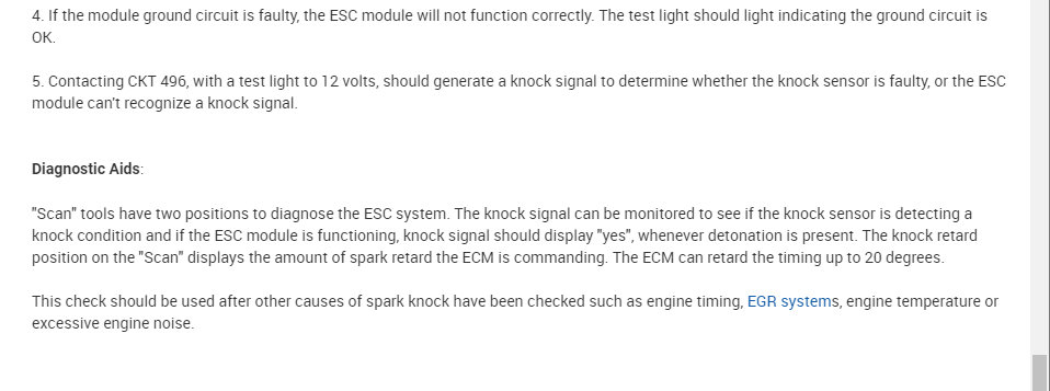

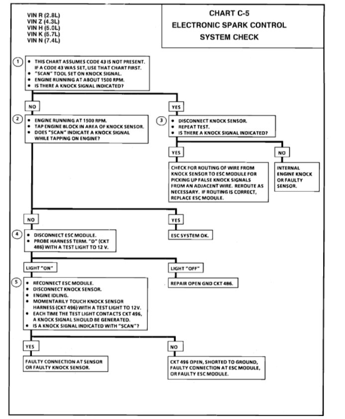

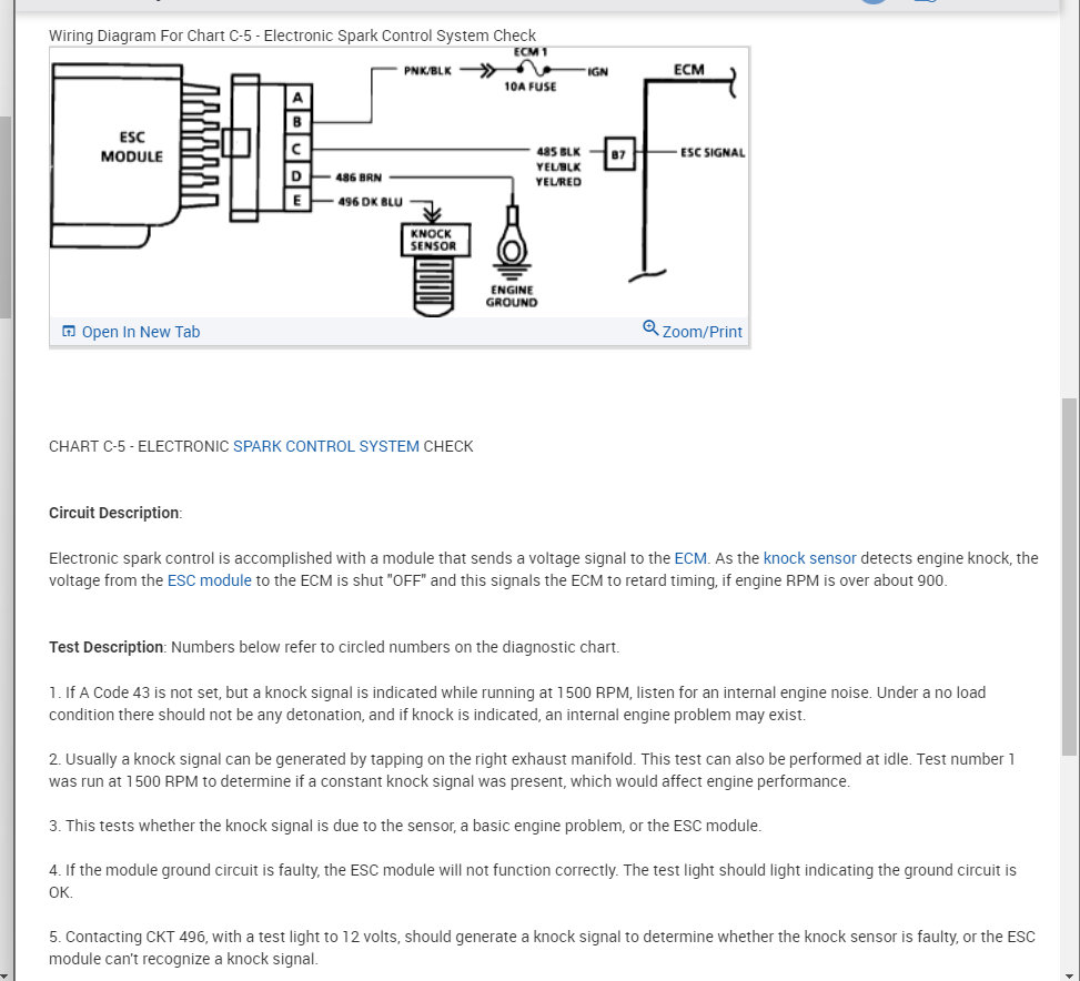

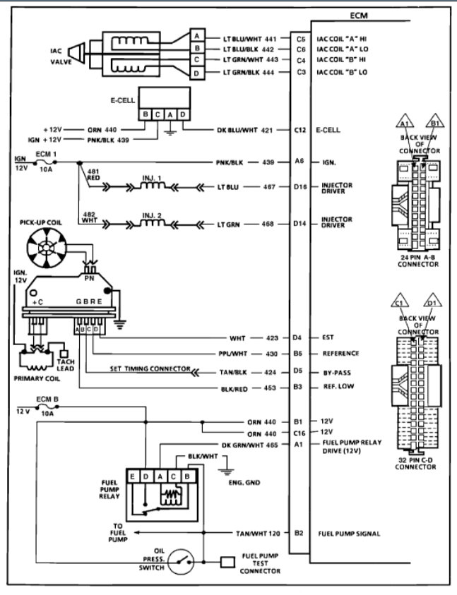

I am attaching the info below from the manual that will help with this testing.
Please run through this and let us know what you have done so far, and we can go from there.
