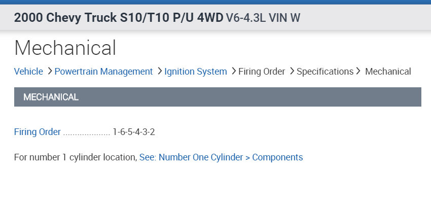

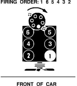

what is the firing order?
Sep 15, 2008 at 2:28 AM
OBXAUTOMEDIC
  • 3,711 POSTS
https://images.2carpros.com/forum/automotive_pictures/188069_00s10_43_1.jpg

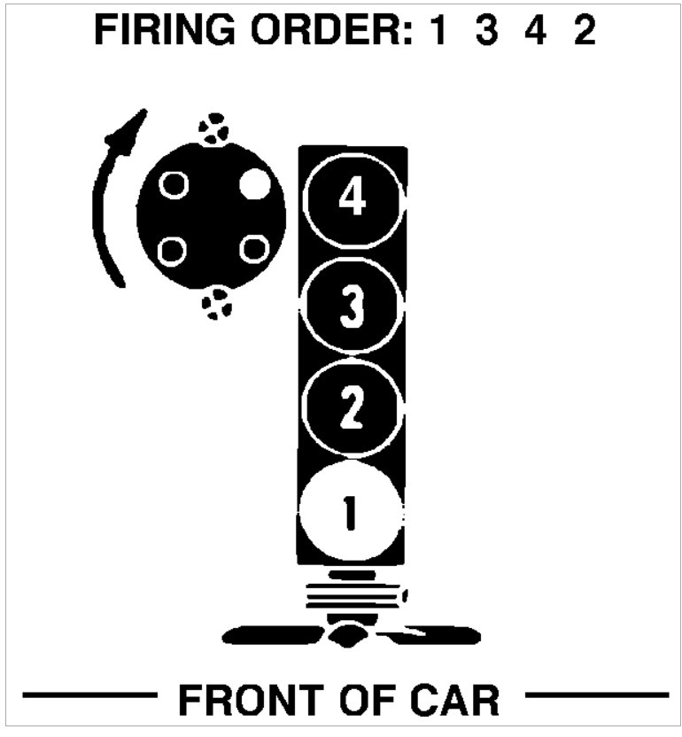

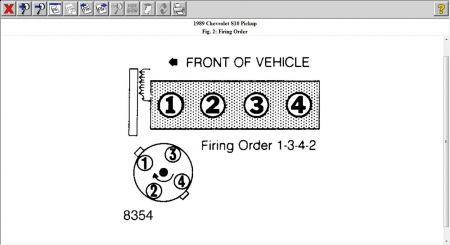

HENRY LEE
what is the firing order for s-10 2.2 4-cylinder pickup truck do it start from front or back
Dec 2, 2020 at 11:55 PM (Merged)
CHRIS1979
  • 7 POSTS
firing order is 1342 cylinder numbers start from front to rear 1 is in front
WRENCHTECH
  • 20,761 POSTS
https://images.2carpros.com/forum/automotive_pictures/561653_43_W_firing_order_94_1.jpg

MIKE H R
  • 3,094 POSTS
The firing order on a 2.2l is 1-3-4-2 and the cylinders are from front to back 1-2-3-4. the front being in the front of the engine

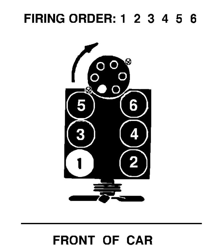

Hi, you have the 4.3L engine?
https://images.2carpros.com/forum/automotive_pictures/170934_S10_firing_order_1.jpg
2.8L is attached below

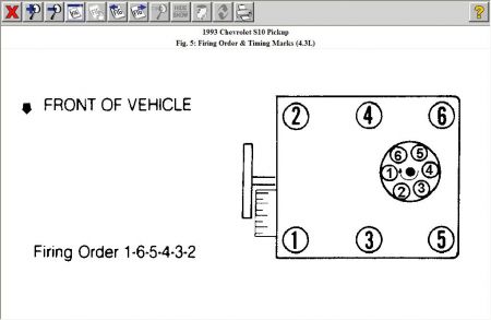

KEVINDEARP
i am trying to find a firing order diagram for the spark plug wires
Dec 2, 2020 at 11:56 PM (Merged)
  • 75,992 POSTS
See below
https://images.2carpros.com/forum/automotive_pictures/12900_fire_order_1.jpg
The four cylinder is below. Please let us know if you need anything else to get the problem fixed. Cheers

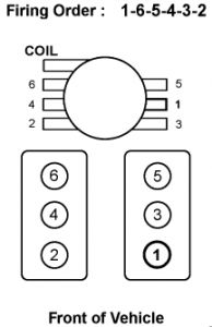

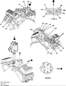

NOAHSDUDE
Electrical problem
1992 Chevy S-10 6 cyl Two Wheel Drive Automatic
wiring sequence from distributer to plugs
JDL
  • 16,098 POSTS
https://images.2carpros.com/forum/automotive_pictures/170934_chevy_s10_1_1.jpg
https://images.2carpros.com/forum/automotive_pictures/170934_checy_s10_2_1.jpg
I wasn't sure which engine you had, the picture came from autozone.

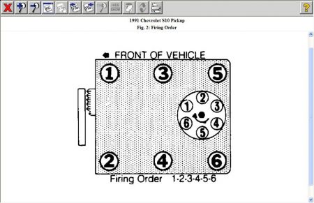

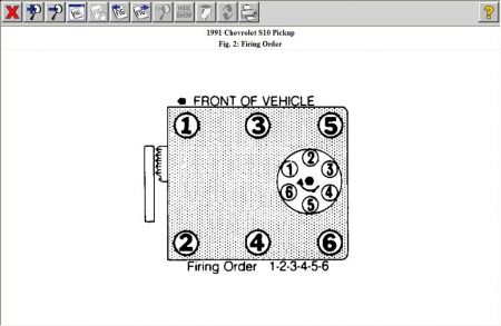

BJACK85
Engine Performance problem
1991 Chevy S-10 6 cyl Two Wheel Drive Manual
what is the firing order for a 91 chevy s10 with a 2.8 engine
  • 75,992 POSTS
https://images.2carpros.com/forum/automotive_pictures/12900_s10_2.jpg

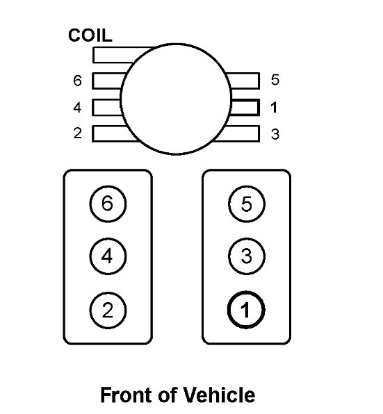

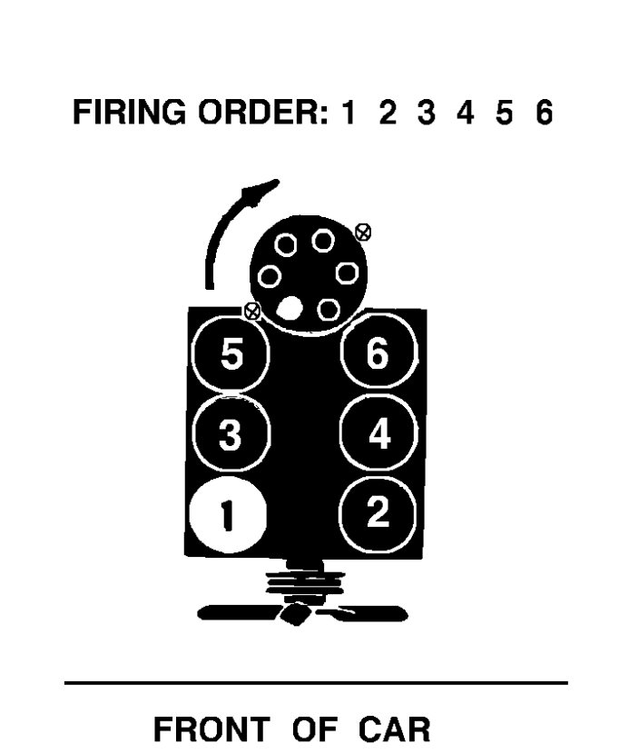

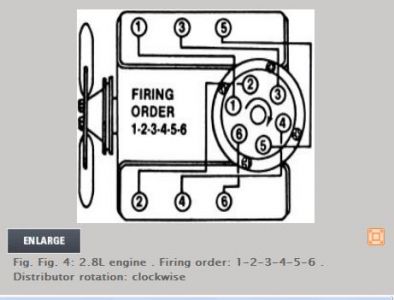

SPARKYTJ1
  • 12 POSTS
I replaced my spark plug and wires on my pickup and got distracted by my son and I think that I may have placed one of the wires in the wrong place on the distributor cap. Can you please give me a diagram showing me the firing order and how to tell which is which in the distributor cap itself.
  • 75,992 POSTS
https://images.2carpros.com/forum/automotive_pictures/12900_f_21.jpg

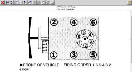

SCOTTDANNY22
  • 36 POSTS
When setting rotor to point to number one plug which side of rotor do you have face it the metal part that bends up to touch contacts in cap or the flat end?
Dec 2, 2020 at 11:57 PM (Merged)
  • 55,224 POSTS
You need to have the rotor end pointing toward the number one placement on the cap. Here is the firing order and number one cylinder placement so you ca get the truck fixed.

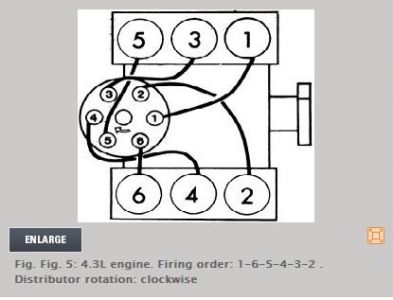

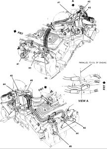

WILDFIREXPRESS2U
Hello I was wondering if someone could answer a question. I have a 1994 chevy S10 The wires we bought have 2 different style ends. One end looks like and elbow hook and the other is straight. Is there only a certain place for the straight end wire to go or does it matter? Any advice you could give me I would greatly appreciate.
Thank You
Gina
Feb 5, 2021 at 12:29 AM (Merged)

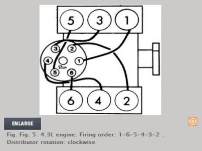

IMPALASS
  • 3,112 POSTS
Hello -Gina You did great on supplying most of the info for your vehicle. The only thing is to ensure you provide the exact liter size and the 8th digit of your VIN code. For this model I show a V6-262 4.3L VIN W CPI and a V6-262 4.3L VIN Z. I gave you both illustrations. On your model the straight end always goes on the spark plug. Make sure you put a dab of spark plug grease on the inside of the boot so it will slide smoothly over the plug and you should feel a slight snap when it connects onto the plug. The 90 degree end goes on the distributor. Do the same with the grease. Extremely important - if you don't have a chart or pic of the firing order then make sure you draw one. I have provided you with one. The best way to do this is look how the wires are routed across the engine, under and over certain things, clamp to certain things. If you don't route them correctly you can pinch them, cause cuts and breaks which then you will have sparks jumping around, they can fall into other moving items or get burned on hot items. Make sure on the distributor cap they are position correctly so they flow off of it nicely. Last since you have a diagram, pull one wire off at a time make a note of where it went and then match it to the exact length plug wire you are replacing it with. Then the next and so on. If you get out of order on the length you may end up with a longer wire on a shorter distance and a shorter wire on a longer distance and it won't fit.
