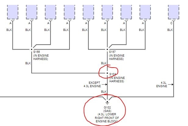

Next, I am seeing more and more a ground issue related to ignition spark loss. All of the coils have a common ground that is located on the driver's side of the engine about 3/4 of the way down toward the front of the engine. It should be a black wire that bolts to the side of the engine block. Make sure that is connected and not broken or damaged.

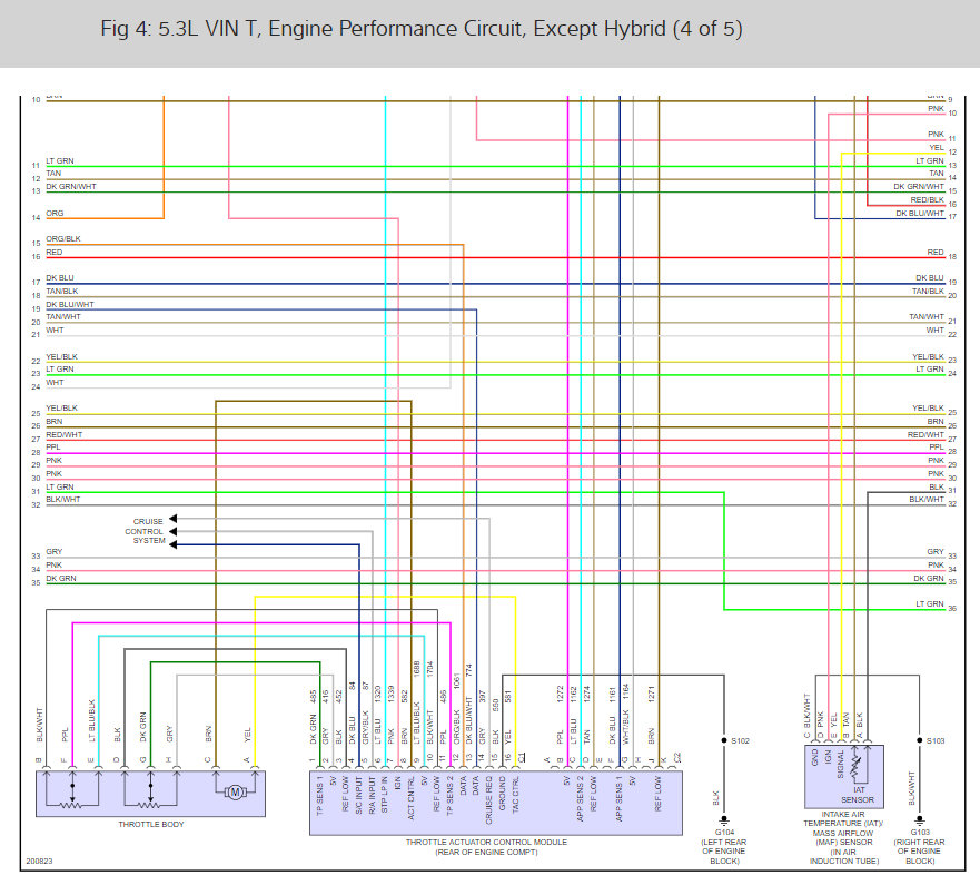

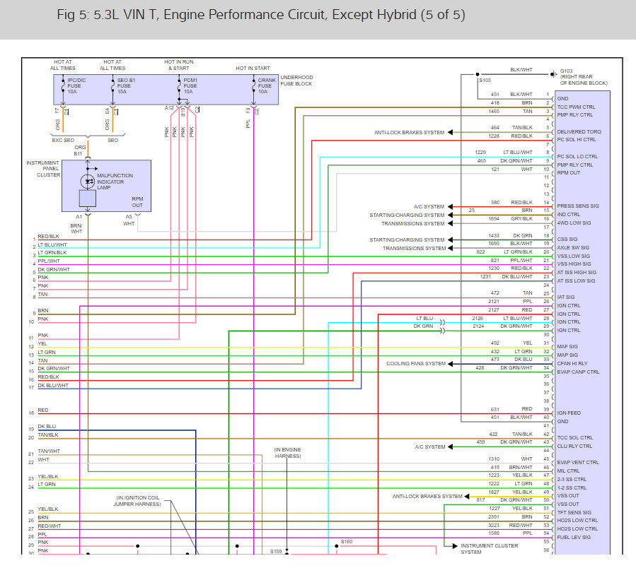

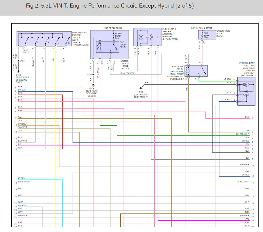

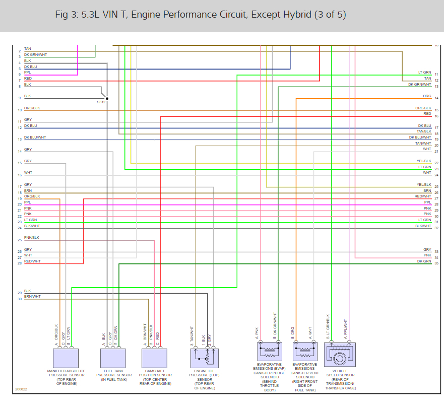

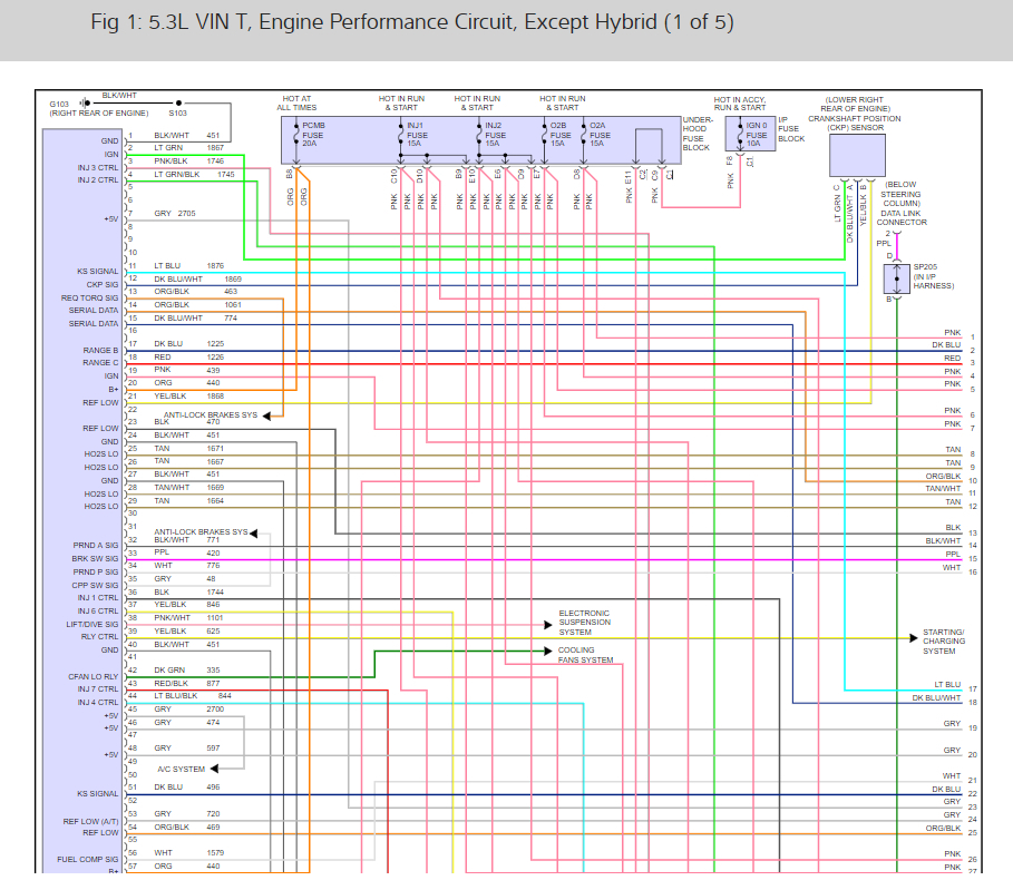

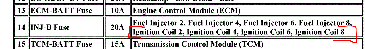

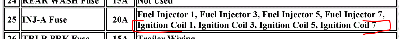

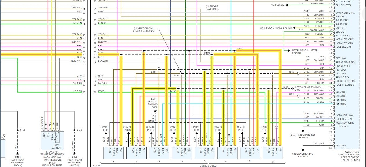

Good afternoon,

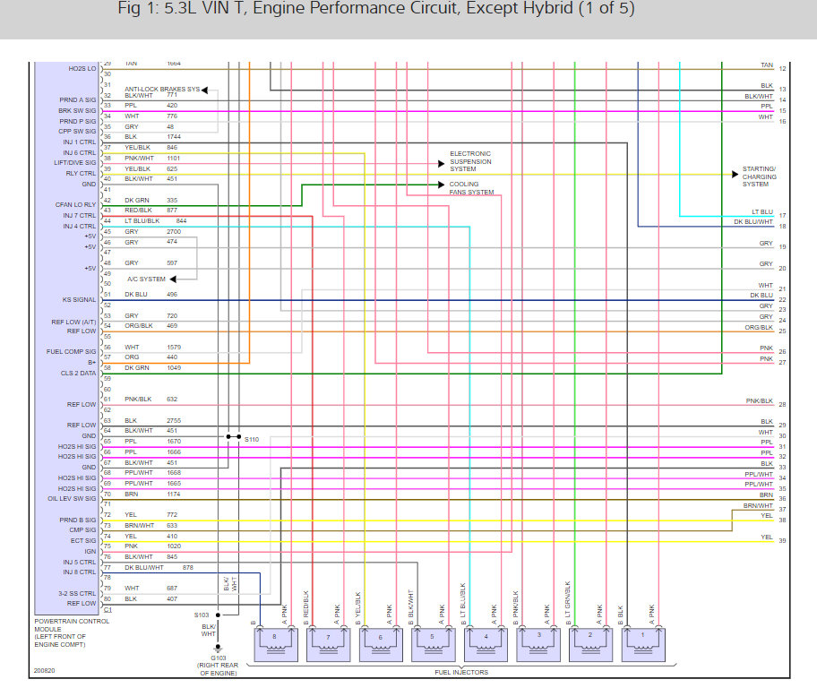

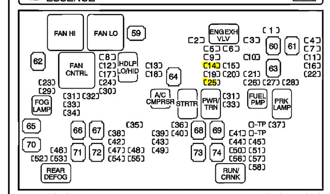

Did you verify voltage to the pink wires at the coils?
I attached the diagram for you and the location of the fuse to check for power.

What is the voltage? The ground is controlled by the ECM. How did you check that?

You cannot measure the other wires as they a pulse width modulated. You need to make sure the connections are good at the ECM. You may have a failed ECM.

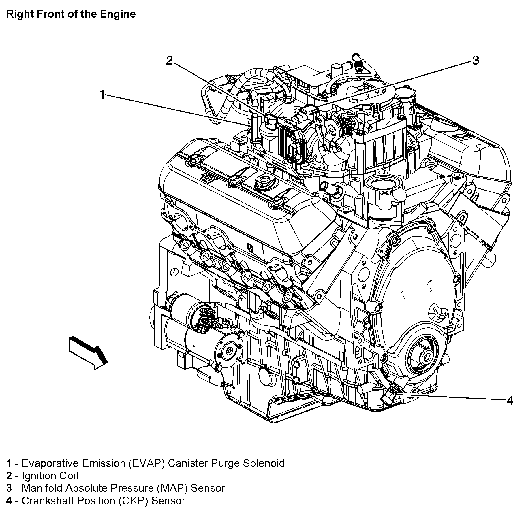

  • 110,240 POSTS
Welcome to 2CarPros.

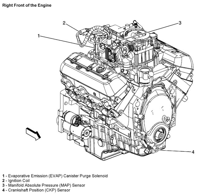

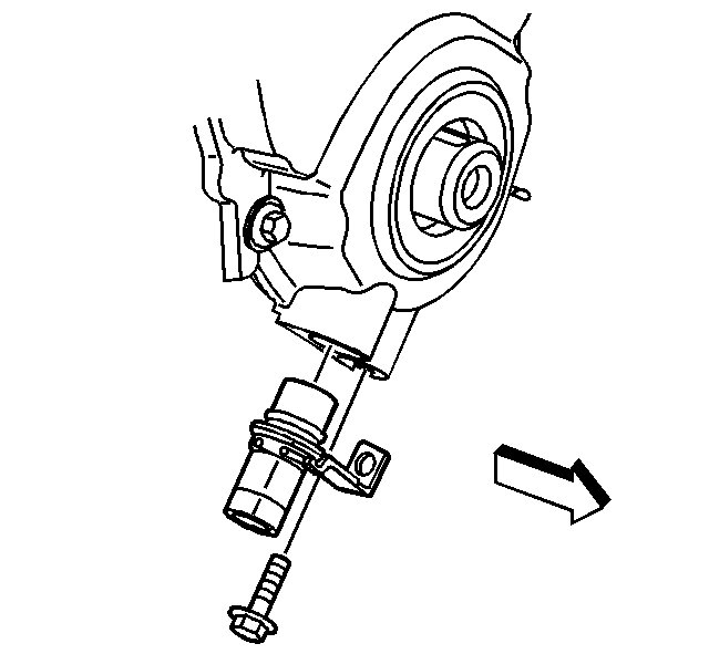

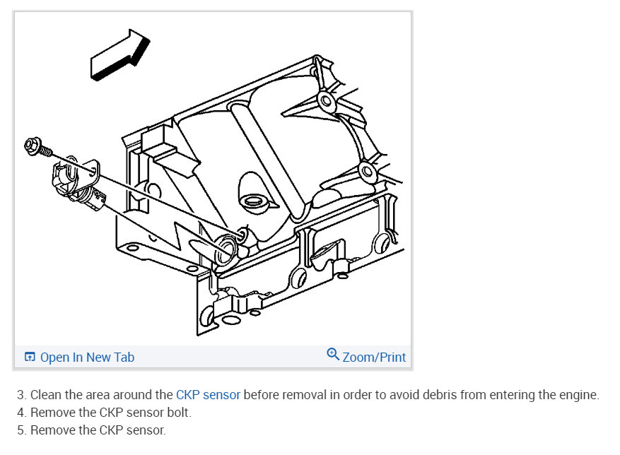

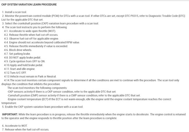

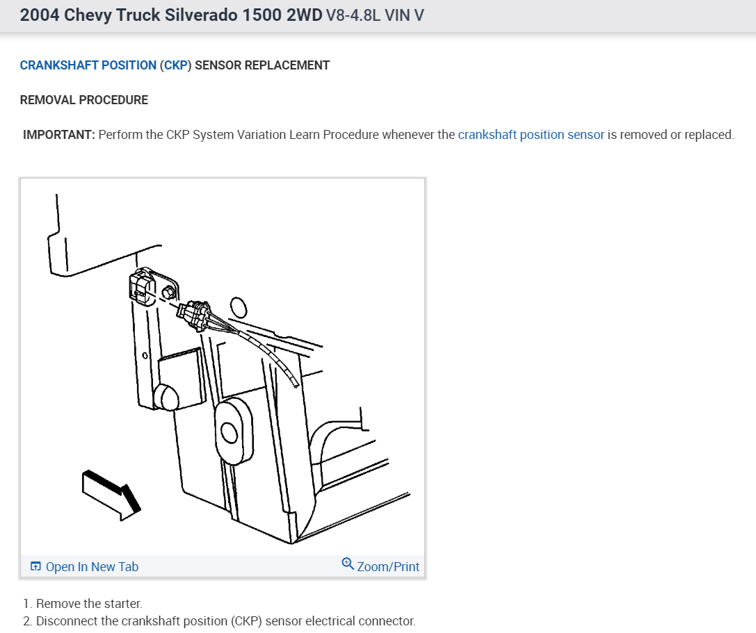

First, have you replaced the crankshaft position sensor? I attached two pictures showing location. I circled the part in picture 2. If you haven't, we need to check that. When I do it, I use a live data scanner and check for an PRM signal while cranking. Take a look through these links. They discuss how it works and its purpose, symptoms, and in general how one is replaced.
https://www.2carpros.com/articles/how-a-crank-shaft-angle-sensor-works
If you find it is bad, here are the directions specific to your vehicle for replacement. Also, the attached pictures correlate with the directions. Additionally, I added the relearn procedure after the directions.

CRANKSHAFT POSITION (CKP) SENSOR REPLACEMENT
REMOVAL PROCEDURE

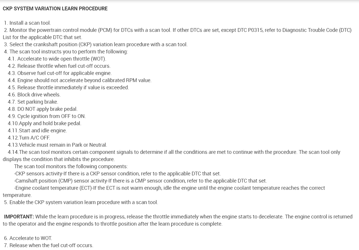

IMPORTANT: The crankshaft position (CKP) system variation learn procedure will need to be performed whenever the CKP sensor is removed or replaced.

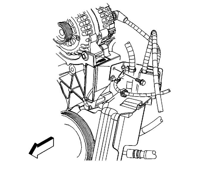

pic 3

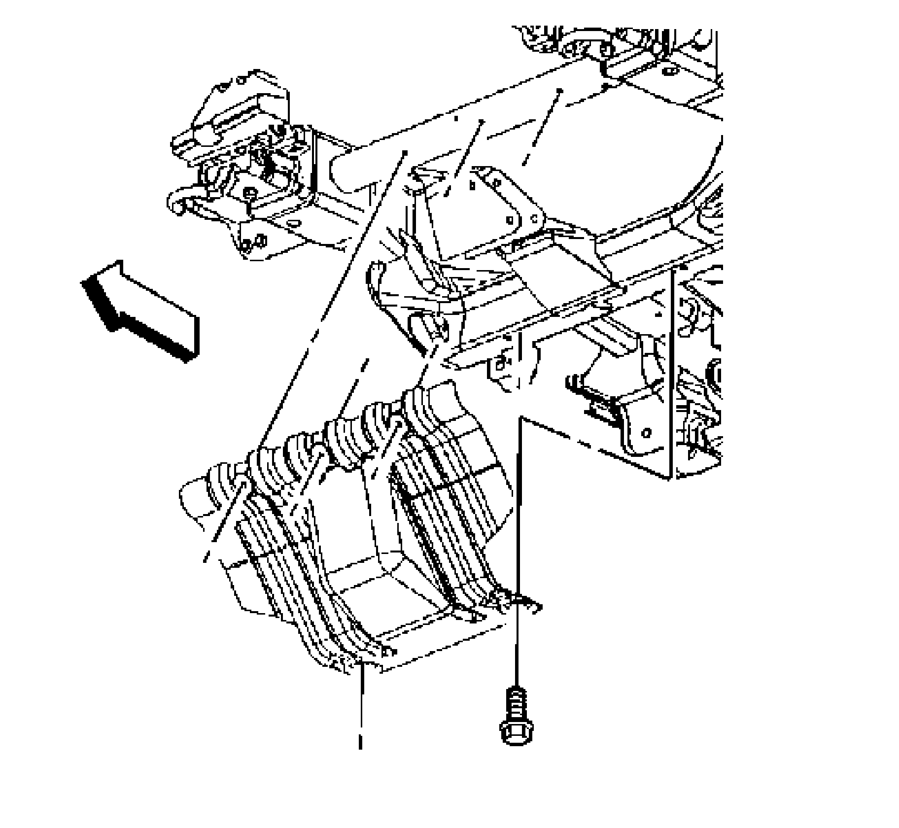

1. Raise and suitably support the vehicle. Refer to Vehicle Lifting.
2. If equipped, remove the engine shield bolts.
3. Remove the engine shield.
pic 4
4. Disconnect the CKP sensor electrical connector (5).

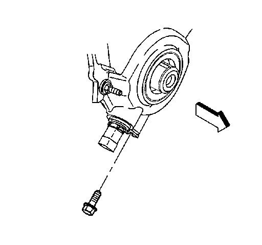

pic 5
5. Remove the CKP sensor bolt.
pic 6
6. Remove the CKP sensor.
INSTALLATION PROCEDURE
IMPORTANT: When installing the CKP sensor, make sure the sensor is fully seated before tightening the bolt. A poorly seated CKP sensor may perform erratically and may set false diagnostic trouble codes (DTCs).
pic 7
1. If installing the old CKP sensor, install a NEW O-ring seal.
IMPORTANT: Do not reuse the original O-ring seal.
2. Lubricate the O-ring seal with clean engine oil.
3. Install the CKP sensor.
pic 8
4. Install the CKP sensor bolt.
NOTE: Refer to Fastener Notice in Service Precautions.
Tighten the bolt to 9 N.m (80 lb in).
pic 9
5. Connect the CKP sensor electrical connector (5).
pic 10
6. Install the engine shield.
7. Install the engine shield bolts.
Tighten the bolts to 20 N.m (15 lb ft).
8. Perform the CKP system variation learn procedure. See: Vehicle > Programming and Relearning
_______________________________________

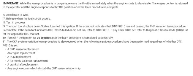

Variation Relearn
CKP SYSTEM VARIATION LEARN PROCEDURE
1. Install a scan tool.
2. Monitor the powertrain control module (PCM) for DTCs with a scan tool. If other DTCs are set, except DTC P0315, refer to Diagnostic Trouble Code (DTC) List - Vehicle in Vehicle DTC Information for the applicable DTC.
3. Select the crankshaft position variation learn procedure with a scan tool.
4. The scan tool instructs you to perform the following:
1. Accelerate to wide open throttle (WOT).
2. Release throttle when fuel cut-off occurs.
3. Observe fuel cut-off for applicable engine.
4. Engine should not accelerate beyond calibrated RPM value.
5. Release throttle immediately if value is exceeded.
6. Block drive wheels.
7. Set parking brake.
8. DO NOT apply brake pedal.
9. Cycle ignition from OFF to ON.
10. Apply and hold brake pedal.
11. Start and idle engine.
12. Turn the A/C OFF.
13. Vehicle must remain in Park or Neutral.
14. The scan tool monitors certain component signals to determine if all the conditions are met to continue with the procedure. The scan tool only displays the condition that inhibits the procedure. The scan tool monitors the following components:
- Crankshaft position (CKP) sensors activity-If there is a CKP sensor condition, refer to the applicable DTC.
- Camshaft position (CMP) signal activity-If there is a CMP signal condition, refer to the applicable DTC.
- Engine coolant temperature (ECT)-If the engine coolant temperature is not warm enough, idle the engine until the engine coolant temperature reaches the correct temperature.
5. Enable the CKP system variation learn procedure with the scan tool.
6. Accelerate to WOT.
IMPORTANT: While the learn procedure is in progress, release the throttle immediately when the engine starts to decelerate. The engine control is returned to the operator and the engine responds to throttle position after the learn procedure is complete.
7. Release throttle when fuel cut-off occurs.
8. The scan tool display reads Test In Progress.
9. The scan tool displays Learn Status: Learned this ignition. If the scan tool indicates that DTC P0315 ran and passed, the CKP variation learn procedure is complete. If the scan tool indicates DTC P0315 failed or did not run, refer to DTC P0315. If any other DTCs set, refer to Diagnostic Trouble Code (DTC) List - Vehicle in Vehicle DTC Information for the applicable DTC.
10. Turn OFF the ignition for 30 seconds after the learn procedure is completed successfully.
11. The CKP system variation learn procedure is also required when the following service procedures have been performed, regardless of whether or not DTC P0315 is set:
- An engine replacement
- A PCM replacement
- A harmonic balancer replacement
- A crankshaft replacement
- A CKP sensor replacement
- Any engine repairs which disturb the crankshaft to CKP sensor relationship.
________________________________________

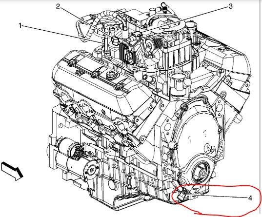

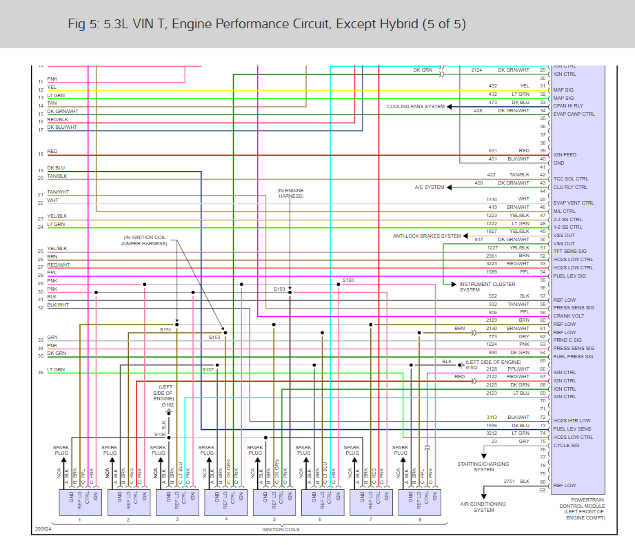

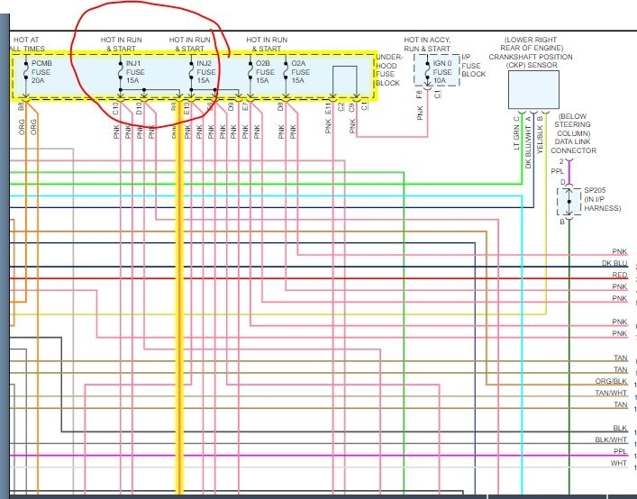

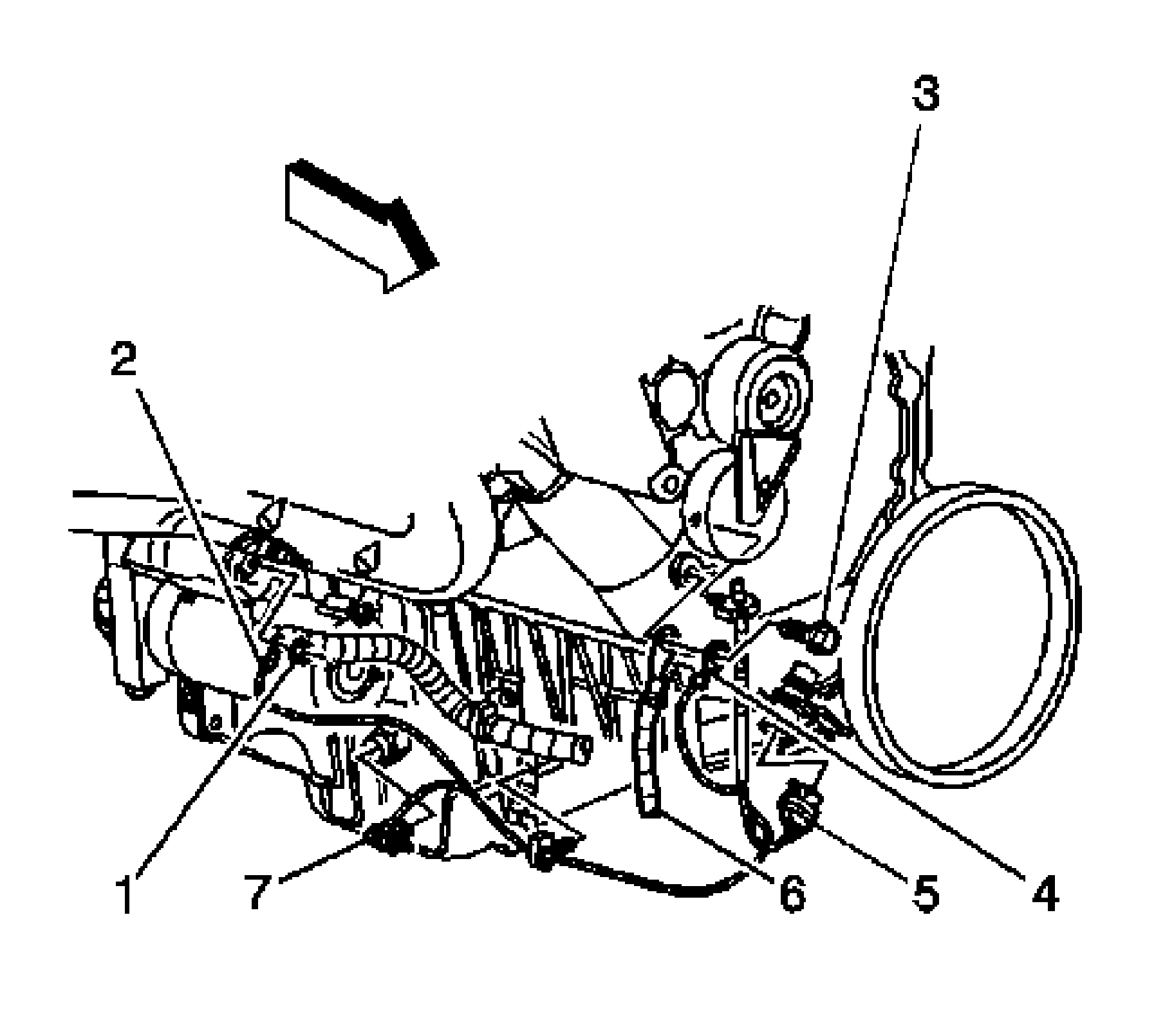

Now, before you replace the sensor, there is one more thing I want you to check. It is the ground for the coils and module. They all have 1 common ground. This ground is pron to fail after miles and years, so I strongly recommend checking it. Even though it may look attached at the engine block, make sure the connector is not ready to break, it is tight, and there isn't a corrosion issue. I learned this the hard way. Same conditions as your truck and couldn't find the problem. Touched the ground and it fell off. LOL
I attached a picture of the coils and ground. I circled the ground location. Make sure you also check the splice in the harness if the ground is good. Also, note that it can show continuity but fail when a load is placed on it. That's why I didn't suspect it.
Let me know if any of this helps or if you have other questions.

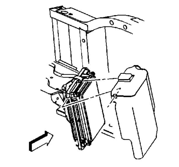

i already explained in the very beginning that i have replaced the PCM and yes the connections are good.
Oct 5, 2020 at 3:07 AM (Merged)
It still could be the PCM. Buying one preprogrammed does not always work.
Do you have a scan tool to read live data?

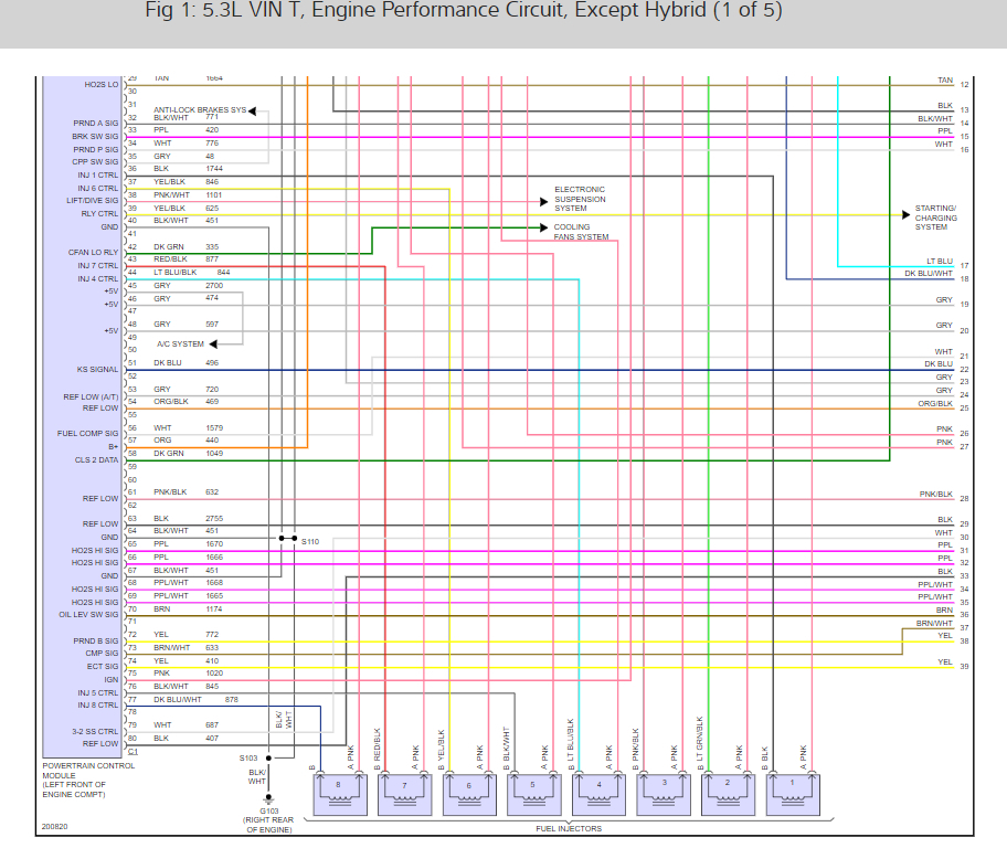

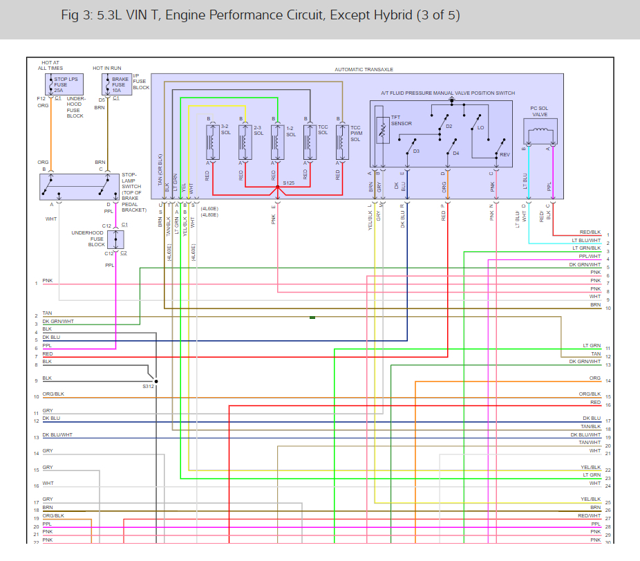

Engine will crank fuel will pump but no spark changed crankshaft position sensor changed battery check ignition coil putting thorough 10 volts alternator puts out 12 volts relays and doses are all ok can't find problem it started and ran one day and hasn't started swapped around plug wires and ignition coils need help really need to get back to work help me
Oct 5, 2020 at 3:08 AM (Merged)
  • 55,224 POSTS

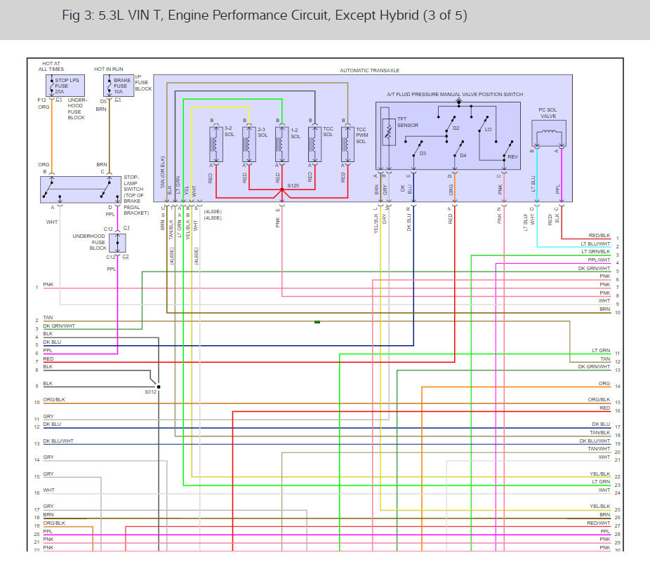

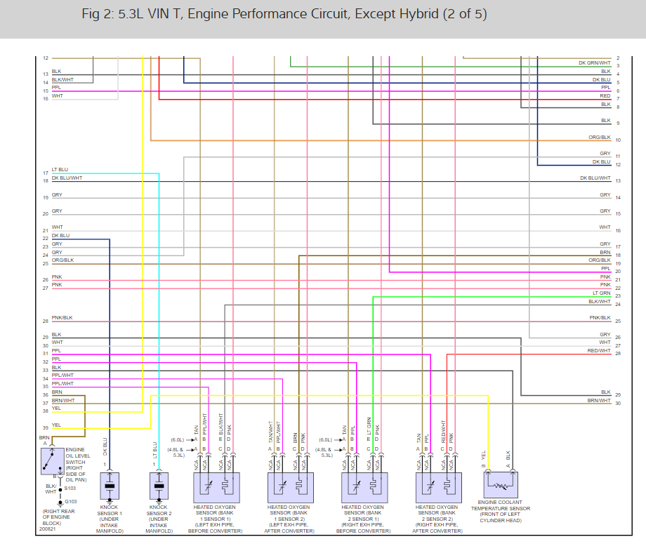

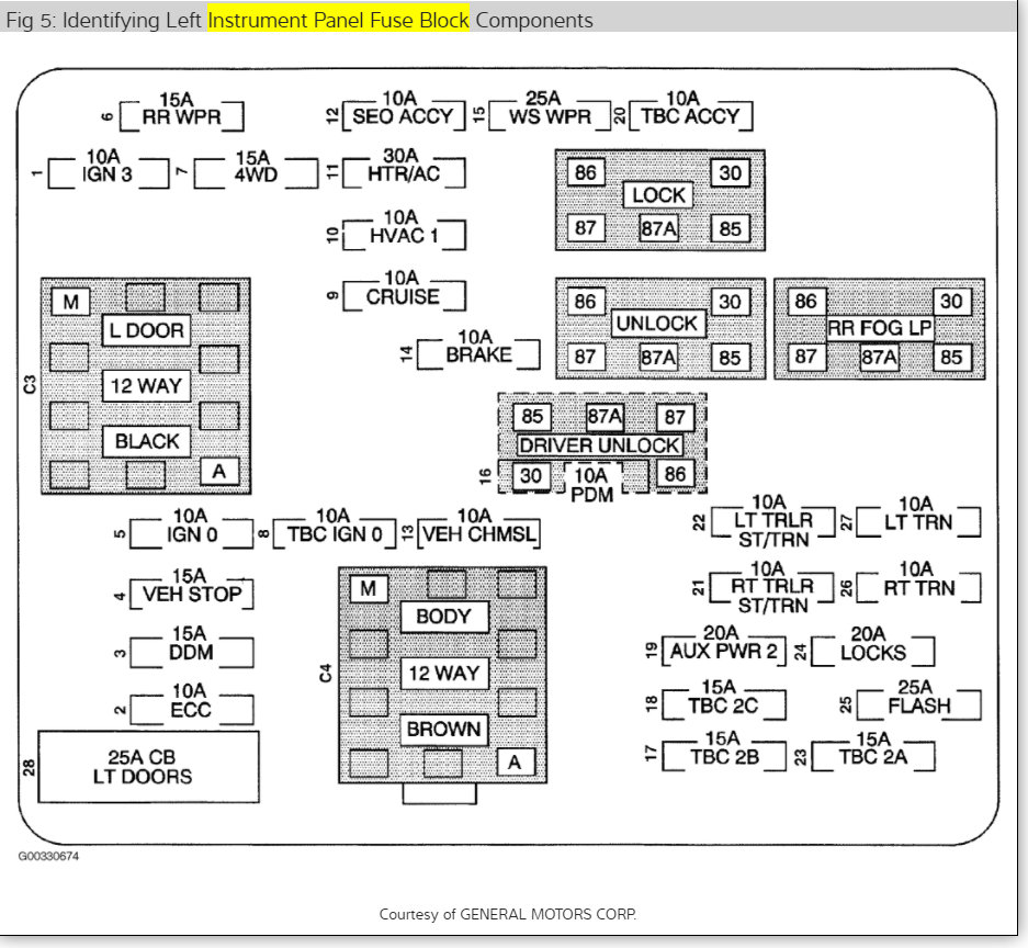

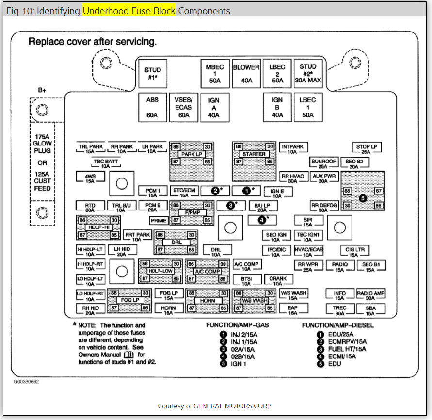

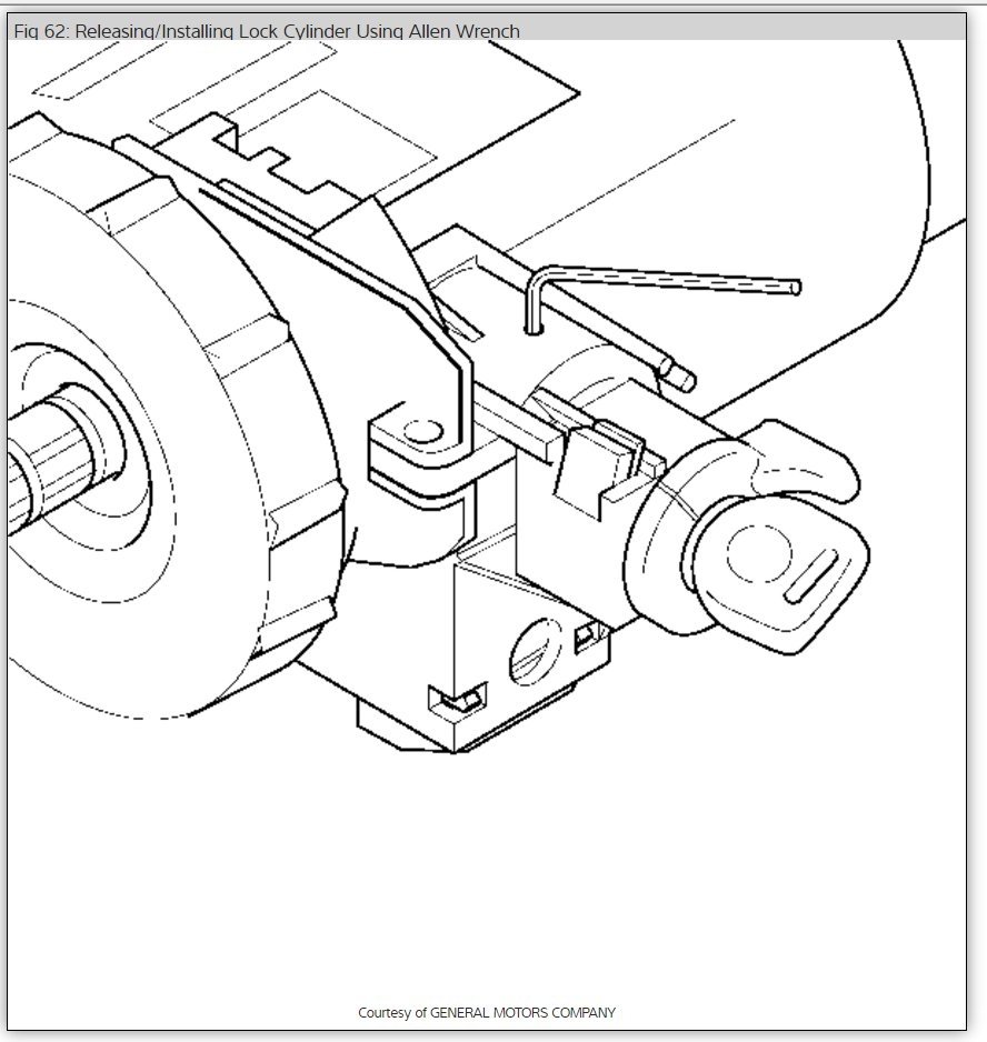

Two things come to mind, first is the security light flashing when you try to start it? This means the security system in engaged and it wont allow the engine ignition system to operate. This guide will help set it if its blinking.
https://www.2carpros.com/articles/how-to-reset-a-security-system

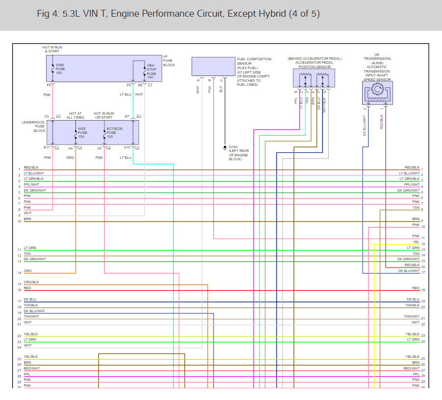

If not you may have an PCM1 fuse that is blow due to a shorted coil or injector. Please check the fuse for power and get back to me.

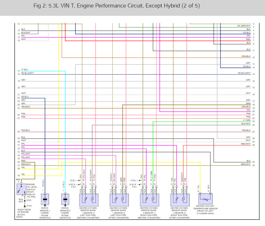

Here are the fuse locations and the engine wiring diagrams so you can see how the system works. If the fuse is blown unplug each coil and injector then plug them in one at time until the fuse blows.
This guide can helps as well
Check out the diagrams (Below). Please run this test and get back to us.
MLONG0790
Yep you were right it was the BCM I took it to the dealer and it cost me $550.00 for everything. Thanks for your help I love this site.

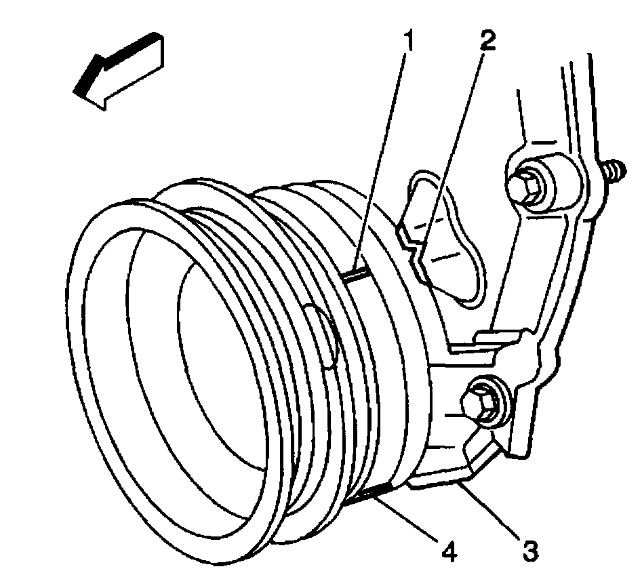

MOTOR MASTER
  • 279 POSTS
Hello my name is Dave.

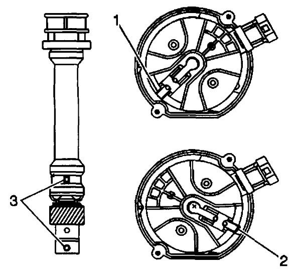

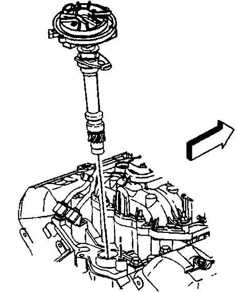

First thing we need to diagnose is the P1345 code which is saying that the cam and crank sensors are not synchronized with each other. In simpler terms the timing is off (I don't know why that can't just call it that ). This can cause a cam sensor code (P0341) and random misfire code (P0300 ). The cam sensor is located in the distributor so if you replaced the distributor with a complete unit you have already replaced the sensor. I am going to attach the diagrams from the manual showing how to install the distributor. Unfortunately to properly time the cam sensor (distributor) you will need a scan tool that has live data however if you follow the distributor installation instructions the engine should start provided that is the only cause of your no start. I am also noting where the illustrations are located in the manual.
Illustration 1
1. Rotate the crankshaft balancer clockwise until the alignment marks on the crankshaft balancer are aligned with the tabs on the engine front cover and the number 1 piston is at top dead center of the compression stroke.

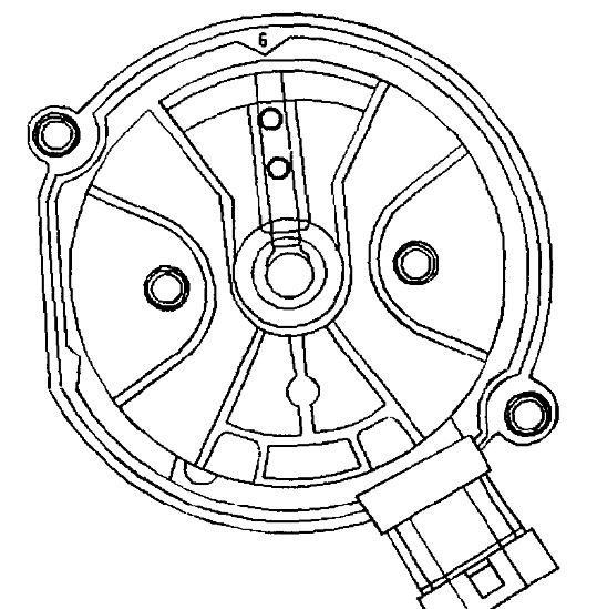

Illustration 2
2. Align white paint mark on the bottom stem of the distributor, and the pre-drilled indent hole in the bottom of the gear (3).
NOTE: The ignition system distributor driven gear and rotor may be installed in multiple positions. In order to avoid mistakes, mark the distributor on the following compartments in order to ensure the same mounting position upon reassembly:
^ The distributor driven gear
^ The distributor shaft
^ The rotor holes
Installing the driven gear 180 degrees out of alignment, or locating the rotor in the wrong holes, will cause a no-start condition. Premature engine wear or damage may result.
3. With the gear in this position, the rotor segment should be positioned as shoran for a V6 engine.
Illustration 3
4. Using a long screw driver, align the oil pump drive shaft to the drive tab of the distributor.
5. Guide the distributor into the engine. Ensure that the spark plug towers are perpendicular to the center-line of the engine.
Illustration 4
6. Once the distributor is fully seated, the rotor segment should be aligned with the pointer cast into the distributor base.
^ This pointer may have a 6 cast into it, indicating that the distributor is to be used on a 6 cylinder engine or a 8 cast into it, indicating that the distributor is to be used on a 8 cylinder engine.
^ If the rotor segment does not come within a few degrees of the pointer, the gear mesh between the distributor and the camshaft may be off a tooth or more.
^ If this is the case, repeat the procedure again in order to achieve proper alignment.
I believe if you follow these instructions the engine will start and as far as the other codes for the EGR valve lets worry about those after we get the engine running. Please keep us up to date on your progress and thank you for using 2CarPros!

I have seen many crankshaft angle sensors go out in these trucks it sounds like that's what happened to your truck here is a video showing the job being done.
https://youtu.be/sKo7xRWVNqY
Oct 5, 2020 at 3:09 AM (Merged)
BROWNN
Thanks for this post I watched the video and replaced the sensor truck fired right up :) I love this site.

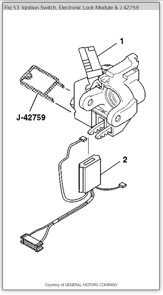

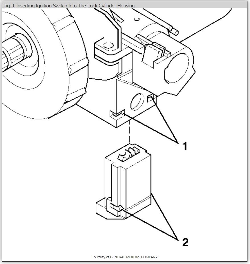

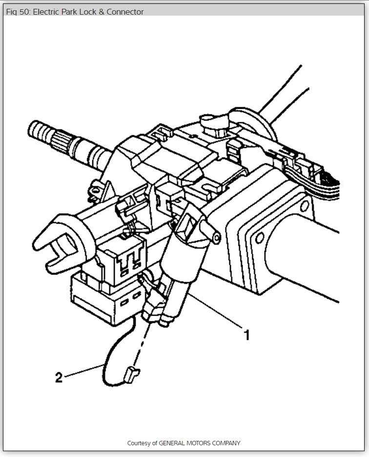

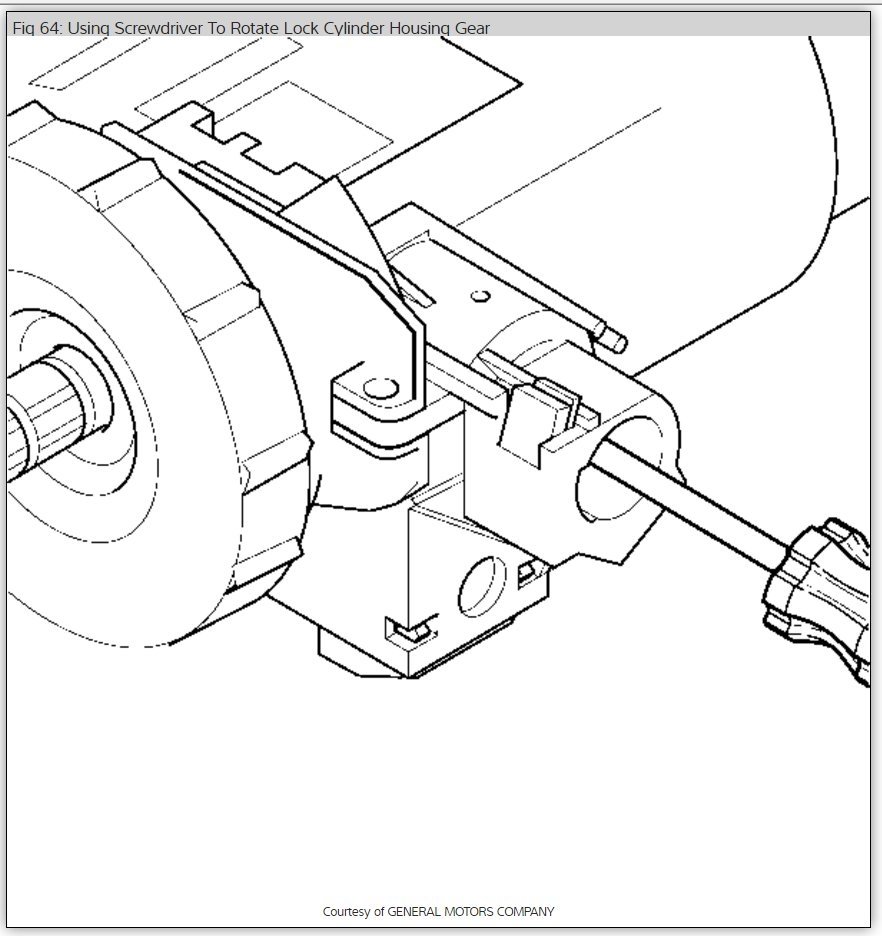

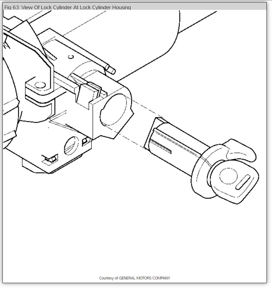

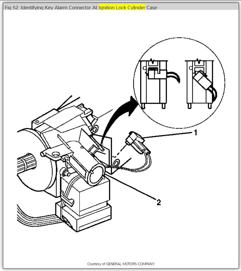

  • 55,224 POSTS

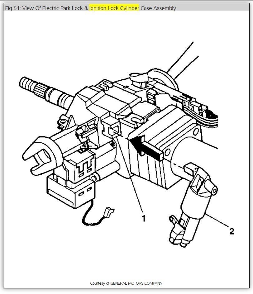

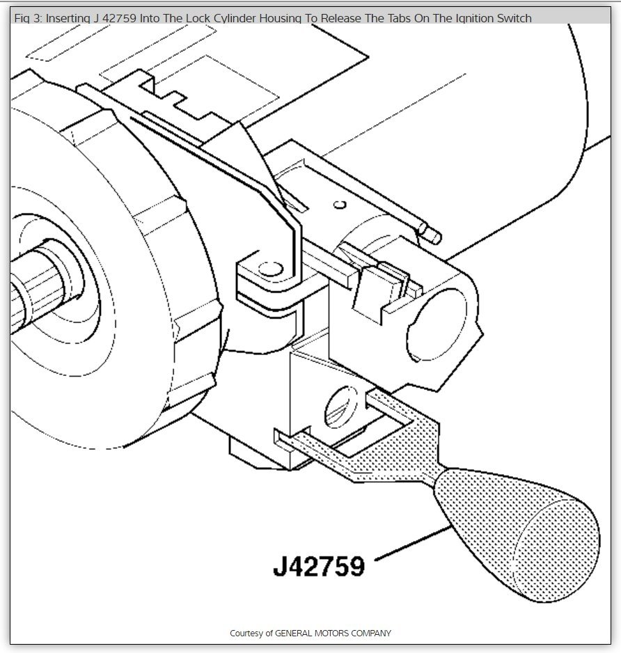

It sounds like the ignition switch has gone bad here is how can replace it. Check out the diagrams (Below). Please let us know what happens.
BOB TYREE
Ken thanks for the advice on the ignition switch. I had changed it out and I still have the same issue.

BIG_AL71
im a litltle baffled by this one. i installed new distibutor w/ new cap an rotor truck won't start. so i check spark at plug and i'm not getting any spark. so i check spark at coil to dist: an i'm getting good spark. so i installed new crank sensor but still no spark at wires. now on harmonic balancer pulley there are 2 marks for timing but no numbers that indicate degrees since timing is not adjustable. so my question is which mark do i use for top dead center and if dist is advanced a tooth would that cause no spark at plugs which don't make sense
