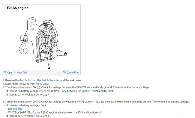

By any chance, have you scanned for diagnostic codes?

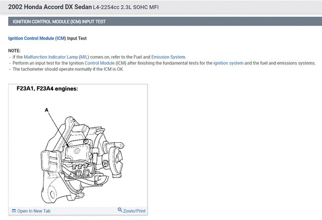

Also, I'm questioning the ICM in the distributor. If it is working, you should be able to crank the engine and the tachometer should move a bit or you can use a live data scan tool to check for an RPM signal.
Check that first. If there is no signal, follow the attached diagnostics and let me know what you find.

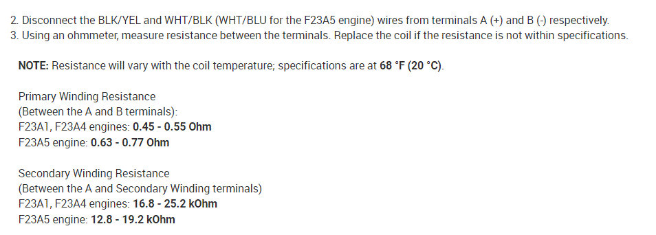

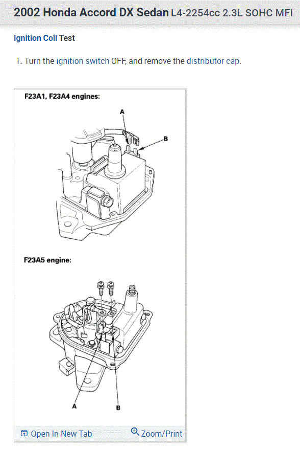

Is there continuity on the yellow/green wire between the ICM and PCM? Also, have you checked the coil itself?
If you haven't, I attached directions below for testing the coil.

I have put a brand new coil in and that did not correct the problem, so I returned it. I will conduct the ohms test as soon as I get to the shop. What are the chances of a new coil out of the box being defective? It happens.

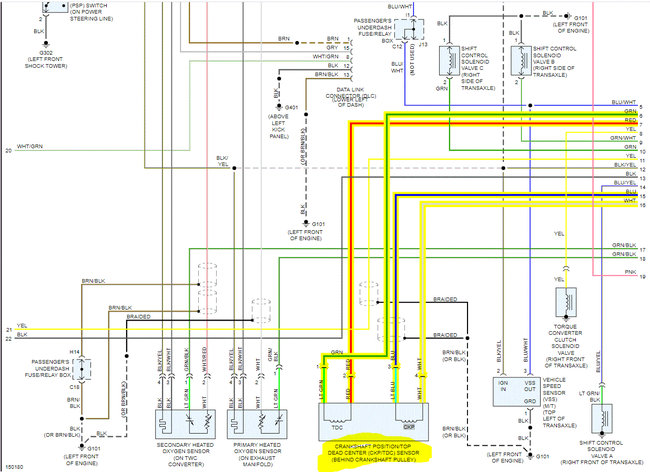

Well, everything checks out okay. Let's talk about the crank position sensor. It is a 4 prong connector dual head system. Meaning 2 prongs for each. I can get a reading on one head unit but not on the other. They are not grounded because they create their own voltage, correct?

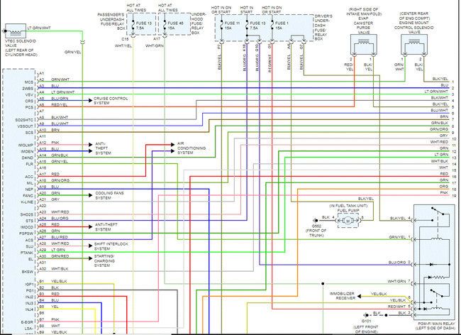

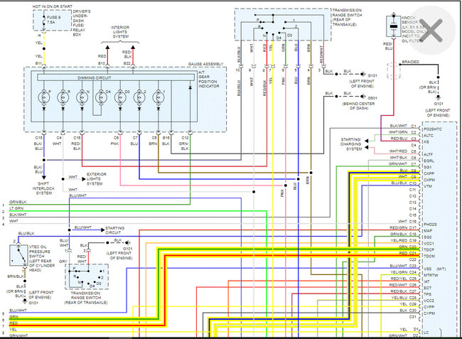

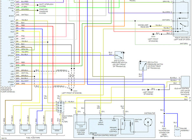

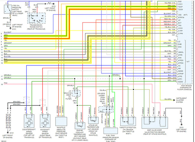

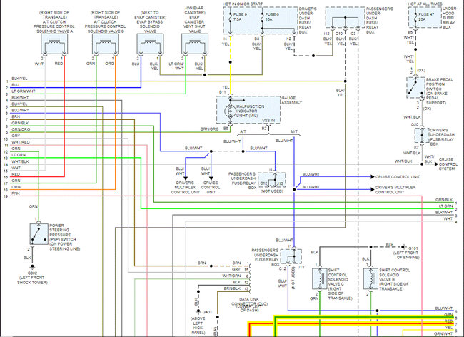

I attached the entire wiring schematic below for the powertrain management system. I highlighted all wires for the CKP/TDC sensor.
The CKP sensor determines fuel injection timing and ignition timing for each cylinder and also detects engine speed. The TDC sensor determines ignition timing at start-up and when the crankshaft position signal is abnormal.
Take a look through the schematics below. I noticed there is no indication of ground. Usually, there is a low reference that functions as a ground, but it's not showing that.
Do me a favor. Remove the distributor cap and confirm there is power to the positive side of the coil with the key in the run position. Next, check if the coil is providing spark. If it does, then there is a problem either with the cap and rotor or the rotor isn't turning.
If there is no spark from the coil, I want you to take a test light and provide a good ground on the one end and place the light on the negative side of the coil and have someone crank the engine for you. Your test light should flash if the ignitor is good.
If the test light doesn't blink/flash, the ignitor is bad and needs to be replaced. If it does flash and we have no spark from the coil, the coil is bad.
Try this and let me know what you find or if you have other questions.
See pics below. Note: I had to cut each pic in half to make them readable for you. I did overlap them so you can follow from one to the next.

All sparks now, I found a missing ground wire thanks to the schematics. Never underestimate the importance of a ground.
