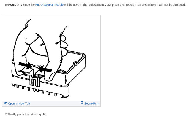

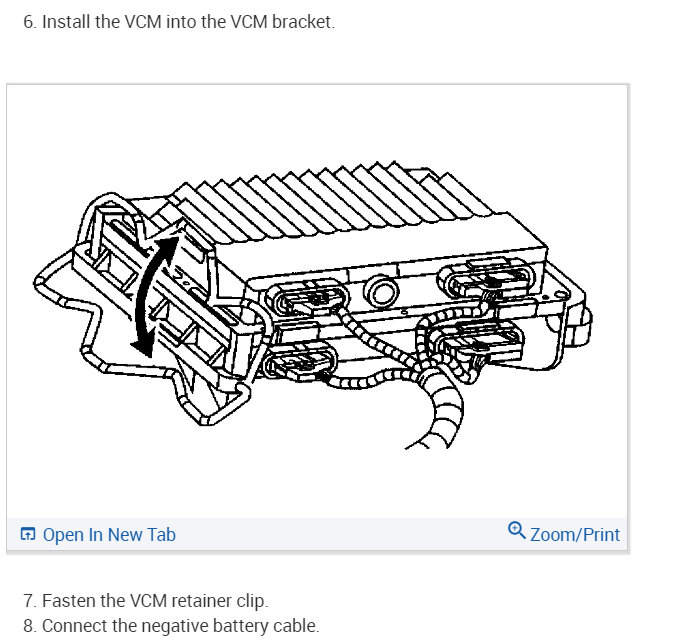

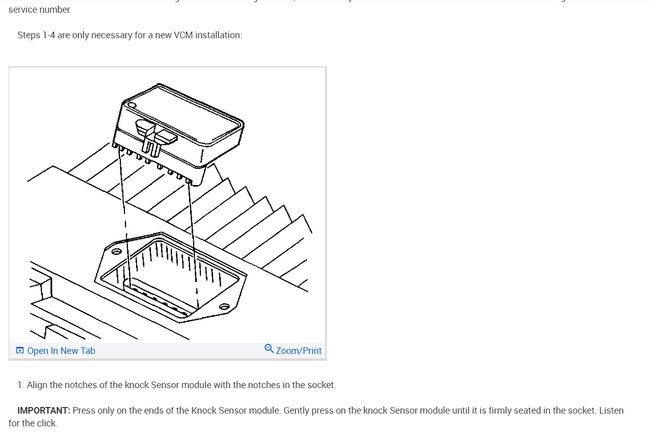

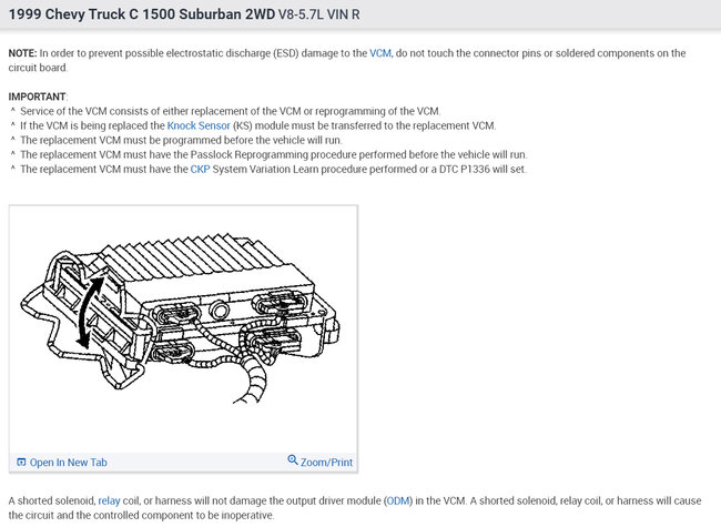

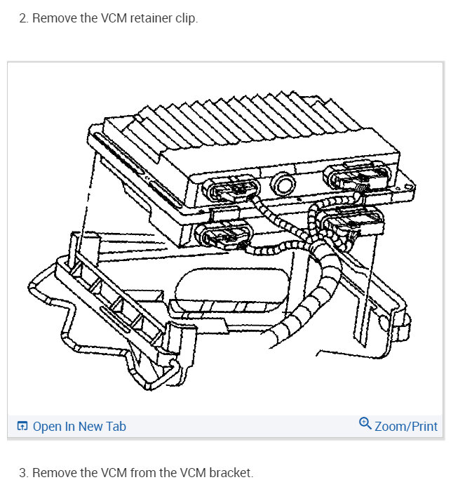

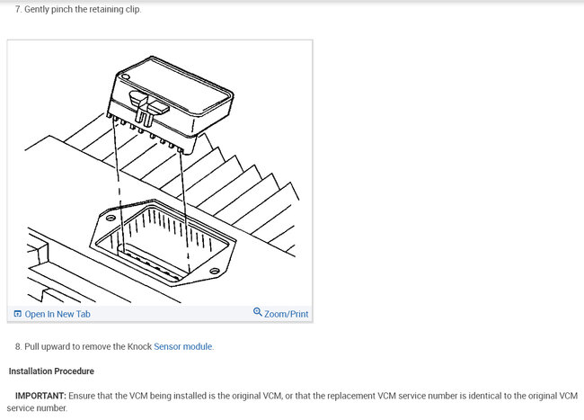

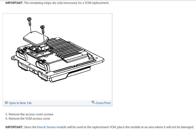

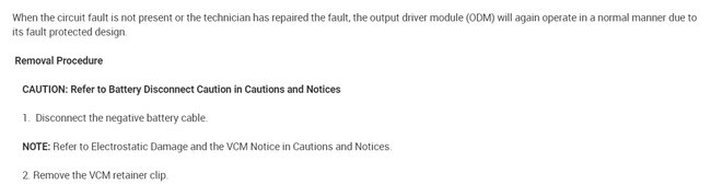

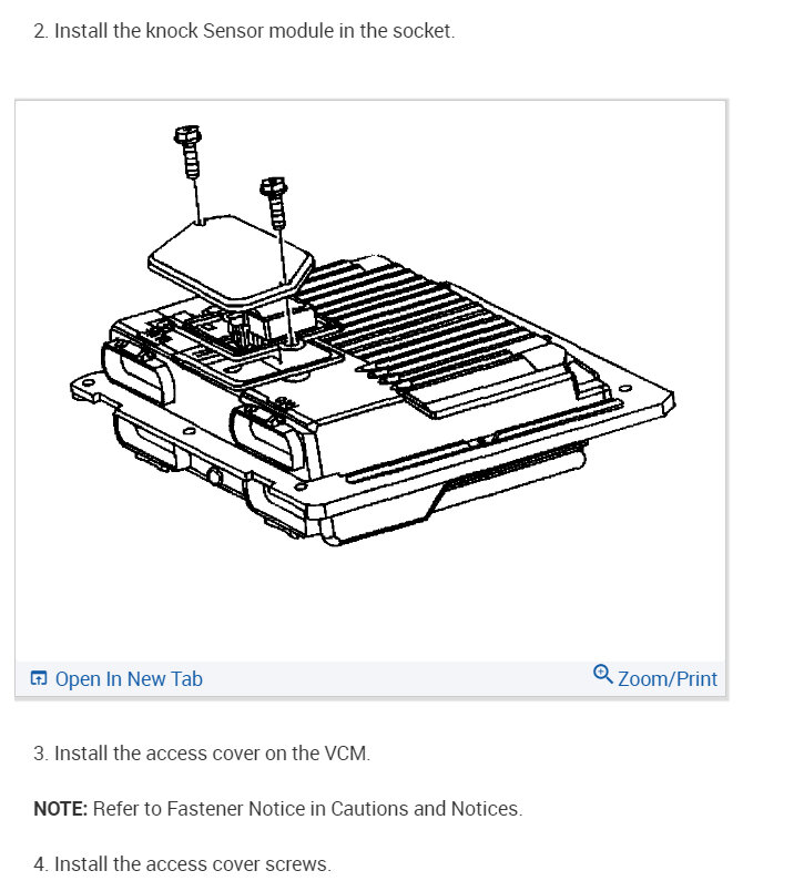

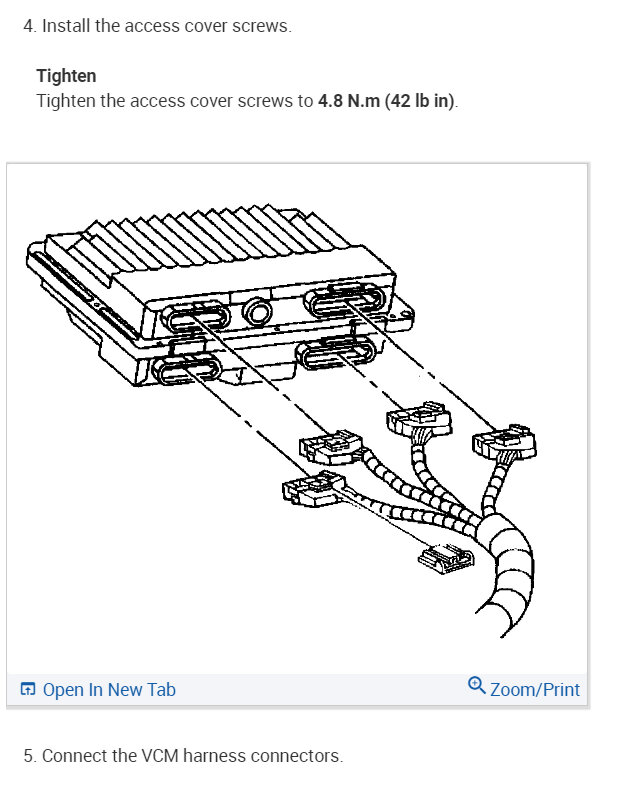

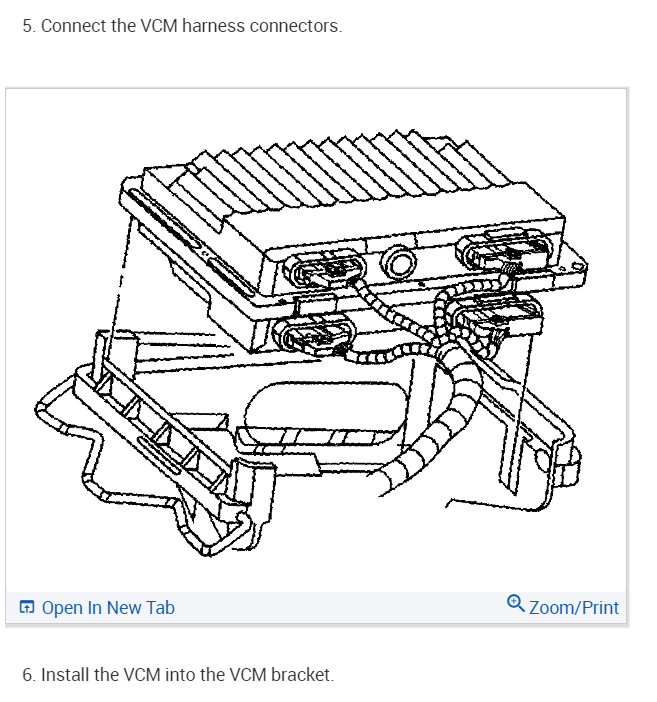

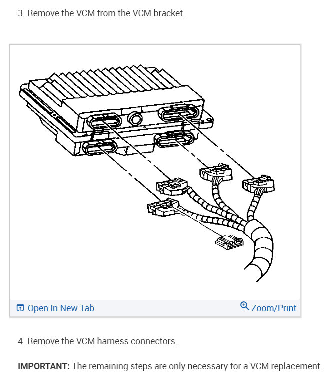

It sounds like the PCM is bad, if you are getting no pulse at the coil and the PCM is seeing RPM the ignition driver inside the PCM is bad. Here is how to change the unit out or send it in for testing. You can get a preprogrammed unit by searching Google or Ebay. Check out the images (below). Please let us know what happens.
