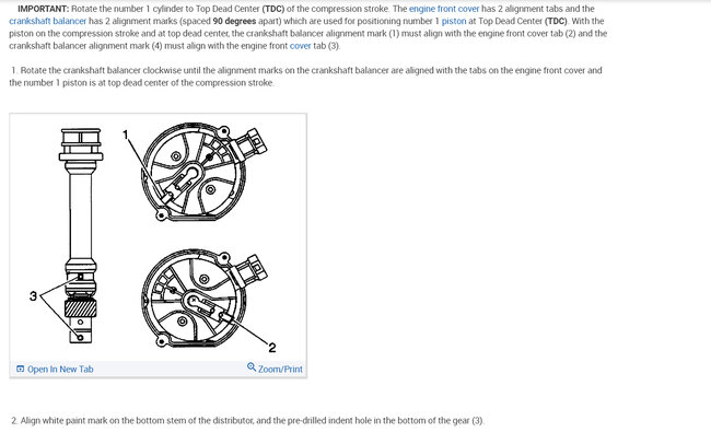

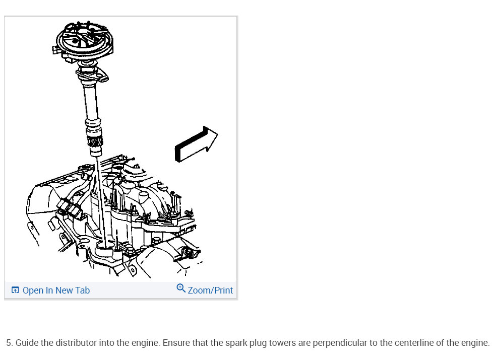

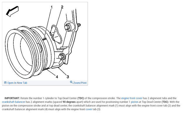

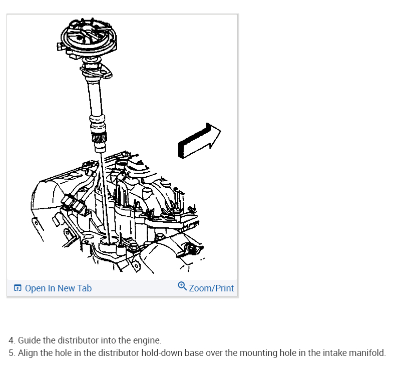

2 months ago, I had codes checked because of a slight miss. O2 sensors and CKP sensor came up. Changed those. Still started and ran. Still had slight miss. Changed rotor and distributor cap... figured would change CMP sensor while I was in there. It would not start afterward. Had spark then. Changed plugs and wires. No start. Checked fuel pressure. Was low, changed fuel pump and filter, battery, starter which was bad. Put in a new distributor. New ECM put in-twice. Have changed coil 3 times, CKP 3 times, CMP twice. Have checked as many ground wires as I can find. Had spark to coil and plugs till I put the throttle body back on and the next morning, no spark at all. Still no spark.

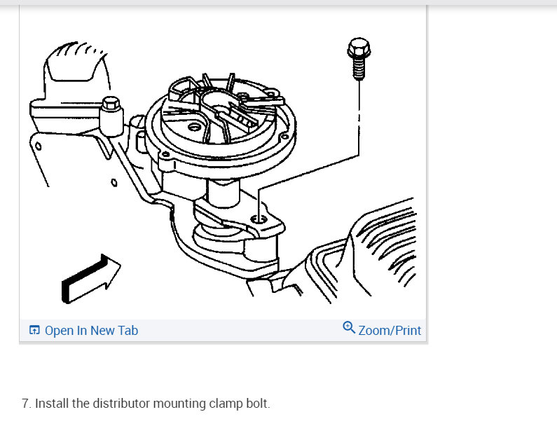

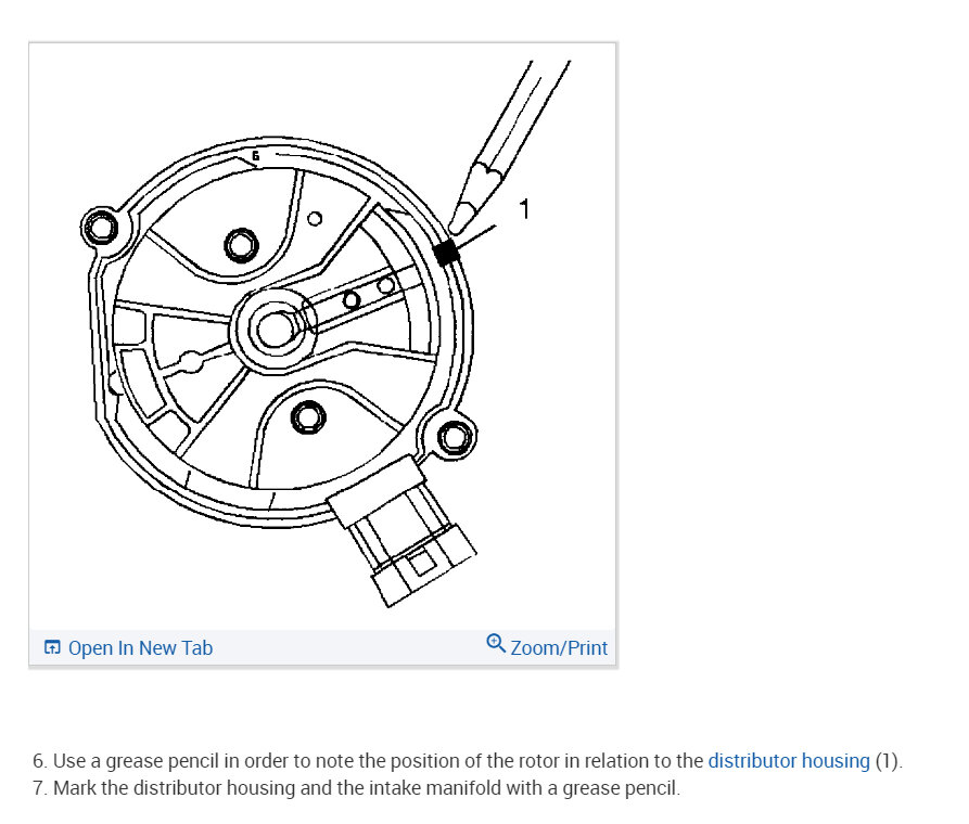

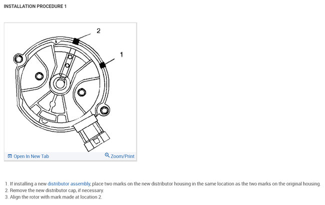

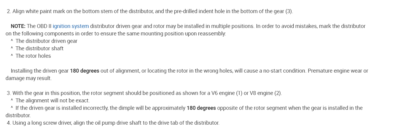

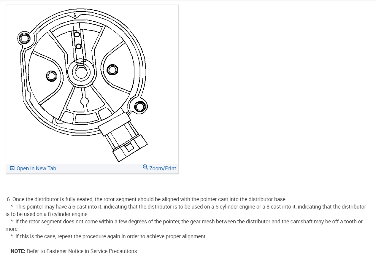

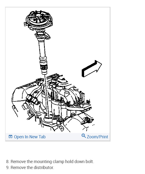

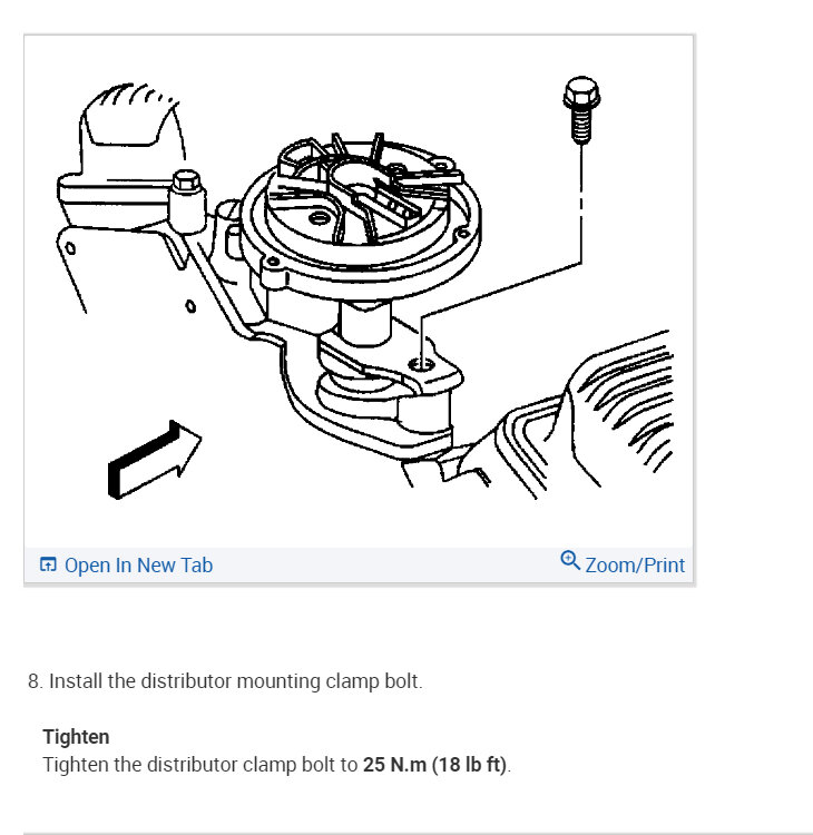

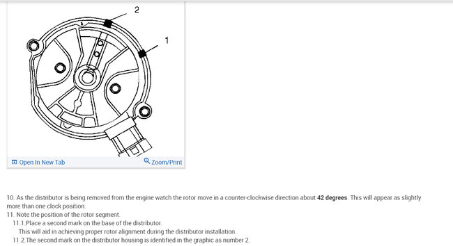

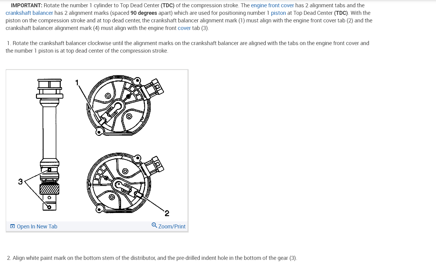

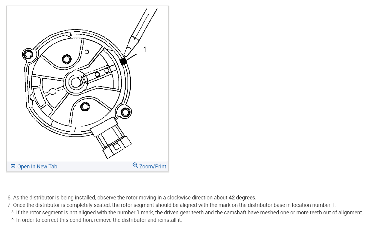

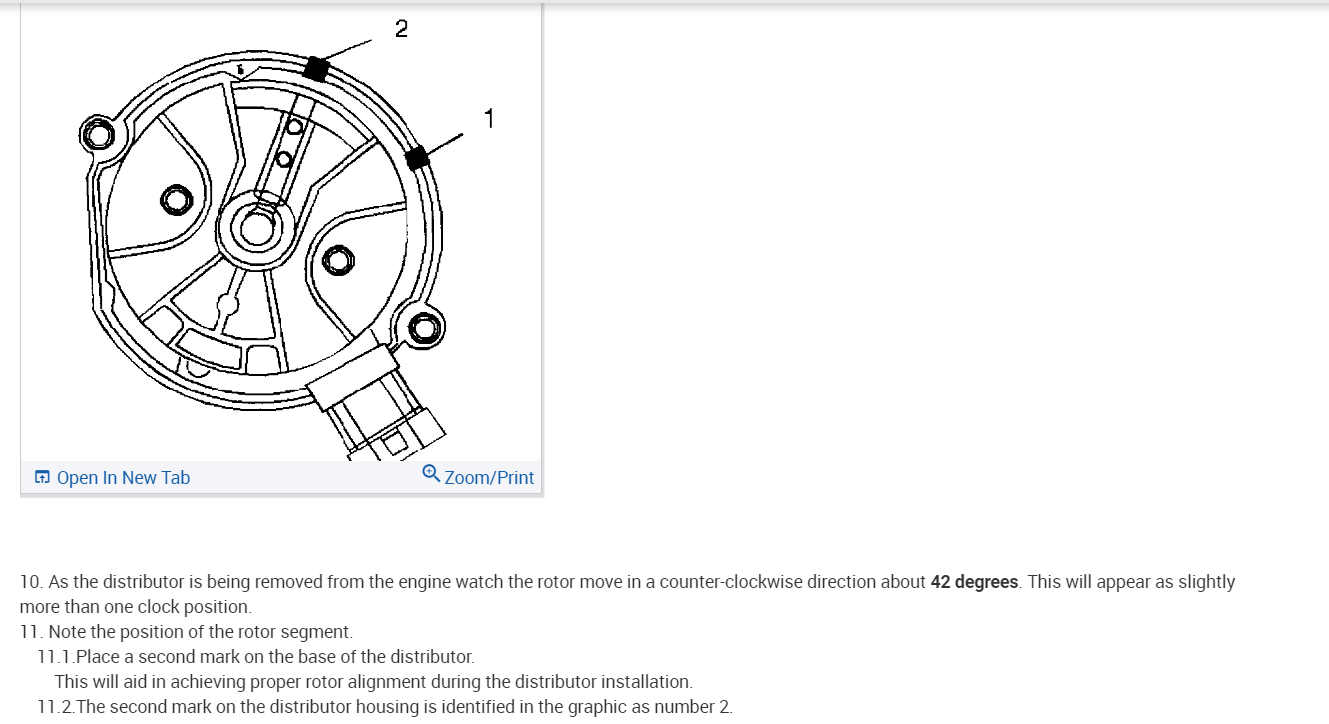

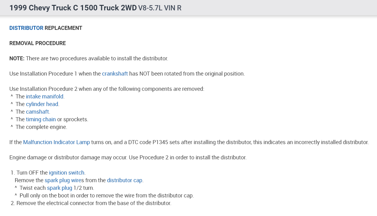

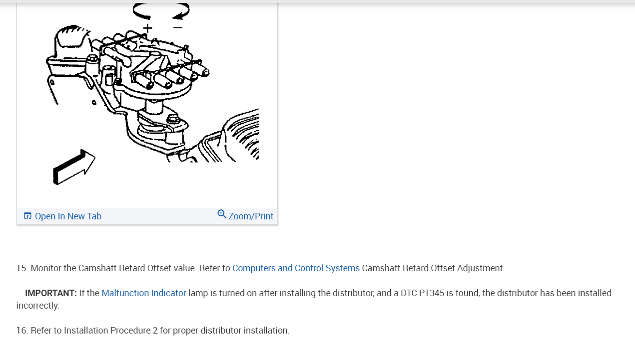

It sounds like the distributor is not installed correctly so the timing is off. Here are the instructions on how to install the distributor correctly. Check out the images (below). Please let us know what happens.

The distributor was checked, checked, checked again, and checked again when it was put in.

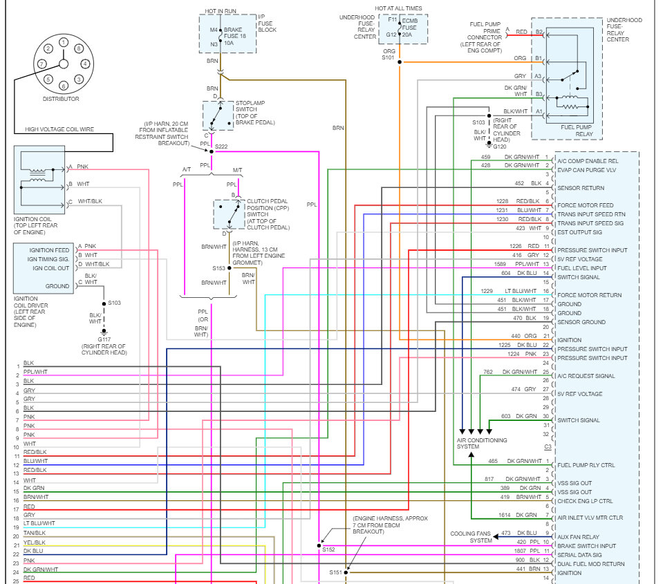

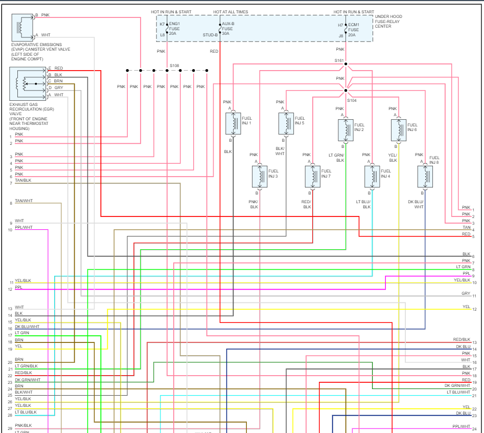

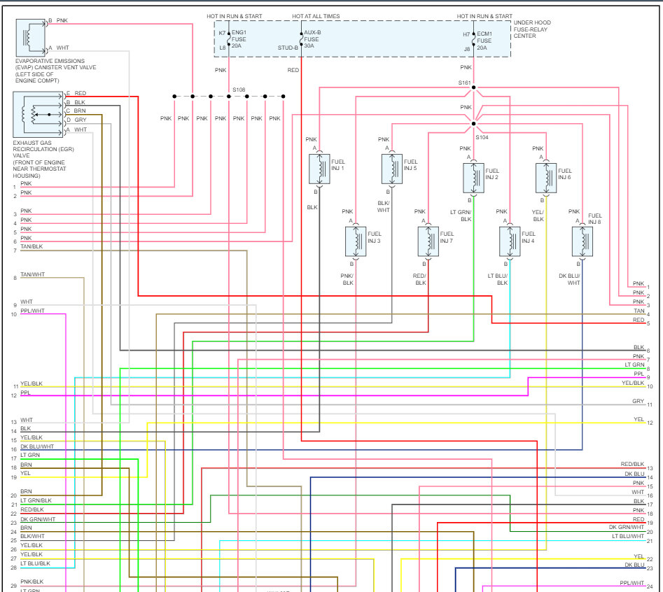

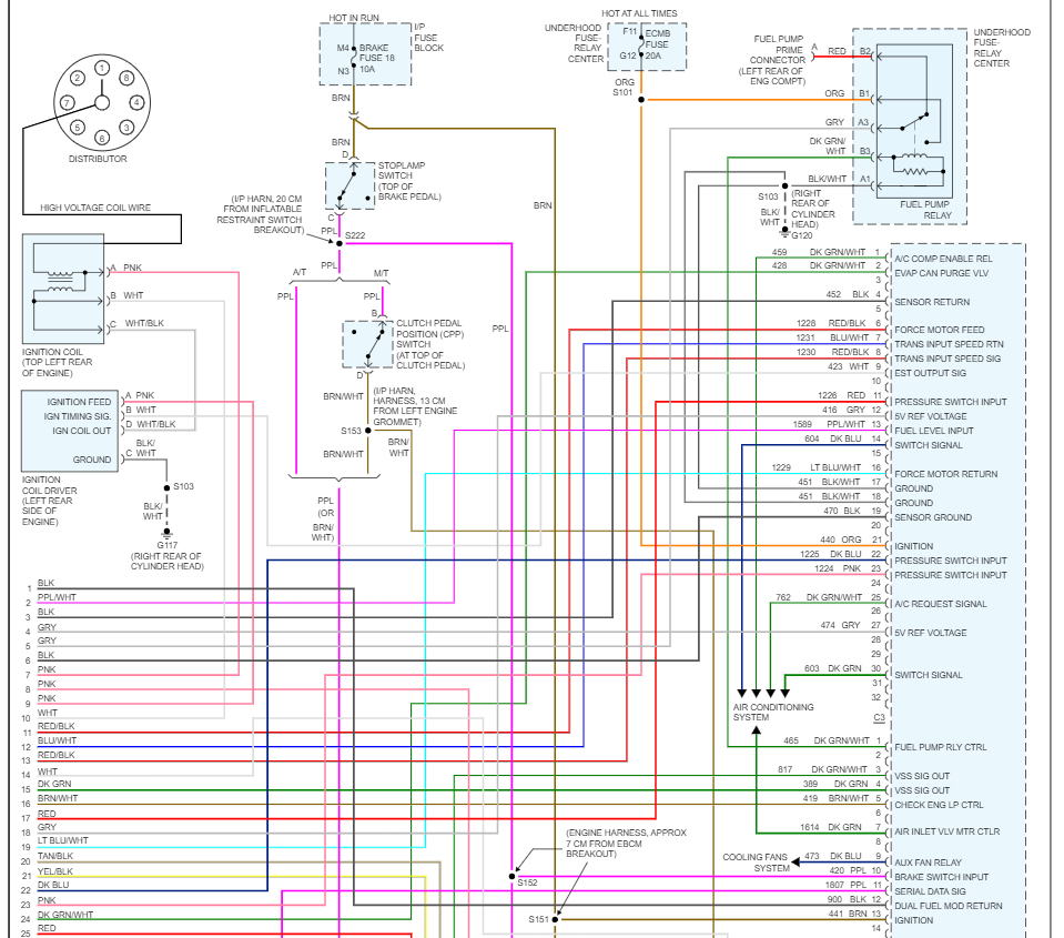

Okay, do you have power at the positive side of the coil (pink wire - key on).
This guide can help:

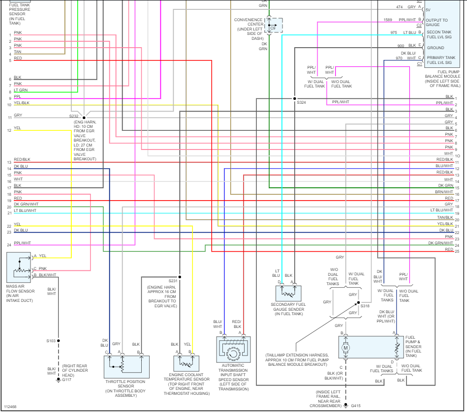

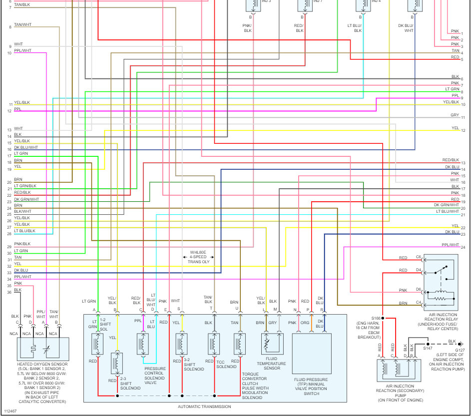

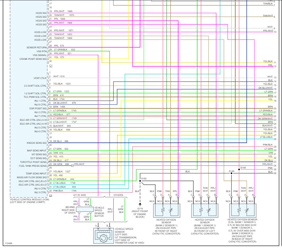

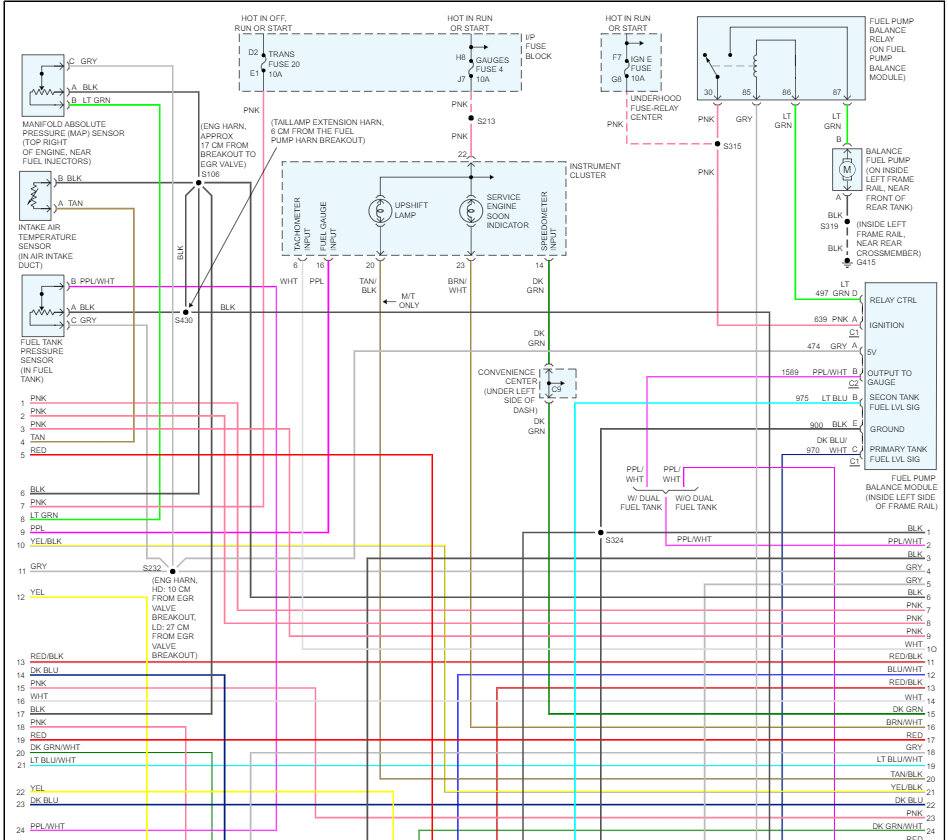

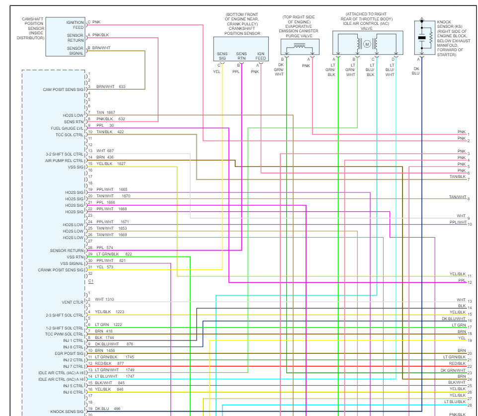

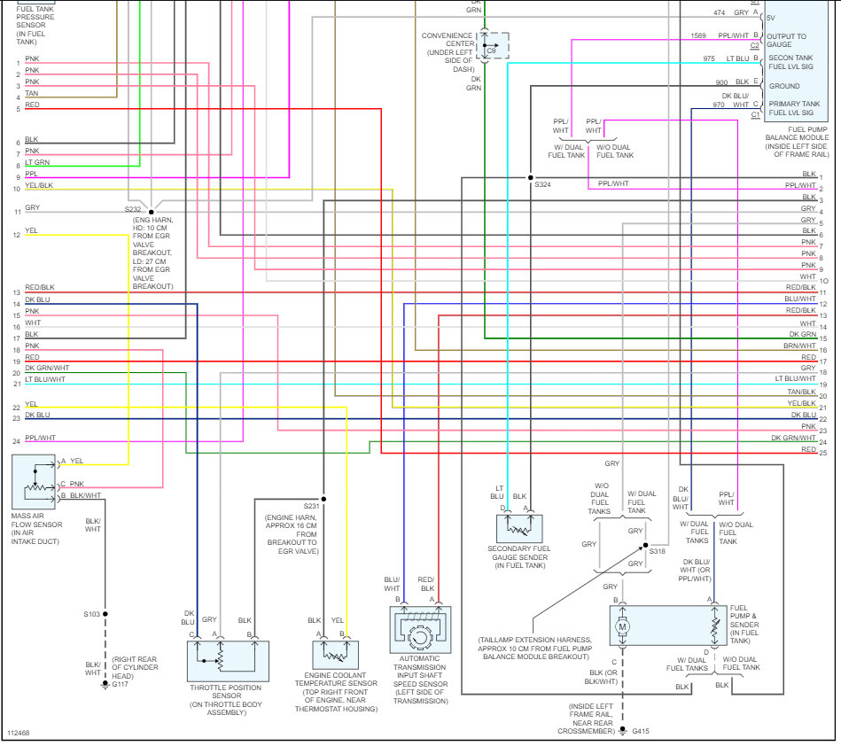

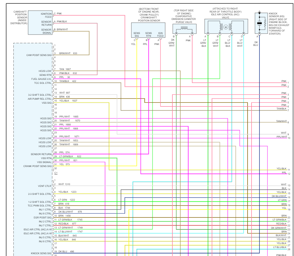

Also, do the same test for the pink wire on the fuel injectors, I would check all fuses in the vehicle and here are the engine wiring diagrams so you can see how the system works.
The wiring diagrams show which fuses to check the PCM and ignition system. Check out the images (below). Let us know what happens and please upload pictures or videos of the problem so we can see what's going on.

Yes, power to positive side of coil and yes power to fuel injectors. Have checked all fuses multiple times.

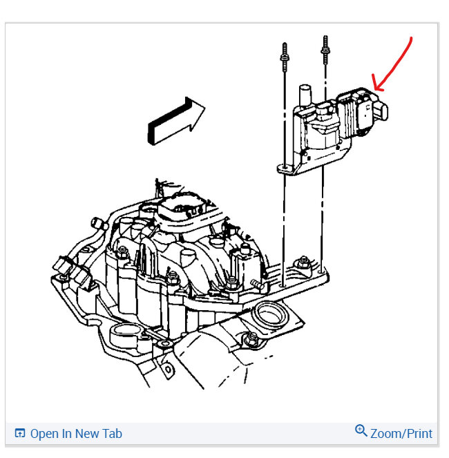

Ours is not a Coil over plug. Ours is a single coil with ignition. Control module on the side of the coil.

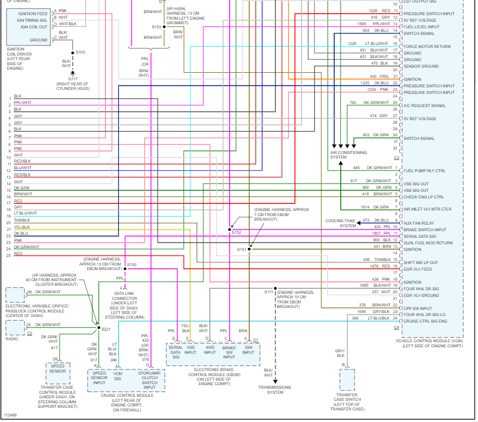

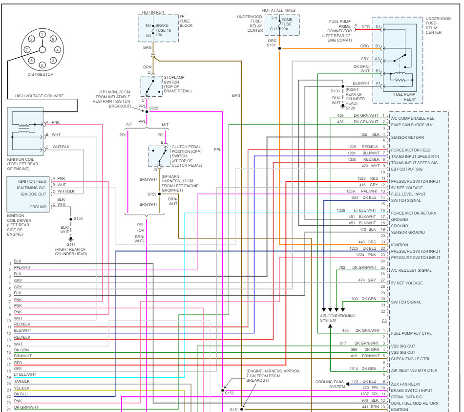

Sorry, the opposite side of the coil, which is either white wire should tell you, remove the connector to test. Also, I have seen the coil driver module go out and cause this issue as well. Here are the coil and module wiring diagrams so you can see how the system works. Check out the images (below). Please let us know what you find.

Nope... No flash... next?

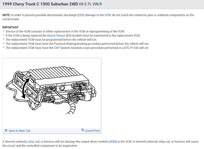

Okay, we are getting closer, you said you replace the crankshaft sensor so I will assume that is okay, if you have a scanner that can read engine RPM, I would crank the engine over to see if it is reading RPMs.
Sep 27, 2023 at 1:24 AM
AYME
  • 15 POSTS
258 on the scanner .. not on the tach.
Sep 27, 2023 at 2:22 AM
  • 55,399 POSTS

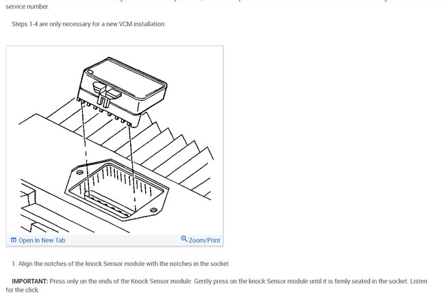

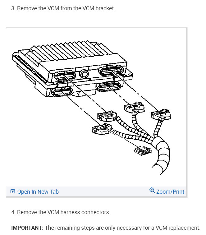

Okay, did you replace the coil control module?
Sep 28, 2023 at 3:06 AM
AYME
  • 15 POSTS
Yes, changed ICM. had spark last night. now we don't have spark. Driving us crazy!! WTH. We have a truck that uses the same coil and ICM. We swapped them out and they work on the truck. The ICM was bad so changed that. Both worked on truck. Put them on the Suburban. Had spark. now no spark. Gremlins, lol.
Sep 28, 2023 at 3:35 AM
AYME
  • 15 POSTS
We took them off and checked them again and they both work on truck. Still no spark when put back on Suburban.
Sep 28, 2023 at 3:36 AM
  • 55,399 POSTS

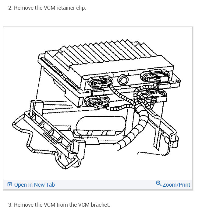

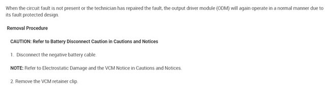

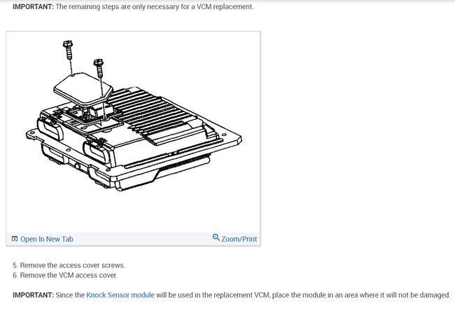

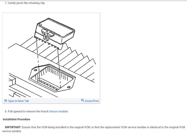

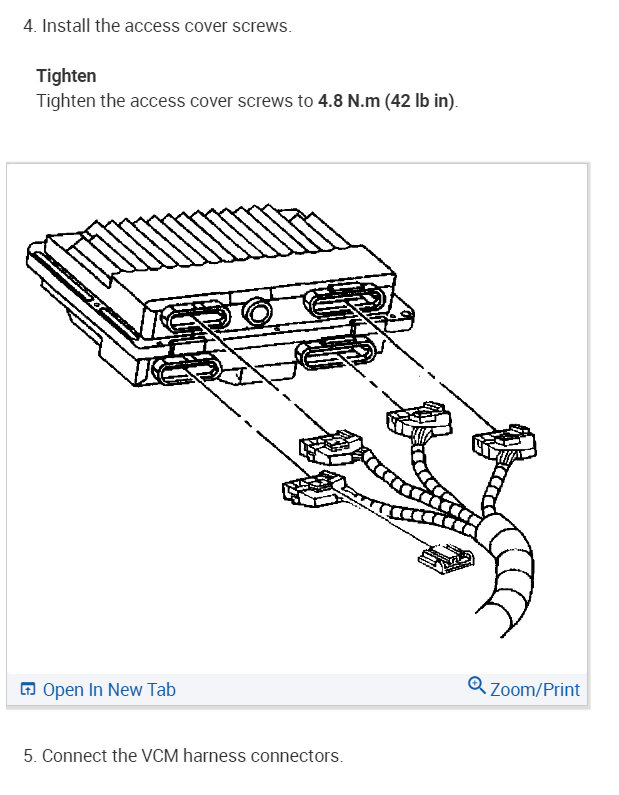

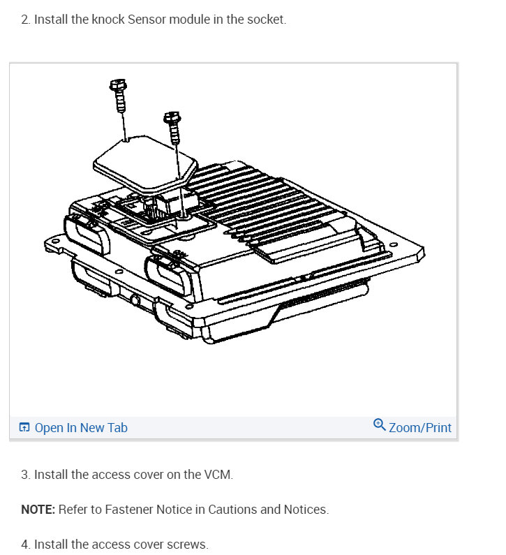

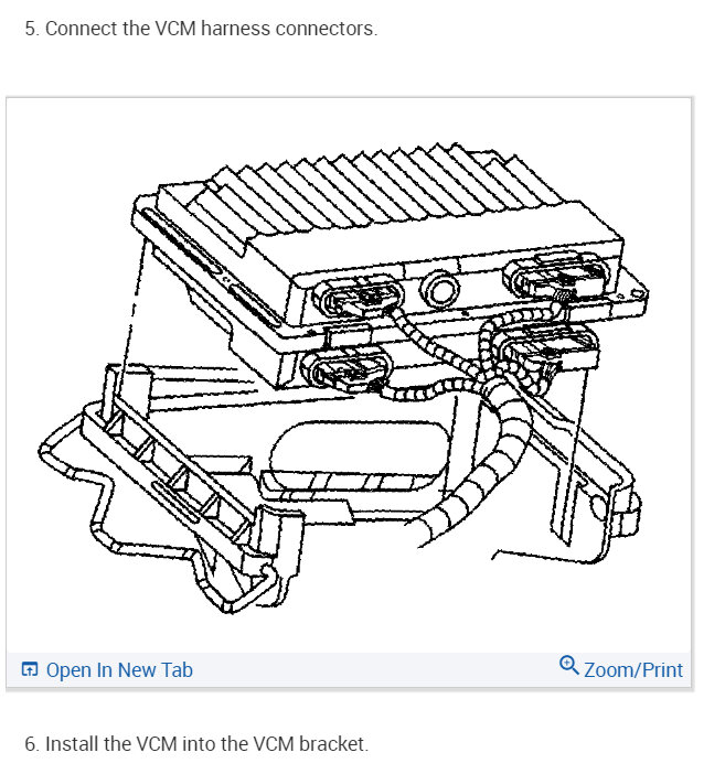

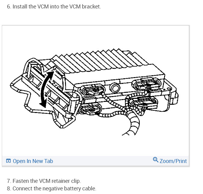

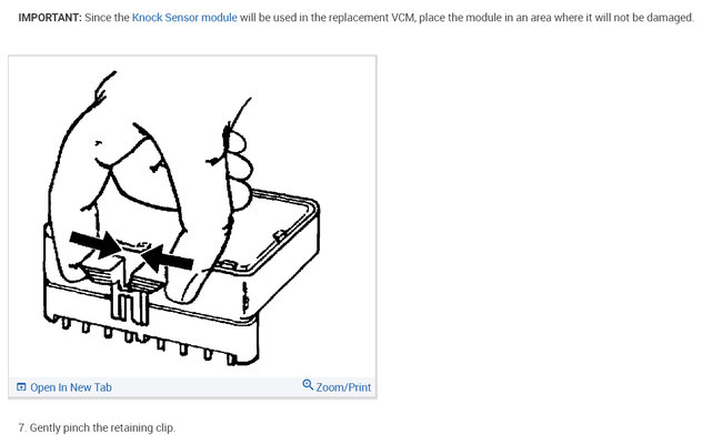

It sounds like the PCM is bad, if you are getting no pulse at the coil and the PCM is seeing RPM the ignition driver inside the PCM is bad. here is how to change the unit out or send it in for testing. You can get a preprogrammed unit by searching Google or Ebay. Check out the images (below). Please let us know what happens.
