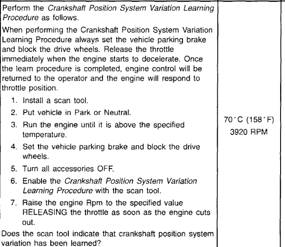

The relearn is called a variation relearn. It does require a scan tool to activate the relearn. It won't reset by driving. See pic 1 below
