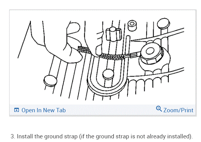

Have you checked the ground between the ignition control module and engine? It is under the top cover. See pic 1.
Let me know. Also, let me know if it is only spark that has been lost. Also, has the ignition control module been replaced?
See pic below.

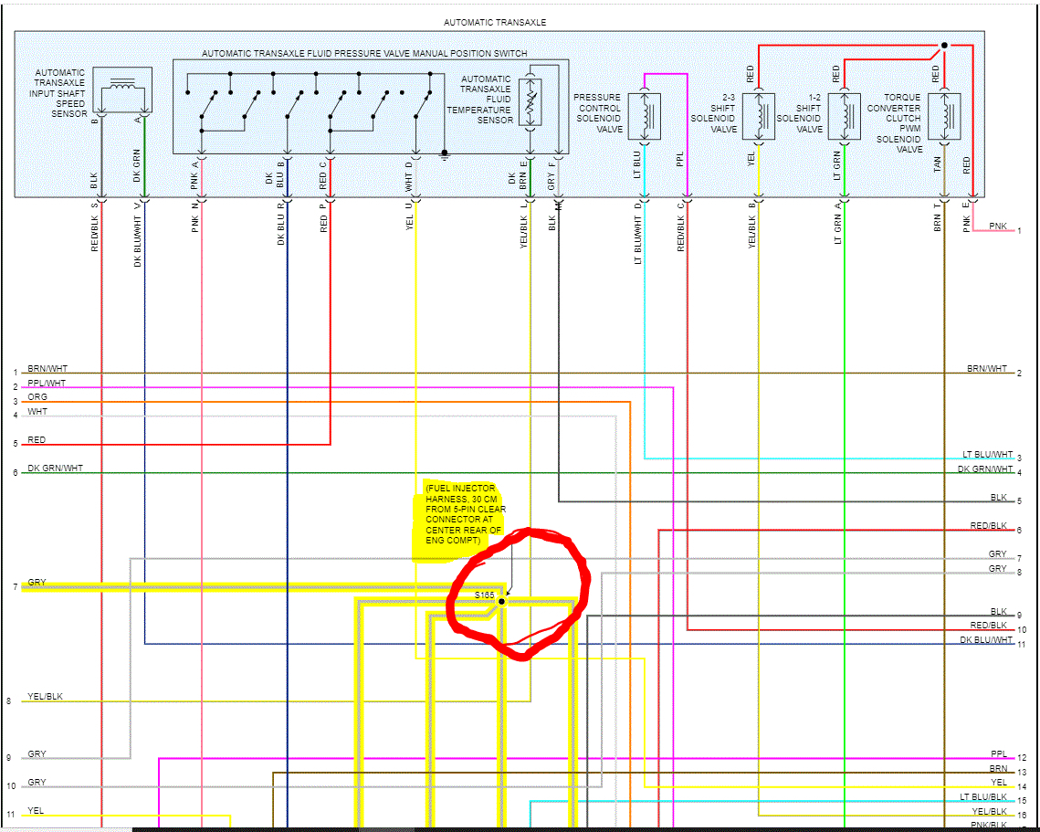

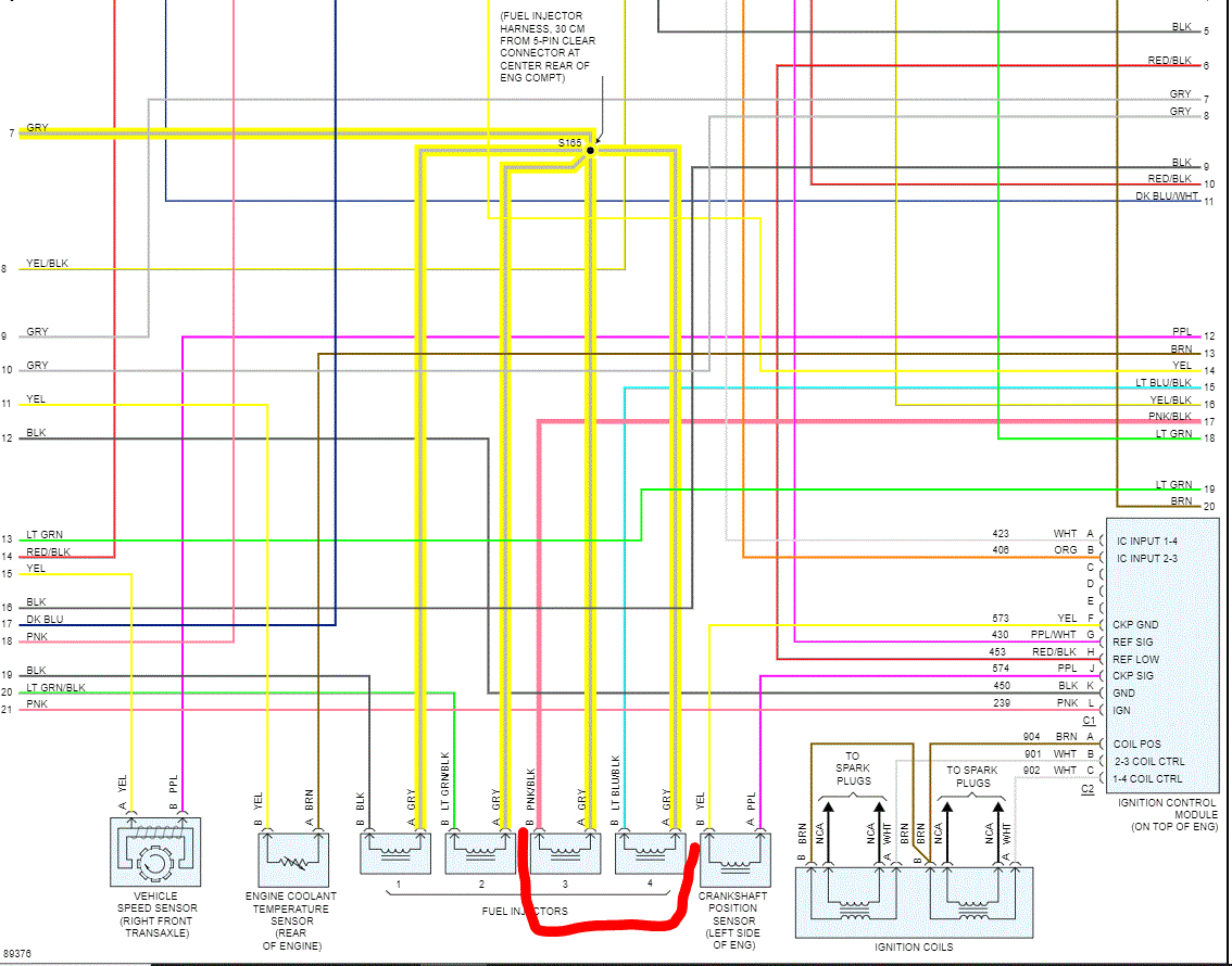

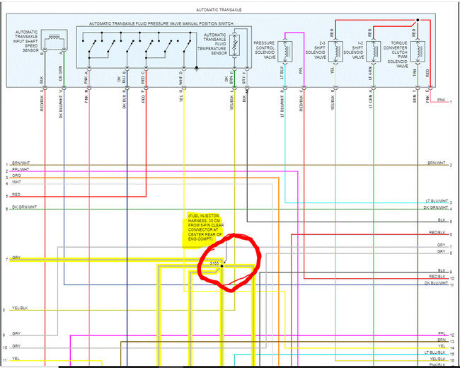

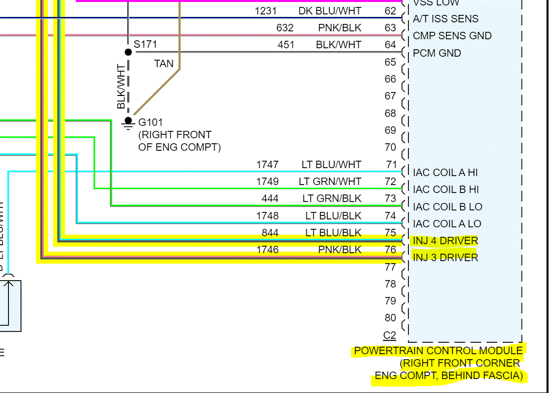

Each of the fuel injectors has a gray wire to it. That is the power supply and should have 12v at all times with the key on. Confirm it is a power issue first. It won't be a fuse or relay issue because all 4 injectors get power from the same place.
If you look below, I attached a portion of the wiring schematic and see where a problem can be if injectors 3 and 4 have no power but 1 and 2 do. There is a point where all four gray power wires are spliced. It is near the rear of the engine.
Take a look at the pics I attached, specifically pic 1. (I had to cut the schematic in half to make it readable). Note the splice and its location. I have it circled in pic 1.
May 21, 2022 at 3:08 PM

You are correct. On the affected cylinders, both have a gray wire, but both also have another wire, one is Pink with a black tracer and the other is light blue with a black tracer.
Here is how it works. You have 12v to the gray wires at all times when starting or in the run position. You confirmed that is good. For the circuit to be completed, the PCM provides a ground path at a specific time and for a specific length of time. That completes the circuit and actuates the injector. So, if you have power and this happened to both cylinders at the same time, I suspect there is either a wiring issue, connection issue, or the PCM has failed.
The first thing I need you to check is if there is a ground path being provided by the PCM. A Noid light can be used to confirm this or even a test light. Here is a link that explains how to test:
https://www.2carpros.com/articles/how-to-test-a-fuel-injector
Since we know we have power, if you use a test light, disconnect the connector on the injector, identify the pink/black first and place the test light on that pin and the opposite side on the battery positive. Have a helper crank the engine. When the PCM provides the ground path, it should light. It should actually strobe on and off while cranking.
If the light doesn't strobe, here is what I need you to do. Disconnect the negative battery terminal and wait for approximately 10 minutes.
Next, locate the PCM which is on the passenger side front of the engine compartment. There will be two connectors. Disconnect the black one. The other one is blue and not relevant.

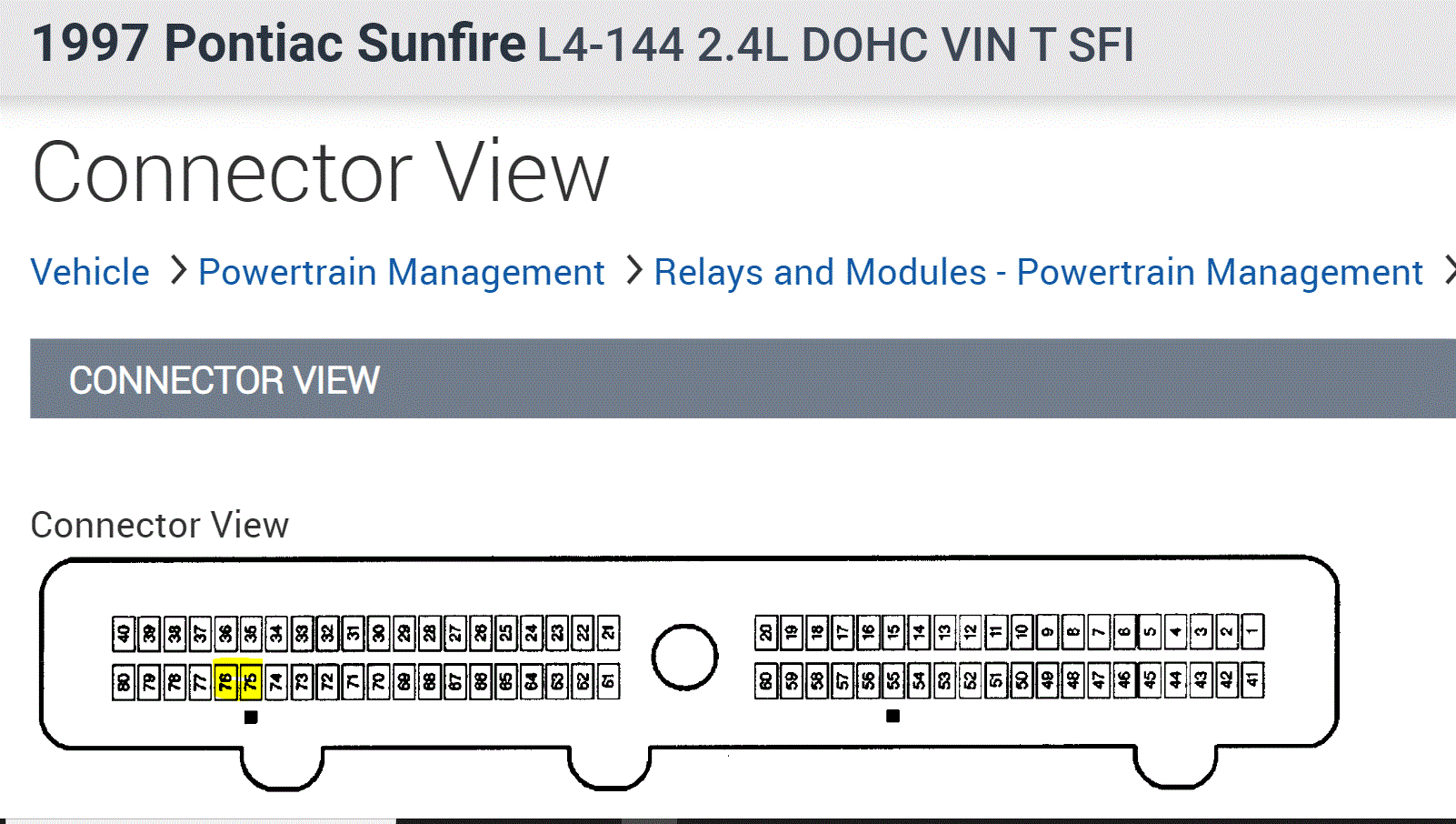

Next disconnect the injectors (cylinder 3 and 4). Using a multimeter or voltmeter, confirm there is continuity between the injector connector and the PCM connector. At the connector, locate pins 75 and 76 (see pic 2) using pic 1, identify the wire color at the injector and which pin it goes to in the connector.
If there is continuity, confirm there is no corrosion or damage at the PCM connector. The pins can break from corrosion or actually short together. Since these two are side by side, I have a feeling there is an issue with the connector, but we need to check.
If the connectors are good, the wiring is good, and there is no evidence of damage, suspect the PCM has failed. You could place a Noid light on the injector connector to see if it pulses on and off to confirm. If it doesn't, the PCM is my primary suspect.
Let me know if this helps or if you have questions.
See pics below. Note: We need to get it running. It's worth more that way. LOL

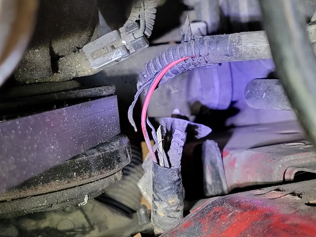

I haven't been able to get the PCM out or disconnected. I did find this and 4 wires of the 5 were broken. Some harness that plugs into the radiator and overflow tank. I used a speaker wire to try and reconnect each one. No luck.

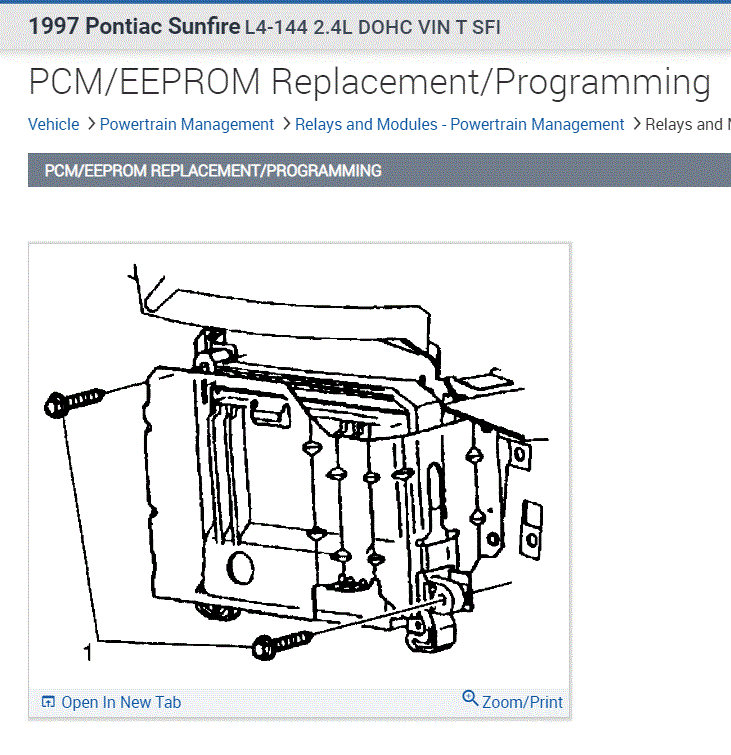

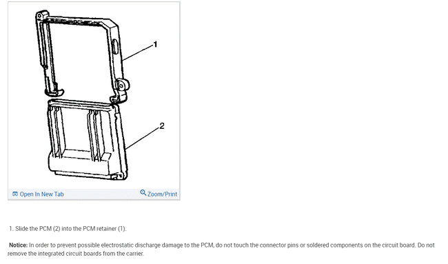

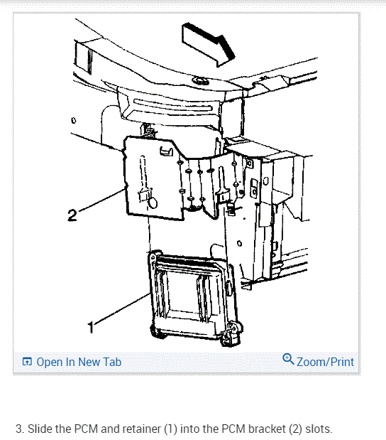

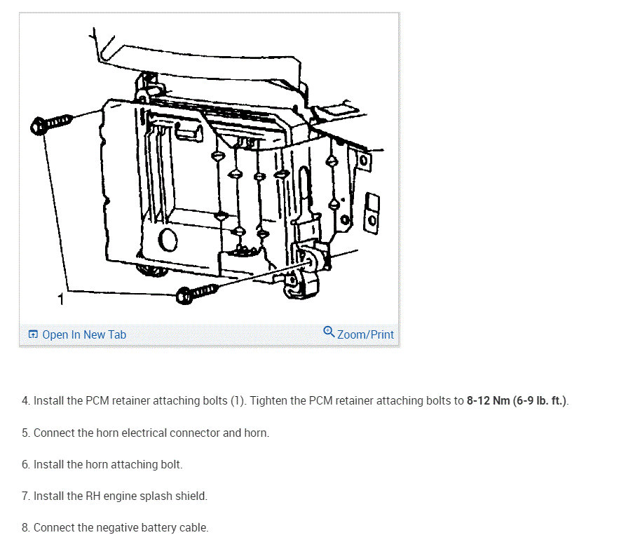

  • 110,240 POSTS

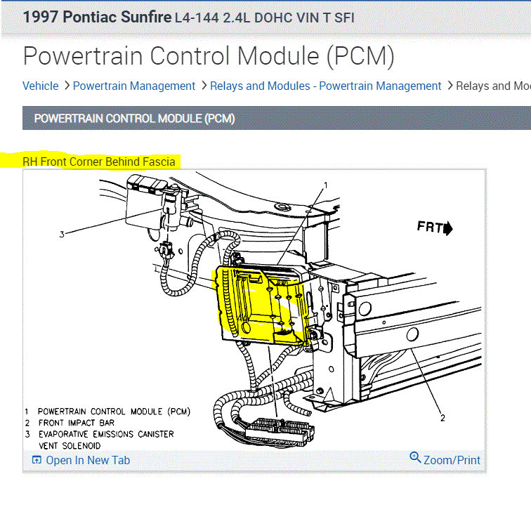

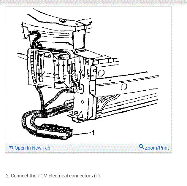

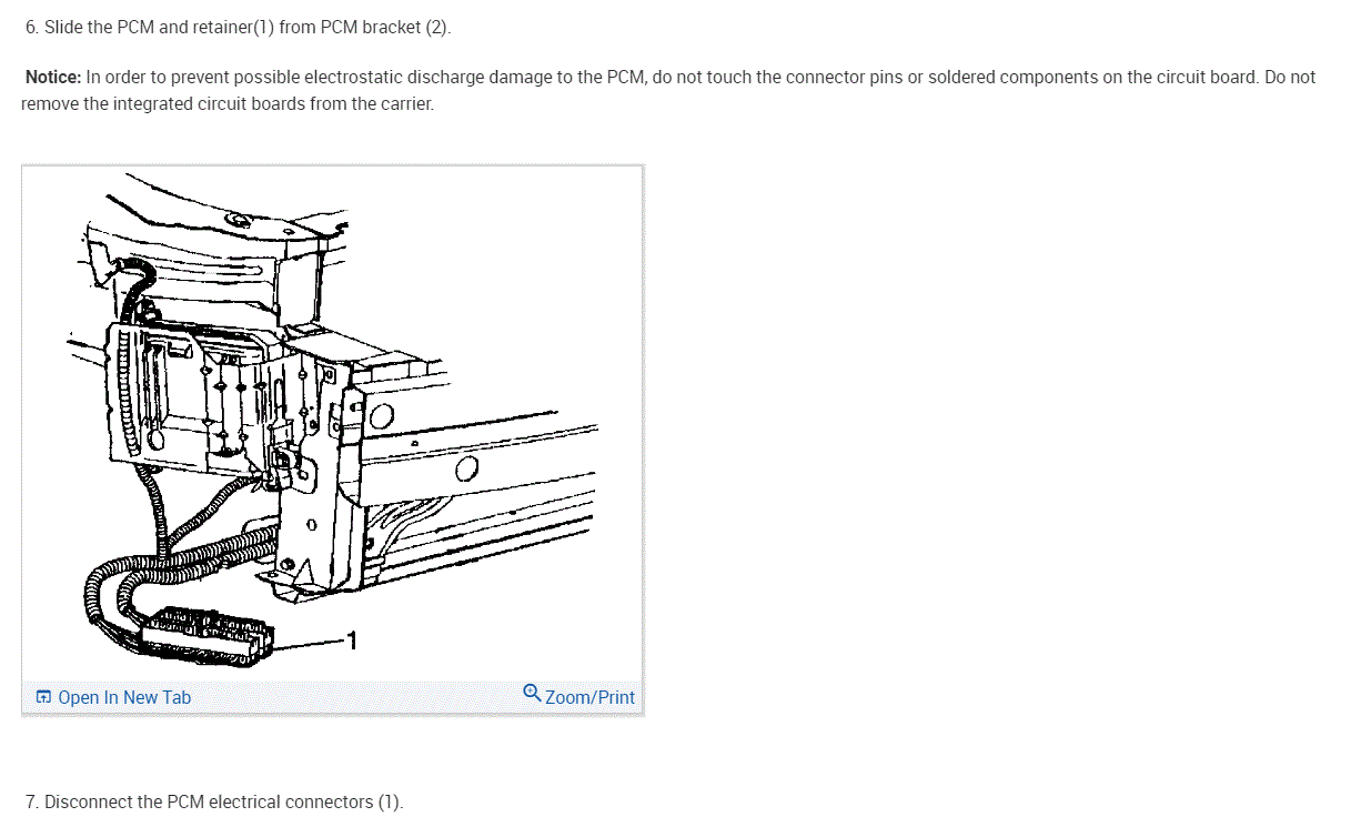

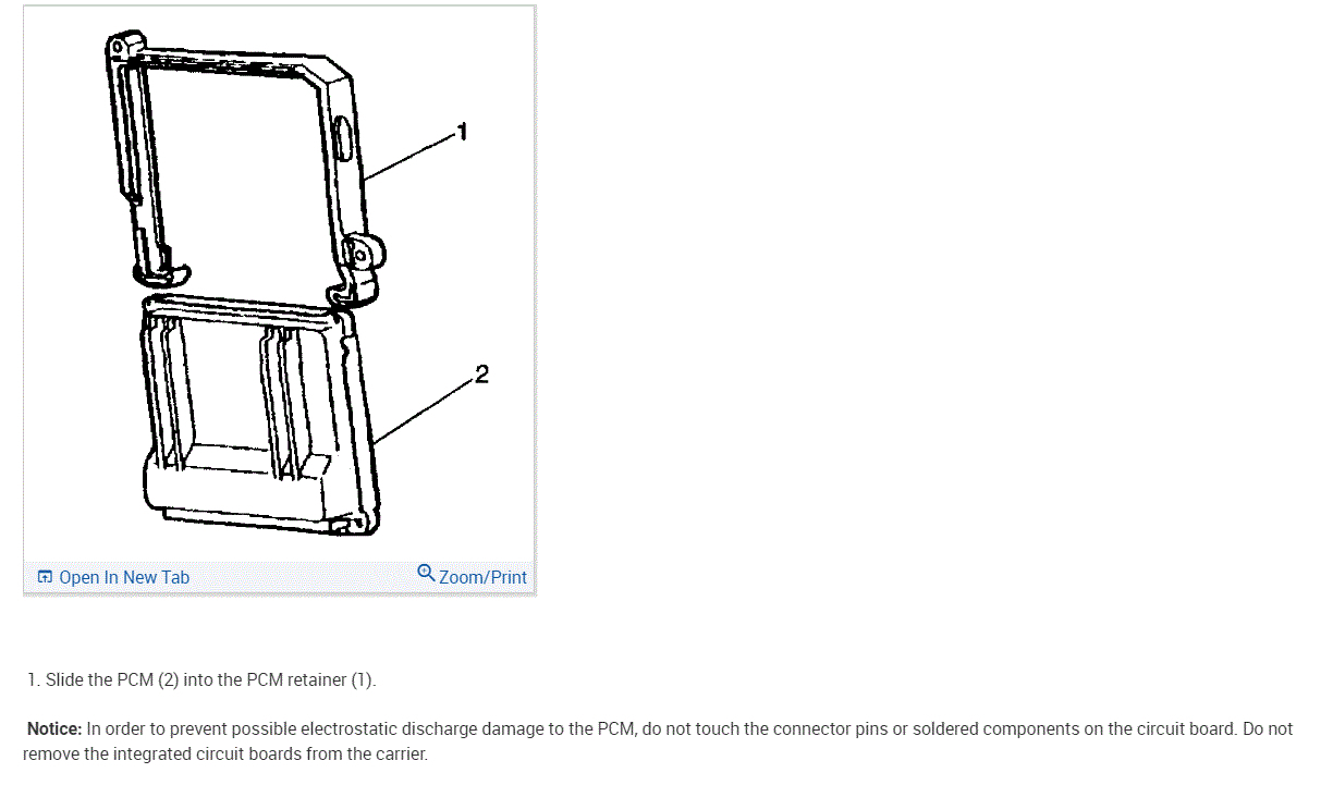

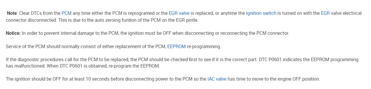

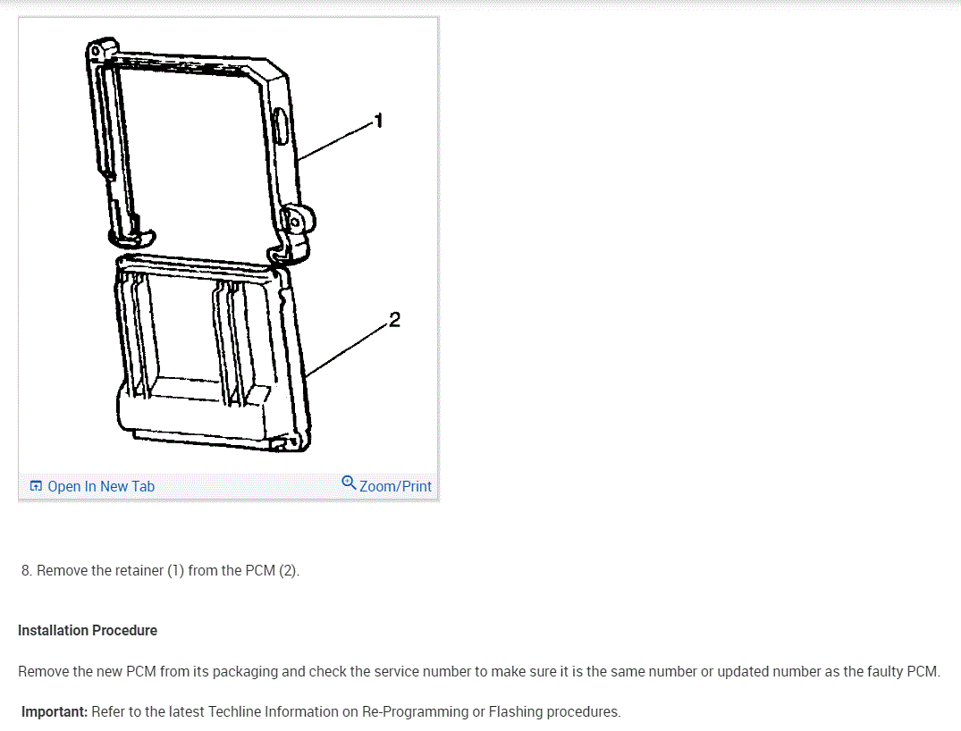

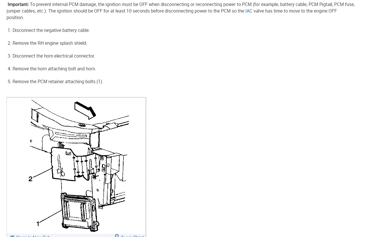

Those must be related to the cooling fan and level sensor. As far as the PCM, I attached the directions below for removal and replacement. Since you are only testing, the relearn shouldn't be required.
I have a feeling the connector is causing the issue or the PCM itself has failed.
If you change your mind, let me know. You can get remanufactured PCM's for a good price and they come plug and play based on your VIN number.
See pics below. The last pic shows the location. It is behind the front bumper.
Jun 1, 2022 at 1:59 PM

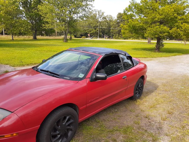

MATHEWCAR30
  • 15 POSTS
The car listed above is a convertible. Red. Needs new top brackets and top itself. Plus has some issue involving the above-mentioned. I have replaced more than even mentioned in this whole ordeal. This car is for Sale. This Vehicle is located near Searcy Arkansas.

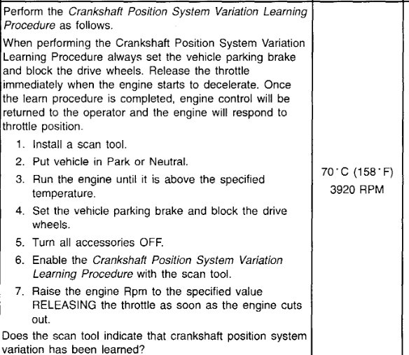

The relearn is called a variation relearn. It does require a scan tool to activate the relearn. It won't reset by driving. See pic 1 below
