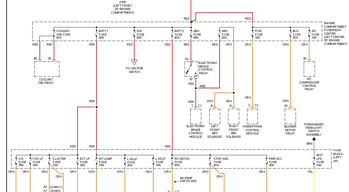

I bought this car as a project, boy what is this a project.
Battery was empty, charged it few times. -Ok.
Cleared memory of instrument cluster with EVO diagnose device.
Theft telltale stays on while cranking, tried resetting but light does not blink or go out after 12 mins.
Have no fuel deliverance and no spark. Something tells me it still is the Theft system but can't come any further.
Car is a 2.2L A/T.

Checked all voltages in fusebox under hood, they were fine, checked all under dash and I got 1.75V on: Turn-BU, ERLS, Alarm, PCM/IGN, IGN, F/P-INJ, AIRBAG.
These are the front 2 rows from bottom up. Had a look and seems like the entire dash has to be removed if you want to check out the cables behind the fusebox?
Anyone got a common diagnostic or where this cable leads in positive side? Directly from fusebox under hood?
And for the reply from Hmac300, checked live data with OBDII-scanner and gives VTD 99 with ign. On, not running. And 255 while cranking.

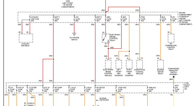

Neither one of those codes match anything it should be like a p0255 but there isn't one and nothing with a vtd it has to be a p-b-or c code. Hiere is pic for power supply for I/p fuse box.
Sunday, October 27th, 2013 AT 4:01 PM

Thnx for the Pic, will see into it on weekend.
