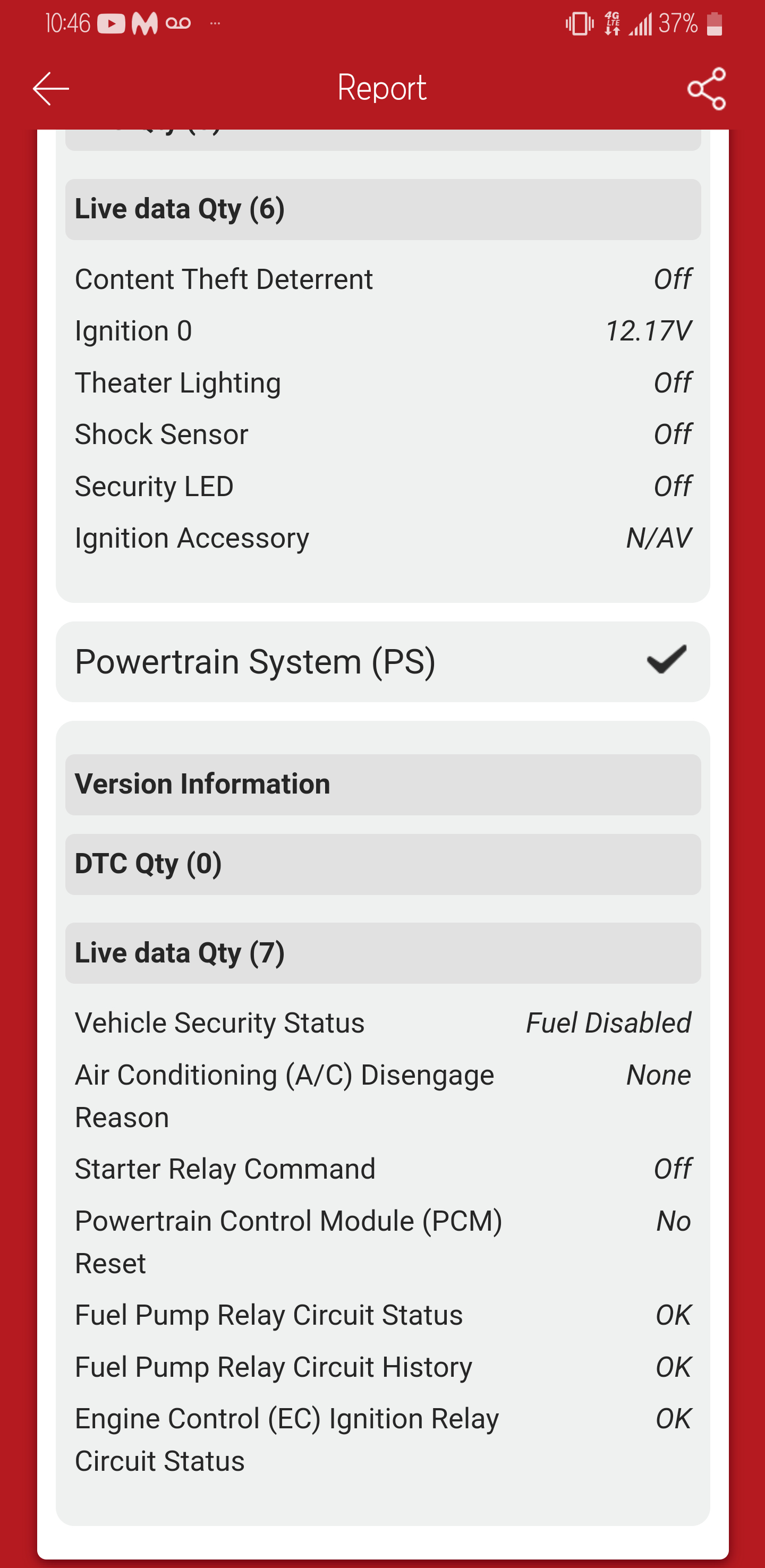

Nope, the security light does not flash when I try to crank it. However, I posted a picture of the last time I did a scan on it. It said security system, fuel disabled. Hold up I'll attach it. This is after changing the PCM. The same issue. Apparently, it isn't the PCM. I did the key relearn properly and the security light doesn't come on when I cycle the key. But it still doesn't power the fuel pump, this picture kind of explains it.

If you jump the power terminals at the relay does the pump run?

Haven't tried jumping the terminals however, if the security isn't powering the fuel system then that's the issue right? I've changed the relay, fuse (fuel pump) and the actual fuel pump itself. Still no power, but I'll try that. Will it make a difference though?

If you have power at the relay, by jumping them, the pump should run. You are bypassing the relay in this case and simply sending power direct to the pump.

Okay, to further update, I've spoken to GM about the issue. The lady was very nice by the way. She spoke to a tech about my issue and they believe it is the transponder chip in my key that is causing this. After reading up on the PK3 and the keys, I believe this is the issue. It says that the key sends the password to the bcm. The BCM then sends the clearance to the PCM and the PCM gives the signal to the fuel pump relay. If there is an issue with the key the bcm will tell the PCM to not start the fuel system. I saw something about fuel enable, I forget at times (it's the ADHD). It could also be the bcm as well. I'll start with the keys first just to make sure that's the issue. I wonder if I can open my key just to make sure it didn't get dirty or some sort of liquid in it. So yeah I'm ordering new keys and will have them cut. Then I might go to the dealer to get them programmed if I can't do it myself.

If it is the security system, then if you leave the key in the on position for about 10 minutes, the security light should turn off and the car should start.
As far as the key, there really isn't anything in it that should cause the vehicle not to recognize it. Also, if you do get a new key, as long as you have the original key, you can program it at home. Here are the directions:

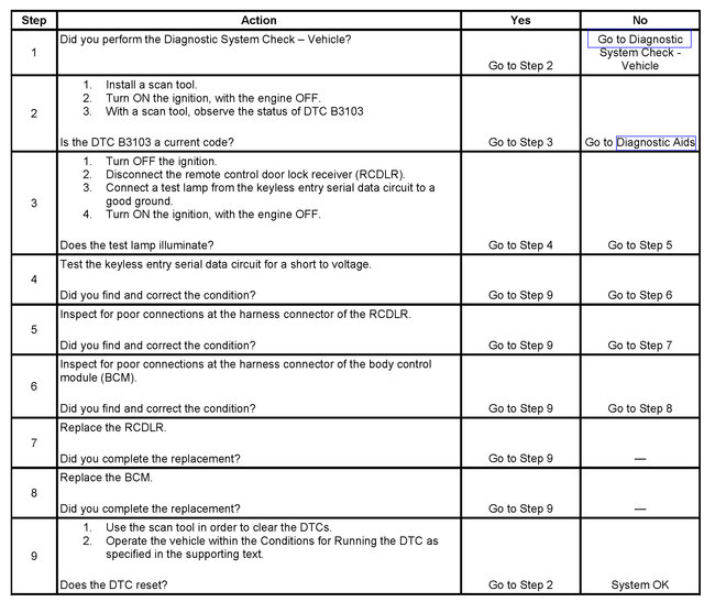

Also, did I mention that I had a code for B3103? Key-less Entry Data link circuit high. It's plugged in but it's only 4 wires coming to it. The replacement connectors I see online have like 6 wires. Plus only three wires are connected. Haven't checked them to see if they have power. The security light is also missing from the dashboard. There is no light or connector, only wires.

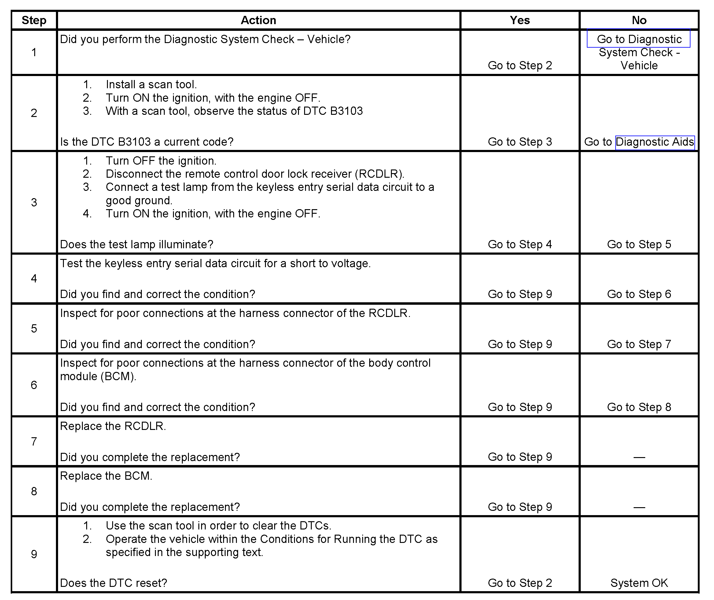

The codes indicates a short to power. Take a look through this information and diagnostic procedure and let me know if it helps. The attached pic is the diagnostics.

See pic 1
The numbers below refers to the step numbers on the diagnostic table.
3. B+ voltage should be present on the serial data terminal when tested with a DMM, but should not illuminate the test lamp. An illuminated test lamp indicates a short to voltage in the serial data circuit.
4. This step checks for a short to voltage in the key-less entry serial data circuit.
