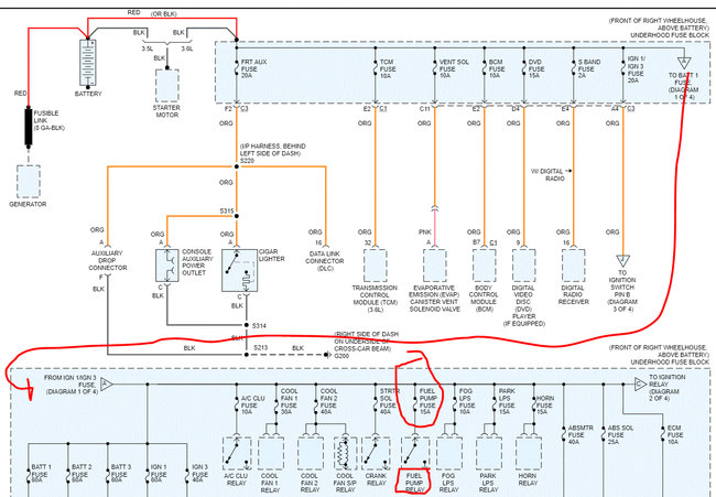

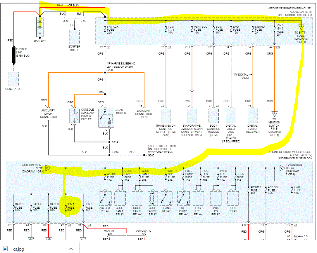

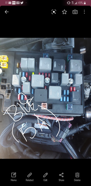

Well, I lost power to my fuel pump about a week ago. After buying a brand new one, putting it in, still not starting. No power to the pump. Now after putting the battery back in (I share the battery with my other car), I have no lights along with not starting.. I changed the fuse and relay before changing the pump. Then I got a test light. Test light tells me that, at the body harness under the driver's seat, that I got no live wires going to the pump..also, no power to the fuse box where the relay goes.I checked other spots and got the test light to light up. Fuel pump, no good. With the key off and with it on.someone please help. I'm new at mechanic work, but willing to do the work.
Jun 6, 2020 at 2:43 PM
  • 110,244 POSTS

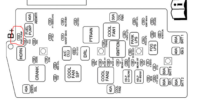

When you say there is no power to the fuel pump relay, is there power to the fuse which supplies it? See pic 1. If not, let me know if any of the fuses in pic 2 have power.
Jun 6, 2020 at 5:10 PM
TPMPRODUCTIONS
  • 86 POSTS
Yes the fuel pump fuse has power. Or I mean, it lights up when I put the test light to it.
Jun 9, 2020 at 12:40 PM
TPMPRODUCTIONS
  • 86 POSTS
I got power to all the other fuses, just not that one. The fuel pump relay has no power. I was just on another site (which I will not name) that makes you pay for their "experts" and the gentleman told me I needed a new fuse box. Needless to say after I replaced the fuse box (today) I'm having the same problem. I'm sure it's something that I don't know about, like a connection that I'm not thinking of...
Jun 9, 2020 at 12:51 PM
  • 110,244 POSTS

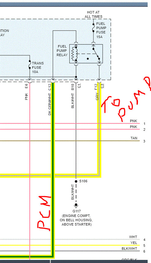

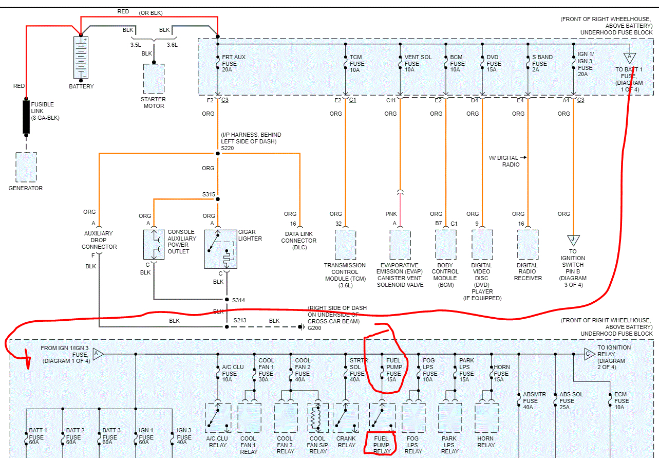

No, you're not missing anything. Take a look at the pic below. I need to confirm that there is power to the fuse indicated. Next, the dark green wire with a white tracer is from the PCM. That is what energizes the relay to power the pump. You need to check if it is getting power. If it is, last is the gray wire that sends power to the pump. Check it for power.

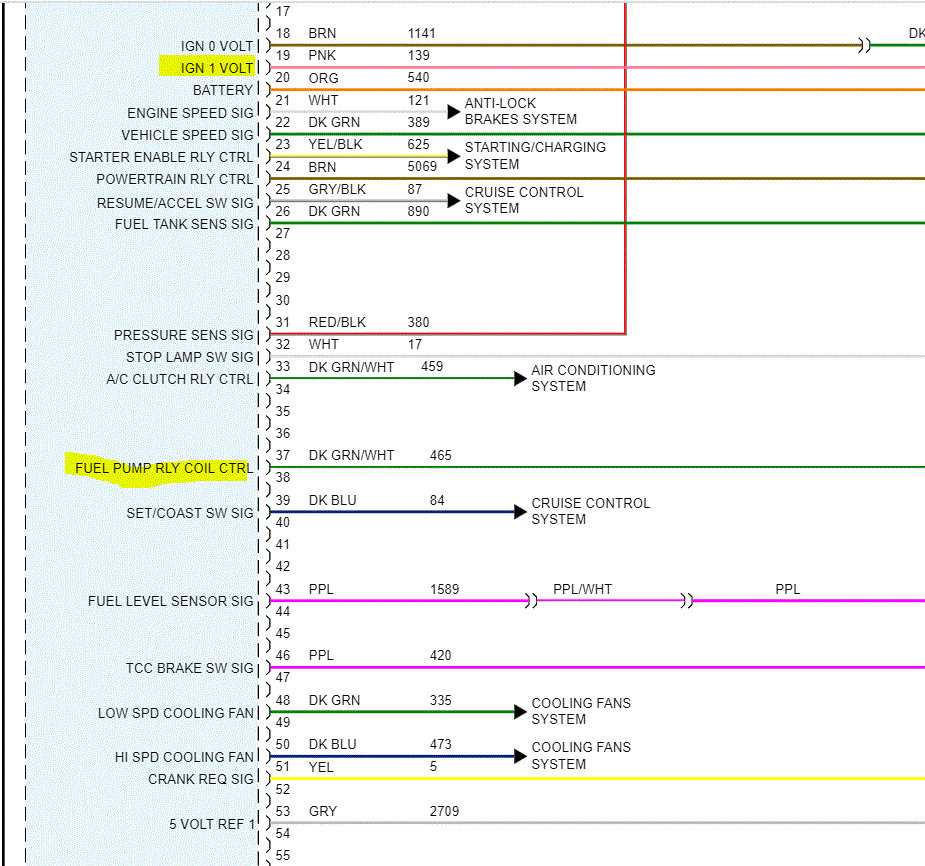

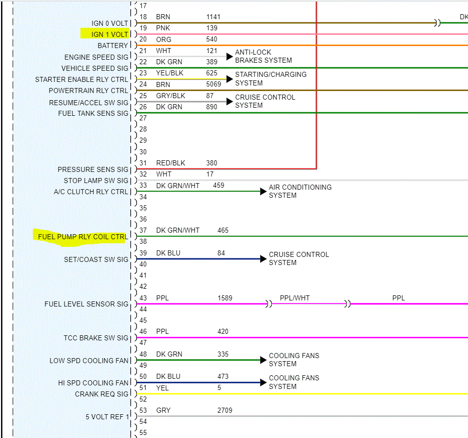

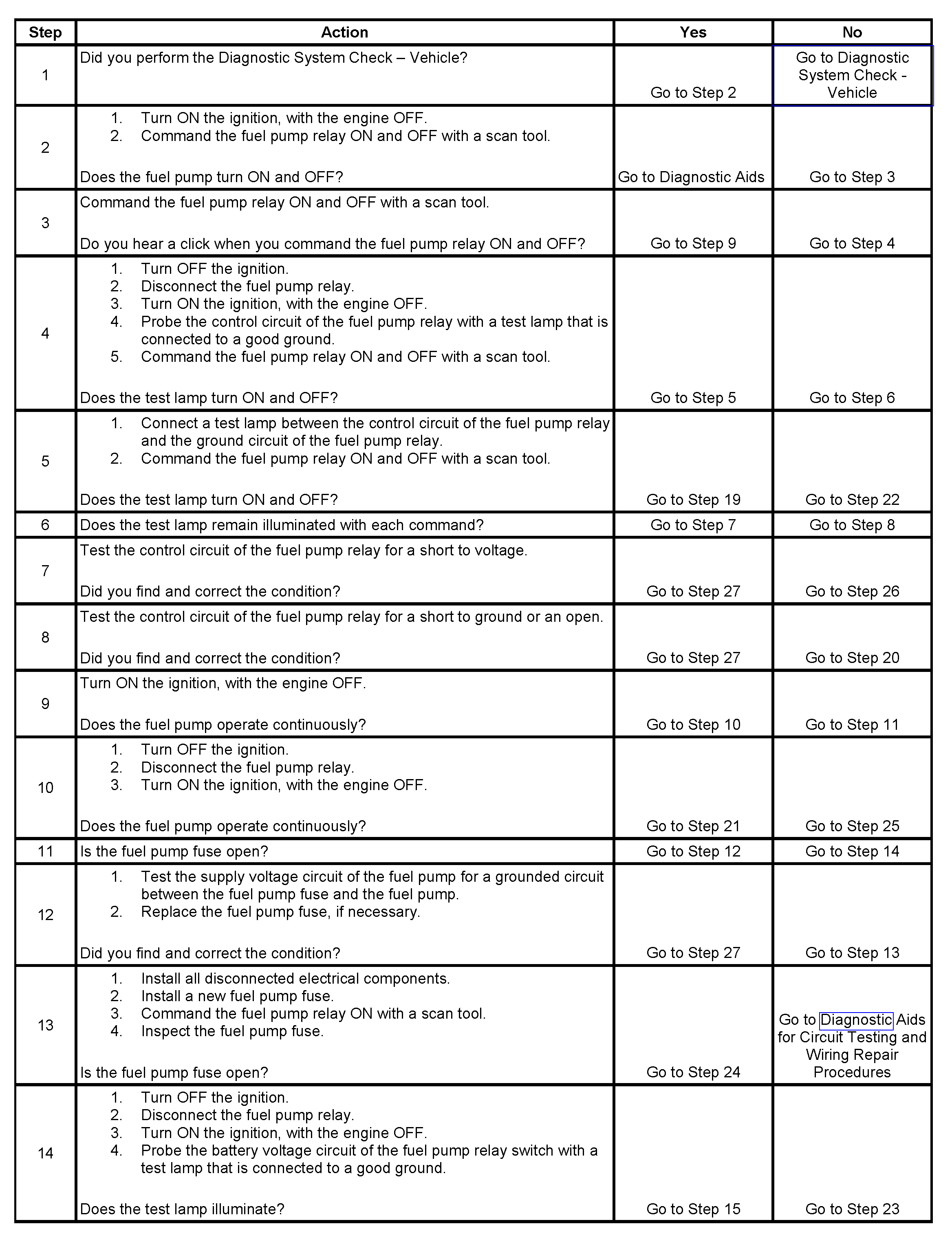

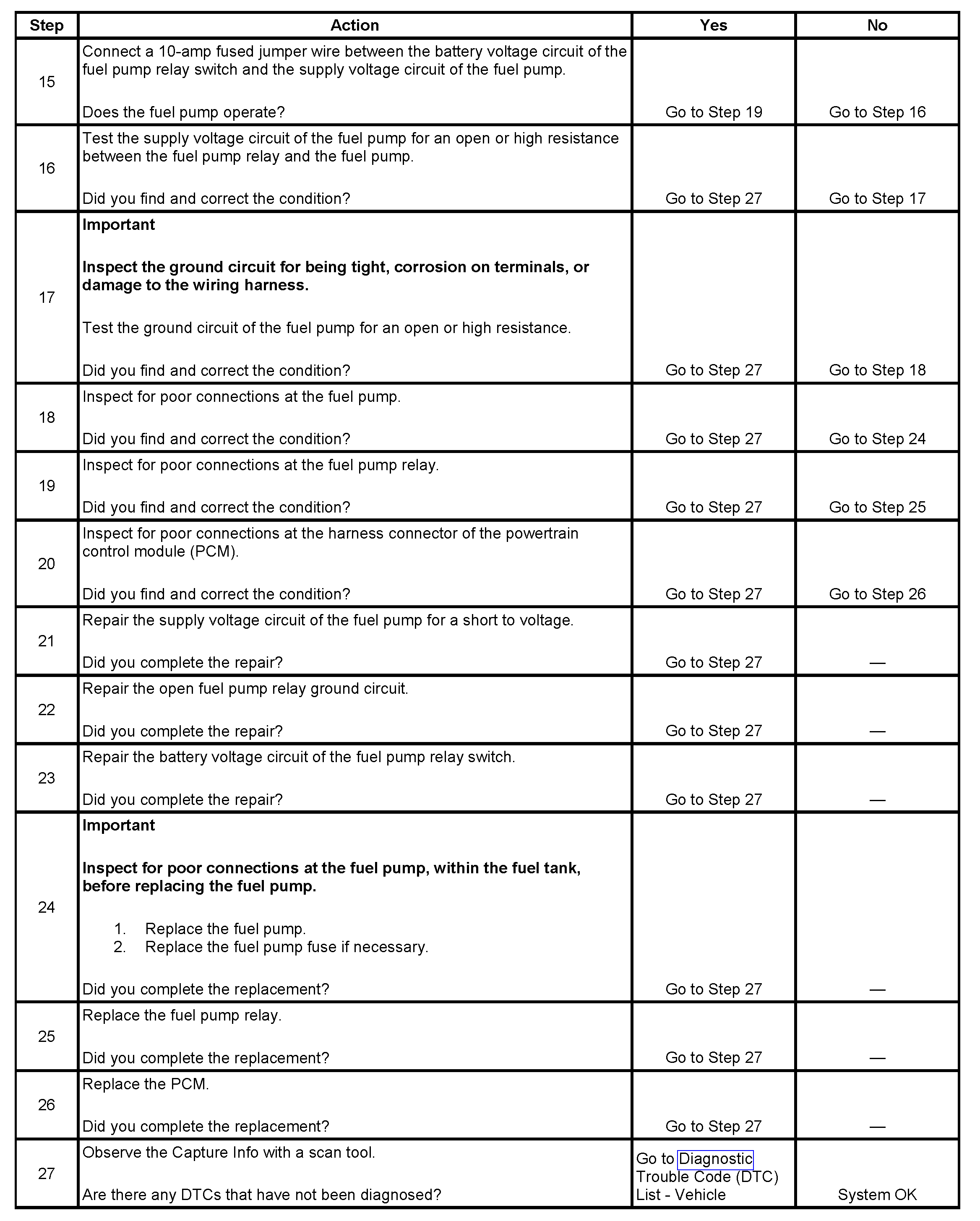

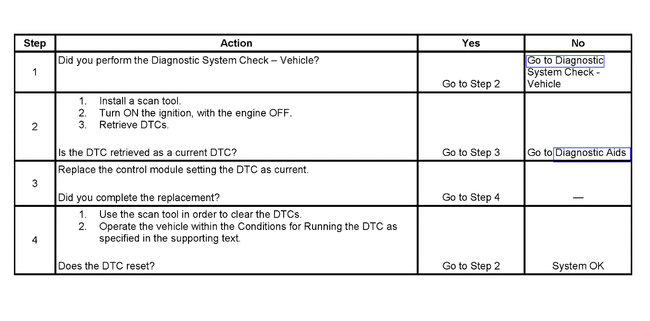

Next, here is a diagnostic flow chart for diagnosing electrical issues related to the fuel pump. Pictures 2 and 3 are the actual steps. I don't know if you are comfortable doing this, but I wanted to add it.
___________________________
2006 Buick Truck Rendezvous FWD V6-3.5L VIN L
Fuel Pump Electrical Circuit Diagnosis
Vehicle Powertrain Management Fuel Delivery and Air Induction Fuel Pump Testing and Inspection Component Tests and General Diagnostics Fuel Pump Electrical Circuit Diagnosis
FUEL PUMP ELECTRICAL CIRCUIT DIAGNOSIS
CIRCUIT DESCRIPTION
When the ignition is turned ON, the powertrain control module (PCM) turns ON the fuel pump relay, which turns ON the in-tank fuel pump. The in-tank fuel pump remains ON as long as the engine is cranking or running and the PCM is receiving reference pulses. If there are no reference pulses, the PCM turns the in-tank fuel pump OFF 2 seconds after the ignition is turned ON or 2 seconds after the PCM no longer receives reference pulses.
DIAGNOSTIC AIDS
- Inspect the ground connection for the fuel pump. Ensure all ground connections are clean and tight.
- The following conditions may have caused the fuel pump fuse to open:
- The fuse is faulty.
- There is an intermittent short in the fuel pump power feed circuit.
- The fuel pump has an intermittent internal problem.
- For an intermittent condition, refer to Testing for Intermittent Conditions and Poor Connections. See: Vehicle > Component Tests and General Diagnostics
TEST DESCRIPTION
Step 1 - Step 14
See pic 2
Step 15 - Step 27
See pic 3
The numbers below refer to the step numbers on the diagnostic table.
3. This step determines if the condition is located on the coil side or the switch side of the circuit.
4. This step verifies that the PCM is providing voltage to the fuel pump relay.
5. This step tests for an open in the ground circuit to the fuel pump relay.
6. This step determines if a voltage is constantly being applied to the fuel pump relay.
13. This step determines if the condition with the circuit is intermittent. If the fuse does not open, inspect the supply voltage circuit between the fuse and the fuel pump for an intermittent condition.

Getting ready to work on my car. can I use the test light to probe the (green) wire for the PCM to see if it gets power or do I have to check at the end? I'm new to this mechanic thing but I'm learning.
Jun 10, 2020 at 8:59 AM
  • 110,244 POSTS
You can, but I believe it sends a 5v reference signal, so the light may be dim.
Jun 10, 2020 at 2:17 PM
TPMPRODUCTIONS
  • 86 POSTS
Okay, so no power to the PCM.

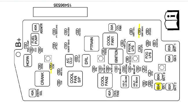

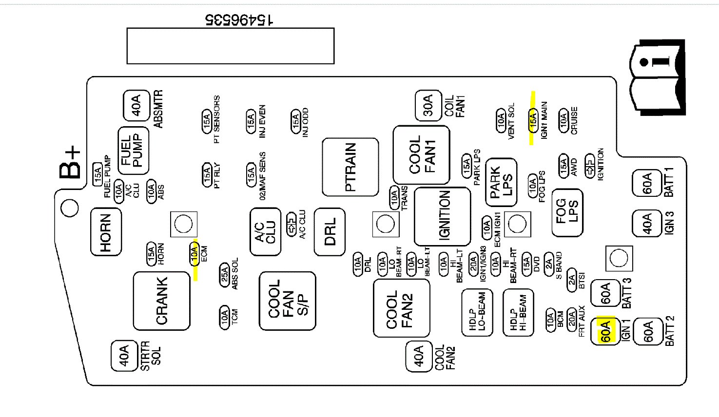

Is it the under hood fuse box that was replaced? Are the three fuses in the attached pic good and have power to them?
Let me know. If they are not getting power and you replaced the fuse box, it doesn't make sense. Is the replacement fuse box new or used?

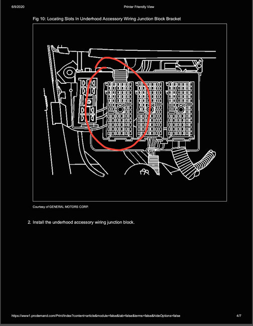

Okay, if the fuses are good, I need you to check power to pin 19 in the harness to the PCM. See attached pic. If there is power there, connect the PCM and check for power out from pin 37. If there is no power, then it's related to the PCM. If there is no power to pin 19, you have an open circuit between the ignition 1 fuse and the PCM.
Jun 14, 2020 at 9:15 AM
TPMPRODUCTIONS
  • 86 POSTS
Okay, so let's go back a little bit. Something didn't sit right with me about the fuses I checked the other night so I brought my shop light with me and it turns out I checked the wrong fuse when you asked me to check the ignition fuse and relay. Turns out, I have no power to the ignition main fuse.
Jun 14, 2020 at 2:27 PM
  • 110,244 POSTS
If you aren't getting power to the 60 amp ignition fuse, something is wrong with the fuse box. The power comes direct from the battery into the box and then is fused (60 amp) to other things. So, power is being lost between the battery and the fuse. Take a look at the pic I attached. It shows one power supply from the battery introduces power to multiple fuses. The ignition 1, 60 amp fuse is one of them. Do the other fuses around the Ignition 1 fuse have power?

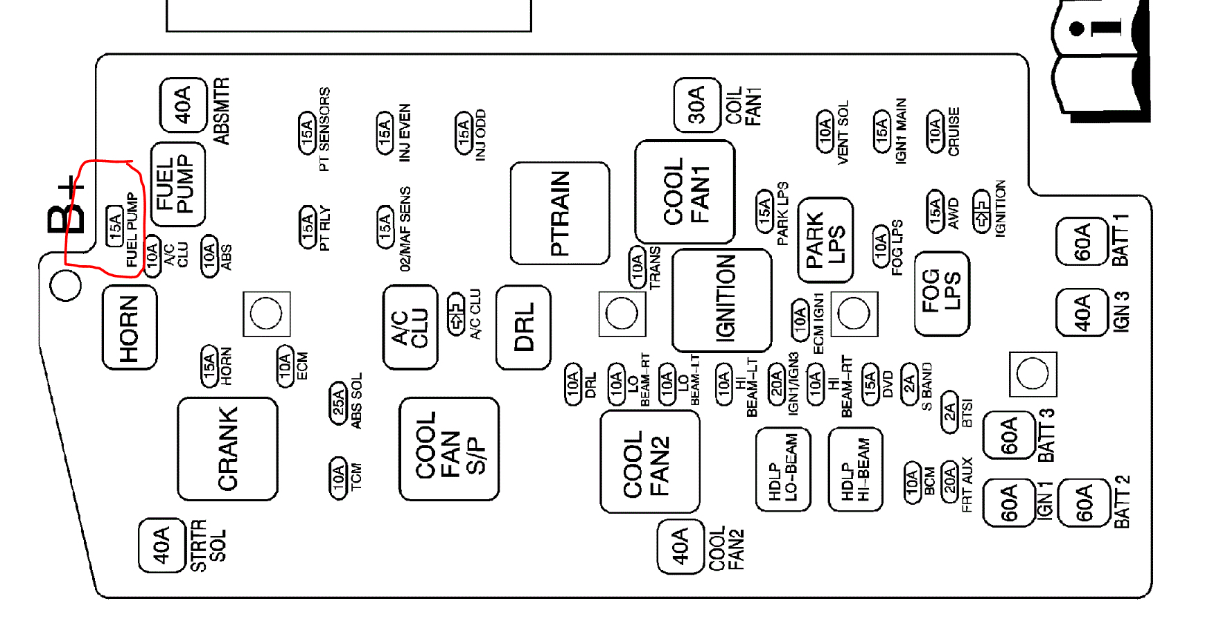

Sorry about that, I guess I said the wrong thing, I'm not getting power to the ignition fuse. The (15A) one. I have included the picture of my actual fuse box with the correct fuse that is not getting power. I hope that helps...
Jun 14, 2020 at 6:18 PM
  • 110,244 POSTS
The fuse box is shaped differently that what I show in the manual. However, if that fuse isn't getting power, are the ones around it?
I don't know if you ever replaced a breaker in the electrical box at your home, but the same principal applies. You have a steel power bar that always has power. When you put the breaker in the box, it contacts that bar and then you can control the power to different circuits in the house based on amperage. The same idea with the fuse box in the car. That box has a connector that has power from the battery at all times. The fuse takes the power from that supply and transfers it to another pin for a specific circuit. If the fuses near it have power, it should as well.
Let me know. I hope my analogy made sense. I'm really trying here. LOL
Jun 15, 2020 at 12:59 PM
TPMPRODUCTIONS
  • 86 POSTS
So are you trying to ask me to check the other fuses around it? So here's how I can answer your question: when I check my test light to see if I have a good ground I usually test the side of the fuse box (positive cable), and the three fuses (empty slots) next to the ignition, cruise, and vent. Not sure if you're asking to check to see if the harness is getting power or not? Wait. I just got it. I finally understand. Let me try this: are you asking if I'm getting power to connector C1? I've included a picture. So I got no power to 27 but I have power to 28. Hope that helps...
Jun 15, 2020 at 9:18 PM
  • 110,244 POSTS
Yep, you got it. Now this is what doesn't make sense. If you have power to 28 and not 27, there has to be either a pin pushed in, a wire not making contact, or the box is bad (which at this point doesn't make sense to me).

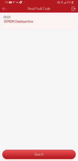

Okay, so I got a whole bunch of questions.. now I just got a new scanner today and got to use my new toy, it's called the ThinkDiag. pretty good scanner (even though I have no idea what these numbers mean. So I looked up my security status (because a mechanic suggested it might be security) and I got this...(picture included) help please!
Jul 3, 2020 at 12:43 PM
TPMPRODUCTIONS
  • 86 POSTS
I also have found this likely issue...
Jul 3, 2020 at 12:55 PM
  • 110,244 POSTS
The second code you provided indicates the PCM is bad. Take a look at the attached pic. It is the diagnostics for this code (B1009). I feel bad saying this, but contact the local Buick dealer and see if you can purchase just the eeprom. Either way, the eeprom or PCM will require programming.
I wish I had better news.
Let me know if you have other questions or if I can help.

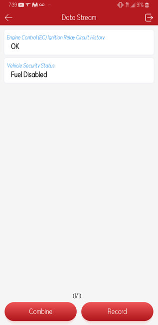

Okay. so, here's the deal:Changed the PCM lights come on now. Still no start. No fuel pump at all. Think diag says the fuel system is still disabled. There is an issue with my security system that I can't seem to fix. It's right under my nose.. there's a gentleman named Mike eyecanfixthat on YouTube that had a very interesting video on a 2006 Buick. He said the guy changed the PCM multiple times and has the same issue.. he hooked it up to a computer and now disabled the anti theft.. wondering how I can do that.
Jul 8, 2020 at 4:28 PM
  • 55,456 POSTS
When you crank the car over is the security light flashing? if so this guide will help you reset it:
