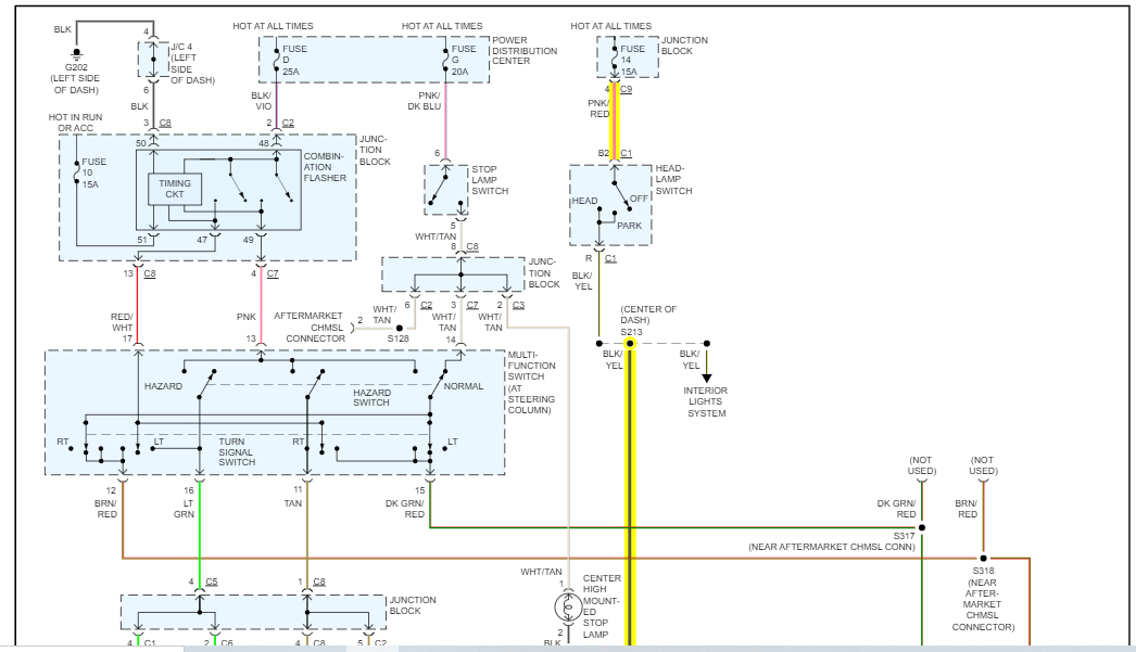

My parking light will not turn on when my headlight switch is on either on position however the lights will turn on if I fiddle the switch into the right spot just before it clicks into place, I have checked all the fuses and relays multiple times and they are all good, I also replaced ones that looked questionable. I also probed at the 2 wires for the circuit and with the switch off I get 12.28v through, and with the switch on the right point to turn the lights on, I get about 0.25v through, I also get another wire that gets power when the lights get turned on, and I am not sure if that wire should be getting power or not as my service manual does not tell me what wire is connected there, and what it leads to.

Everything you described points to the head light switch itself, especially when the lights do work when the switch is held in a certain position. That proves all the rest of the wiring and fuses have to be okay. The only exception would be if the running light circuit has a switch contact that is just barely sliding over a different 12-volt supply contact for a different circuit, but that would be really unlikely.
What we need to do is pull the switch out, then start by looking at the electrical connector to see if two terminals are black / overheated, and if the plastic connector body is melted around those terminals. If they are, the only proper repair is to replace the switch and those two terminals in the connector at the same time. If either the switch or the two terminals are not replaced, they will cause a repeat failure of the new part.

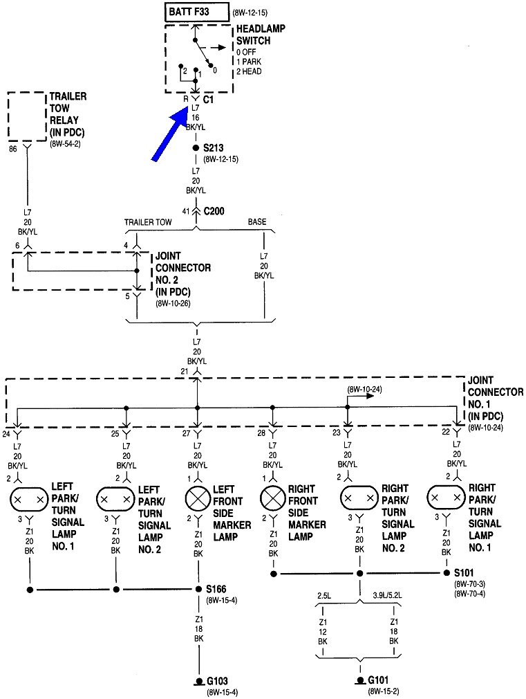

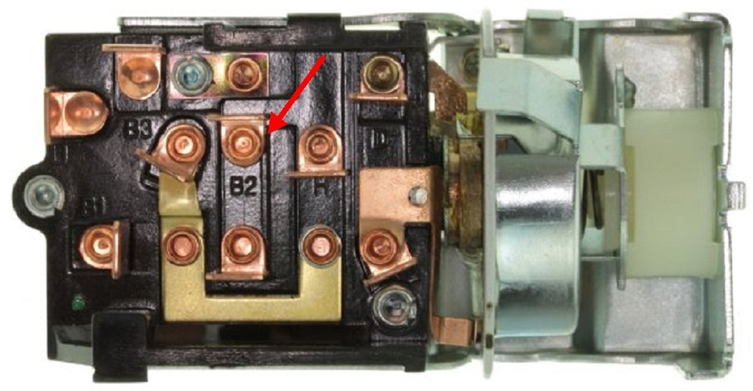

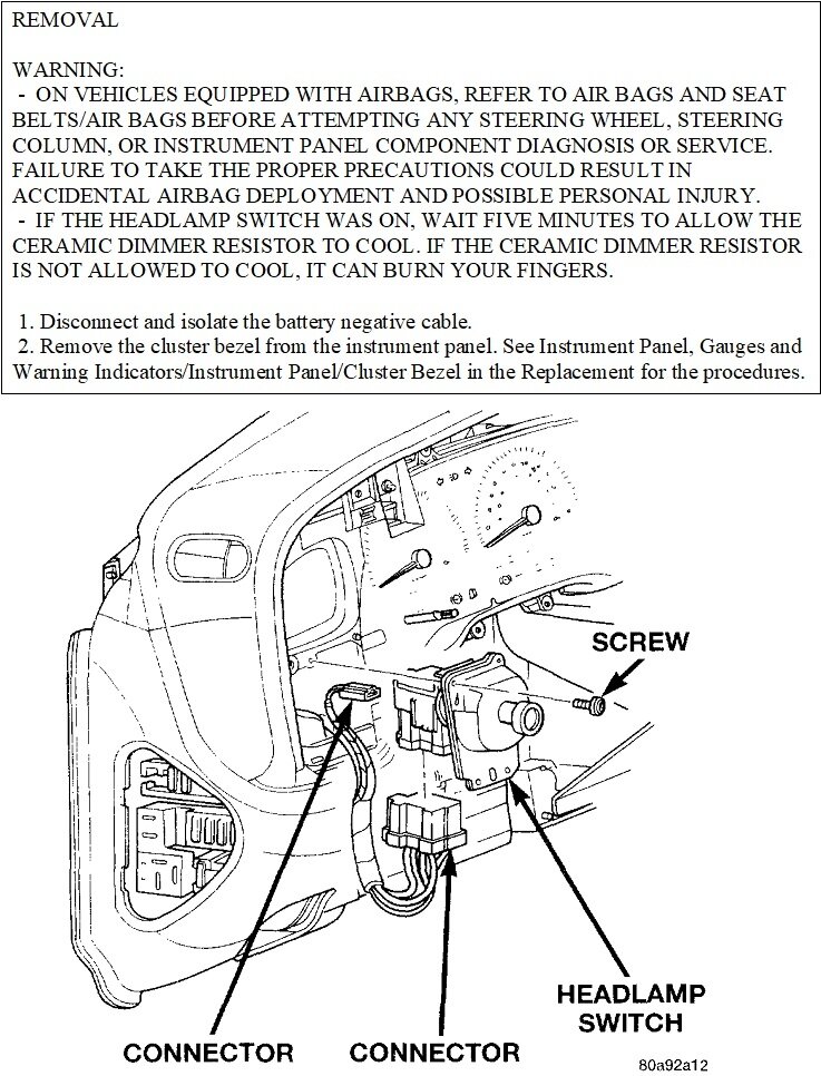

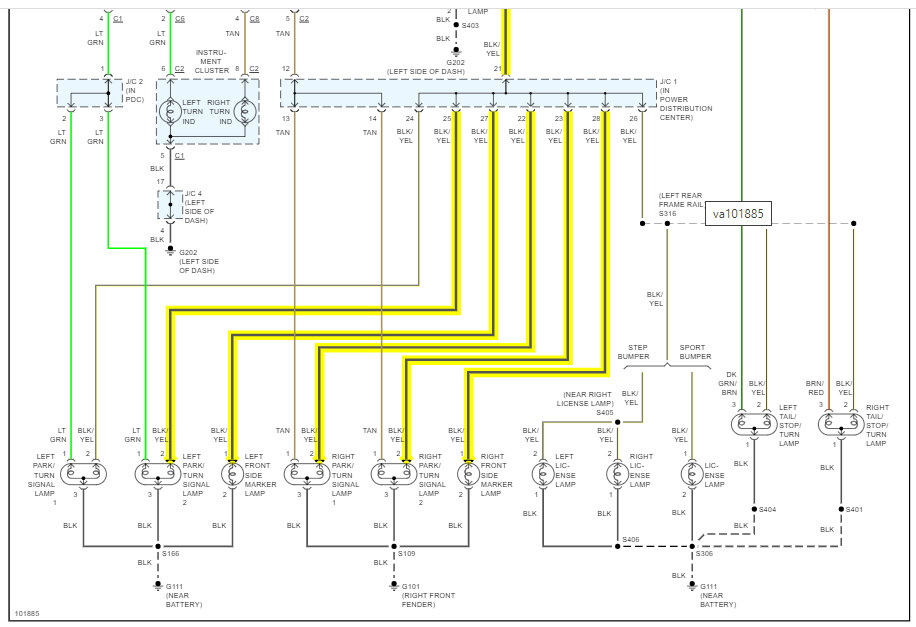

Here's the diagram. The running lights are on the first and third diagrams where I added the colored arrows. Next are the switch removal instructions, but it sounds like you may have had that out already. The last photo is of the switch terminals. I can't find terminal "R", but the red arrow is pointing to the supply terminal, "B2". That one will have a pink / red wire. The wire going to the lights is black / yellow. That circuit also feeds the dash lights. They both feed the radio display, so you'll see it doesn't dim when the head lights are turned on.
Those are the two color wires to look at for overheated terminals.

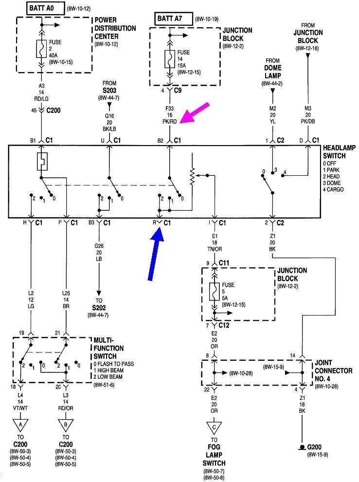

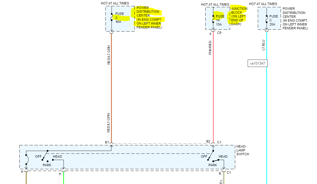

It sounds like the switch needs to be replaced. As far as the power you mentioned, power to the headlamp switch is provided by two different fuses that have power at all times, fuse 2 in the power distribution center and fuse 14 in the interior fuse box.
The parking lamps are powered via fuse 14. Have you checked it?

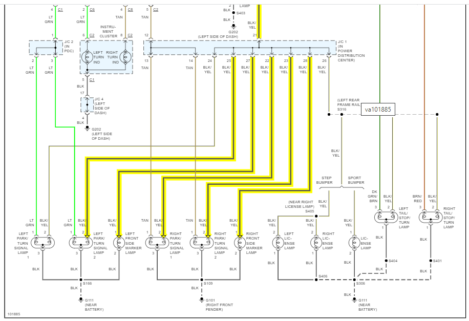

Let me know. Also, pic 1 below is from the headlamp wiring schematic. Pics 2 and 3 are from the exterior lamps. I had to cut the single page in two so you can read it. I did overlap the two. Note fuse 14 is present in both schematics.
Let me know if this helps or if you have questions.
