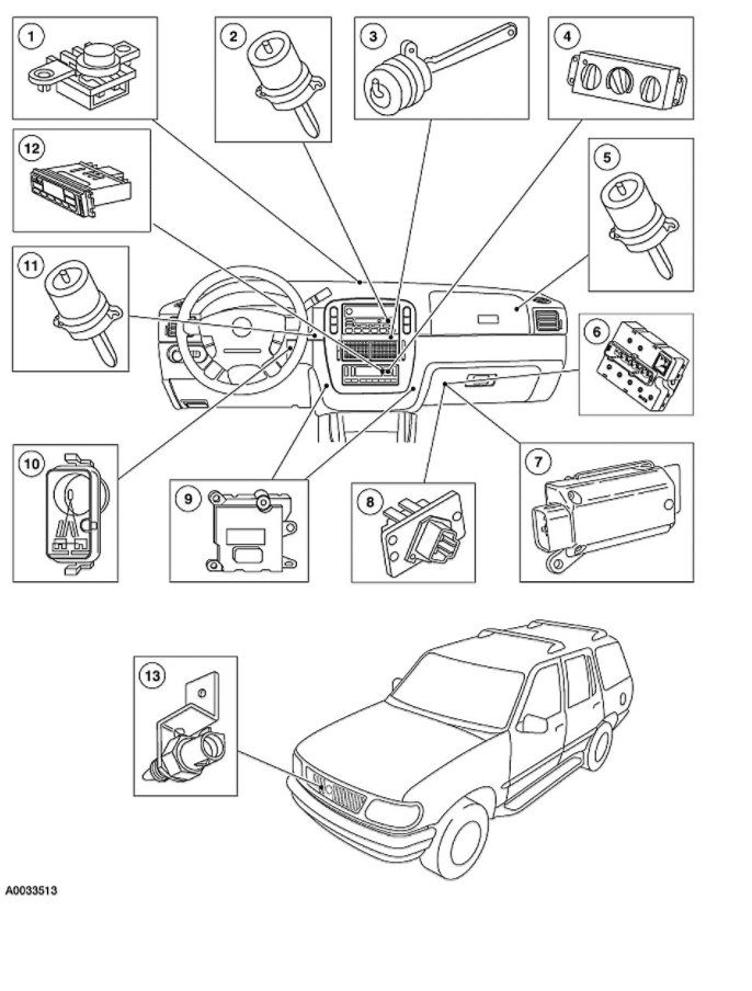

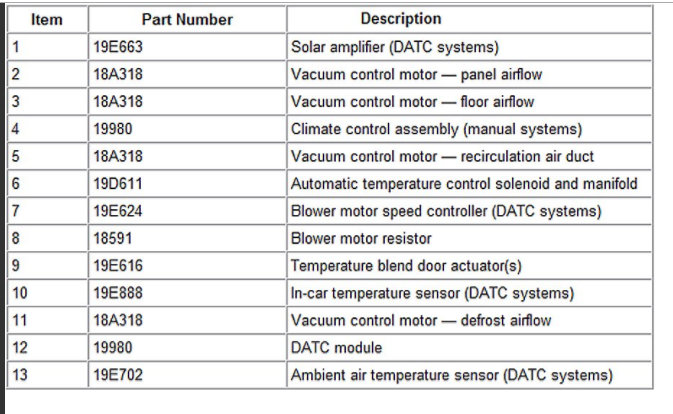

Blower sounds like it is working, but no air movement. I used to get a clicking sound inside the dash. I have dual climate control and have already changed out the driver side blender door actuator.
Thinking it is the passenger actuator as the dual climate controller indicated some time ago that it was an issue, but that code does not come up anymore. So it is that or the heater core that went bad. my thought is because there is no air moving anywhere (defrost, upper and lower blower vents) the main door must be stuck shut or not working? I really do not want to hand the truck over to a mechanic to 'guess' because it is a dash off job for passenger actuator and that racks the bill to over $400.00 just to get in to change a $40.00 part and that is if it is bad.
Thoughts?
Dec 20, 2017 at 3:08 AM
  • 55,743 POSTS
It sounds like the mode actuator is bad. here is guide to give you an idea of what you are in for when doing the job. Also some of the air doors are power by vacuum so check the vacuum lines under the hood to make sure they are not falling apart.
and
https://www.2carpros.com/articles/air-vents-stay-in-the-defrost-position
and this guide and video can help as well.
and
https://youtu.be/SNRb6pSwYuU
Check out the diagrams (below) Let us know what happens and please upload pictures or videos of the problem.
