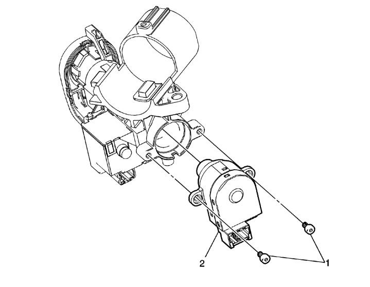

the heat went out and im trying to find the heater box in this 1998 ford explorer eddie bauer. it only blows out cold air.
Sep 27, 2020 at 11:45 AM (Merged)
DAVE H
  • CERTIFIED EXPERT
  • 13,384 POSTS
check you are getting heat to both hoses on heater core ... if you are then you will need to check the blend door !! a big job i'm afraid

TIMGAINES
I have a 98 explorer that the heater in malfunctioning. The heater works but there is no tempature control, it stays on high heat no matter where I dial the temp control. I checked to variable resister in the temp control and its good. Also the air conditioner fights the heater when I run it...the heater wins. I called the dealer and they sail the haeter door was stuck and they would have to take the entire dash out to fix it, for way more than I want to spend. Any suggestions?
FLEXY5
  • CERTIFIED EXPERT
  • 512 POSTS
that's pretty much it. The dash HAS to come out. the blend door motor sits on top of the air distribution box. If the blend door itself is broken, A/C has to be evacuated and the entire box removed. Not much options there, unfortunately.
