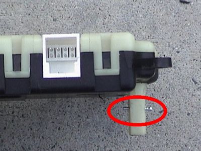

If you are going to replace the "Blend Door Actuator" yourself you will save $1000+ and that is no B.S. !! $1000,00+ is if "you have it done". A large portion of the high cost is labor, because the whole dash needs to be removed !! Calm down...put on the brakes...there is another chapter to this "Blend Door Actuator" horror show called a "quick fix".
https://images.2carpros.com/forum/automotive_pictures/433905_Blend_door_fix_example_1.jpg
THE 1/16th" FINISH NAIL WILL SAVE YOU $1000.00+!! - There is more work that needs to be done to complete the "quick fix" but it is absolutely well worth it. The "quick" fix is a step by step procedure with pictures. Take a look at it, actually not bad at all. Much better than pulling the whole dash out! which is a real S.O.B. to do. The quick fix was done on a "1996" Explorer but they are all the same, "Mercury Mountaineers" included. Here is the link for the step by step Blend Door Actuator "Quick Fix": http://www.blenddoorfix.netfirms.com Check out what is states in Step:9 about how much you just saved!! doing it yourself. I hope this information helped you out. If you have any questions or need some more information, just private message me and I will get right back to you. Rick

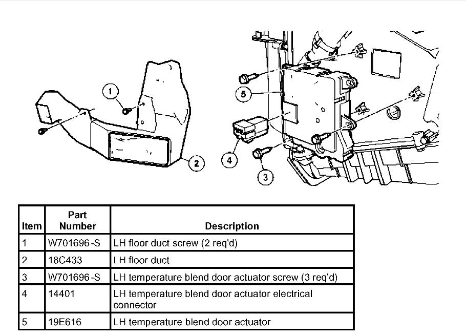

hey guys some help here as i say fan works but no heat &i hear clicking sound by heater core. yes the ac works great thanks for the help
Apr 7, 2020 at 4:34 AM (Merged)
DOCFIXIT
  • 18,828 POSTS
Blend door actuator electric motor that moves door from AC to heat.
https://images.2carpros.com/forum/automotive_pictures/198357_Graphic_234.jpg

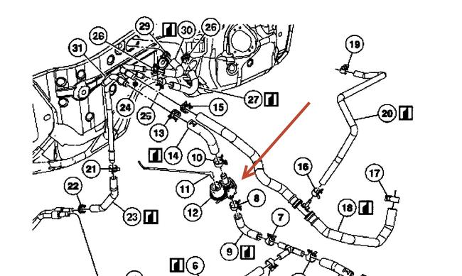

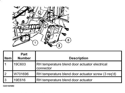

CWE909
  • 14 POSTS
fan motor works, turn switch to heater no hot air. both heater hoses under hood are hot. dont know ig gate is not switching or something else wrong. any ideas?ought maybe circuit possibly bad. turn knob for heat rotates very easy thanks and God Bless!
Apr 7, 2020 at 4:35 AM (Merged)
HMAC300
  • 48,601 POSTS
this can be a couple of things. you have a water valve item 12 in pic see if is passing water through it so it will be hot both sides. then there are temp actuators on LH (shown second pic) and Rh they may not be working. But pull the hvac fuse for 60 seconds with key then reinstall sometimes these reset. Otherwise they may not be working.
