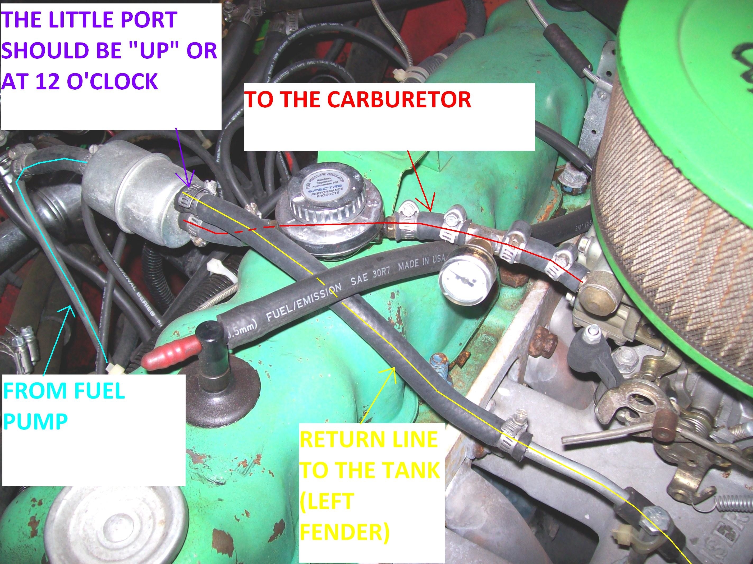

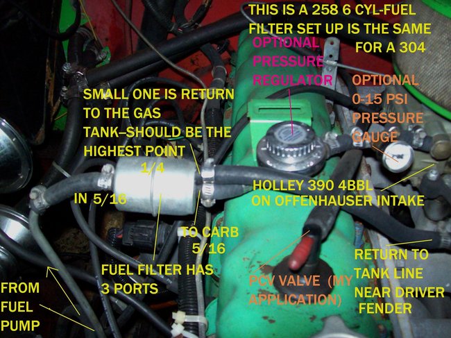

Yes, I have turned the engine over and if I take the gas line off the filter it pumps through but when I hook up the filter that has one line going to the carburetor and one going to return back to the gas tank it doesn’t come through. But you can blow through the filter easy? That’s where it doesn’t make sense. Do I have to have a filter with an outlet going back to the tank ?

This is a 1 barrel Carter YF carburetor?
How long has it been since it ran normally?
Disregard the regulator and pressure gauge in my pictures.

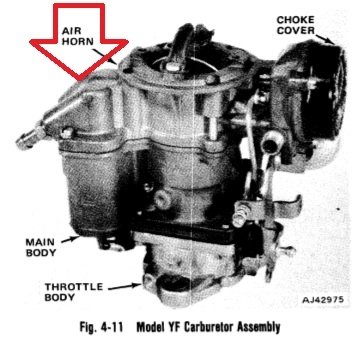

Sounds like your float is stuck or the needle and seat is stuck closed.
The carburetor thinks the bowl is full, and won't let more fuel in.
Last pic, whop the carburetor with a rubber mallet a few times about the area where my red arrow points. This is over the float/ needle/ seat on a YF.
Maybe it will shake loose, let's not damage the carburetor with the whopping!
Give it a try.
Good news? Let us know?

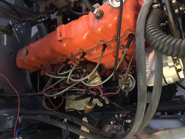

BRIAN.W
  • 12 POSTS

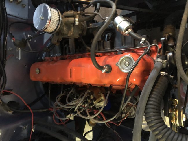

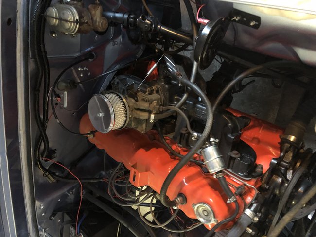

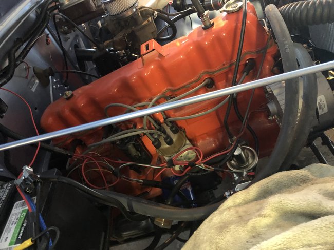

Here they are. Sorry it to so long.

As it stands now, still not whacked the top of the carburetor?
Your whole engine compartment is so darn clean and pretty! Come make mine look like that!
I found one glitch that is unrelated to the bowl filling up.
It would affect the way the engine runs and tunes up.
The PCV valve is in the front hole. It's job is to remove combustion gasses and water/ moisture from the crankcase.
The carburetor is engineered to also run off of the air that runs through PCV needed for combustion.
In stupid terms, lets say 90% of the air goes through the carburetor's throat and 10% comes through the PCV. All of which is needed to make things run correctly.
As it stands now, the rear hole in the valve cover looks to be closed off. Basically, this would be the same as plugging the PCV hose off as air cannot continue to move through the PCV after a vacuum gets pulled on the engine block. The 10% of air no longer gets to the carburetor and correct tuning is impossible.

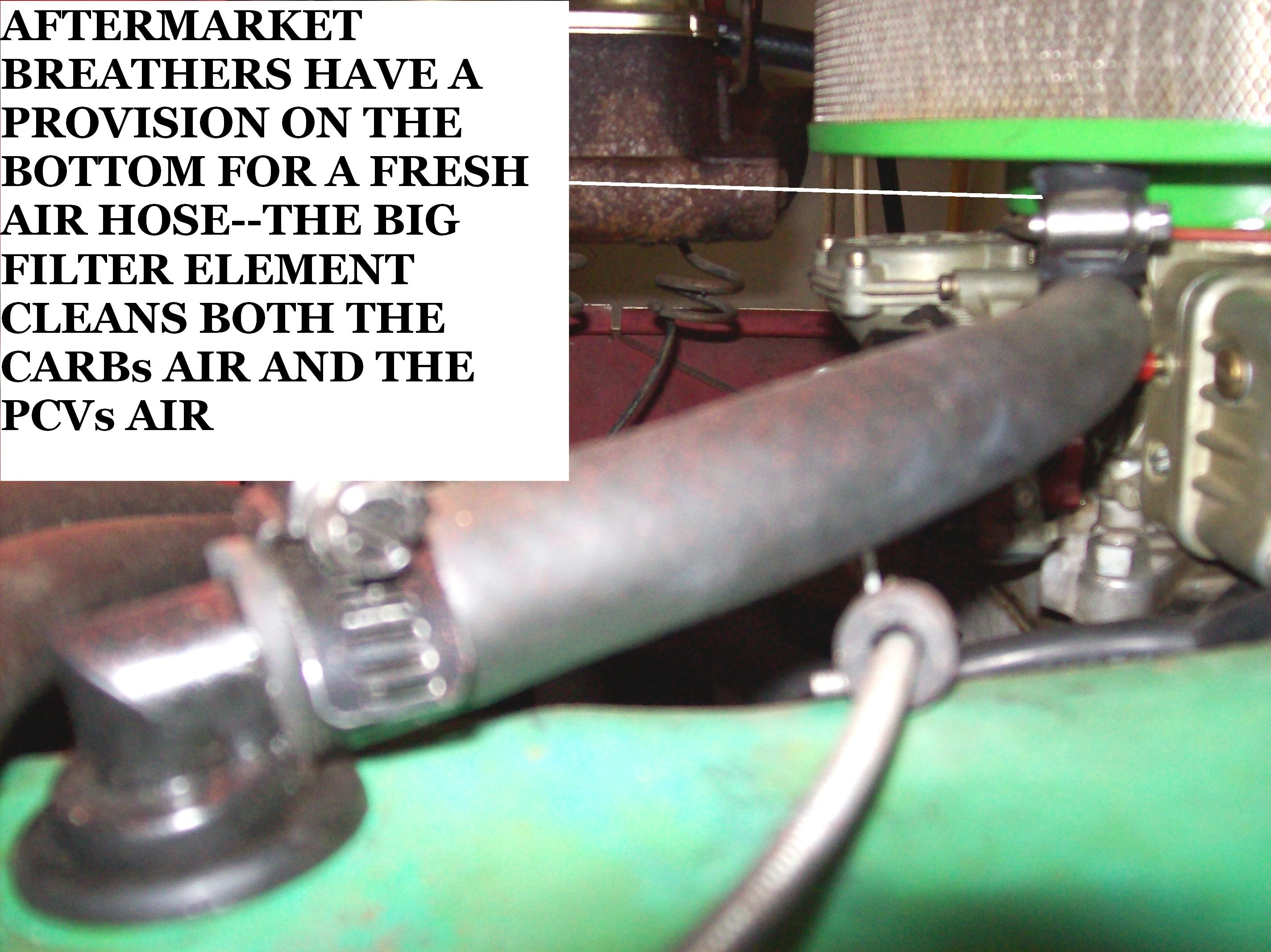

The easy fix for this is to simply pipe over to the air cleaner and draw clean fresh air from there. You might modify your air cleaner, or purchase another with the provision. I recommend this way over the next option I show below. (See my pic)
This option basically sticks a filter up out of the second hole. Eventually it gets stopped up or restricted and you are unknowingly back in the same boat you started with, unless you stay on top of things. See my link.

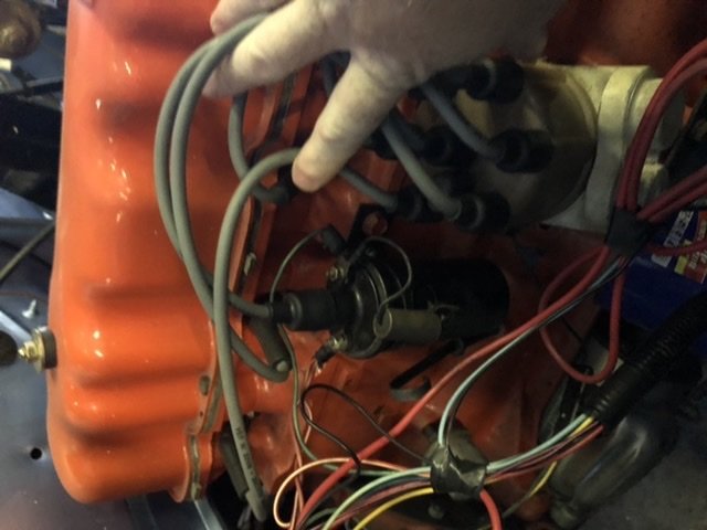

I hope you can see the condenser on this photo.

I really like your paint.
Lose the condenser, it is there to keep the static off of your radio, if you will install resistor spark plugs this should eliminate the static. There are other brands, my #1 choice is Champion if I can get them, my second preference is Autolite. Here's a link:
https://shop.advanceautoparts.com/p/autolite-copper-resistor-spark-plug-65/5390222-P?searchTerm=spark+plugs.
I still see your breather hole is capped off on the valve cover, don't forget to make it breathe!
