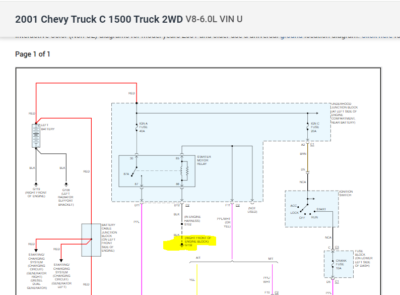

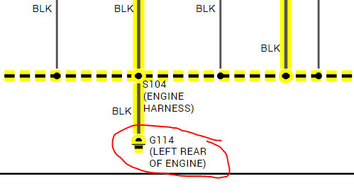

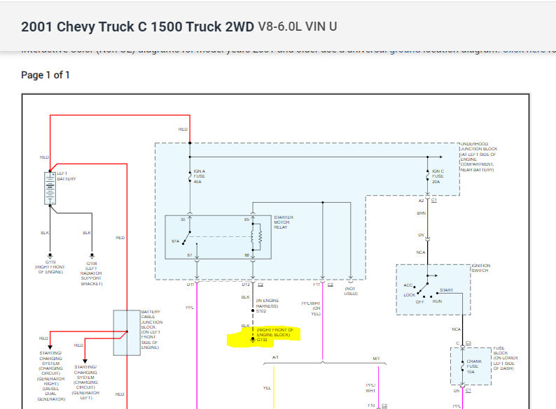

I believe you are referring to Ground 132 (G132) which is for the starter relay and several other things. See attached pic below. Yes, there are two wires to that ground, but there are several components dependent on its operation.
On a lot of these trucks, people would lose spark to all ignition coils at the same time. Replacing the crankshaft position sensor wouldn't resolve the issue. Instead, the ground for the circuit failed. It would show continuity until a load would be placed on it and then not be able to handle the load.
The connector itself would rust apart and fail causing several different problems. In this case, there should be two black wires that go to it. If you look at the pic below, you will see lines that are made with dashes. That simply indicates the ground is used but is a switch operated ground and not being used at all times.

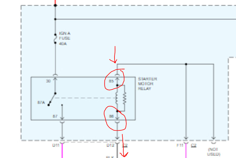

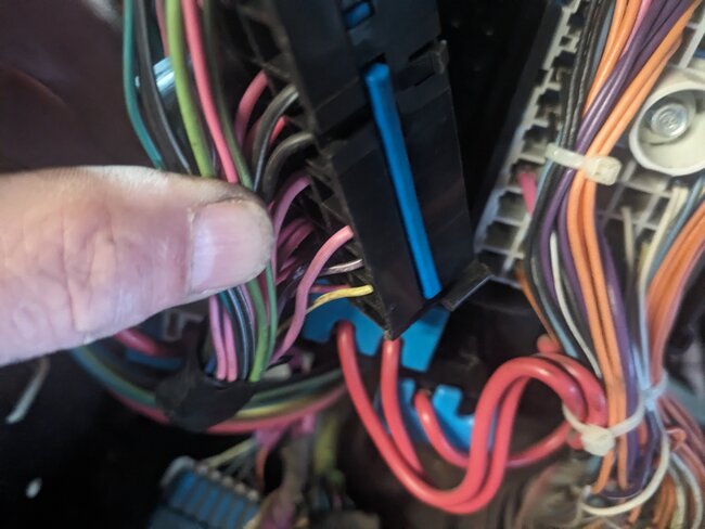

This is the first time I have had any electrical problems in any of the cars I have worked on. I realized that I was reading the pins on the relay wrong. The problem is still with the ground on pin 86. I have taken the big wire looms off and I have been tracing the two wires in the ground back the the fuse box. I found the ground back to the other items, and not the starter relay as it went into a connecter with many lines coming out the other end. I still can't get any continuity to pin 86 on the wire. I looked under the fuse box to the wires going into pin 86 and it looks like there are two wires going into pin 86 and they are orange or pink. See photo. I found a broken wire and I fixed it. I don't know what it went to. Should there be two wires under pin 86?
Ron
May 6, 2024 at 11:58 AM
  • 110,244 POSTS
According to the wiring schematic, the wire from pin 86 should be black. Once you locate it, run a jumper wire from that pin to the battery negative. See if the relay works then.
The wire colors to the relay are purple (pin 87), red (pin 30), black (pin 86) and pin 85 will either be a purple wire with a white tracer, or it could also be yellow. See pic.
