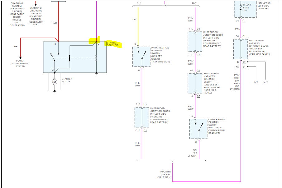

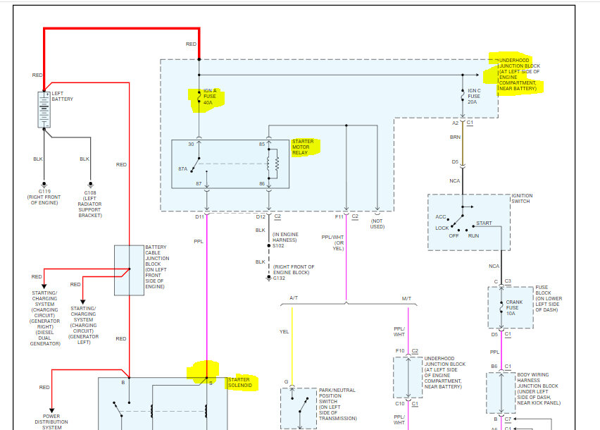

That appears to be related to the starter or the neutral safety switch. The lights inside turning off is normal when the key is in the start position.
First, see if it will start if you place the transmission in neutral. If there is no change, I need you to locate the starter relay in the under-hood junction box. Switch it with a different one having the same part number and see if that changes things. Also, confirm the ignition 1 fuse is good and has power to and from it. Also, in the under-hood junction box.
If there is still no change, at the starter motor, there will be a smaller gauge purple wire. The wire will have no power until the key is in the start position. Have a helper turn the key to the start position while you check for voltage at that wire. If there is voltage, the battery cables are clean and tight, and everything is properly attached at the starter motor, the starter will need to be replaced.
I attached the wiring schematic below so that you have a reference. Let me know what you find or if you have other questions.

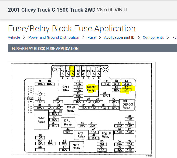

Hi Joe,
I have confirmed that the relay and the fuses and the engine fuse box are okay. I put the truck in neutral and it didn't start. I got a new starter and there is no power to the purple wire when the key is turned to start the car. How do I research and see why the purple wire has no power?

  • 110,244 POSTS

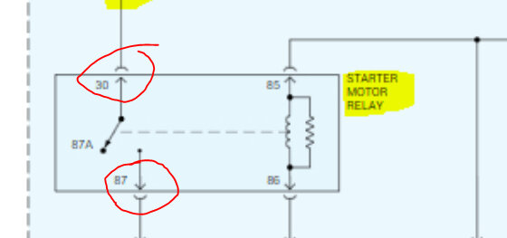

Here is what I need you to try. Remove the starter relay. On the relay you will see a number identifying each of the connector pins. Locate numbers 87 and 30 and determine which connectors in the box they go to.
Take a jumper wire and jump power from pin 30 to 87. When you do this, it sends power directly to the starter S post (purple wire) and the starter should engage. Do this and let me know what you find. If there are no issues and the key is in the run position, the engine should start.
By doing this, I can determine if there is an issue at the relay or if the PCM isn't providing a ground to actuate the relay.
See pic below.

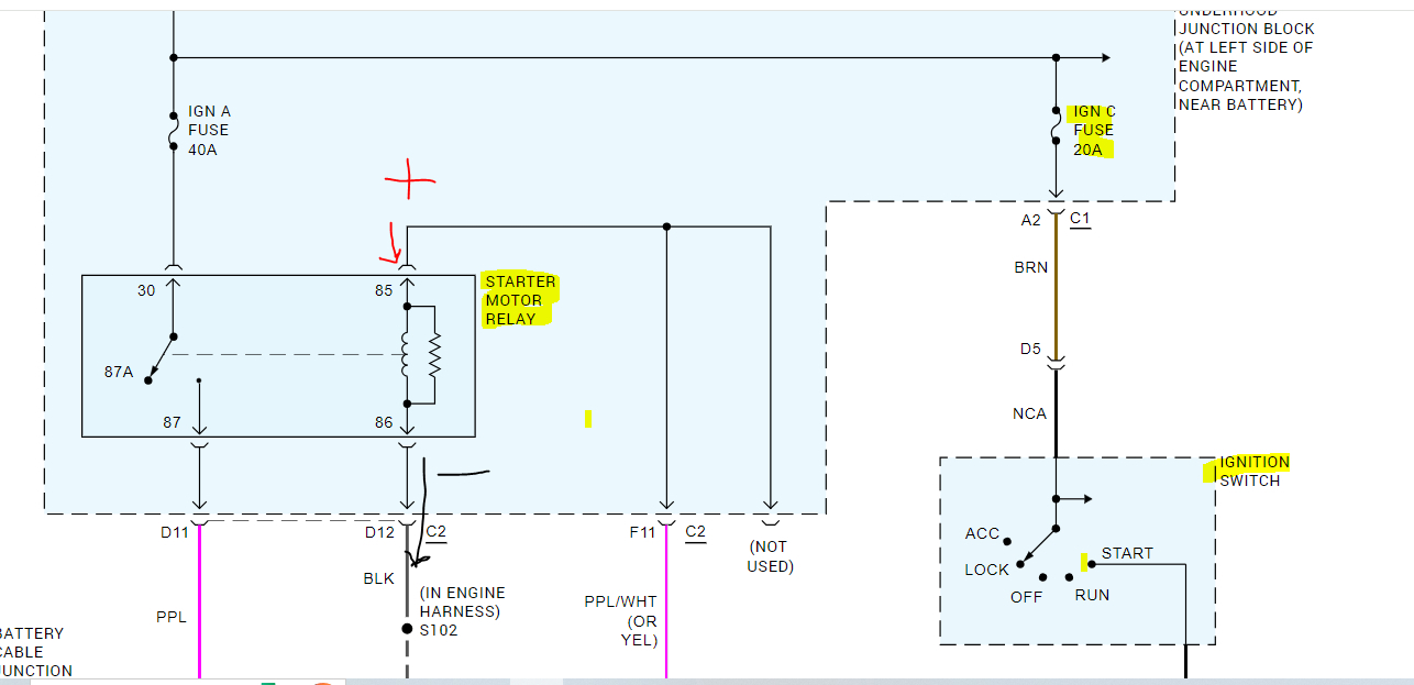

  • 110,244 POSTS

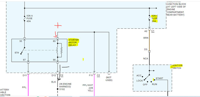

Power should be present at pin 30 from the ignition A fuse. For power to reach pin 30, the primary side of the relay needs to be completed. So, if you have power at pin 30 but nothing is present at 87 with the key in the start position, the problem is likely on the primary side.
Now, we need to check the primary side. With the key in the start position, check if power becomes present at pin 85. If it does, then I need you to check for continuity to ground via pin 86. Pin 86 is a ground and doesn't require the key to be in any specific position.
Let me know what you find.
See pic below.
Mar 22, 2024 at 2:17 PM

  • 147 POSTS
Hi Joe, I did the test, there was no power on pin 85. What is the next step?

  • 110,244 POSTS

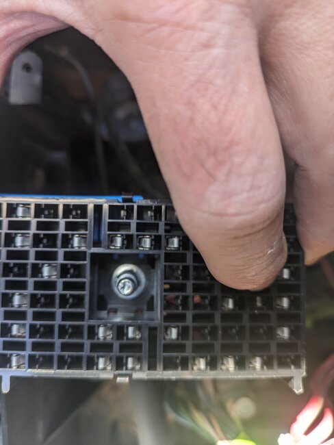

If you had a wire in pin 85 and used a test light, where did you have a ground for the test light? I ask because if you get power to pin 85 and pin 86 has continuity to ground, the primary side of the relay should be complete. When that happens, an electromagnetic field is created which forces the secondary side to close (power between pins 30 and 87) and sends power to the purple wire at the starter. (I hope that made sense).
If that is happening, recheck the purple wire on the starter to make sure it has power with the key in the start position. If it does, suspect the starter is the problem.
Do you now have continuity to ground between pin 86 and a body ground or the battery negative?

Hi Joe,
I had the wire in pin 85 and I attached my test light and touched the grounding screw in the photo. There was a small wire and a bigger wire attached to the engine block. As I said before I cleaned the connectors with 40 grit sandpaper and the area where they attached. I felt like that screw was the grounding wire for the relay. When my wife turned the key, the test light turned on. Am I correct that that ground was for the relay?

  • 110,244 POSTS
Using the test light, put a paper clip in 86. Place the alligator clip side of the test light on that paper clip. Then probe pin 85 with the light and have your wife turn the key. Does the light turn on?
As far as the neutral safety switch is concerned, see if it will start in neutral. Also, there is a yellow wire at the switch that should have power with the key in the start position. However, if you have power at pin 85, the switch is working. Power must run through the safety switch before it reaches pin 85.
I have a feeling that pin 86 doesn't have continuity to ground. Therefore, it isn't completing the circuit for the primary side of the relay. If possible, try the test I mentioned above. If it tests good, either we have a bad relay, no power to the secondary (which you already checked and is good via power at pin 30), or an open between pin 87 and the starter. But you already checked that and the wire is good. That leaves the only thing left. A ground for the primary.
The ground is G132 and located at the front right of the engine block. I can't tell in the pic which side of the engine I'm looking at. It appears to be the left (driver's side).

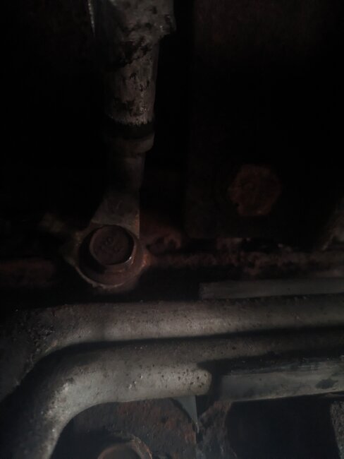

I found it. I will have to take the intake manifold off to get some room to get to it. I will let you know what I find out.
Mar 27, 2024 at 7:55 AM

Hi Joe,
I got the intake manifold off and got to the ground and tested it. It was at the very back on the left hand side of the engine block. The wire isn't cut and has continuity from the connection at the ground to the 85 post in the fuse box. It was getting dark and I called it a day. I didn't take a detailed looking at where it is connected to the engine block. Tomorrow I will take some 40 grit sandpaper and cleaned the area where it attach to the engine block and the connector. Is there anything else I should do?

Joe,
Today I took some 40-grit sandpaper and sanded the area where the ground attached to the engine block. When I attempted to sand the attachment on the end of the wire, it came off the end of wire.
I attached a new end to the wire and then tested it for continuity and it tested fine. I have attached it to the engine block and reinstalled my intake manifold. I put on a new shift cable and when I tried to put it on neutral, there was an issue. So, I need to get that fixed before I can start the car.
Ron

That isn't too uncommon. They corrode and break. Interestingly, when checked for continuity, they test good. However, when a load is placed on it, the ground fails.

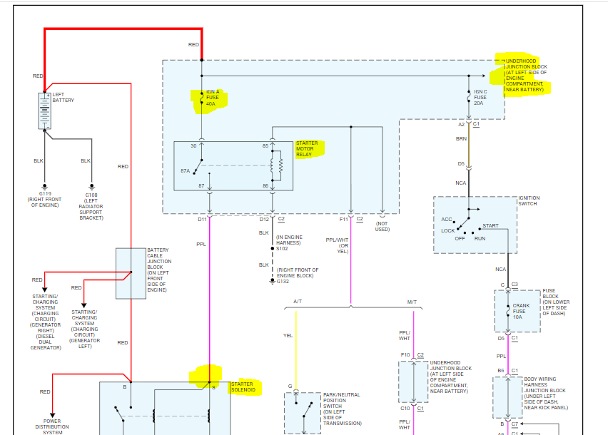

  • 110,244 POSTS
Hi Ron,
If the relay is good and jumping it allows the starter to engage, we need to check the other side of the relay, the primary side.
With the key in the start position, check pin 85 for power. If there is power, confirm pin 86 has continuity to ground.
See pic below.
Apr 5, 2024 at 1:20 PM

When we turn the key there is power to 86 it lights up. But there isn't continuity to ground at 87. I had continuity at 87 before when I had the intake manifold off before. How do I go about fixing the ground?
Apr 13, 2024 at 6:25 AM
  • 110,244 POSTS
Relay primary side are pins 85 and 86,
With the key in the start position, pin 85 should have power. Pin 86 is the ground source for the primary side of the relay and should have continuity to ground at all times.
Relay secondary side are pins 30 and 87
Pin 30 should have power at all times. Pin 87 is what connects to the starter motor, so you won't have power there until the relay is reinstalled and actuated by the primary. Pin 87 isn't a ground. It's the power supply to the S terminal on the starter motor.
Is that what you found? I ask because the pin numbers you mentioned are for different sides of the relay.
