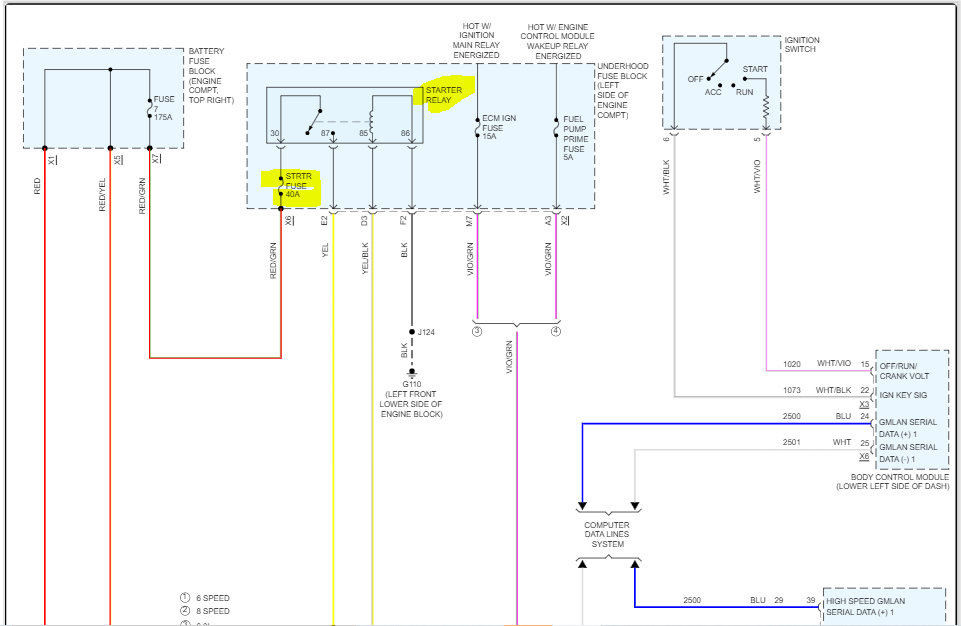

Tried to start truck in morning it failed. I gave it a jump with a booster, and it started, and it ran the rest of the morning. in the afternoon it did not start again, tried the booster again did not start, I put on charger for a couple of hours. Still didn't start. I checked battery, two months.old,12.9 volts, alternator is 3 weeks old. When I try to start it clicks once and that's it. everything works; lights are bright, I tried to start in neutral, no go. I'm stranded at home out of ideas please help. I am retired so luckily, I don't have to show up at work. Thank you for your help.

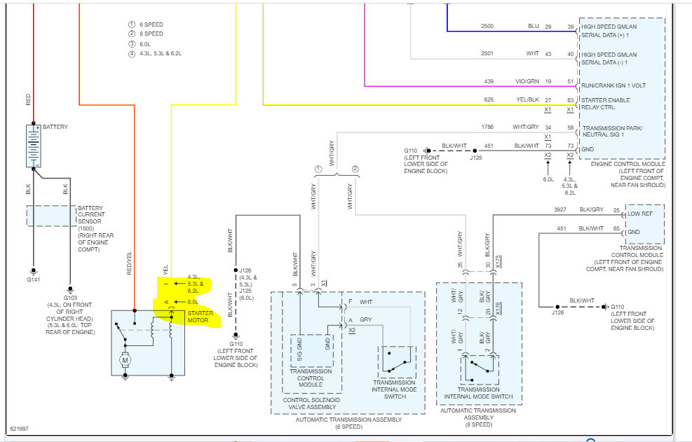

Also, can you tell if the click is the starter motor? There is a chance the starter motor itself may have failed.

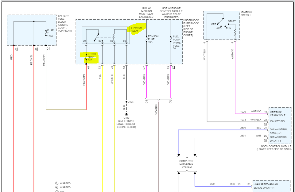

If the click isn't from the starter, there could be a faulty fuse or relay. I attached the wiring schematic below showing the starter circuit. I highlighted the fuse and relay in question. The easiest thing to do is this.
Have a helper turn the key to the start position while you check for voltage at the yellow wire on the starter motor. If you have power and everything is tight, the starter is likely the issue. If there is no power, work back to the relay and fuse.
Aug 10, 2022 at 5:38 AM
JOL
  • 12 POSTS
Finally got somebody to crank the engine while I put a voltmeter on, and it read 11.9. The solenoid was also sparking, $240.00 later it's working again. Thanks for all your help. This will be my go to site from now on.
