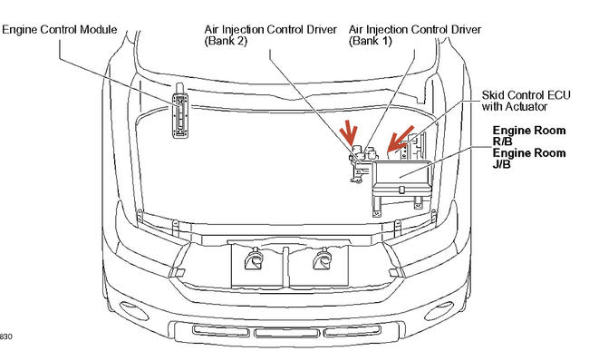

The 1613/14 code is yor air inection pump driver or pump solenoid on the secondary pump this could be very well to having installed the performance chip in yur vehicle. It is the driver and or the solenoid and sthis should be checked by a professional so he can scan it and turn things on and off awhich you are unable to do with your scanner to test the driver as well as solenoids. Have a pro test this but the fault cold lie with your chip you installed.

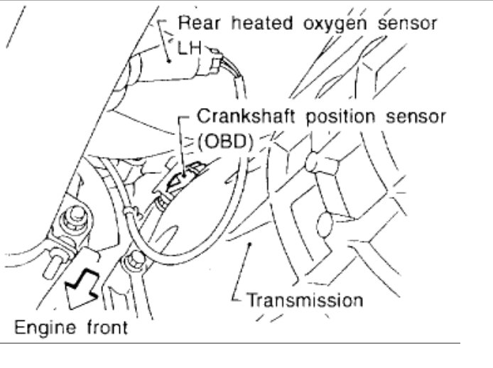

A few day ago in the morning, our 98 Pathfinder would crank, but not start. We changed 5 out the 6 spark plugs and it ran fine that night and the next morning until about 20 min. Into driving. Then, the car began to idle bad and acting like it was going to shut off. I arrived at work and when beginning to leave, it cranked and started but again idled bad while in park and drive and would shut off. Tried to have spark plug replaced, but no mechanic was willing and able at time. Attempted to drive home and it shut completely off coming down the road. No smoke, radio and all electronics would work, but would not restart. We replaced the 6th plug and all the wires and it will crank and not start. We listened for the fuel pump with ignition "ON" and you can hear it and clicking under hood. You smell fuel when trying to crank and spark plugs smell of gas. We ran the scanner tool and no codes are found. We tested the spark plugs and there is no fire to at least two of them. We have came to the conclusion it is either the crankshaft sensor or distributor. But My question is if it is the crankshaft, wouldn't we have received a code or could it be the ECU not giving it a code or the distributor rotor (cap looks brand new). Also, is there any way to test the distributor or crankshaft to narrow it down?

When a crankshaft sensor goes bad it will not set a code. Here is a guide to help you see what you are in for when doing the job.
Here is the location of the sensor which is on the top of the transmission bell housing.
Cheers

Yeah we have tested the spark plugs and there is no spark. We have turned the ignition and the fuel pump cuts on. The fuses are ok. We need to know how to test the coil on the distributor, cap, or crankshaft. We hooked the scanner and no codes are pulling. I will order the crankshaft sensor
Wednesday, November 14th, 2018 AT 12:19 PM (Merged)
  • 75,992 POSTS
The Crankshaft Position Sensor (OBD)On transmission housing, facing flywheel gear teeth. You will need to jack the car up
CDERRICK23
It took a while but I got the sensor changed out and the engine started right up YA! Thanks for your help this site rocks!
