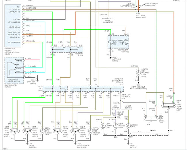

My brake and blinkers work, but my taillights both don't work. One stopped working a while back, but recently the other stopped working too. The fuses look good, I don't know what I should look for.

Have you checked the bulbs? The bulbs for this (3157) have a dual element. One is for the signals and brake light. The other is for the parking lights. If the one element failed, you can still have brake and turn signal lights and the parking lights won't work.
Are the front parking lights working?

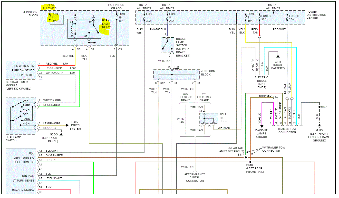

There is a fuse and relay for the parking lights in the junction block. However, if the front parking lights are working, they are good, so I need to know.

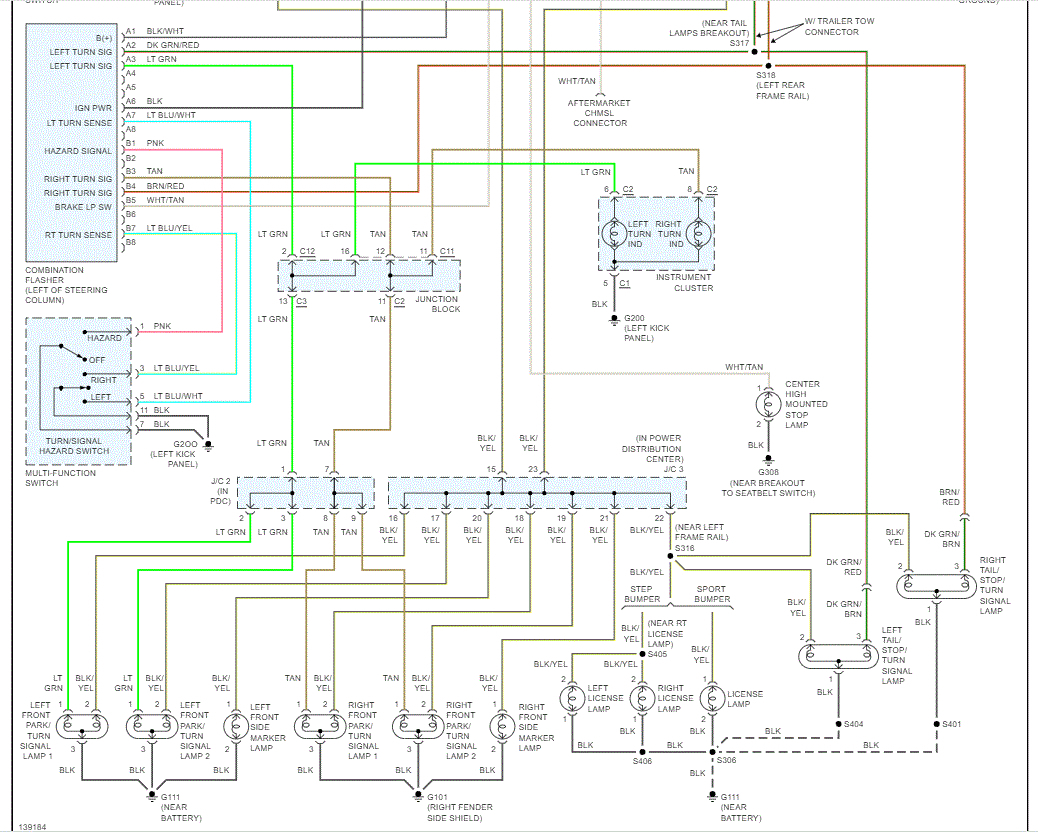

I attached the wiring schematic below for your review. Rather than purchasing the bulbs and not needing them, remove the bulb, and inspect the socket for damage. Also, check the black wire with the yellow tracer for power when the parking lights are on.
