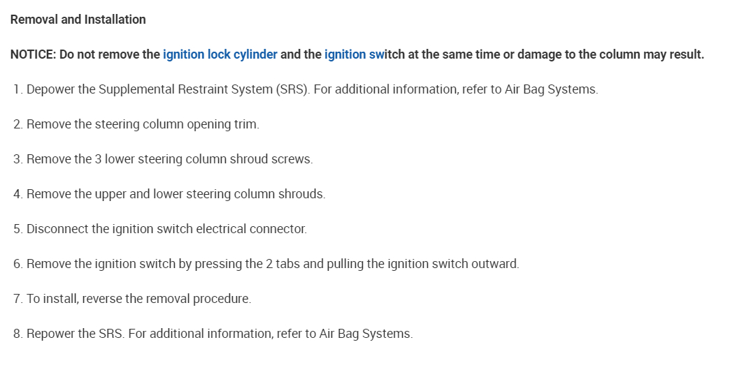

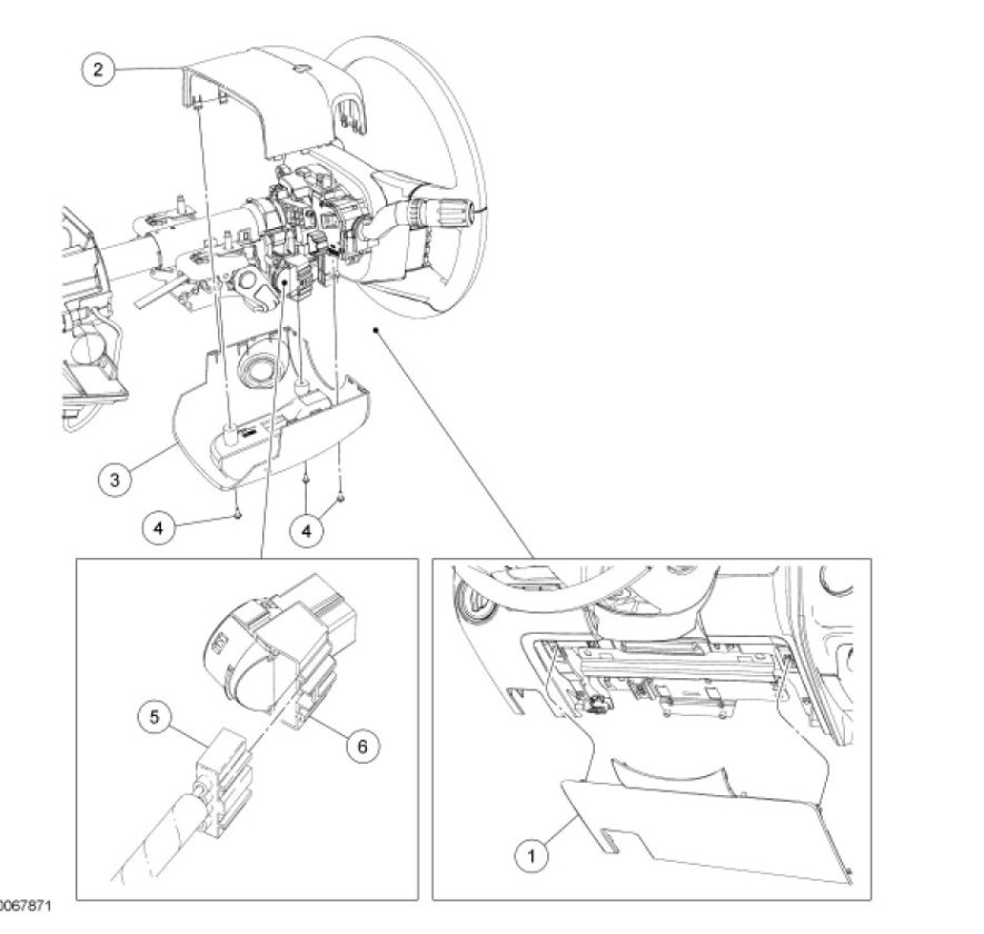

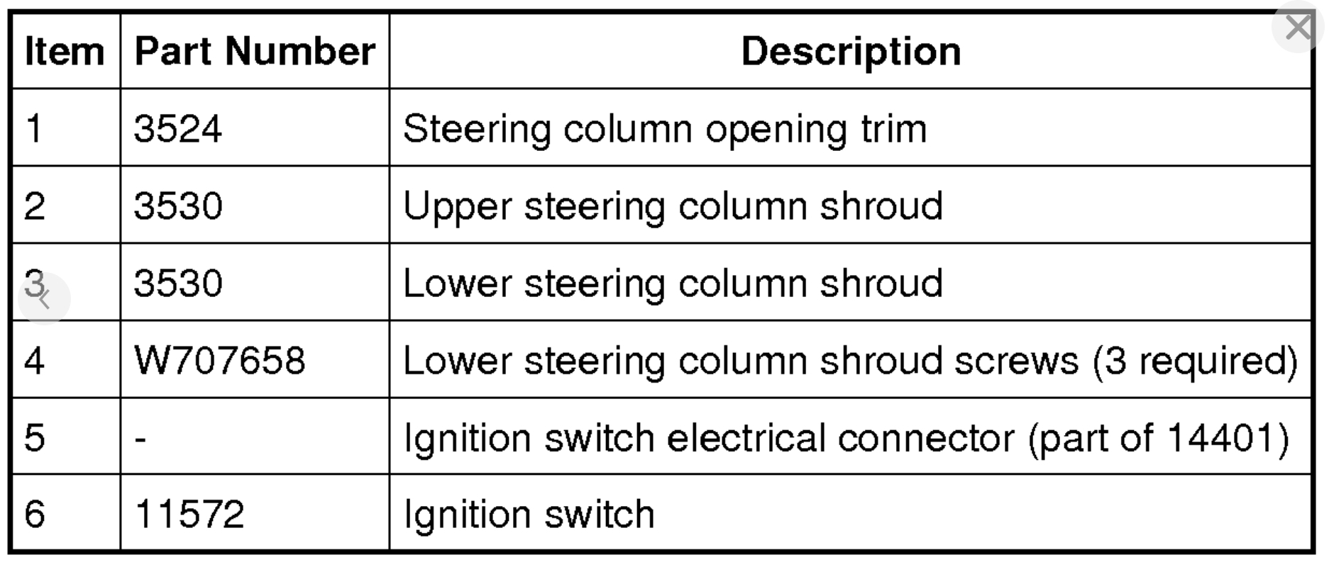

This happens when the ignition switch is ou. here is how you can change it out in the diagrams below. This guide can help as well:

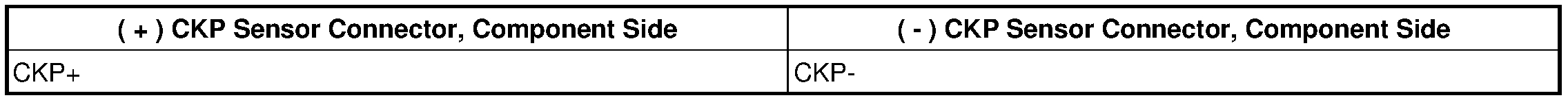

Vehicle listed above is the limited model 3.0 engine. intermittent no start or crank, it will start fine then after a fifteen or twenty minute drive if I shut it off I usually have to wait twenty minutes or so for it to start but not every time? I have replaced everything that others have suggested from ignition switch to relay, I even had a remote start installed and still have the problem. it runs and drives great once it starts. about to the end of my rope with it so any ideas will be greatly appreciated.
Aug 19, 2020 at 12:12 PM (Merged)
  • 110,241 POSTS
Welcome to 2CarPros.

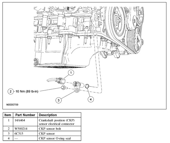

What you are describing sounds like a bad crankshaft position sensor. When they start going bad, they are affected by heat. Take a look through these three links. The first describes what the sensor does. The second discusses symptoms and the third discusses in general how one is replaced. Now, when I suspect a bad sensor (which may or may not set the check engine light to come on) I use a live data scanner. If the sensor fails, you will lose the engine RPM signal to the scanner.
https://www.2carpros.com/articles/how-a-crank-shaft-angle-sensor-works
____________________________________
You can also check the sensor for resistance. Here is how it's done. Additionally, here are a couple links to help you check the resistance:
CKP SENSOR RESISTANCE
- Ignition OFF.
- Measure the resistance between:
Pic 1
Is the resistance between 0.25K - 1K ohms? If not, replace the sensor.

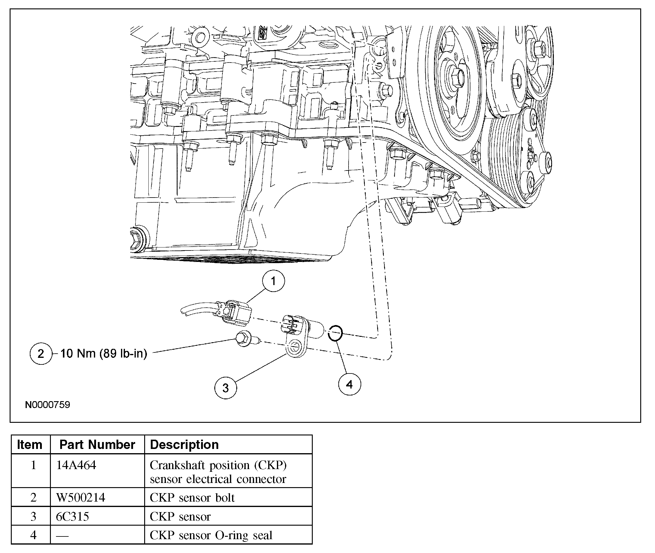

If you find this is the problem, here are the directions specific to your vehicle for replacement.
REMOVAL AND REPLACEMENT
CRANKSHAFT POSITION (CKP) SENSOR
Pic 2
Removal and Installation

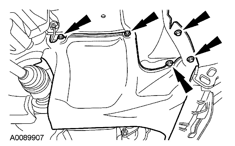

1. With the vehicle in NEUTRAL, position it on a hoist.
2. Remove the 5 bolts and the RH splash shield.
- To install, tighten to 9 Nm (80 lb-in).
pic 3
3. Disconnect the crankshaft position (CKP) sensor electrical connector.
4. Remove the bolt and the CKP.
- To install, tighten to 10 Nm (89 lb-in).
- Inspect the O-ring seal and install new as necessary.
5. NOTE: Lubricate the CKP O-ring seal with clean engine oil.
To install, reverse the removal procedure.

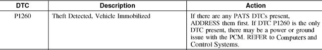

GOKEY GYURI
  • 5 POSTS
The problem occurred after deleting all the keys.
I have programmed two keys.
we used abdites avdi, zedfull, tcode, vcmm dealer.
the device shows that the keys are programmed but PATS on dash flashing.
I have P1260 error on TCM.
thank you

The code you have indicates there is either a power or ground issue at the PCM (see Pic 1). Have you disconnected the connection to check for corrosion or a damaged pin?

GOKEY GYURI
  • 5 POSTS
I solved the problem!
programmed new file in eeprom + programmed two keys.
initialized modules.
the car is working again.
