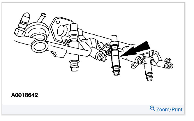

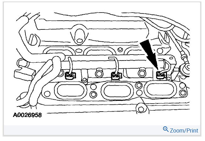

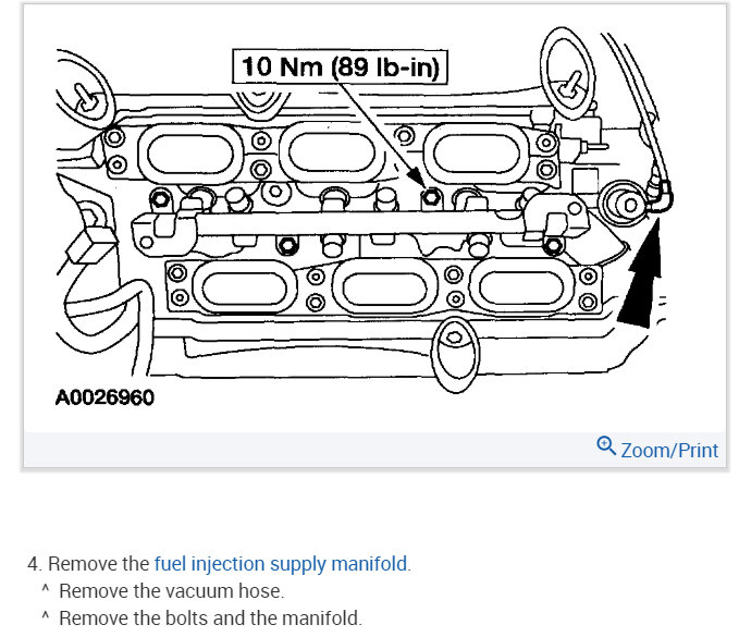

Hi rmurdock, Welcome to 2carpros
This sounds like you have a fuel injector that is not working right if you pull the spark plug is it white like nothing is happening in the combustion chamber?
If so I would remove the injector to test it here is a guide.
https://www.2carpros.com/articles/how-to-test-a-fuel-injector
Check out the diagrams (Below). Please run this test and get back to us.

RMURDOCK
Greetings:
I did what you said and the injector is not opening so I got a new one for $67.00 and installed it the engine has never run better. I love this site.

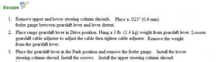

KEVISHA
So what about the linkage being loose it has something to do with the transmission? thanks a bunch in advance!
Jul 19, 2018 at 2:18 PM (Merged)
BLUELIGHTNIN6
  • 16,542 POSTS
You talking about the shift cable linkage?? If so you will need to follow steps below to adjust it..

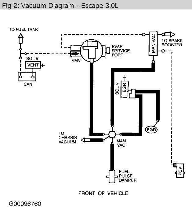

HMAC300
  • 48,601 POSTS
the lines going from the valve cover to air duct /breathers are not vacuum only the pcv is if you are good with a scanner freeze frame it and check your voltages if a sensor is bad can cause that also check grommets for air leaks. i'll send a vacuum diagram in next email because our site has changed and I can't do it on a reply.
Jul 19, 2018 at 2:19 PM (Merged)
HMAC300
  • 48,601 POSTS
see pic
