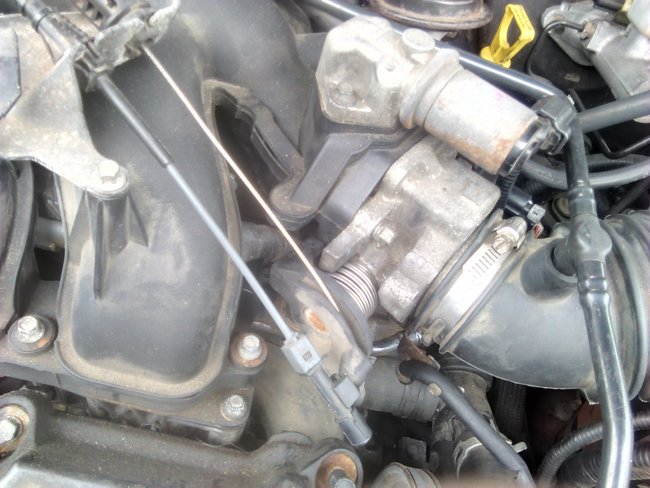

SHAWN67
My 04 escape struggles to reach 30 mph. Trouble code for tps sensor low input, I changed tps sensor,cleaned IAC valve and cleaned throttle body. Nothing changed. Also fairly low idle. Any help appreciated.
Jun 23, 2020 at 5:26 AM (Merged)

SHAWN67
Trouble codes are p1120,po113,po511, po403. Fuel pressure is fine. Seems to be a hissing at the egr valve when idling. Included is a picture of throttle body are. Advice appreciated.
HMAC300
  • 48,601 POSTS
for 113 check iat and or maf sensor for resistance see pics on where. check for a vacuum leak or cracks around egr or bad gasket. make sure it's cleaned out as well as sometimes they clog. need to know if it 's electric or vacuum though . for 511 check idle air control valve for plugging and or pintle sticking. best to clean this and throttle plate on both sides with choke cleaner.for 1120 by cleaning throttle plate may take that code away. also check for a cracked intake manifold at egr if it's plastic,
