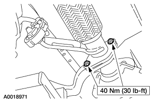

Any ballpark on what repair costs for something like that would be?
Tuesday, June 23rd, 2020 AT 12:26 PM (Merged)
BMRFIXIT
  • 19,053 POSTS
If it is the flex pipe to cut and replace would be around $160

Where would I look for the flex pipe? Does it come right out of the manifold?
  • 110,055 POSTS
If you hear a hissing, there has to be a vacuum leak. Can you tell aprox where it is coming from? Have you checked the intake, brake booster?
BMRFIXIT
  • 19,053 POSTS
Flex pipe
