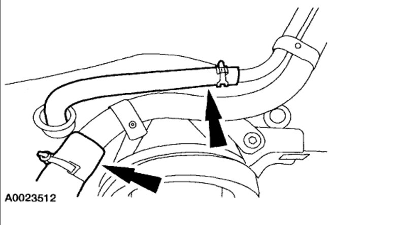

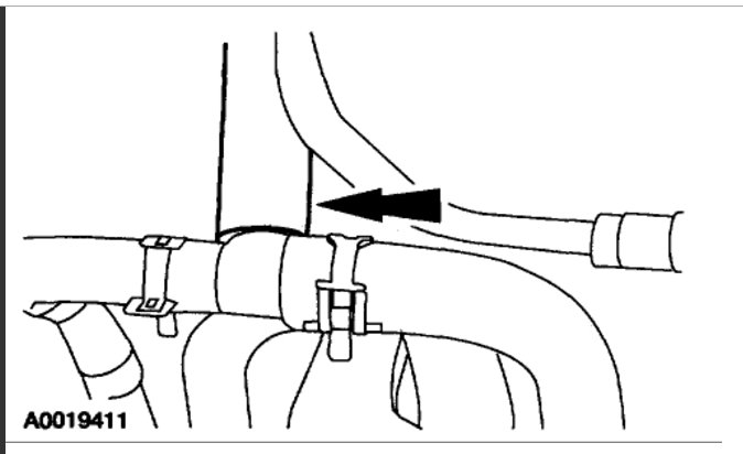

After I got home from the store today, I later went to move my car and it acted like it wanted to start but couldn't, like no fuel was getting to the engine. I've never had a single problem before with my 2001 Ford escape, so I called the dealership to come and tow it there. My question, is it the fuel pump, and if so, how much does it usually cost to replace one with labor? I also need to add that at the store I brought home 800 lbs of mulch in the car. Did this contribute to the problem or not?
Apr 23, 2008 at 10:29 AM
BLACKOP555
  • 10,386 POSTS
It does sounds like the fuel pump when out can you hear it running in the tank with the key on?

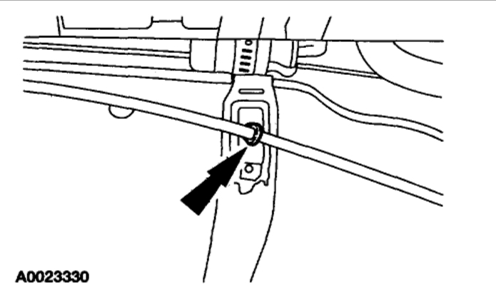

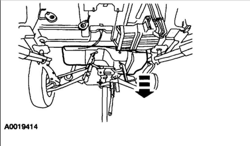

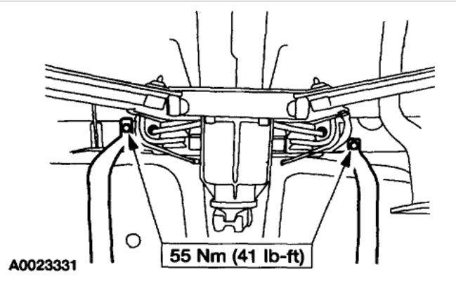

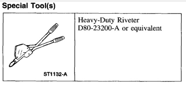

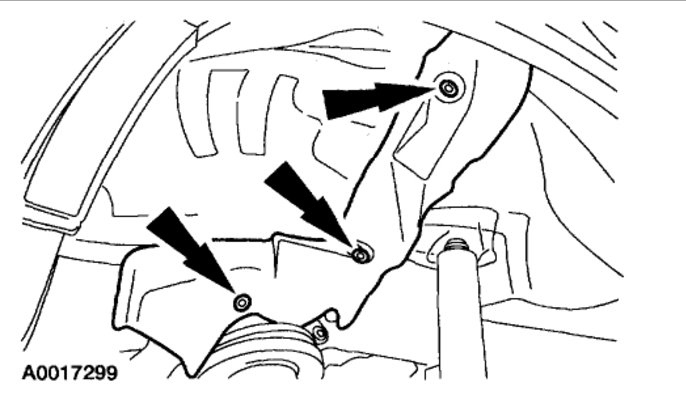

Here is a guide to help you see what you are in for when changing the pump out.
https://www.2carpros.com/articles/how-to-replace-an-electric-fuel-pump
Here is how it will be for your car (below) you can find the pump on Amazon for about $140.00 so the rest will be labor.
Cheers

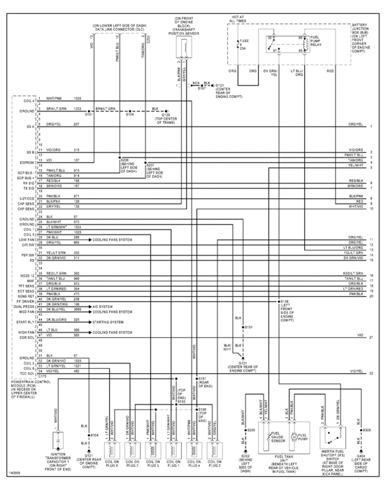

was doing some service on veh. removed mass air flow, replace air cleaner, sprayed mass air flow with proper cleaner, at that time, noticed throttle body dirty. sprayed throttle body out, reassy parts. veh will not start, All items are pluged in and tighten. veh was running ok before this. put tester on veh, getting code p0232 now, did not have it before. please help. thank you len
Aug 12, 2020 at 6:43 AM (Merged)
  • 110,246 POSTS
That code deals with the fuel system circuit. Can you hear the fuel pump prime when you first turn the key? Have you checked fuel pump pressure? I have no idea why that would come up based on what you did. Try switch the fuel pump relay with another one with the same part number. Also, let me know if both fuel and spark are missing to the engine. When you turn the key to the on position without cranking the engine over can you hear the fuel pump run in the tank for 5 seconds?
BIGLEN40
veh will start with starting fluid, found the fuel rail sharder valve, no pressure when key is on. checked fuses and switched relays, still no pressure.
  • 110,246 POSTS

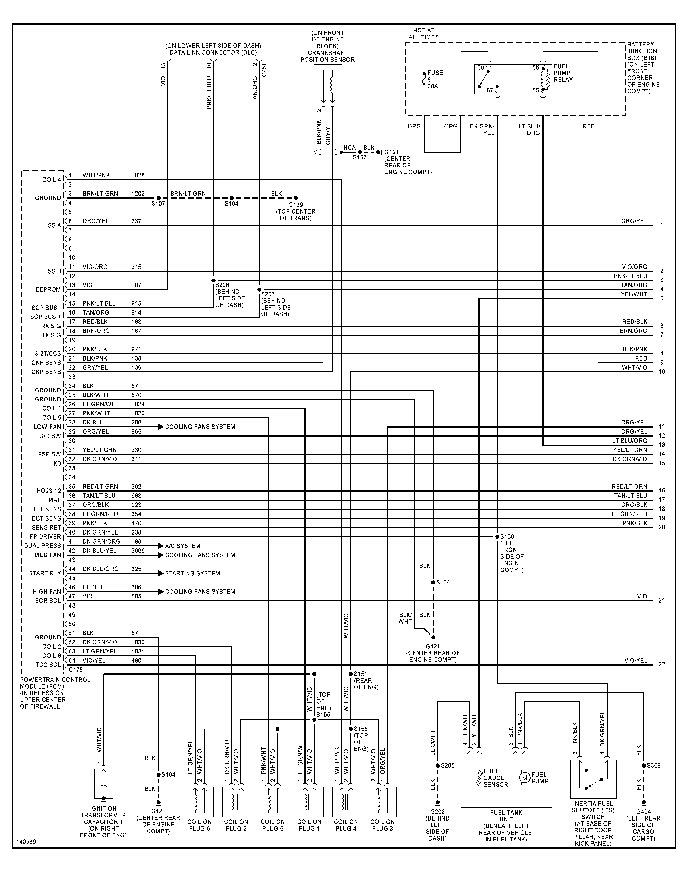

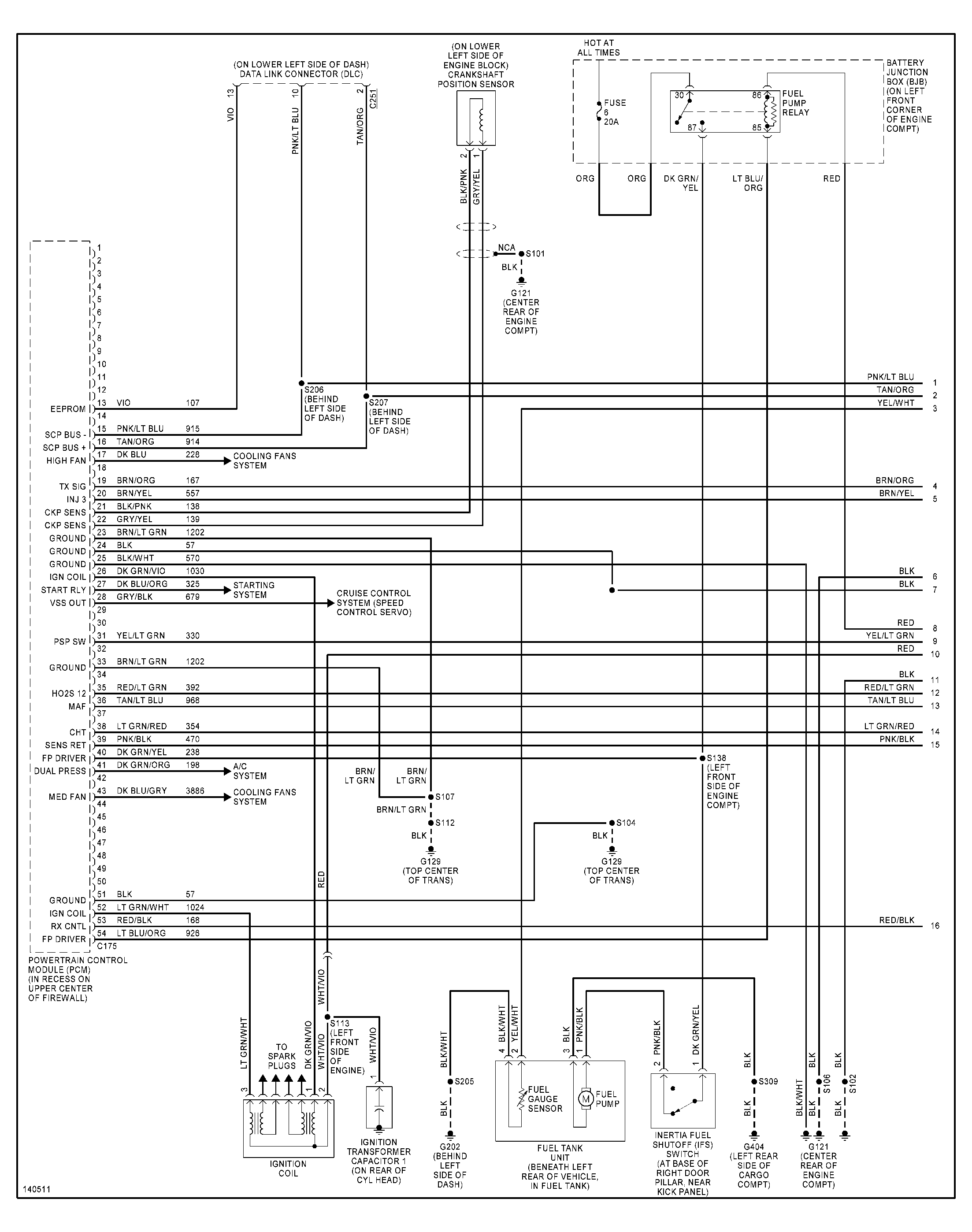

There is a list of things this code relates to. All of them point to no power to the fuel pump.
Here is what I need you to do. Remove the fuel pump relay from the relay box and disconnect the PCM wiring harness. Check for corrosion on PCM connection. If nothing is found, check the resistance between PCM harness and relay harness. If there is less than 5 ohms, special test equipment is needed to continue the circuit. There is an open circuit on the system. If there is more repair wiring or pins.
Here is a list of possible causes for this code:
Open circuit between fuel pump and fuel pump power circuit
Poor fuel pump ground
Fuel pump internal open
Fuel pump secondary circuit shorted.
Fuel pump relay contacts always closed
Open between PCM and fuel pump circuit
I attached wiring schematics for both the 2.0L and the 3.0L. NOTE: The first one is the 2.0
Let me know what you find. Sorry it took long to get back to you. I had to do a lot of reading on this one.

Hi. This Escape won't start. I put my scanner on it and received the following error codes:
FORD.ENGINE.FUELSYS Fuel System Status
(Open/Closed Loop) Open Loop
And also:
P0232 - Fuel Pump Secondary Circuit High
I checked the fuse and it is OK. I don't know how to check the relay. I also don't know where the fuel pump is (Under the front passenger seat?) to check it. What do you think?

Check the fuel pressure with a fuel pressure gauge designed for your fuel system and comeback with the readings this is where we start-
Or do below and tell me what happened-let me know asap
Get a starting fluid or ether and spray into the carb or the throttle body on an EFI. Did it start and die? If not disconnect a sparkplug wire or 2 and ground it to the engine -have helper crank engine over-do you have a snapping blue spark? If so-you have a fuel related problem, check the fuel pressure to rule out the fuel filter/fuel pump/pressure regulator and listen to the injector/s are they pulsing or hook up a noid light. No snapping blue spark continue to troubleshoot the ignition system-power input to the coil/coil packs,distributor pick-up coil, ignition control module, cam and crank sensors- Note: If it doesn't apply disregard it
P0232 Engine Fuel Pump ckt
The fuel pump secondary control circuit deals with the fuel pump driver module (another word for computer) which is use to regulate the fuel pump pressure. By using a fuel sensor located in the fuel rail, the engine computer can regulate the fuel pump pressure by monitoring the fuel pump duty cycle.Using this duty cycle range, the computer can determine when to shut off or increase the fuel pressure for optimum engine performance. Therefore, if the duty cycle is below or higher than the targetted range, it will set a code like the above or a code related to the fuel pump secondary control circuit which could have an errant reading. When this happens, the fuel pump driver module will set at a default usually set at 100 % duty cycle. For basic test, check connections of the wirings/grounds related to this circuit by using ATS wiring diagram.

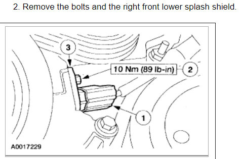

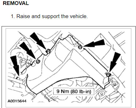

G.SMITH93
Two days ago it failed to start, i assumed the fuel pump went out, live in temperatures below freezing, extremely low gas. I tried it later that night and it fired right up. Next morning fired right up took it and filled the tank immediately ran errands went home for a few hours, attempted to leave would not start, turns over strong trying to start. This morning started right up! Autozone said O2 sensor bad fuel cap and cylinder four misfiring. my question is can one of those cause the intermittent fuel problem? I changed my cap and put in injector cleaner/water remover.
Aug 12, 2020 at 6:48 AM (Merged)
  • 55,549 POSTS
This sounds like a crankshaft angle sensor is failing which can happen without triggering a check engine light. Here is a guide to show you what you are in for when doing the job:
This is what it will be like for your car (below).
Here is a guide that covers all of the bases:
