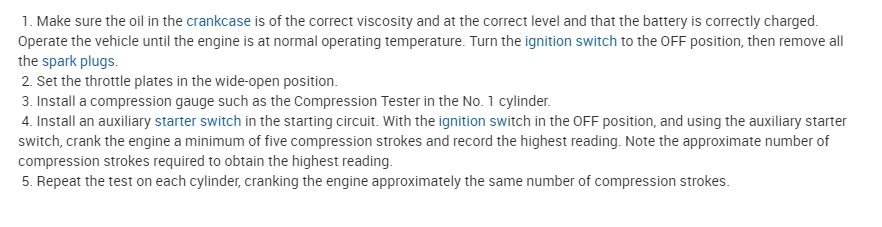

The first thing I would do is a compression test to see if the cylinder has any internal damage. Low compression will cause this.

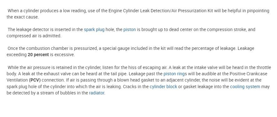

If the pulse is good, the cam lifts are okay, then move onto a compression test and then a leak down test if the 32 failed the compression test.

Did you check the compression on number 1? I would verify that.

Did a leak down test via Ford scan app, which passed, will do actual compression test this week. 2 weeks ago it started rough, I changed the oil used Castrol edge high mileage.

Valve spring would do it all the time. If you want to double check, do a running compression test. That will tell you if you have a bad valve spring.
A vacuum gauge will also tell you.

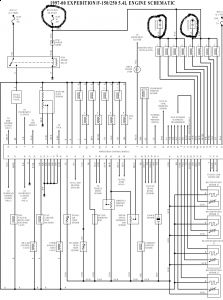

Ok so my 2000 f150 starts misfiring, then doesn't start, had it towed and come to find out a 30 amp fuse blew to the PCM. PCM has a bad cyl.6 driver. I get a new ford PCM, Motorcraft cop, plugs, injector, cleaned the egr, cleaned the maf sensor, did a compression test and still a misfire in cylinder 6. The truck doesn't have any engine noise and when you push the pedal to the floor it takes off, but as soon as she goes into OD it gets rough. I've spent a whole lot of money and man hours into this. PLEASE HELP!
Monday, May 10th, 2021 AT 11:03 AM (Merged)
MATHIASO
  • 1,209 POSTS
Hello romosbuddy
According to the diagram, the PCM and the COPs share the 30 amps blown fuse
(Coil on plugs).
There is a capacitor on each side of the COPS. Check them.
Replace the coil on #6.
Pay close attention to the tube that wraps around the spark plug. Cracks can allow voltage to jump to ground causing a misfire.
Clean the COP connector and wiring harness terminals. Corrosion at either place can cause intermittent operation and loss of continuity, which may contribute to component failure. Applying to these connections can help prevent corrosion and assure a good electrical connection.
