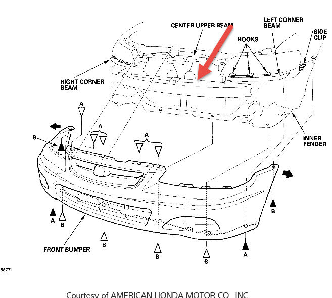

MTRANDYD237
  • 2002 HONDA ACCORD
  • 2.3L
  • 4 CYL
  • FWD
  • 150,000 MILES
Told it's a faulty front crash sensor. Where the is the crash sensor located?
Saturday, February 9th, 2019 AT 8:05 PM (Merged)
HMAC300
  • 48,601 POSTS
We don't have a pic of that but arrow points in general area. DO NOT ATTEMPT TO REPLACE THIS YOURSELF BY ANY MEANS.
MTRANDYD237
Why shouldn't I change this myself? So long as I disconnect the battery before beginning any of the work it should be OK. Right?
HMAC300
  • 48,601 POSTS
Don't say you have not been warned and you can't make the light go out anyhow unless you have a pro model scanner
