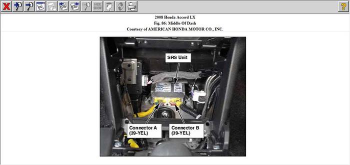

Where is located the MES connector I am trying to reset the srs unit?
Feb 9, 2019 at 12:01 PM (Merged)
  • 75,992 POSTS
SRS unit in middle of dash. here is a video that will help you reset the codes check the diagrams below for the connector location:
