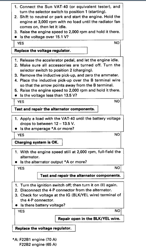

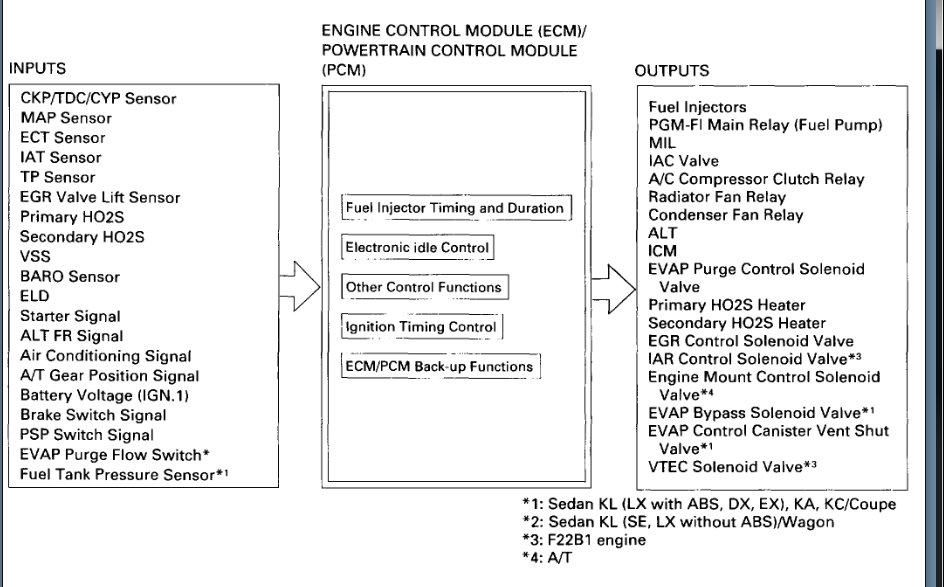

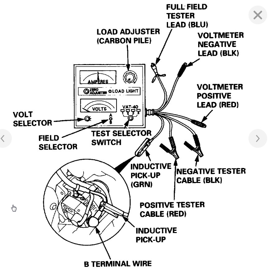

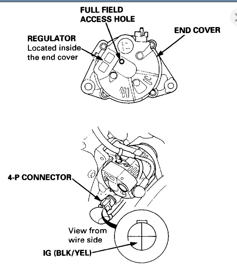

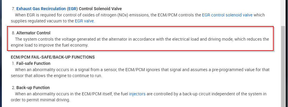

CPAMBURGY
Car has been daily commute no issues until battery light came on. Had alternator and battery tested. Alternator tested as overcharging the battery 16.6. Replaced alternator and battery. Battery light is still on. Starter has also been replaced within the last month. What could be causing the issue? At times the light flickers off and on. Any ideas?
Aug 25, 2020 at 5:48 AM (Merged)

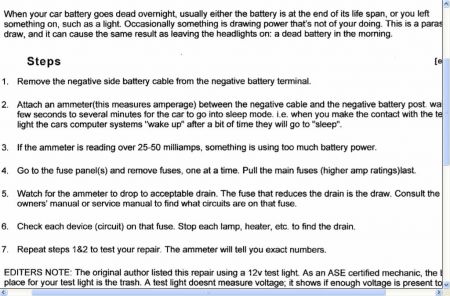

The battery light coming on only indicates the operating voltage is low. If the alternator and battery have been replaced, it is possible that the ECM is the issue. Your vehicle has the voltage regulator inside the alternator but the ECM is what controls the regulator. It is less likely that they ECM is the issue on these types of vehicles but if not tested properly on the vehicle with what is called a VAT 40 tester then we don't know that.
I attached the tests for you to review but again, we need to find a shop with this tester so we know for sure which is the issue.

SASIFIED
my battery light keeps coming on and off mostly when i slow down or am going at a slow rate of speed. ive turned on my radio and lights to see if it stays on but it seems to go off most of the time when i do that. ive replaced the alt. and battery and have even put new connectors on it. and all my fuses are ok. could it possably be a short?
Aug 25, 2020 at 5:49 AM (Merged)
  • 75,992 POSTS
Check the alternator belt tension-if okay get the battery and the alternator load tested. Too look for a short in the electrical system do below
https://images.2carpros.com/forum/automotive_pictures/12900_parastic_draw_1_21.jpg
SASIFIED
thanks ill give it a try and let ya know the out come if your right ill keep the donation thing in mind and will for sure use your site again in the future and for sure will donate.
