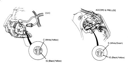

THE T SHIRT GUY
I have a new alternator installed, now the battery light stays on. The voltage is 14.4 with the engine on and 12.3 with the engine off.
I installed it myself, I have some mechanical skill, everything was reconnected correctly.
The new alternator was a reconditioned unit that matched the original. How can I fix this?
Thanks in advance,
Tom
Aug 25, 2020 at 5:50 AM (Merged)
MERLIN2021
  • 17,250 POSTS
Youre absolutly sure ALL wires on the back of the alternator are reconnected?
2CARPRO JACK
  • 11,533 POSTS
Let me know what you find
THE T SHIRT GUY
I will test the plug-in connector for voltage, so if there's a constant line in as well as an ignition line, could one be at fault and the unit still operate?
Is that why the battery light stays on?
Electrical is somewhat puzzling to me. But I'm learning.
I'll get a diagram of the plug-in to refer to.
Thanks again for the input.
MERLIN2021
  • 17,250 POSTS
Be aware Honda manual states "If any fuses are blown, charge light will stay on, even if charging system is working properly! ", so check ALL fuses, even the ones under the hood!
LES H.
I have a 1989 Honda Accord that I just replaced the Alternator on. When the alternator failed the BAttery Light also came on. The voltage across the battery was reading 11.3 Volts with the engine running or not. After replacing the Alternator the voltage is 12.3 across the battery (Not Running) and 14.5 with the car running. Help........
THE T SHIRT GUY
I metered the plug-in connector for voltage, the terminal (S) was zero, checked the fuse- bingo. The #8,ACG(S) 10 amp fuse was blown. I replaced the fuse and checked the voltage at the terminal (S) and now there is voltage.
I puts humpty dumpty back together again, starts up, voltage is at 14.4.
The battery light is out.
Thanks
Tom, the T Shirt Guy

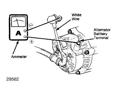

GREASYSNOT
Electrical problem
1985 Honda Accord 4 cyl Front Wheel Drive Automatic
battery lamp stays on, new alternator and is charging at 14.5 volts at idle.
BMRFIXIT
  • 19,053 POSTS
Check alternator wire harness connections check drive belt tension. Battery must be fully charged prior to beginning test. Alternator Output Test With engine off, disconnect White wire from alternator battery terminal. Connect ammeter positive lead to alternator battery terminal, and negative lead to wire just removed. Connect voltmeter to battery. Start engine. Turn on headlights (high beam), rear window defroster, and turn heater fan switch to highest setting. Run engine at 3000 RPM. Ammeter should show about 60 amps for Accord and Prelude, 50 amps on Civic. Check alternator if not to specification.
https://images.2carpros.com/forum/automotive_pictures/99387_Graphic1_538.jpg
