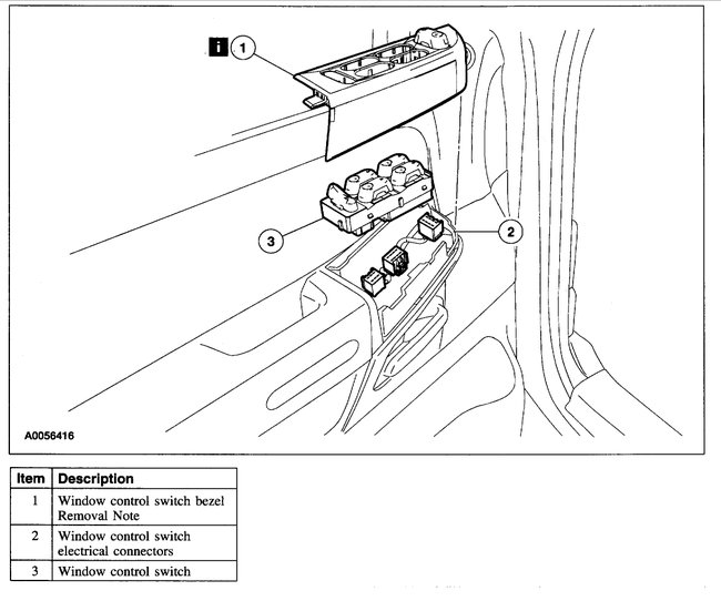

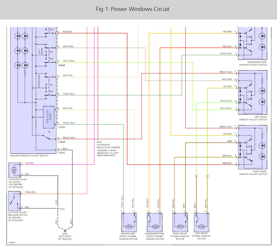

Yes the master switch is most likely bad becasue the entire systems power runs through the main control switch located at the drivers door. Here is a guide that will give you an idea on how to test it.
https://www.2carpros.com/articles/electric-window-repair
and
and

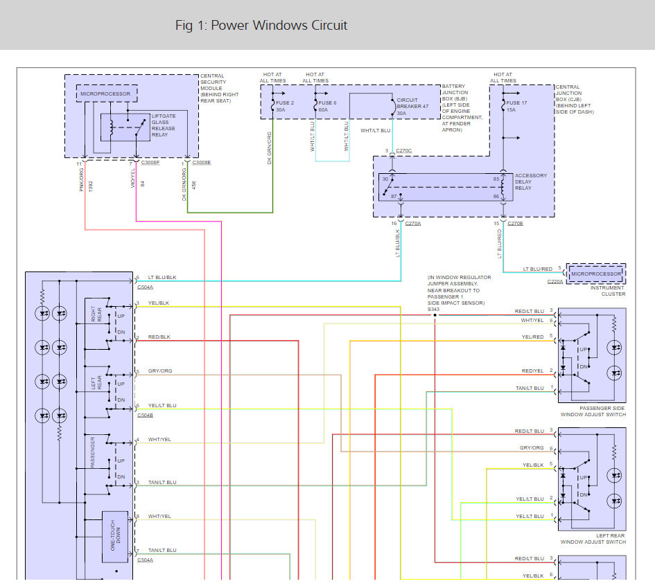

Here is how it will be to change the switch in your car and I will include the wiring diagrams so you can see how the system works. (below)

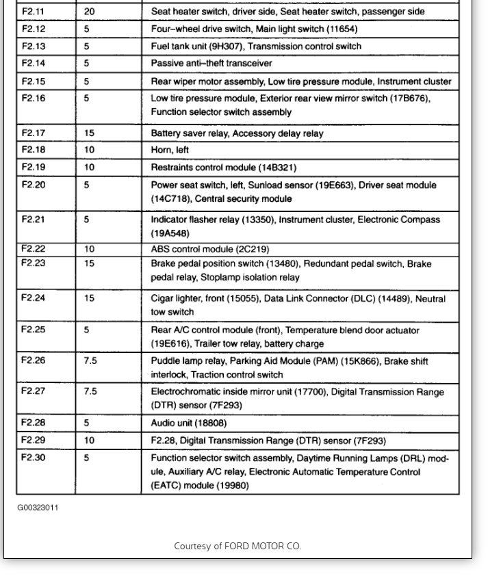

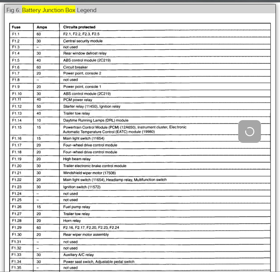

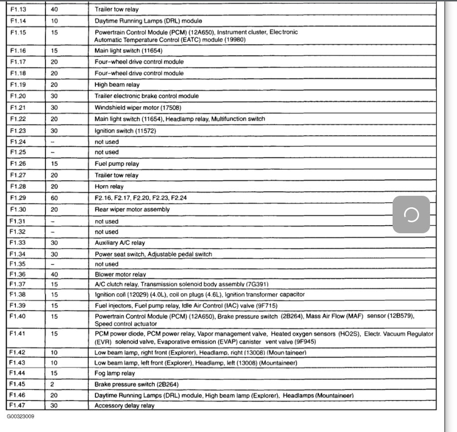

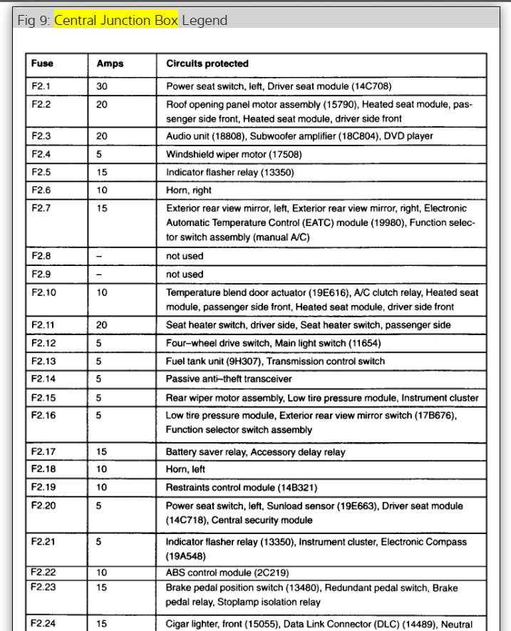

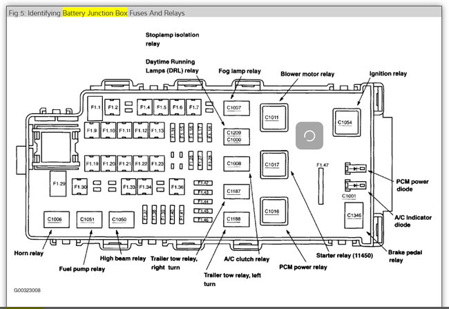

Alright left side of engine compartment drivers side at the fender apron in the fuse box see if fuse number 6 60amp has power to both sides.Also behind the left side of the dash in the fuse box fuse number 17 15amp see if there is power to both sides of that fuse.Let me know what you find.

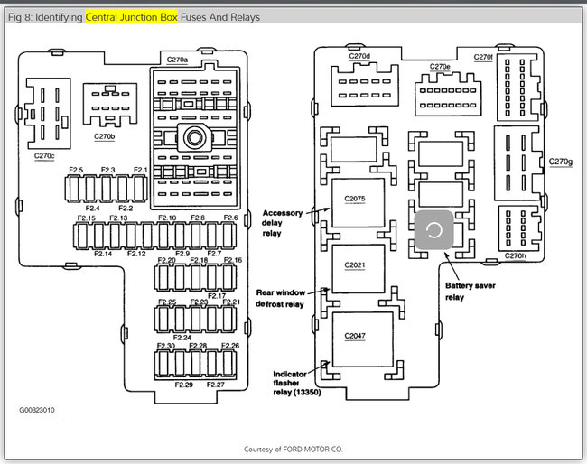

Stopped working, checked sixty amp fuse under the hood checked the number seventeen underneath the steering wheel. I am not sure if it is the relay or not and or where it is.

Ok behind the left side of the dash there will be a light blue wire with a black stripe coming out of thr fuse box it should have power with the key the run position.

Now key in the run position go to the master window switch on the drivers door see if the light blue wire with a black stripe has power going into the switch?

I have looked at the sixty amp fuse under the hood it is okay I believe the thirty amp relay under the hood is also working properly I am getting power to the fifteen amp fuse that people online say controls the power windows in the driver's compartment. I am also getting power to the blue wire with the black stripe leading into the drivers cluster I cannot figure out why my windows are not working.

Activate the driver's window switch while measuring the voltage on the black wire at that switch assembly. All voltage measurements should be done with that switch plugged in, to be accurate. Back-probe through the back of the connector next to the wires.

Please understand the moderators on this website answer questions in our spare time so we dont always get right back to you.So now key in the run position at the drivers master window switcb with the passenger front window switch in the up position you should have power on the white wire with a yellow stripe.Same switch down position tan wire with a light blue stripe should have power.

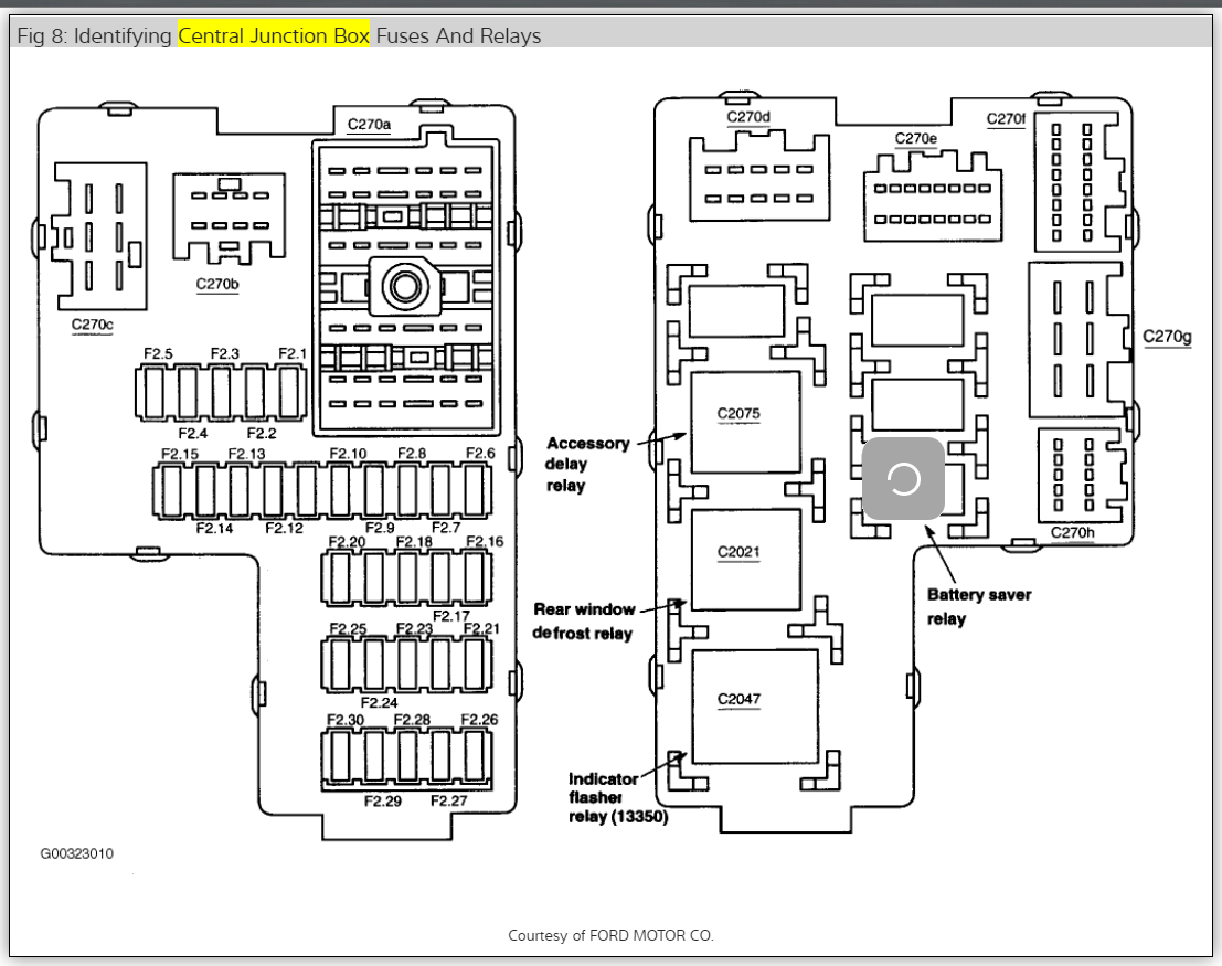

Which fuse controls the power windows? The owners manual doesn't mention power windows.
Nov 10, 2017 at 3:42 PM (Merged)
  • 110,194 POSTS
Have you checked on the inside of the fuse box cover?
