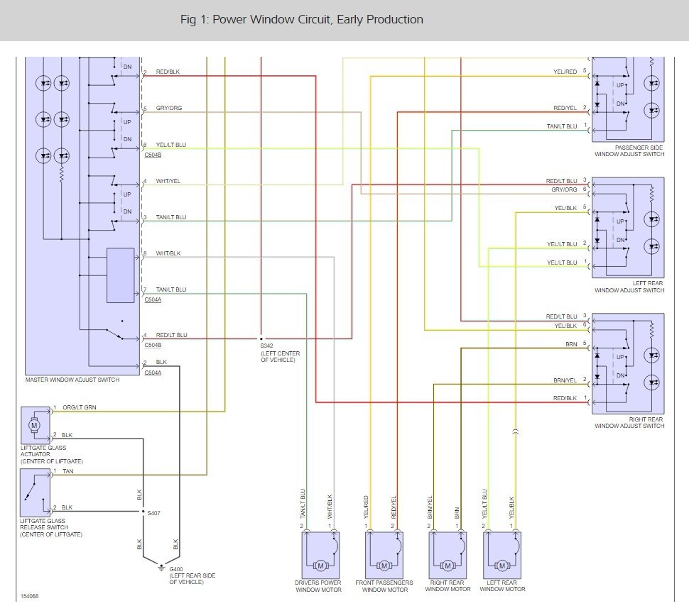

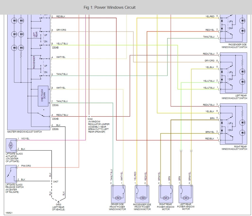

The back left side window will not go down. All other windows work using either the main window console on the driver door or the switch at the door itself. Only the back left window will not go down by using either switch. Main console on driver's door or switch at the door. Could possible issue be fuse, relay, motor or electrical connection?
Friday, June 13th, 2008 AT 8:03 PM
20 Replies
MASTERTECHTIM
  • 4,750 POSTS

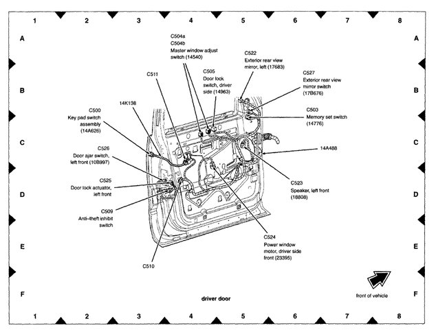

Most likely problem will be a faulty window motor itself, not wiring. if you remove the door panel you can put a test light across the 2 terminals at the window motor and operate the switch and if the light lights up then for sure the motor is bad. you can also slam the door while holding the window switch down and see if that jars free a stuck window motor.
Here is how you test the motor and window wiring diagrams so you can see how it works with the fuse location as as well along with how to change the window motor out if it turns out it is bad.
https://www.2carpros.com/articles/electric-window-repair
and
Check out the diagrams (Below). Please let us know what you find. We are interested to see what it is.

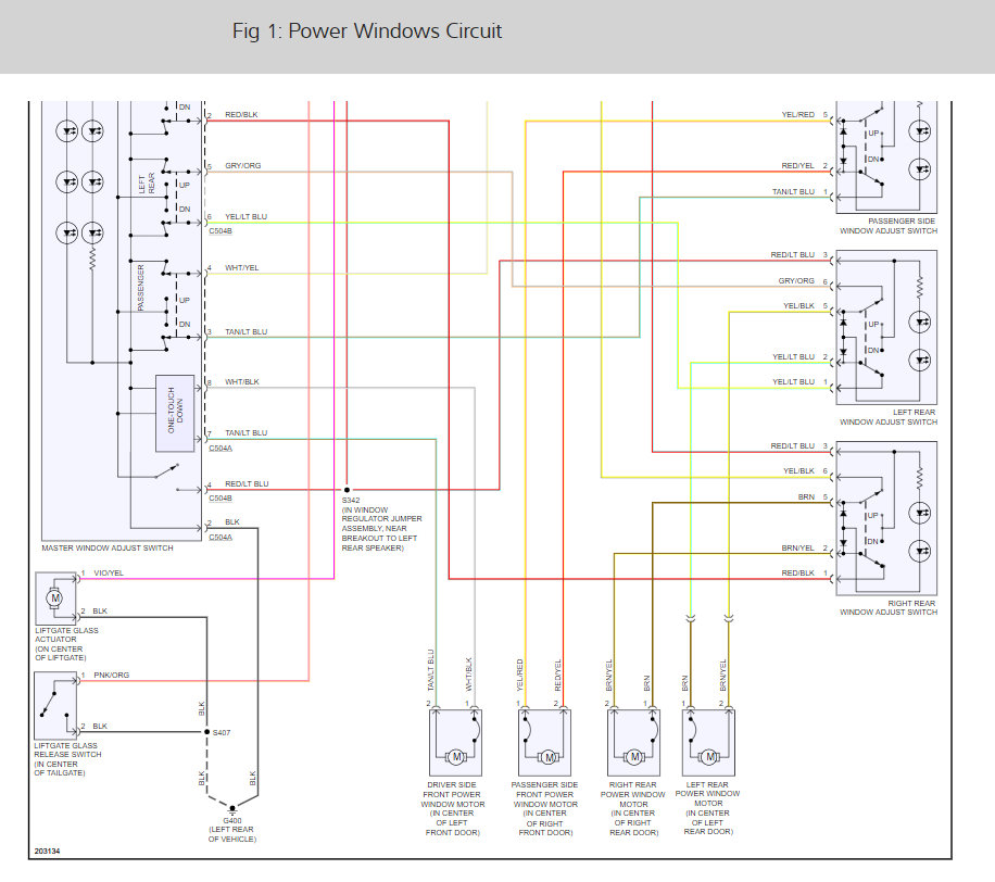

None of the power windows will not go down at any window position from any window switch. I checked the fuses and relays. All good. Could it possibly be the master window switch?
Friday, August 2nd, 2019 AT 5:25 PM (Merged)
HMAC300
  • 48,601 POSTS
Yes either that or a broken wire in door jamb or lock is on at master switch.

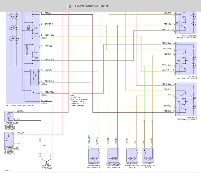

KEN L
  • MASTER CERTIFIED MECHANIC
  • 54,333 POSTS
Hey Bootdog
Here is a wiring diagram to help with your testing
Please let us know what you find so it will help others.
Best, Ken

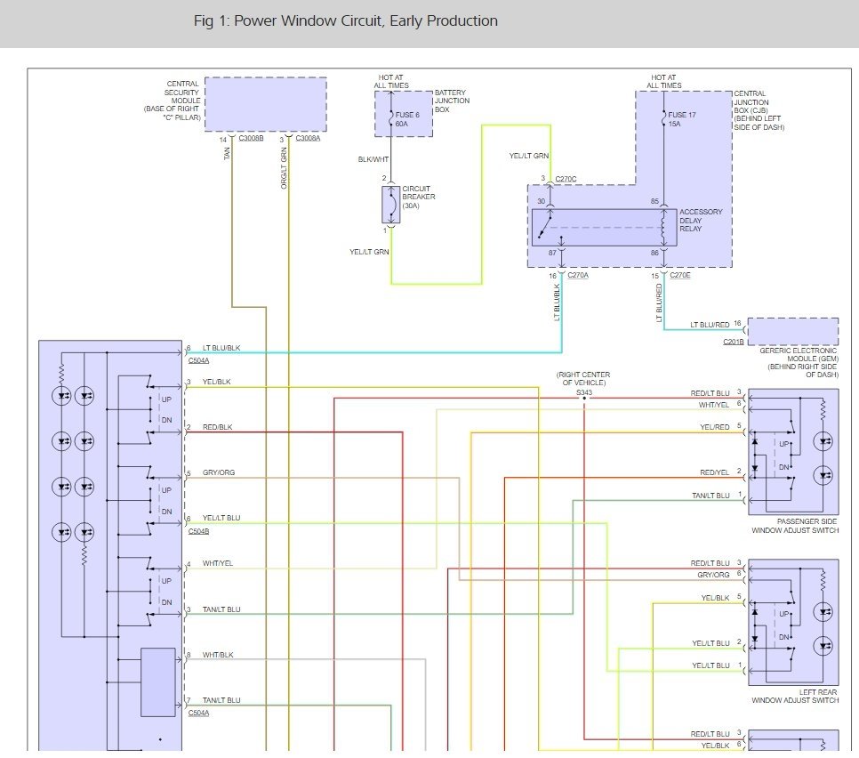

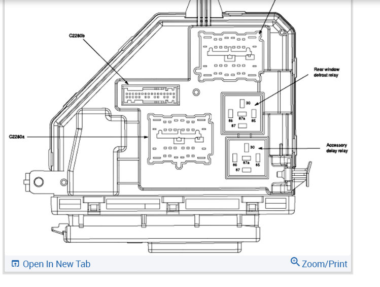

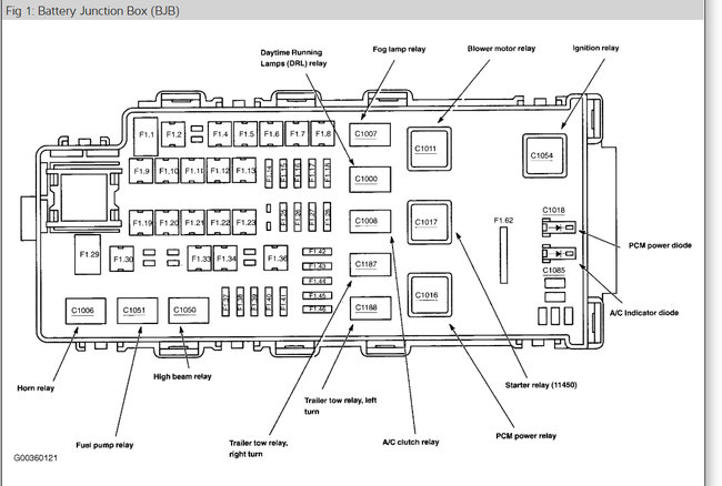

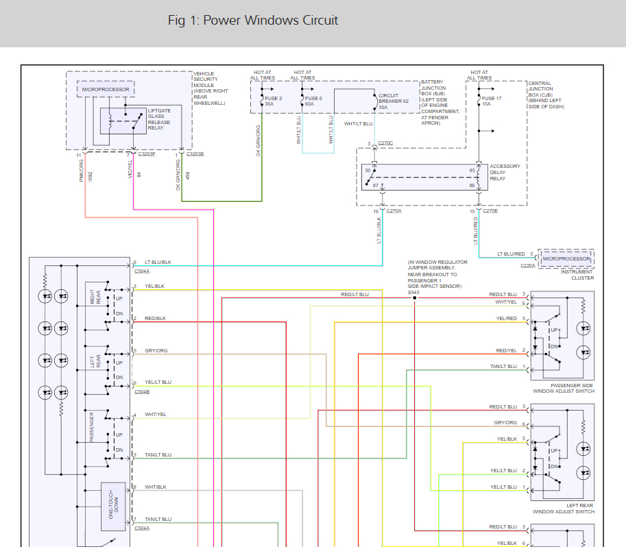

All power windows on my 2002 mercury mountaineer stopped working at once. I have no power at the connectors that plug into the swithes. The owners manual doesnt say which fuse controls them. The ground is good at the switch. I tested all the bigger fuses with my tester (20 amps and up)which were all good and I dont have any shorts. Is there a relay or something I'm missing? It has 60 k on it and its got a 4.0L v6
Friday, August 2nd, 2019 AT 5:26 PM (Merged)
PEPPERMRJ
  • 1,158 POSTS
Hey julius,
That year merc had two wiring schemes for the PWs, an early and late design. Both have a 60 amp fuse (#6) in the pwer junction block under the hood.
Then there is either a 30 amp fuse (#47) in the same box or a circuit breaker on the way to the central junction box.
Both have a 15 amp (#17) fuse in the central junction box. They also share an accessory delay relay.
The relay is controlled by a Gem (generic electronic module) module. I remeber seeing something about these going bad because of a leak in the windshield cowl on explorers.
All power goes to the master switch first and then to the individual switches on the doors.
If you are getting no power at the master switch, check the fuses/circuit breaker first, swap out the relay next, and then check the Gem module.
If that doesn't work following wires looking for a short is the next step. PITA!
Good hunting and let us know. :)

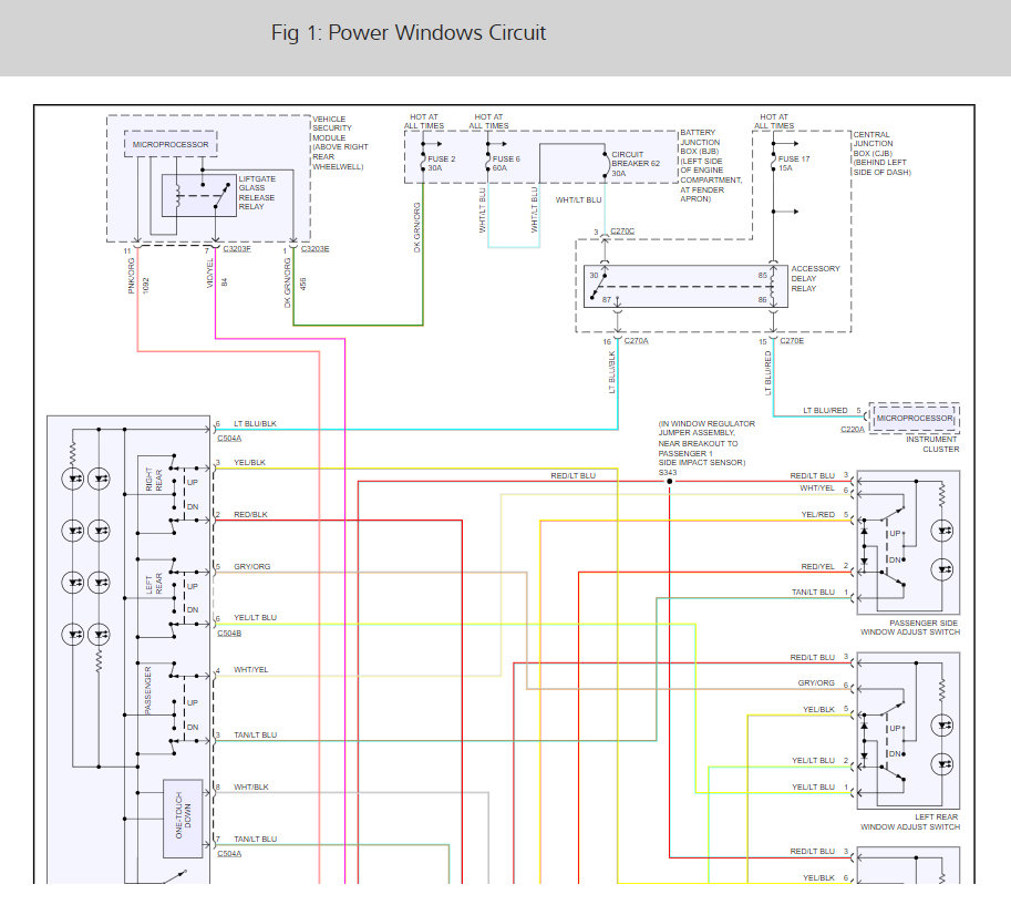

MARK MAKAREWICH
  • 10 POSTS
  • 2002 MERCURY MOUNTAINEER
  • 4.0L
  • V6
  • AWD
  • 180,000 MILES

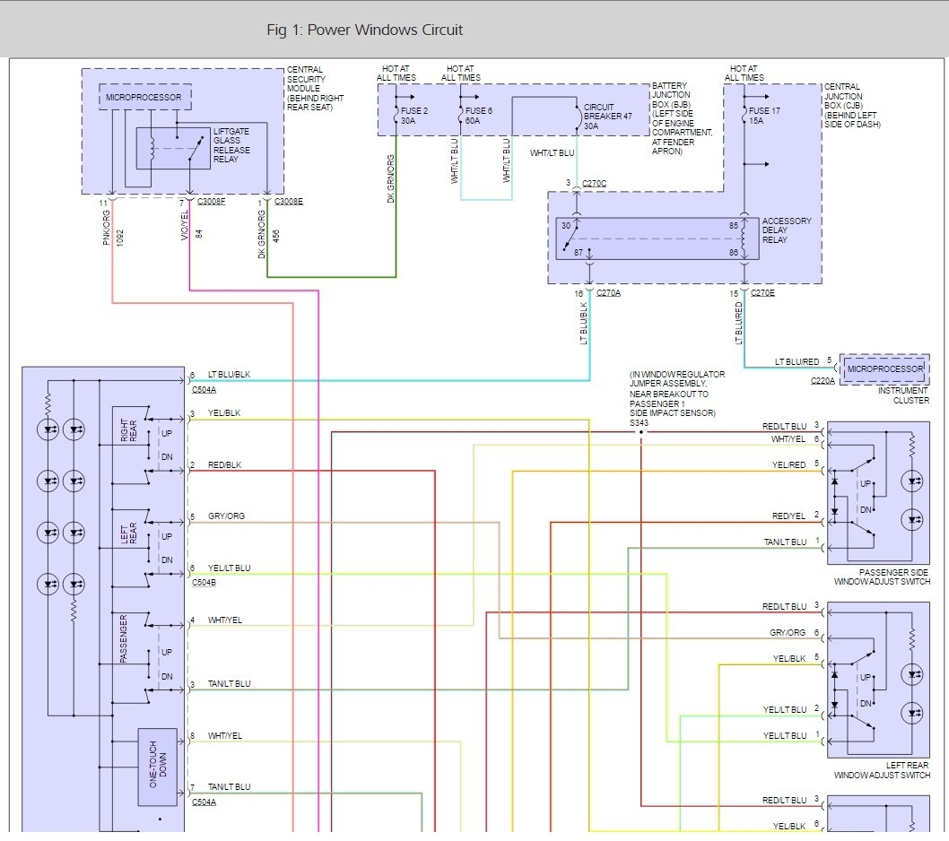

Power windows not working. Tester light comes on when I touch one of the sixty amp prongs under the hood in the power distribution center but not the other. The relay and the fuse under the driver side dashboard also test positive.
KEN L
  • 54,333 POSTS

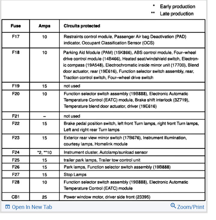

If the key is on then both should light up. Here is the wiring diagram and a guide to help you get started.
and
Please run some tests and get back to us we are interested to see what it is.
