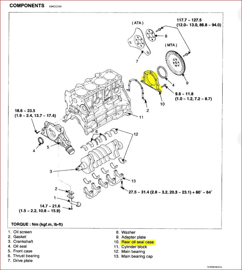

I’ve got the car listed above GLS model with a catastrophic oil loss. It’s on the right side of the engine and isn’t from the valve cover, though it reaches almost up to it. Could this be from a failed pan gasket? Is there anything else on that side that could fail that big?
The upper radiator hose burst, also, but I would think that would just be from overheating after the oil loss.

Sorry, it is the right side as seen from the front of the vehicle. I guess that would make it the actual left side of the engine. That would put the oil filter and main seal on the other side, away from the leak.

I thought it might be the pan gasket, but I’d never seen one blow oil that high on the engine.

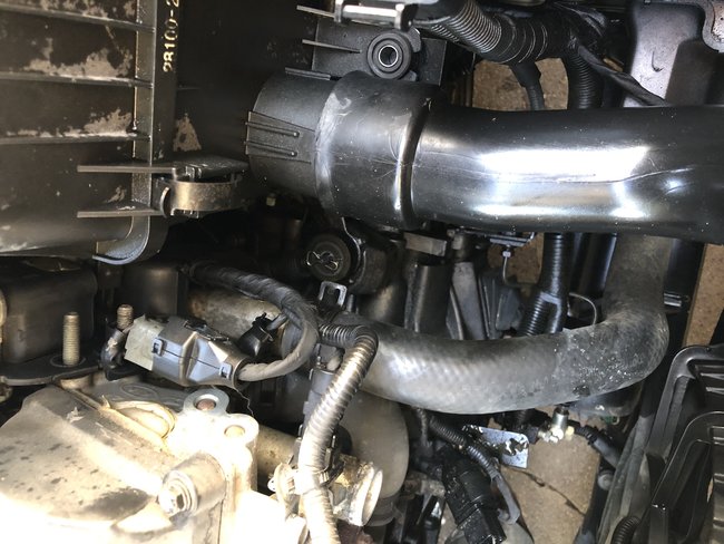

Picture.
Jun 11, 2019 at 9:52 AM

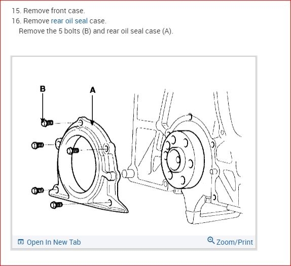

You actually have a main seal on each end of the crankshaft. If the leak is on the side away from the filter then the rear main seal is what I would guess.
I agree with you. A pan gasket normally doesn't put out that amount of oil as you are describing.

Should I replace the seal and the seal case? Or would the seal be the likely culprit?

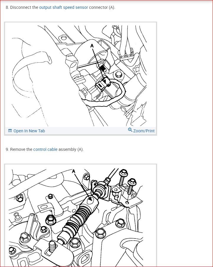

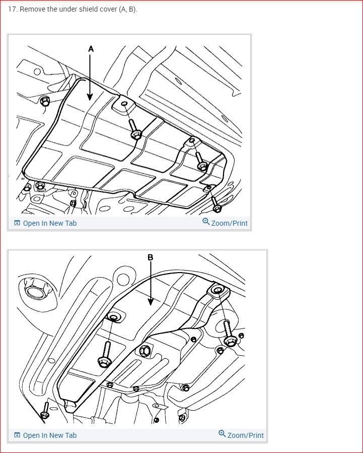

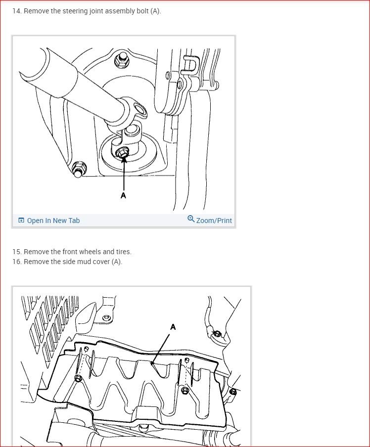

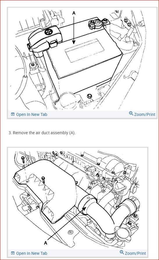

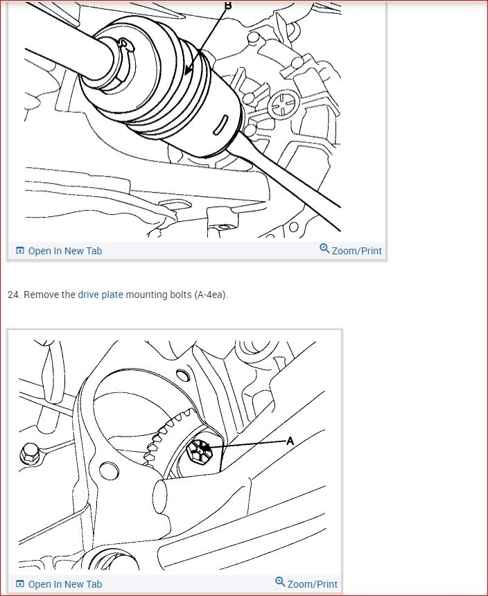

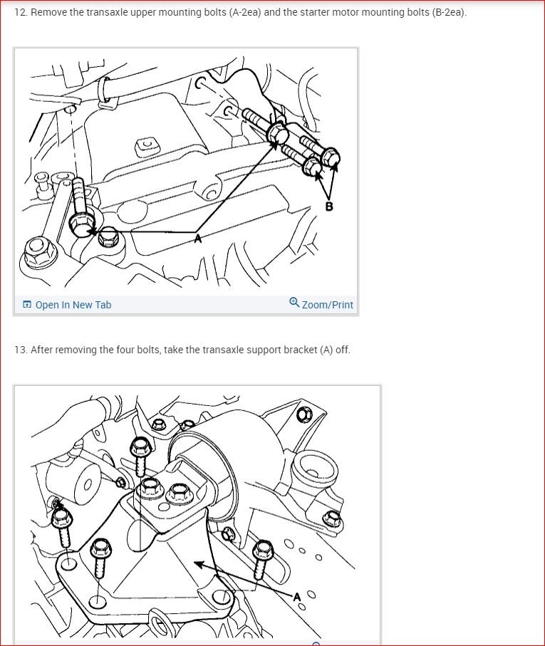

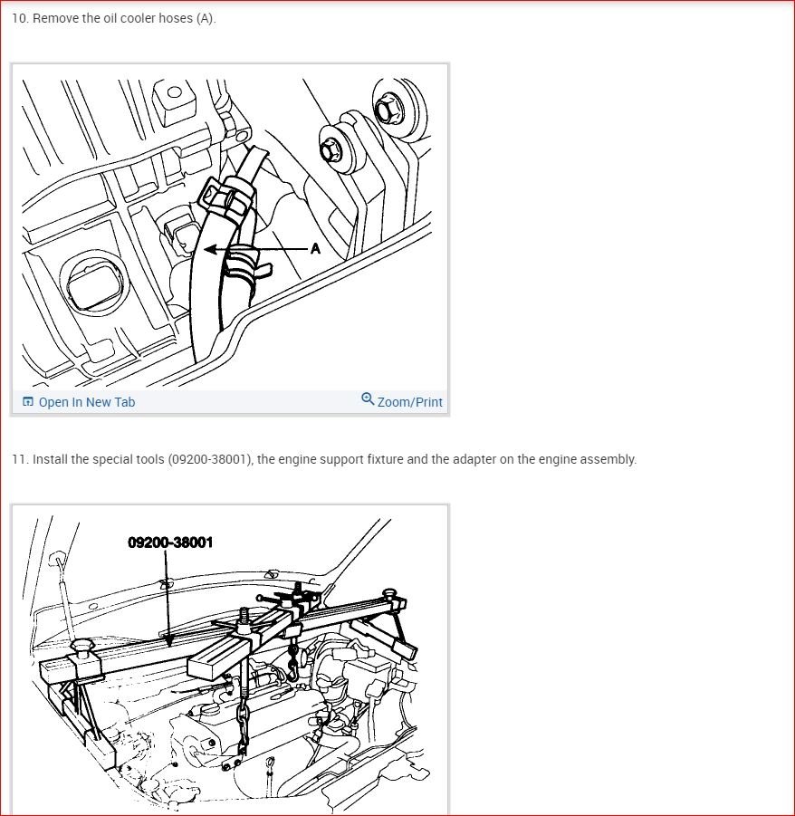

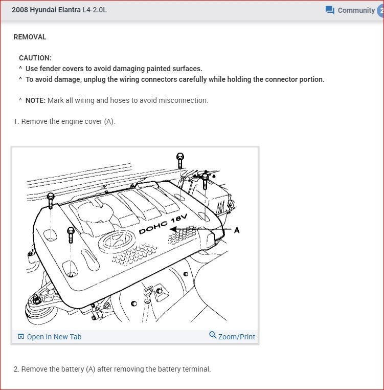

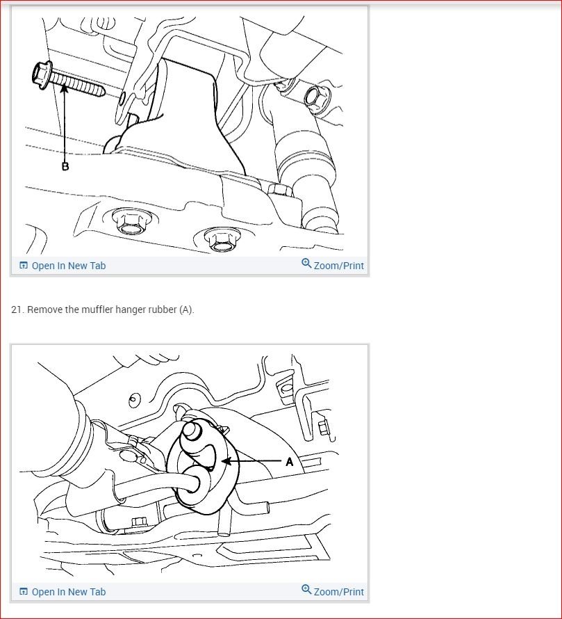

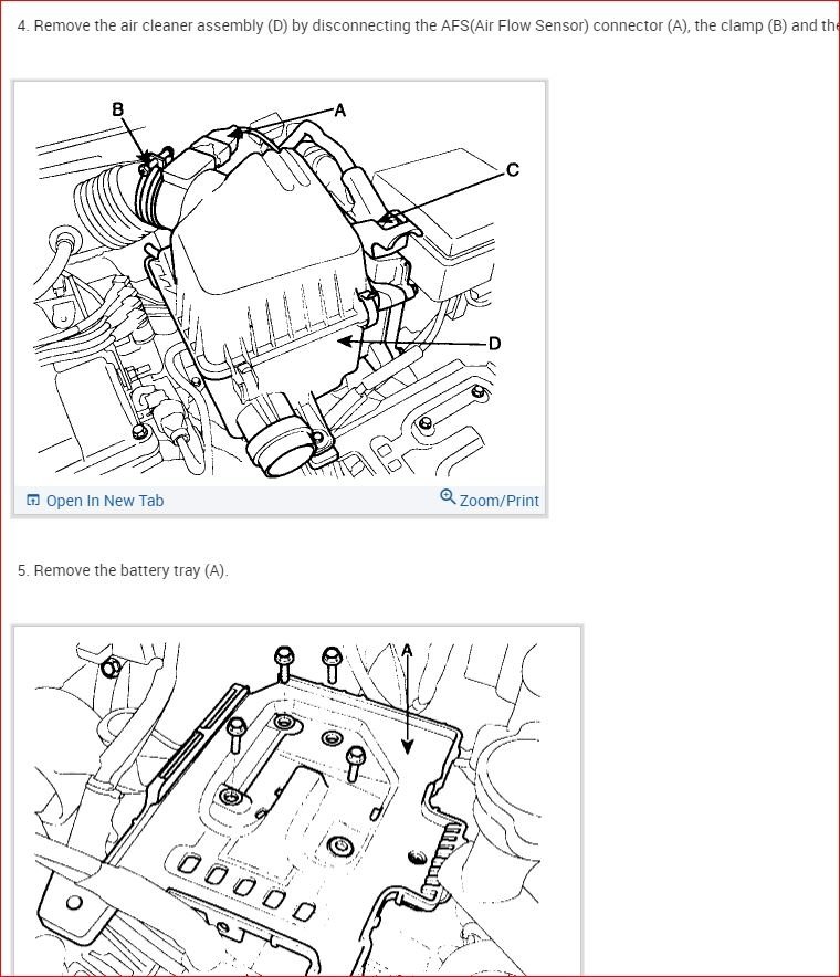

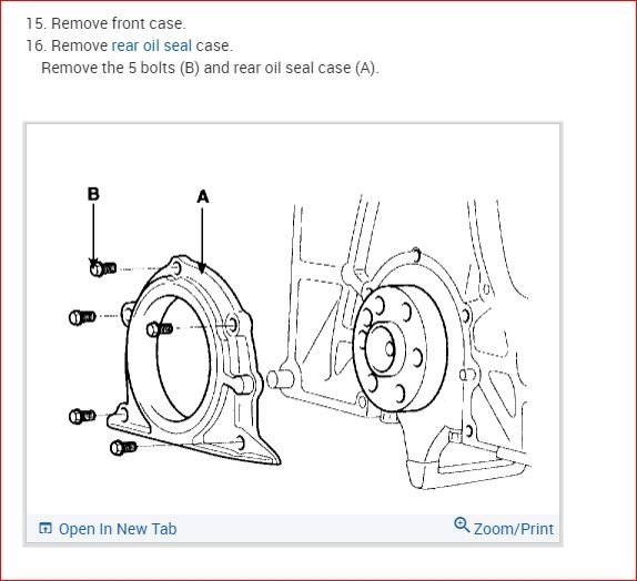

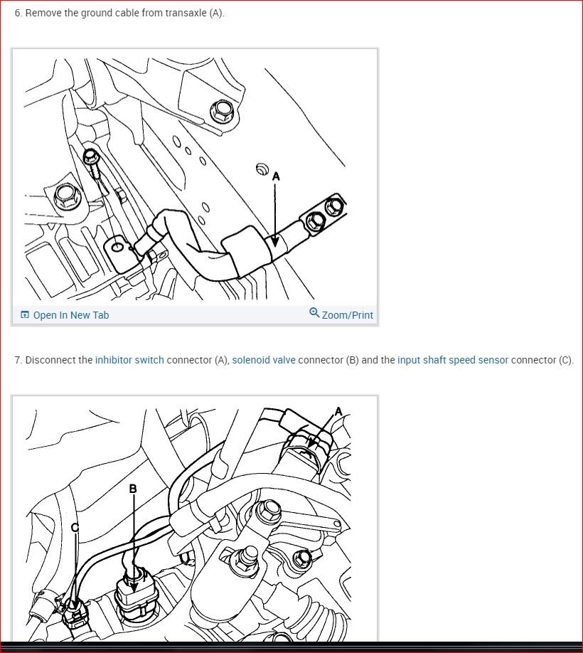

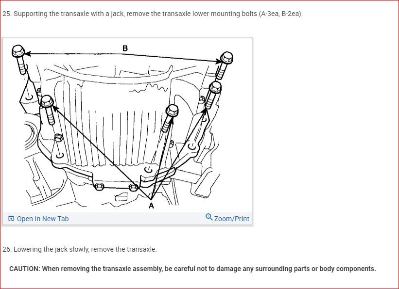

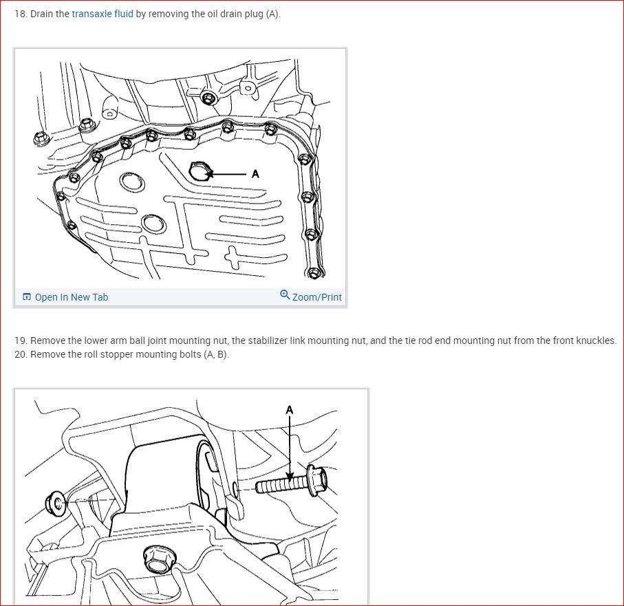

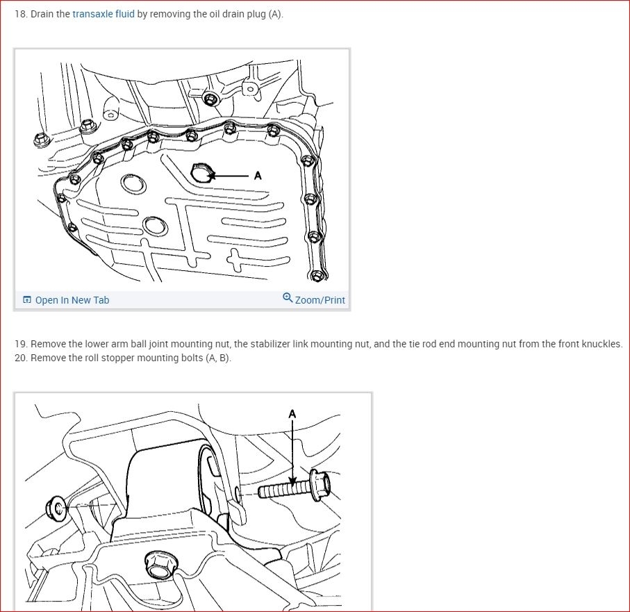

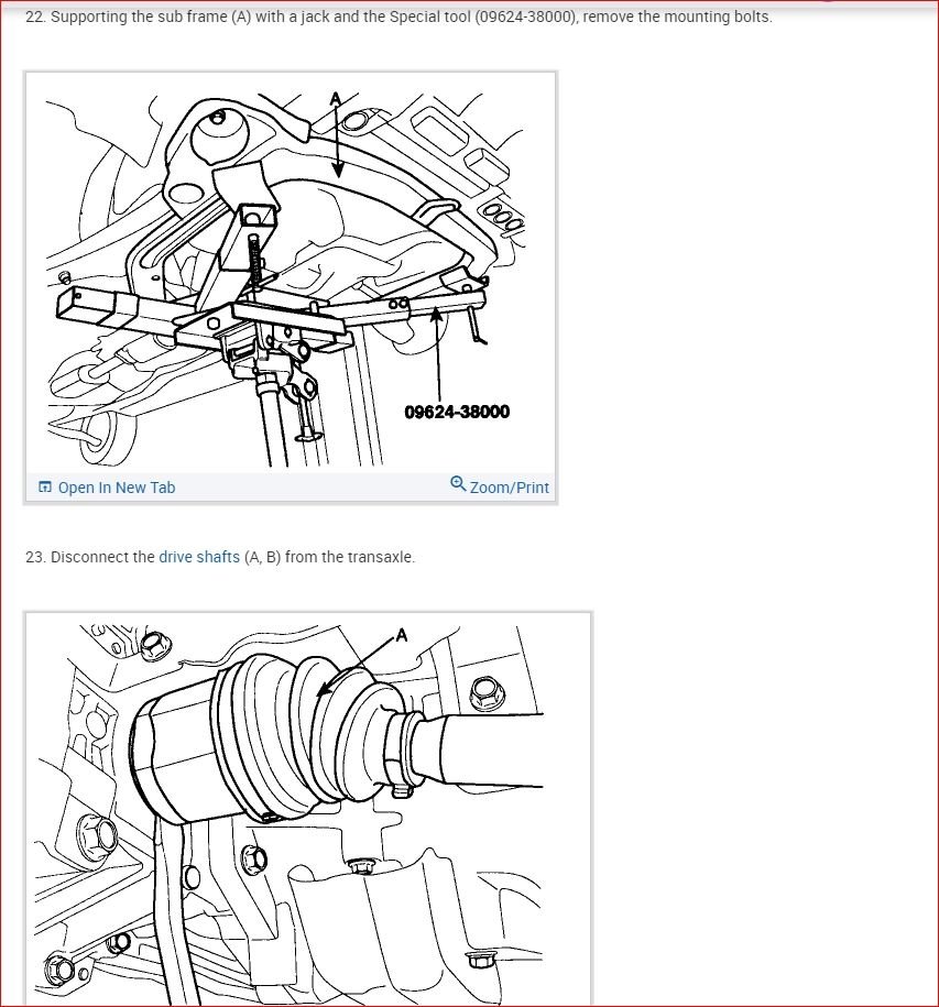

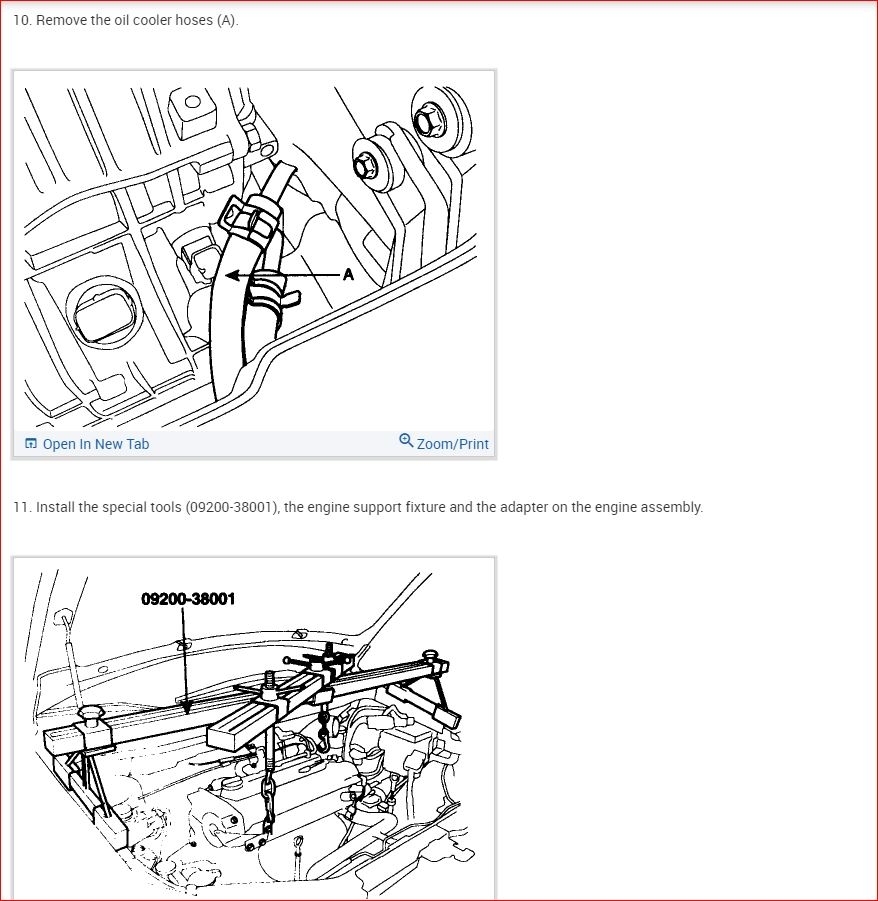

It looks like you can get just the seal as this most likely the issue, but you will want to make sure this is where it is coming from because you have to remove the transmission in order to replace it. Unfortunately, Alldata does not have a specific procedure on how to replace this seal but you have to remove the flex-plate which you have to remove the transmission to get to.
Here is the procedure to remove the transmission. Once this is out, you will see the flex plate and the seal is just behind this.
Let me know if you need more information but again, this is a lot of work so we need to make sure this is it. Doing the dye test will confirm it is coming from there before you disassemble. Thanks
