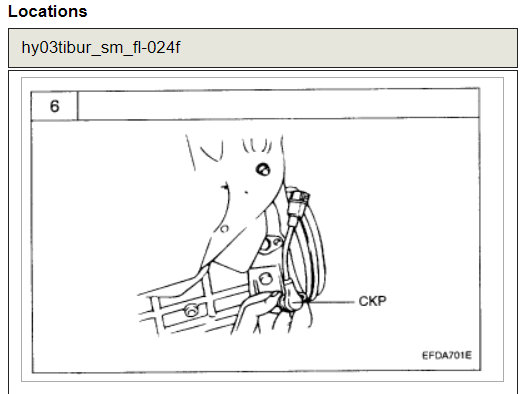

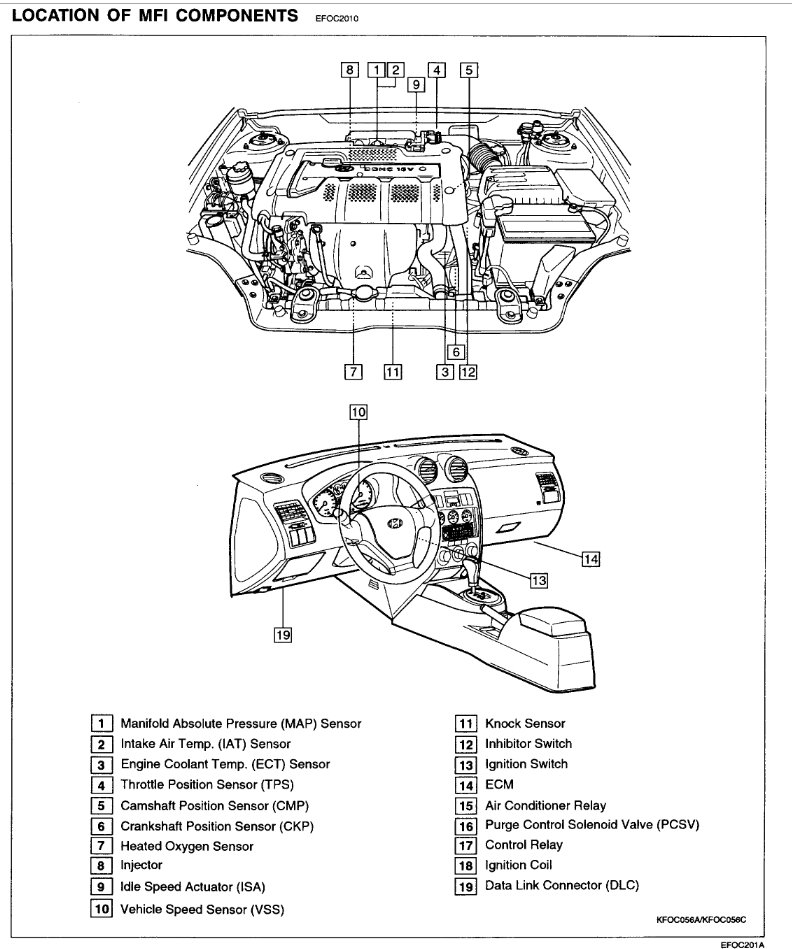

This is sounds more like a crankshaft sensor. Here is a guide to help you see what you are in for when doing the job.
Here is the sensor location for your car.
Check out the diagrams (Below). Please let us know what you find.
Cheers

I went out to check what I could of your ideas to fix this and I was under the hood checking pretty much everything I could from the alternator wires to the maf sensor to the IM ground to the battery ground. Couldnt find the engine block ground. Figured its on the bottom end somewhere. But when I went to start the ar to listen to it run and maybe figure something out that way.
I turned the key into the on position and the radio came on like normal. But only for 2 seconds, then it went off for a second then back on for 2 then off for 1 then back on for 2 then off for 1. You get the idea. So now I am worried that its electrical. So I took it the the shop and they replaced the crankshaft sensor for $240.00 all fixed I wish I did it myself DOH.
