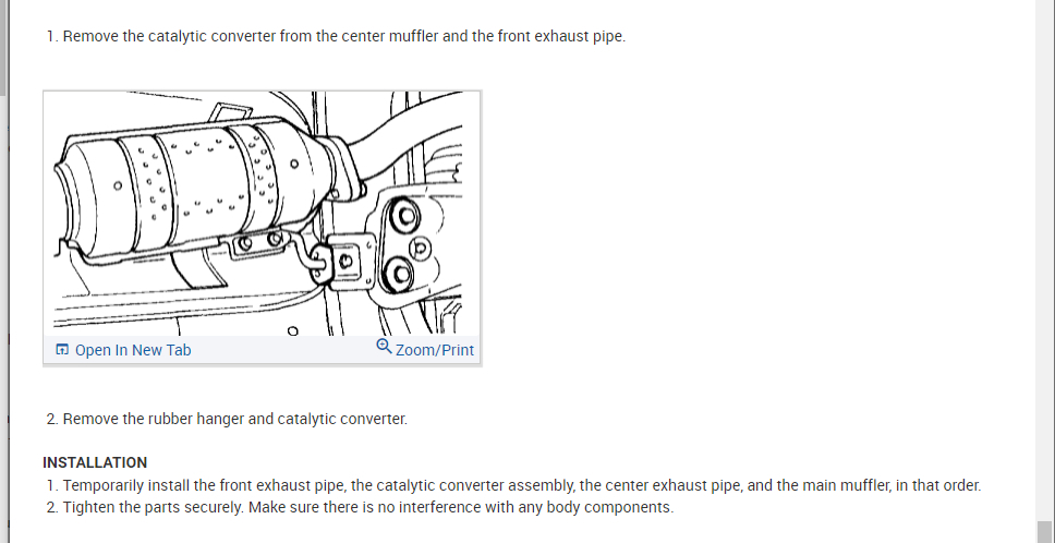

This does sound like a fuel issue but if you changed the pump then we can assume that is okay. However, here is a guide that will help with this issue in more general terms. It will get us started on this issue.
https://www.2carpros.com/articles/engine-stalls
I would suggest we check the fuel pressure just to be sure it is okay.

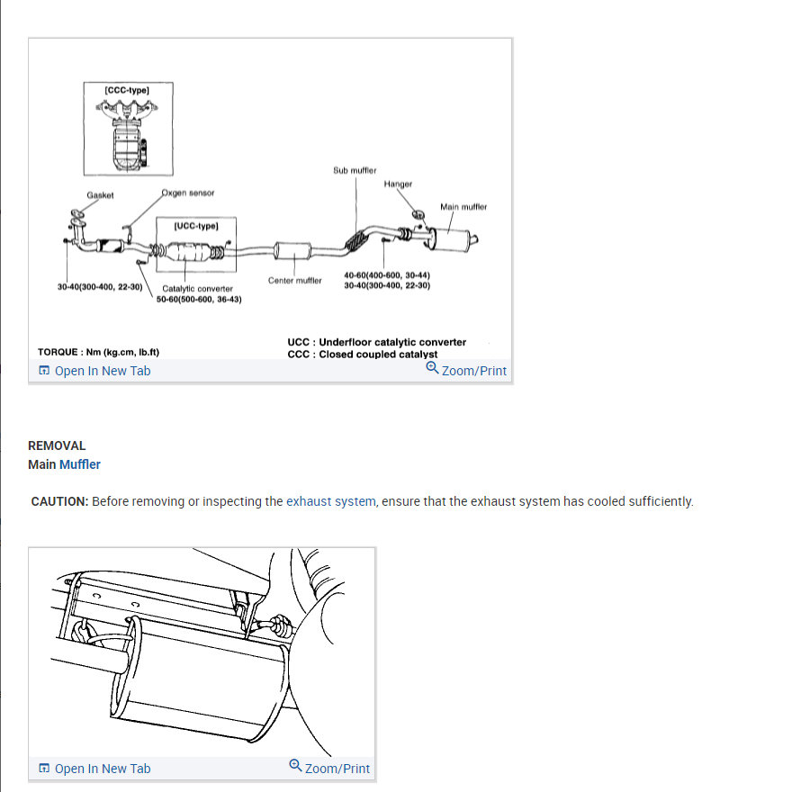

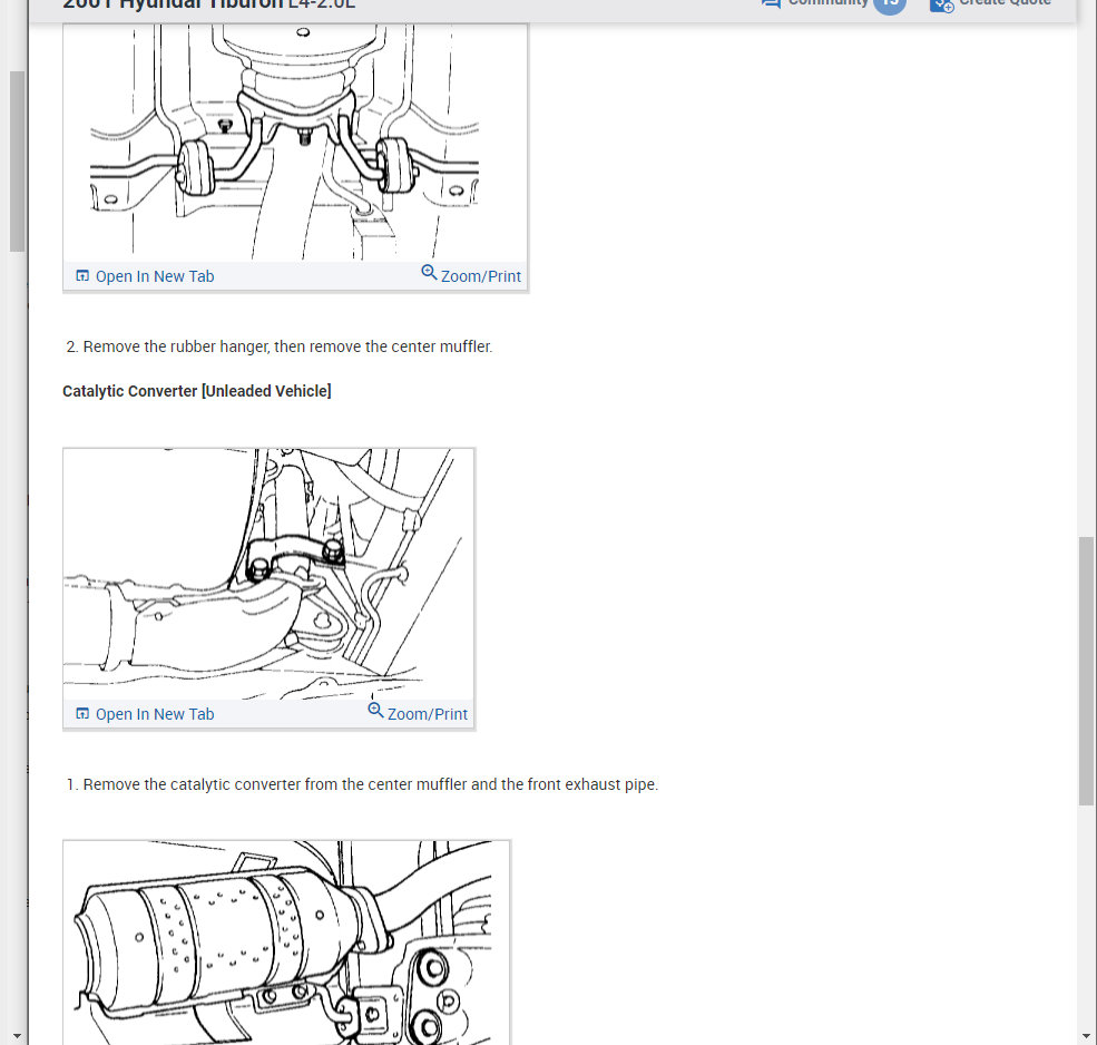

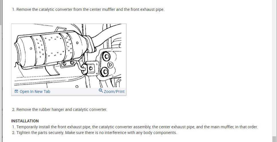

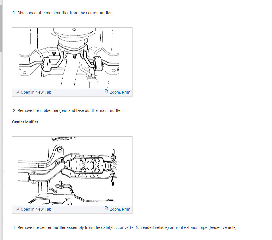

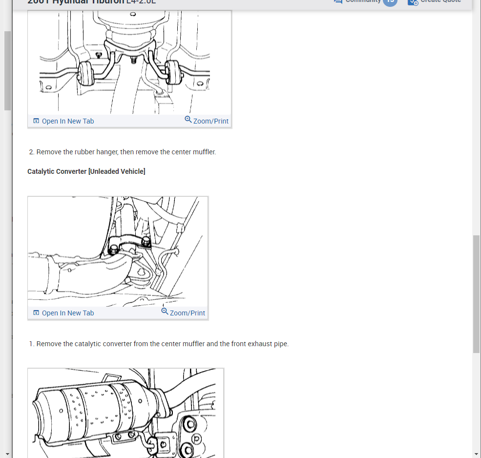

Lastly this could be a restricted exhaust so we need to test the converter and find out if it is plugged.
Below you will find the process on how to replace the converter as I suspect this is the issue.
Once we run through all this stuff we will have a better idea what the issue is. Please let us know what you find with this and we can go from there. Thanks
