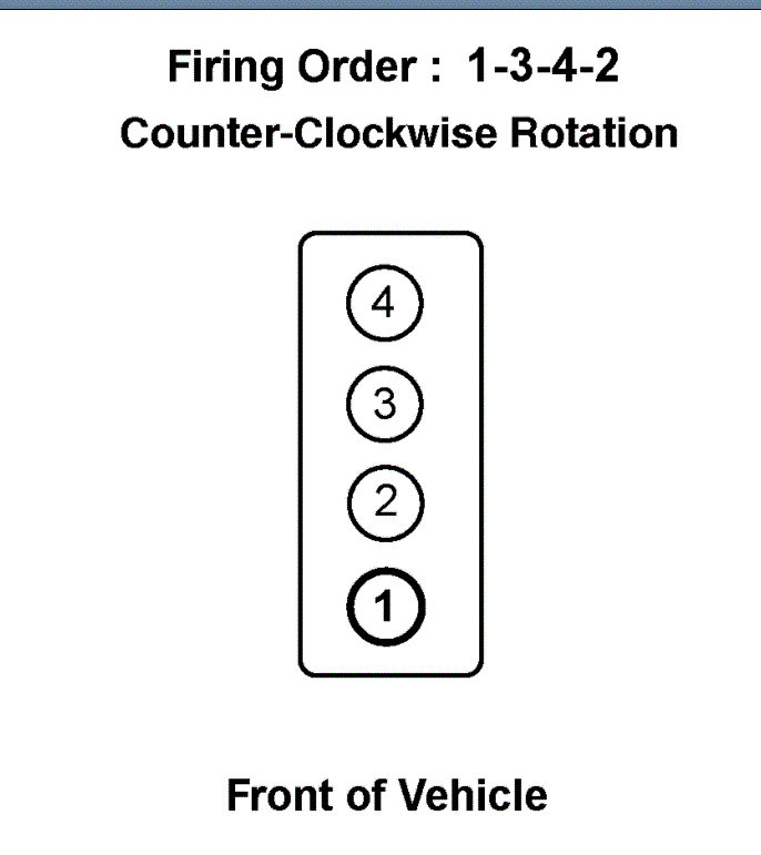

The idea that timing is jumping all over the place leads me to believe that it is something with the distributor itself. If the timing chain was that bad, I feel you would hear it. If you replaced the rotor, make sure it is fully seated and the correct one was provided. Check for play between the gear and where the rotor attaches. Something is allowing it to jump around.
I attached a pic below of the firing order. Let me know what you find.

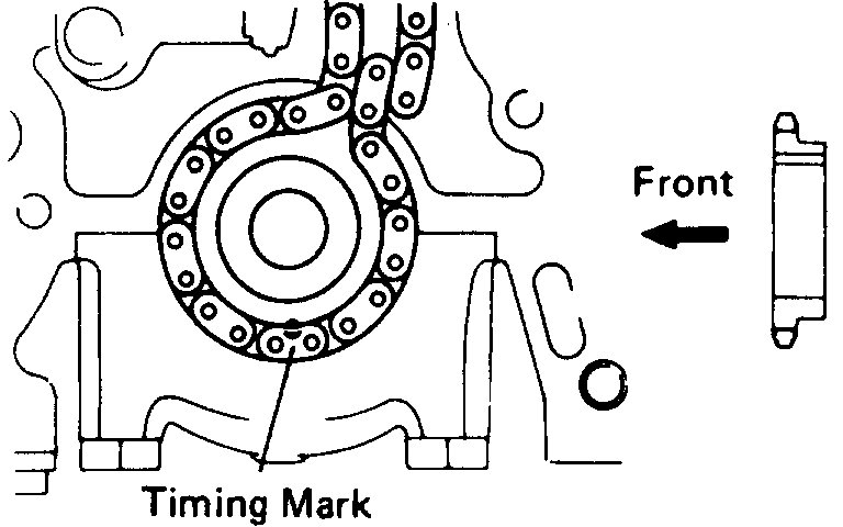

REMOVAL:
1. Disconnect negative battery terminal.
2. Disconnect primary distributor connector.
3. Remove distributor cap retaining screws, distributor cap and spark plug wires.
4. Remove hold down bolt and remove distributor.
INSTALLATION:
1. Install a new O-ring to the distributor housing and apply a light coat of engine oil prior to installation.
Distributor Installation Timing Marks
pic 1
2. Turn crankshaft pulley until the timing mark is aligned with 5° BTDC mark.
3. Ensure rockers on cylinder #1 are loose. If not, rotate crankshaft 1 full turn and re-align timing marks.

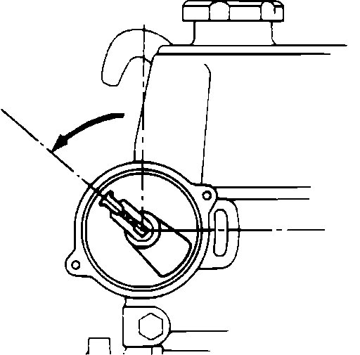

Distributor Rotor Alignment
pic 2
4. Install distributor rotor. Begin insertion of the distributor with rotor pointing upward and mounting hole centered with bolt hole.
5. Install distributor hold down bolt and tighten by hand. Remove rotor.

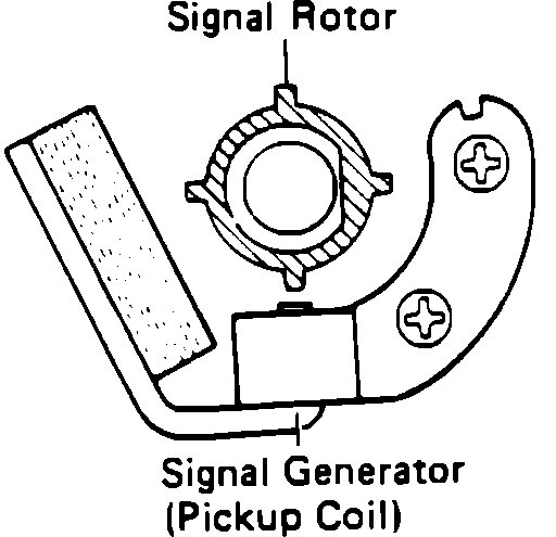

Crankshaft Position Sensor Showing Signal Rotor Alignment
pic 3
6. Align the signal rotor tooth with pickup coil projection.
7. Torque distributor hold down bolt.
Torque: 19 Nm (14 ft. Lb)
8. Install rotor and distributor cap with spark plug wires.
9. Reconnect primary distributor connector and negative battery terminal.
Firing Order: 1 - 3 - 4 - 2
10. Warm engine up to operating temperature and adjust ignition timing. See: Ignition Timing > Adjustments > Ignition Timing

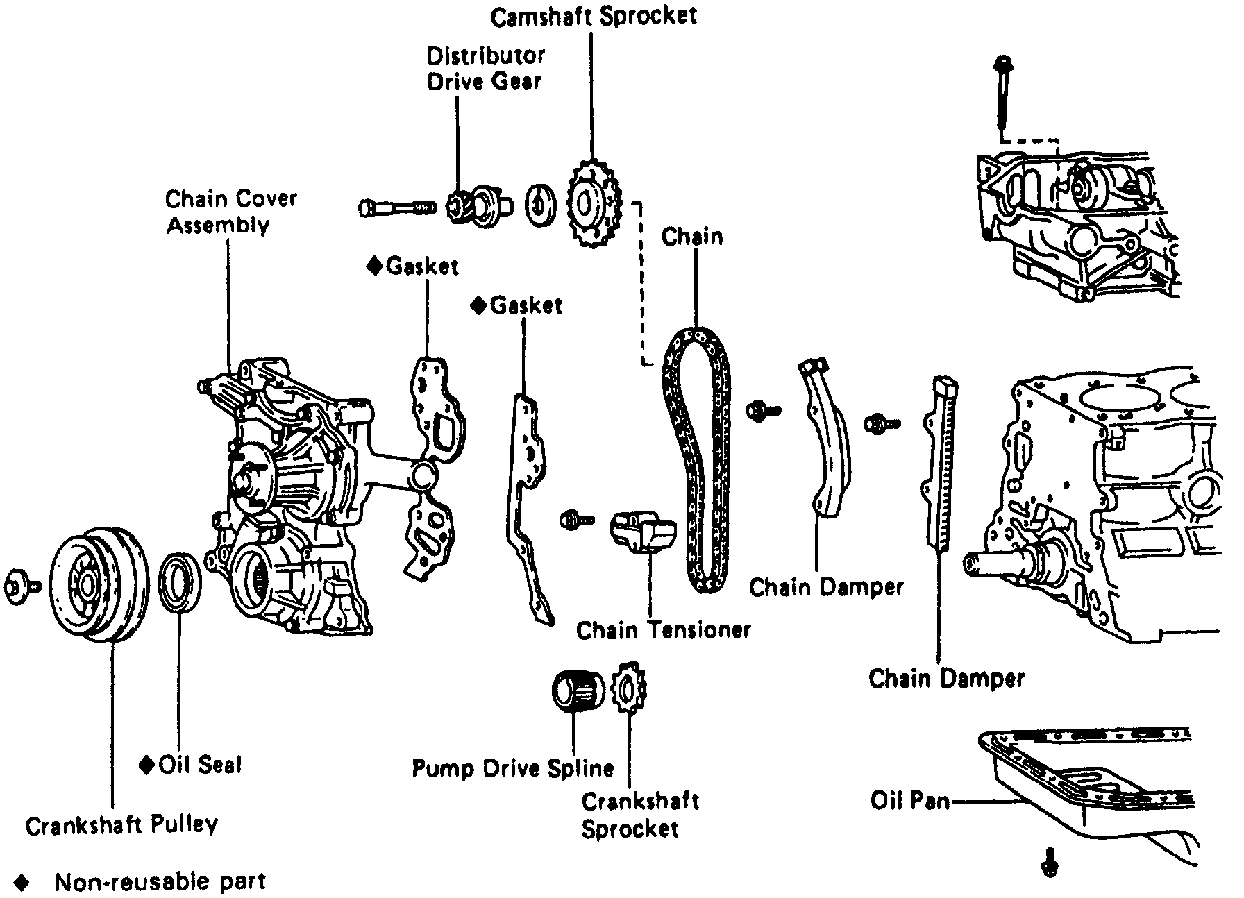

I would replace the rotor if it is moving. Also, disconnecting the exhaust won't hurt anything for testing. However, I'm leaning towards your thoughts as far as how would it be plugged one minute and not the next.
If you decide to put the chain on, here are the directions. The attached pics correlate with the directions.

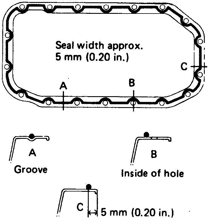

4. REMOVE OIL PAN
(a) Remove the engine undercover.
(b) Remove the engine mounting bolts.
(c) 2WD: Place a jack under the transmission and raise the engine approx. 25 mm (0.98 in.)
(d) Remove the 16 bolts and 2 nuts.
Pic 2

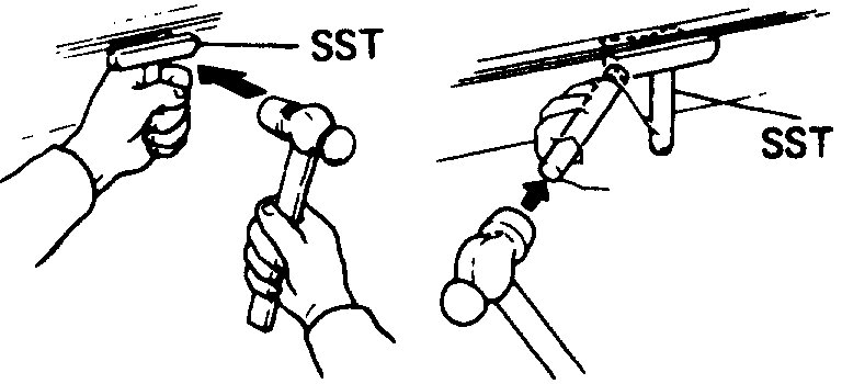

(e) Using SST and brass bar, separate the oil pan from the cylinder block.
SST 09032-00100
HINT: When removing the oil pan, be careful not to damage the oil pan flange.

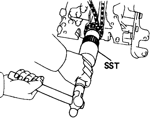

pic 3

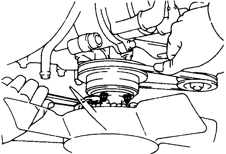

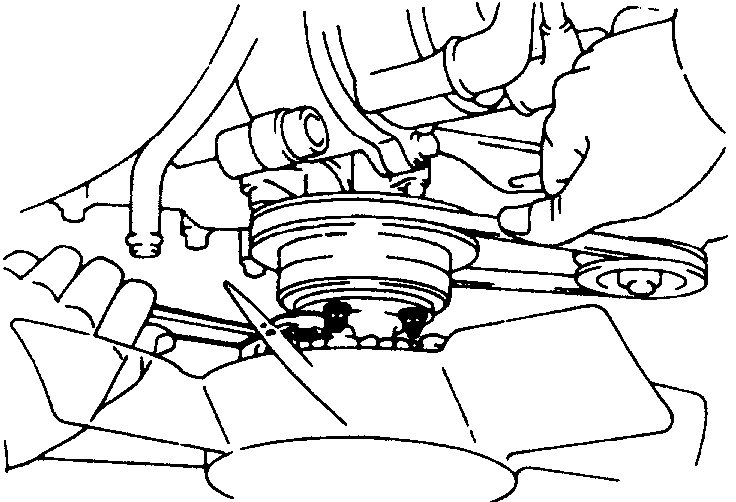

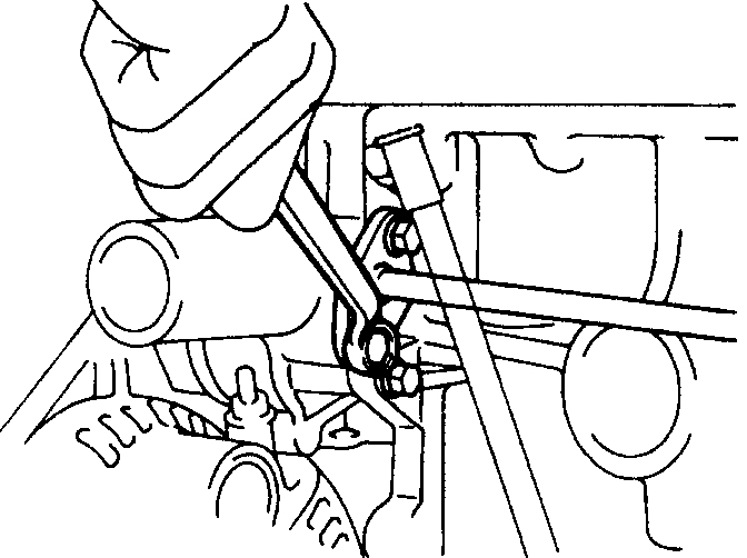

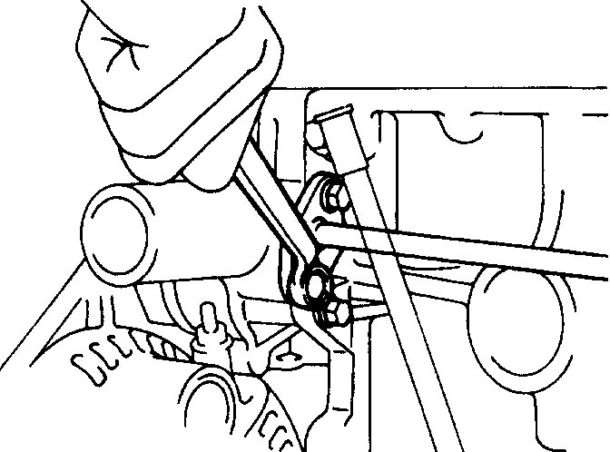

3. REMOVE FLUID COUPLING WITH FAN AND WATER PUMP PULLEY
(a) Loosen the water pump pulley set bolts.
(b) Loosen the belt adjusting bolt and pivot bolt of the generator, and remove the drive belt.
(c) Remove the set nuts, fluid coupling with fan and water pump pulley.

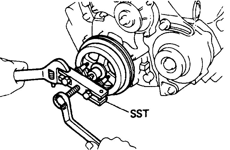

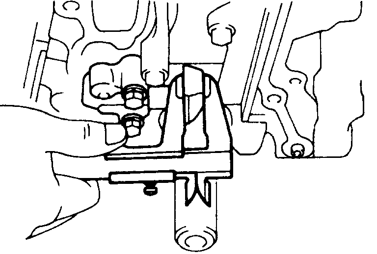

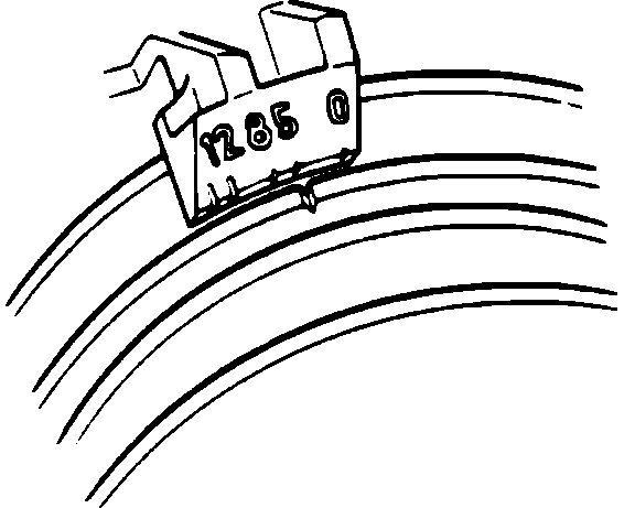

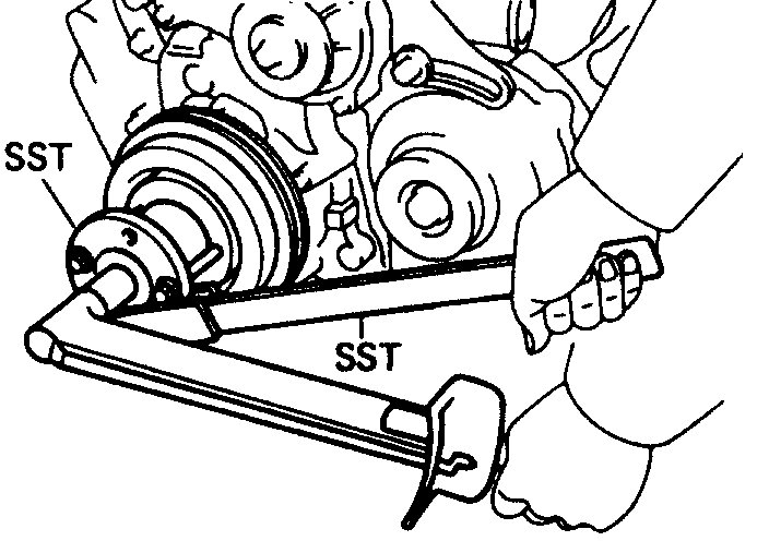

4. REMOVE CRANKSHAFT PULLEY
(a) with A/C (without Air pump) or with PS (with Air pump): Remove the No.2 crankshaft pulley.
Pic 4
(b) Using SST to hold the crankshaft pulley, loosen the pulley bolt.
SST 09213-70010,09330-00021

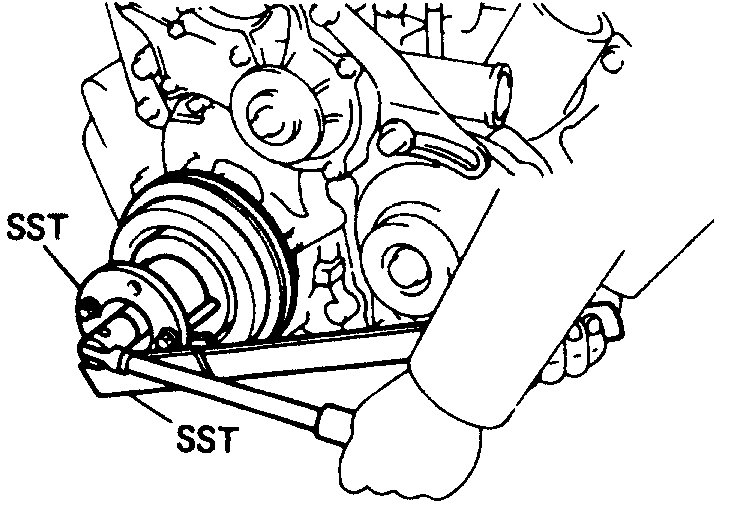

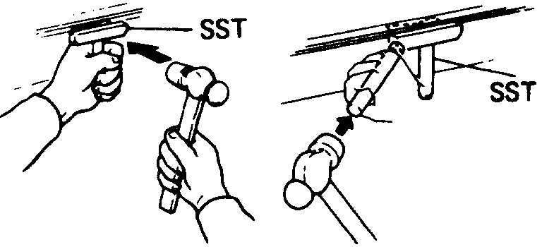

pic 5
(c) Using SST, remove the crankshaft pulley.
SST 09950-50010

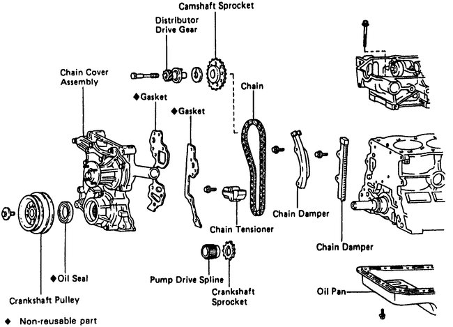

pic 6

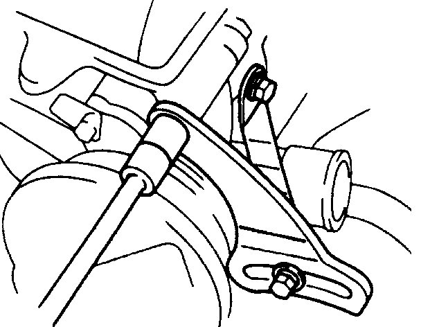

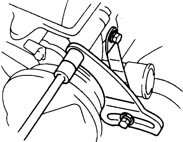

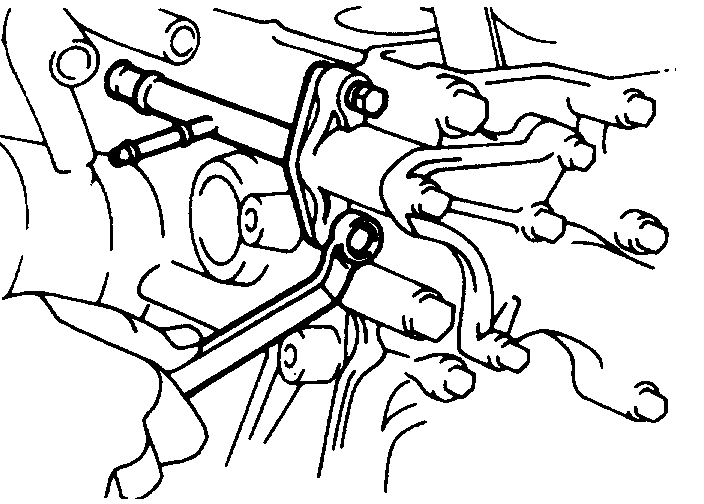

5. REMOVE NO.1 WATER BYPASS PIPE
Remove the 2 bolts and pipe.
Pic 7

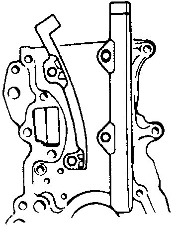

6. REMOVE FAN BELT ADJUSTING BAR
(a) With PS: Remove the bolt and PS lower bracket.
(b) Remove the 3 bolts and bar.

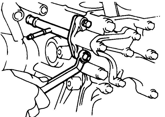

7. DISCONNECT HEATER WATER OUTLET PIPE
Remove the 2 bolts, and disconnect heater water outlet pipe.

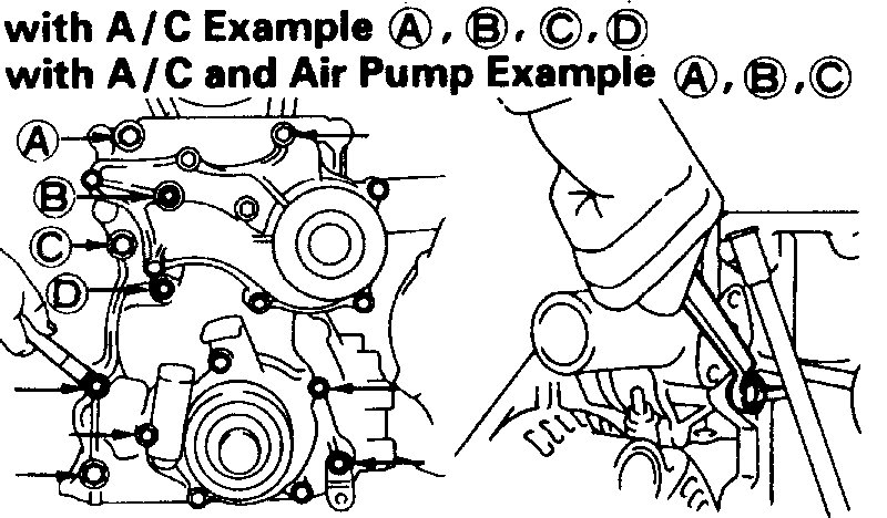

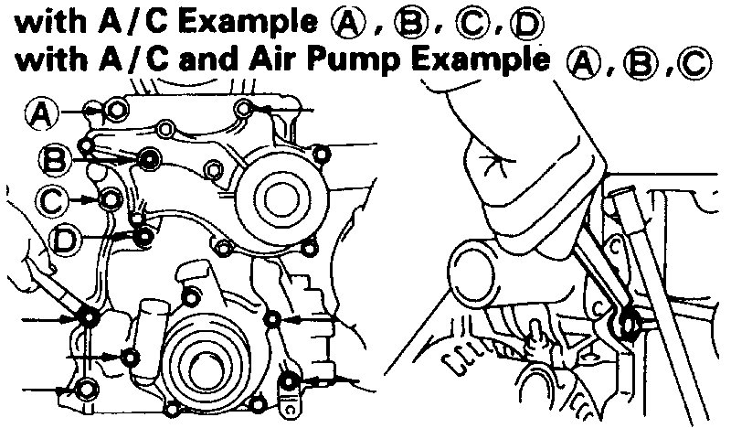

8. REMOVE CHAIN COVER ASSEMBLY
(a) Remove timing chain cover bolts shown by the arrows.
(b) Using a plastic faced hammer, loosen the chain cover and remove it.

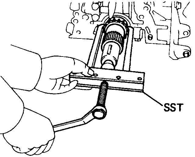

Pic 11

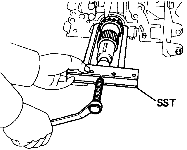

10. REMOVE PUMP DRIVE SPLINE AND CRANKSHAFT SPROCKET
If the oil pump drive spline and sprocket cannot be removed by hand. Use SST to remove them together.
SST 09950-40010

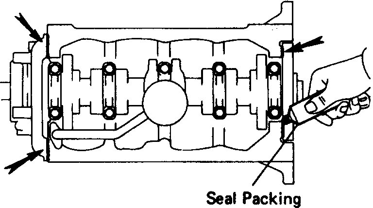

11. REMOVE GASKET MATERIAL ON CYLINDER BLOCK

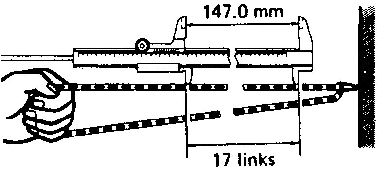

1. MEASURE CHAIN AND SPROCKET WEAR
pic 12
(a) Measure the length of 17 links with the chain fully stretched.
(b) Make the same measurements at least 3 other places selected at random.
Chain elongation limit at 17 links: 147.0 mm (5.787 in.)
If over the limit at any one place, replace the chain.

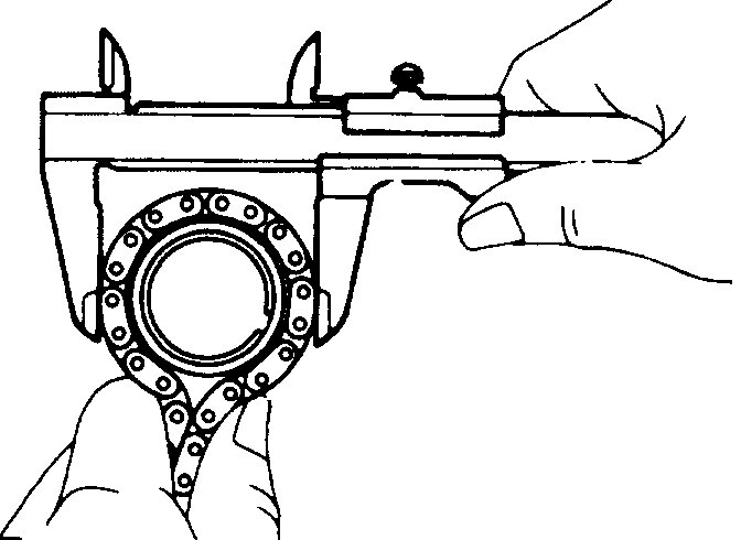

(c) Wrap the chain around the sprocket.
(d) Using a caliper gauge, measure the outer sides of the chain rollers as shown. Measure both sprockets.
Minimum crankshaft sprocket: 59.4 mm (2.339 in.)
Minimum crankshaft sprocket: 113.8 mm (4.480 in.)
If the measurement is less than minimum, replace the chain and 2 sprockets.

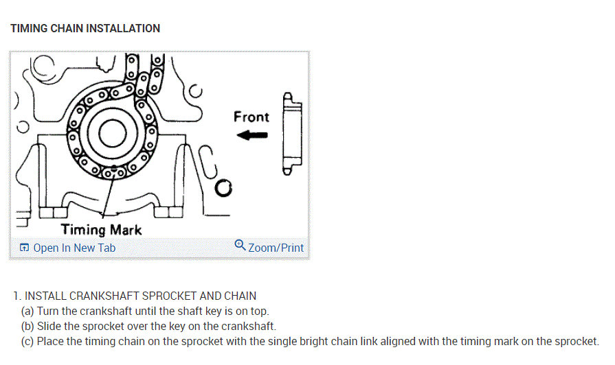

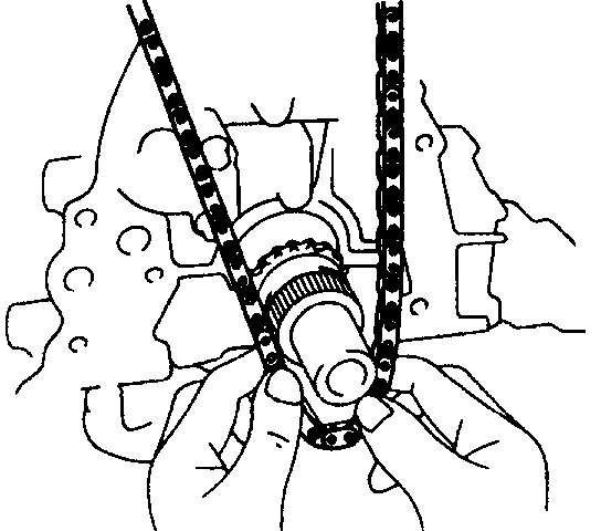

TIMING CHAIN INSTALLATION
pic 16
1. INSTALL CRANKSHAFT SPROCKET AND CHAIN
(a) Turn the crankshaft until the shaft key is on top.
(b) Slide the sprocket over the key on the crankshaft.
(c) Place the timing chain on the sprocket with the single bright chain link aligned with the timing mark on the sprocket.

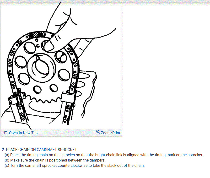

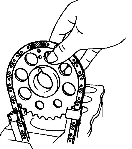

2. PLACE CHAIN ON CAMSHAFT SPROCKET
(a) Place the timing chain on the sprocket so that the bright chain link is aligned with the timing mark on the sprocket.
(b) Make sure the chain is positioned between the dampers.
(c) Turn the camshaft sprocket counterclockwise to take the slack out of the chain.

5. INSTALL FAN BELT ADJUSTING BAR
(a) Temporarily install the adjusting bar to the alternator.
(b) Install the adjusting bar to the chain cover and cylinder head.
Torque: 13 N.M (130 kgf. Cm, 9 ft. Lbf)

6. INSTALL HEATER WATER OUTLET PIPE
Connect the heater water outlet pipe to the timing chain cover with the 2 bolts.

8. INSTALL CRANKSHAFT PULLEY
(a) Install the crankshaft pulley and bolt.
(b) Using SST to hole the crankshaft pulley, torque the bolt.
SST 09213-70010 and 09660-00021
Torque: 157 N.M (1.600 kgf. Cm, 116 ft. Lbf)
(c) with A/C: Install the No.2 crankshaft pulley.
Pic 24
9. INSTALL WATER PUMP PULLEY AND FLUID COUPLING WITH FAN
(a) Temporarily install the water pump pulley and fluid coupling withfan with the 4 nuts.
(b) Place the drive belt onto each pulley.
(c) Stretch the belt tight and tighten the 4 nuts.
10. ADJUST DRIVE BELT TENSION

(b) Apply seal packing to the joint part of the cylinder block and chain cover, cylinder block and rear oil seal retainer.
Seal packing: Part No.08826 - 00080 or equivalent
pic 26
(c) Apply seal packing to the oil pan as shown in the illustration.
Install a nozzle that has been cut to a 5 mm (0.20 in.) Opening.
HINT: Avoid applying an excessive amount to the surface. Be especially careful near oil passages.
If parts are not assembled within 5 minutes of applying the seal packing, the effectiveness of the seal packing is lost and the seal packing must be removed and reapplied.
Immediately remove the nozzle from the tube and reinstall the cap after using the seal packing.
(d) Install the oil pan over the studs on the block with the 16 bolts and 2 nuts. Torque the bolts and nuts.

Thanks for directions and pics. A real help. If you're still on board: on questions, let me know if I just need to dismantle some more to check more first.
I went ahead and figured whatever forced me to move distributor back one gear (Or, moved it one gear ahead) is still broke regardless of whatever else is also wrong; and, that leaves only distributor gears or chain or chain gears.
Finally I got truck in garage late today and took off few things and the valve cover to look in there. Have not taken front chain cover off yet to see crank gear.
Things are not looking right in there to me:
Update and questions:
Distributor gears looked okay to me (can't see how they could have skipped); Chain was loose on both sides till tightened it up on guide side (right) at #1 cylinder TDC; But, I think on the tensioner side (left) all seems loose but not sure how tight its supposed to be. I can also lift the chain up off the cam gear very slightly (about a 1/16 inch). Further down at tensioner it did seem to be some tighter. I didn't see any shiny chain link so far.
But observed 2 things at #1 cylinder TDC: (if I did it right - I put the only pulley mark at 0 mark on plate and distributor is pointing to #1 cylinder terminal. Let me know if there's more to it).
1. All the rockers on the left side facing engine (incl. #1 cylinder) (don't know if intake or exhaust) are tight with no gap even those not on any cam lobe like #1 cylinder; and, #1 cylinder and all not on lobe on the right side are properly loose or gapped. Can't figure that out?
2. The cam timing chain gear had no timing marks I could see on the side facing out (me) so, I looked and found them on the inner back side facing in the engine (so looks like someone put it on backwards? - I can tell it has had a chain put on it in the past.) And, the biggest concern is that at #1 cylinder TDC these cam gear timing marks were not pointing to the top but were well past top towards the right. I'd say clockwise about the middle between 12 o'clock and 15 degrees after.
Questions:
Shouldn't both rockers on #1 cylinder be loose and all others not on cam lobe on left side?
Shouldn't these can gear marks be on the outside (does it make any difference?)
Should these cam gear marks be pointing to top if engine mark is at #1 cylinder TDC? Or should the be pointing down and I just can't see them yet? The 2 marks I see on back side look exactly like the ones in pic 17.
Should there be this, or any, play in the chain and tensioner or should the tensioner hold all tight at all times?
Does any of this indicate any problem since moving the distributor back one gear kind of fixed it.
Thanks.
Wednesday, December 9th, 2020 AT 5:38 PM
  • 109,913 POSTS
The timing is done by identifying the bright chain link location is aligned with the marks on the sprockets. See pics 1 and 2. Now, it isn't odd that you can move the chain a bit. However, it is odd the marks are on the rear of the chain.
See if the links line up. See the attached pics for directions for setting the engine timing.
