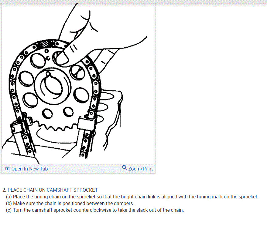

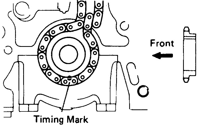

The engine on my pickup started a bad loss of power irregular missing at any steady engine rpm's, including idle, and it stops missing on any acceleration. I advanced the distributor as far as it would go and the missing stopped and engine ran fine. Plugs and plug wires are new and okay.
I am assuming its the timing chain but would like to know any other possible causes to check for first. Thanks for your help.
(I have not taken valve cover off yet to see if I can tell anything about the timing chain. Bought truck used recently so assuming the faulty plastic timing chains guides have been replaced by now.)
Thank you

It could be a few things. For example, a partially plugged catalytic converter, an engine vacuum leak, fuel pressure, and so on can cause these types of symptoms.
Do me a favor. before we guessing, scan the computer for diagnostic trouble codes. This vehicle has an OBD1 system and doesn't require a scan tool to get codes. Hopefully, that will point us in the right direction.

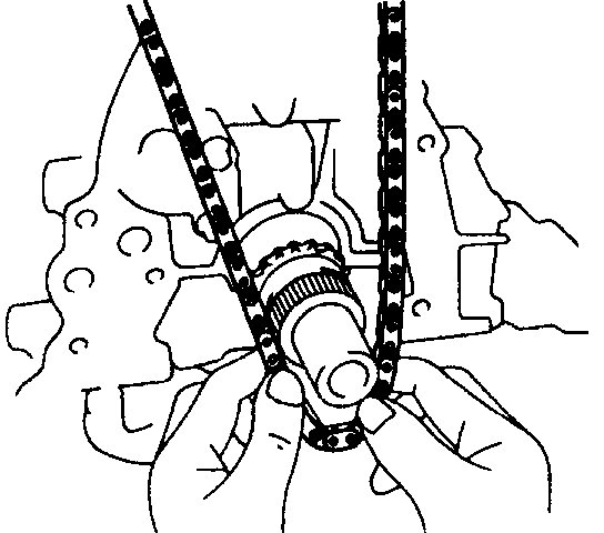

Thanks, will check the codes and get back to you. So, does the fact that when we move the distributor it solves the problem and engine runs fine, not implicate the timing chain or anything particular?
Oct 26, 2020 at 9:21 AM
  • 110,194 POSTS

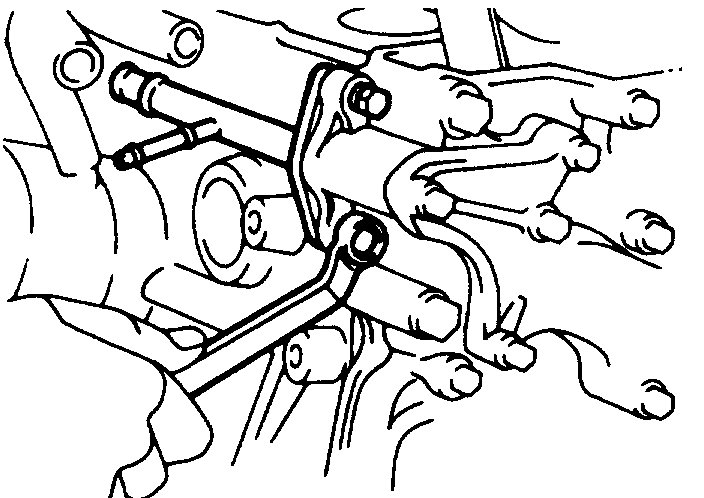

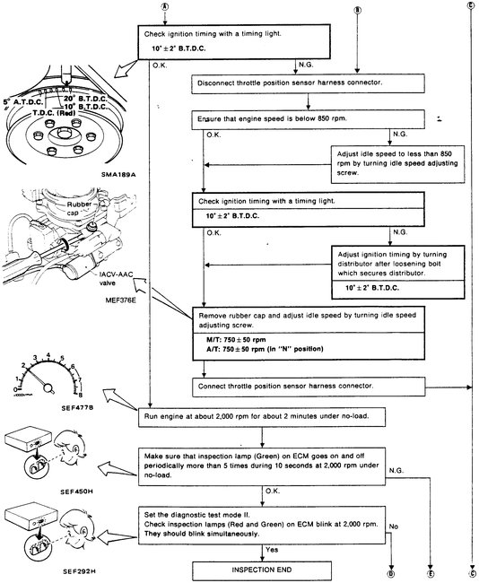

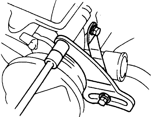

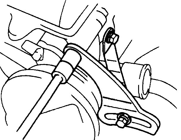

It could. I'm not sure if you are advancing or retarding the ignition timing. However, if the chain jumped, it wouldn't matter moving the distributor. If it is stretched, you may notice some differences. But keep in mind, when the chain is stretched or jumped, the camshaft and crankshaft are not working together properly.

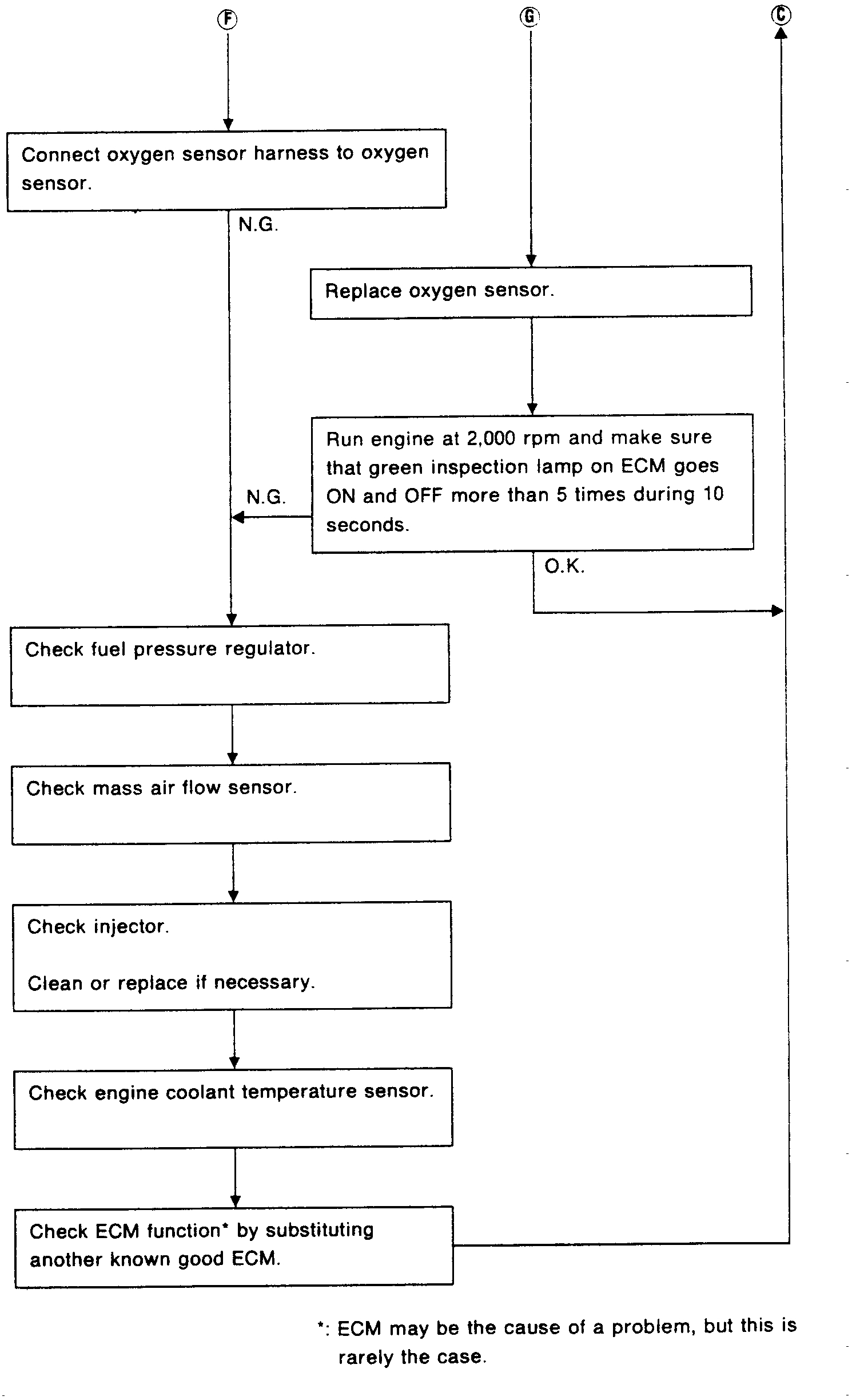

Another thing that you could try is by removing an O2 sensor before the catalytic converter to see if it changes things. If the converter is plugged, the added release point will be noticeable.

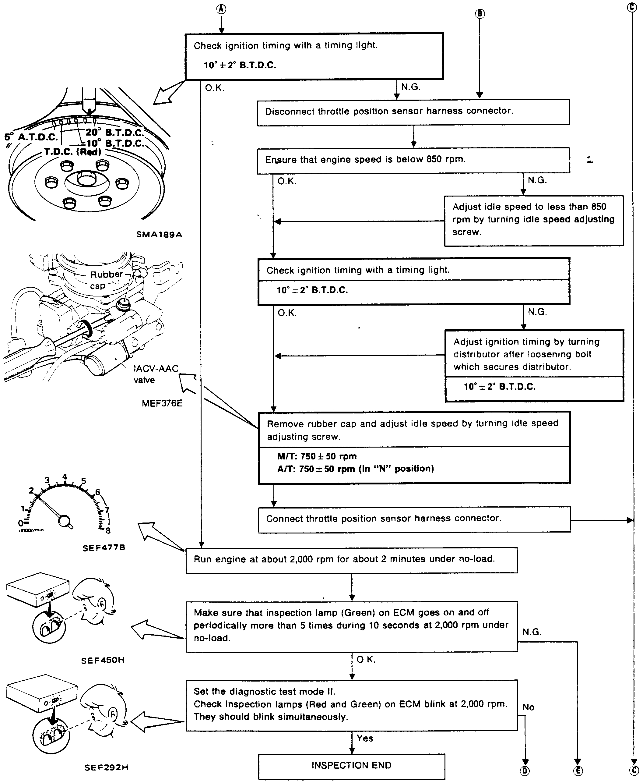

As far as the timing, here is where it should be.
Ignition Timing 10 +/- 2 degrees BTDC
__________________________________

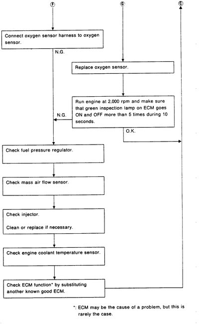

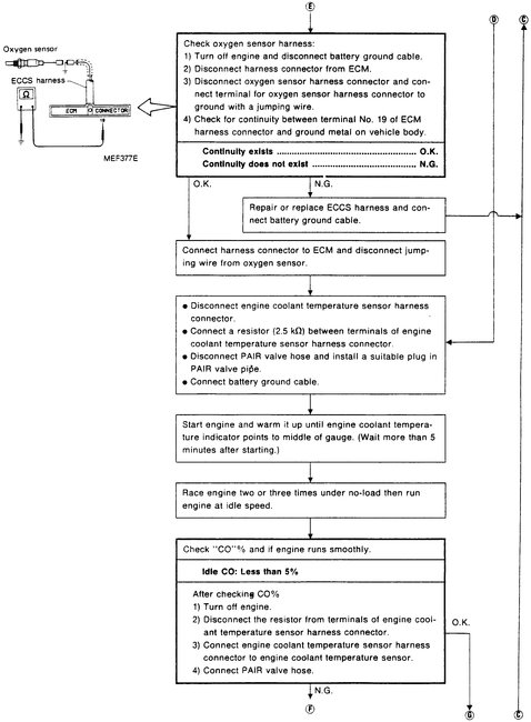

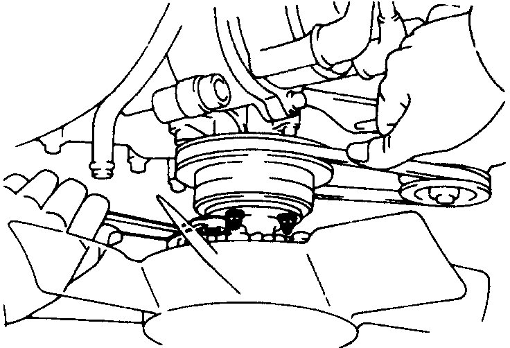

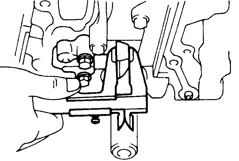

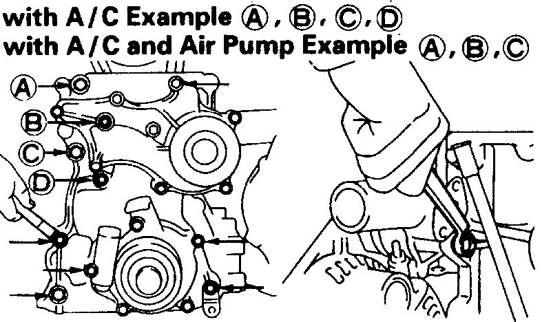

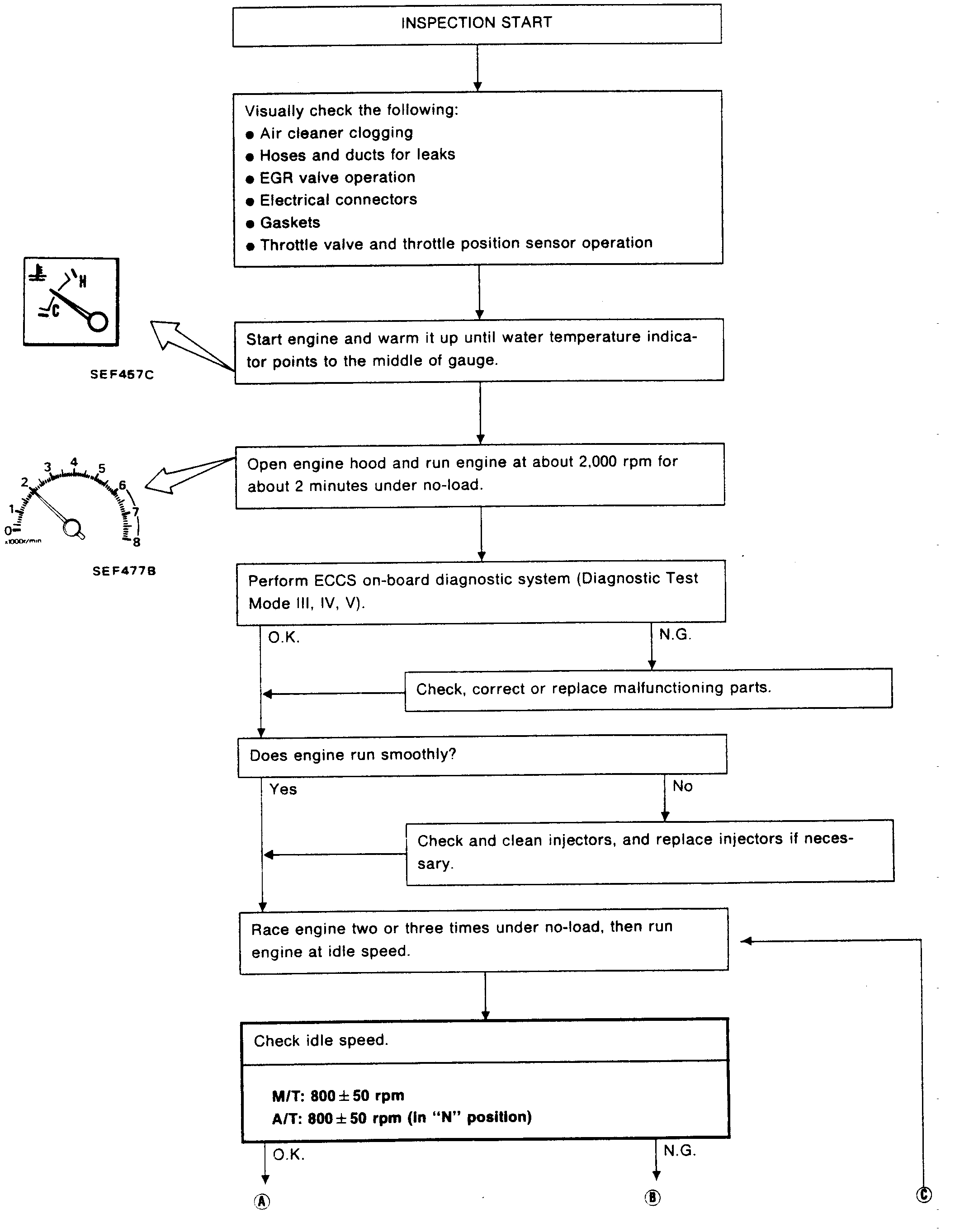

Here is a little more information that may help. The attached pics correlate with the directions. It deals with timing, idle speed, and air fuel ratio adjustment.
1993 Nissan-Datsun Truck D21 Hardbody 2WD L4-2389cc 2.4L SOHC MFI (KA24E)
Idle Speed/Ignition Timing/Idle Mixture Ratio Adjustment
Vehicle Powertrain Management Ignition System Ignition Timing Adjustments Idle Speed/Ignition Timing/Idle Mixture Ratio Adjustment
IDLE SPEED/IGNITION TIMING/IDLE MIXTURE RATIO ADJUSTMENT
IMPORTANT NOTES
- All adjustments must be correct to insure proper operation of the engine control system.
- The air fuel mixture is not adjustable.
- Base idle speed is adjustable.
- Closed loop idle speed is not adjustable.
- Base ignition timing is adjustable.
- Closed loop ignition timing is not adjustable.
PREPARATION
1. Make sure the following parts are in good order:
- Battery
- Ignition System
- Engine oil and coolant level
- Fuses
- ECM harness connector
- Vacuum hoses
- Air intake system (Oil filler cap, oil level gauge, etc.)
- Fuel pressure
- Engine compression
- EGR operation
- Throttle valve
2. On A/C equipped models, checks should be carried out with the system OFF.
3. On A/T equipped models, checks should be done with the transaxle in NEUTRAL.
4. When measuring "CO) percentage, insert probe more than 40 Cm (15.7 in) into tailpipe.
5. Turn off headlamps, heater blower, and rear defogger.
6. Keep front wheels pointed straight ahead.
7. Make the inspection after the radiator fan has stopped.
INSPECTION AND ADJUSTMENT PROCEDURE
Idle Speed/Ignition Timing/Idle Mixture Ratio Inspection (1 Of 4)
pic 1
CHART 1
Idle Speed/Ignition Timing/Idle Mixture Ratio Inspection (2 Of 4)
pic 2
CHART 2
Idle Speed/Ignition Timing/Idle Mixture Ratio Inspection (3 Of 4)
pic 3
CHART 3
Idle Speed/Ignition Timing/Idle Mixture Ratio Inspection (4 Of 4)
pic 4
CHART 4
- Follow the charts from top to bottom.
- Do not skip steps.
- Do not vary from chart direction.

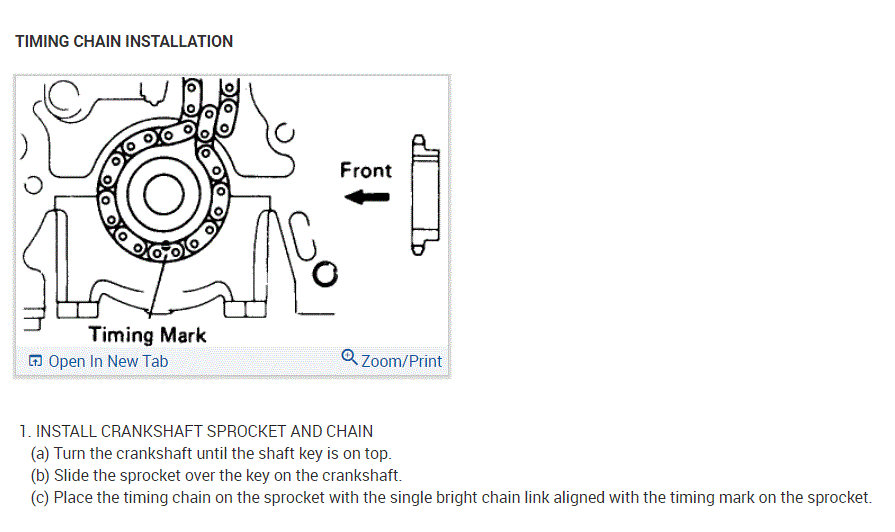

Thanks so much. You are so right. I did not stop to think that a timing chain would get the crank and cam out of sink for which a distributor move would not effect. We also now see that a replacement chain has been installed before son got it. (Silicone)
This is my son's Toyota truck so, not until this weekend did we both get to it. We checked the codes like you suggested and it was code 41 - "throttle position circuit fault".
We checked that we had retarded, not advanced, the timing when we moved the distributor to fix.
So, we did this again - all the distributor would allow - and it started running good again except minor interim cut outs at all RPM's (almost unnoticeable). It's like, if the dist. would allow more retarding, the truck would run perfect - it's very close now.
So, we checked the timing with a light with distributor in original and max retarded position. Could not get a good read. It was jumping all over the place from way too advanced to less advanced back and forth at constant idle. (no tachometer so, we checked it at all idles and with and without the advance terminals shorted)
A complication however, is we had already replaced the throttle position sensor first thing and so we might have caused the 41 code problem ourselves (we have not understood yet how to adjust it so we adjusted it all all points and also disconnected it with no changes at all in engine - that dist. retard fixes). We ran an ohm test on the old one (had to tear it up ) and it appeared to be working on all points IF we figured out how it works.
So, I guess the old TPS could have been bad and the new one is not adjusted so same problem from both? Or, separate original problem and now a new TPS problem we created? Does the codes check just give you one worst problem?
After the 41 code, we did not check any thing else out yet, and we just retarded the distributor again and are thinking to just run it that way to buy some time since, we figured retarding the timing would not burn any pistons etc.? (still jumping and too advanced as best we can check) We read an out of adjustment TPS would prevent setting the timing???

We still take out 02 sensor to check for catalytic converted clogging real quick if you think its still a possible problem.
Hope this helps you help us. Thanks again.

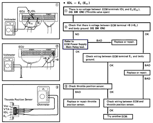

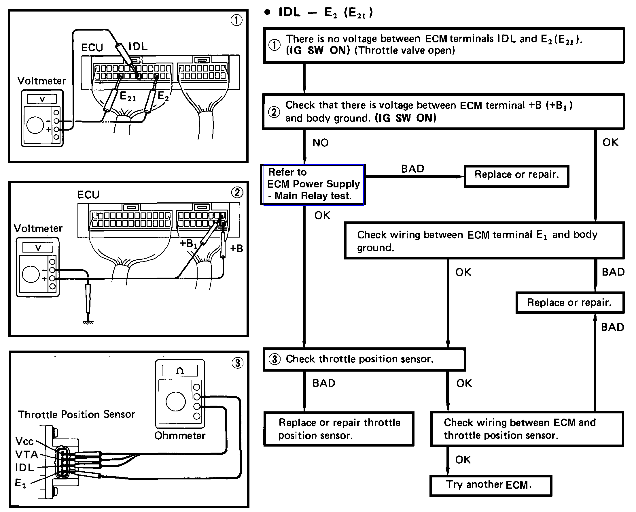

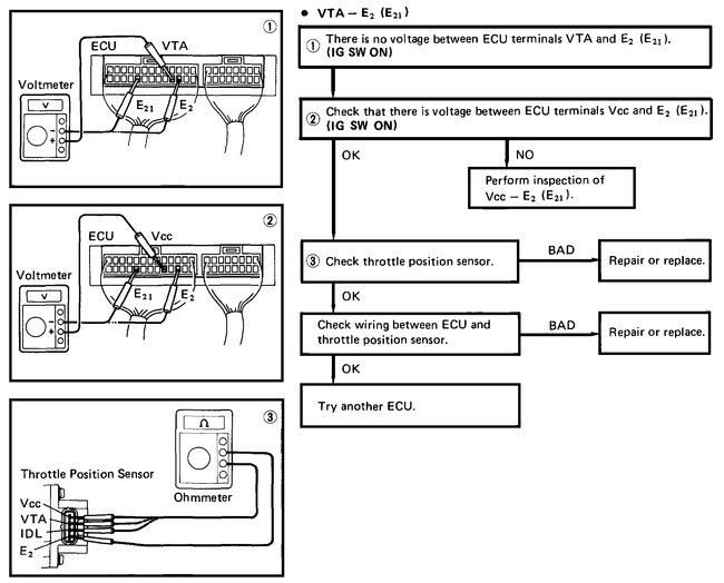

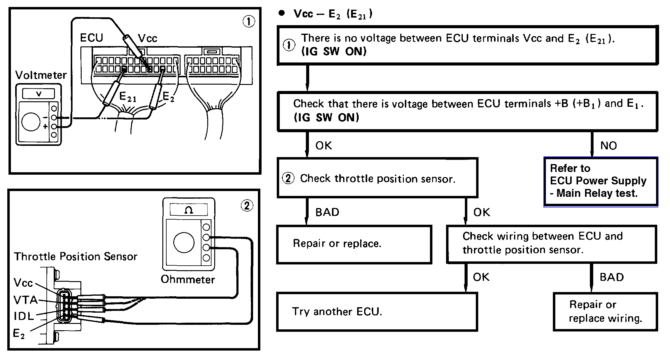

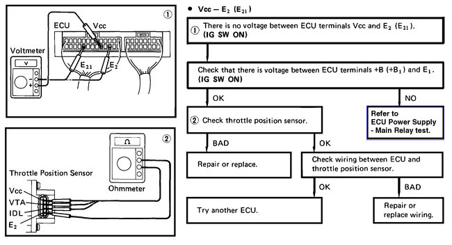

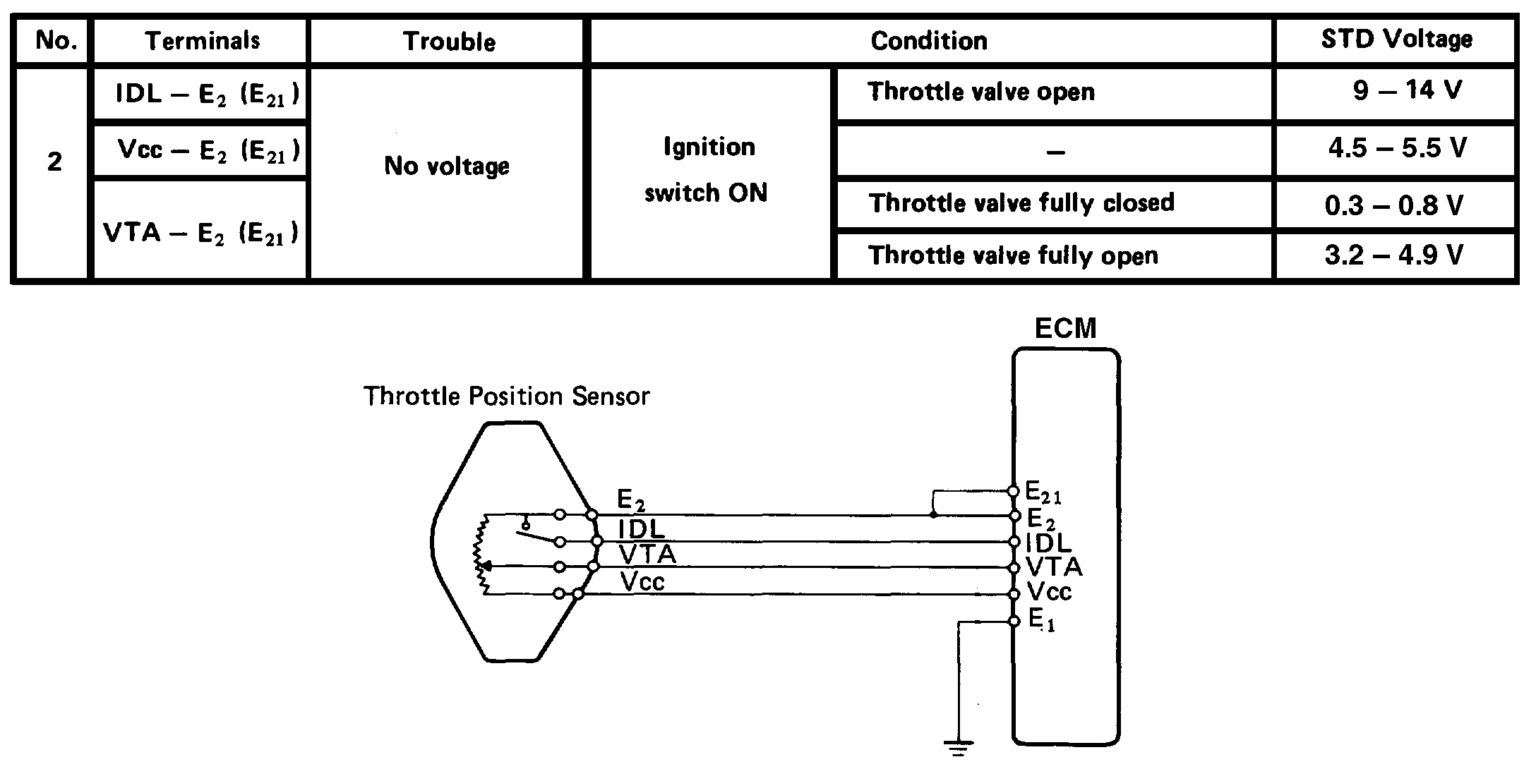

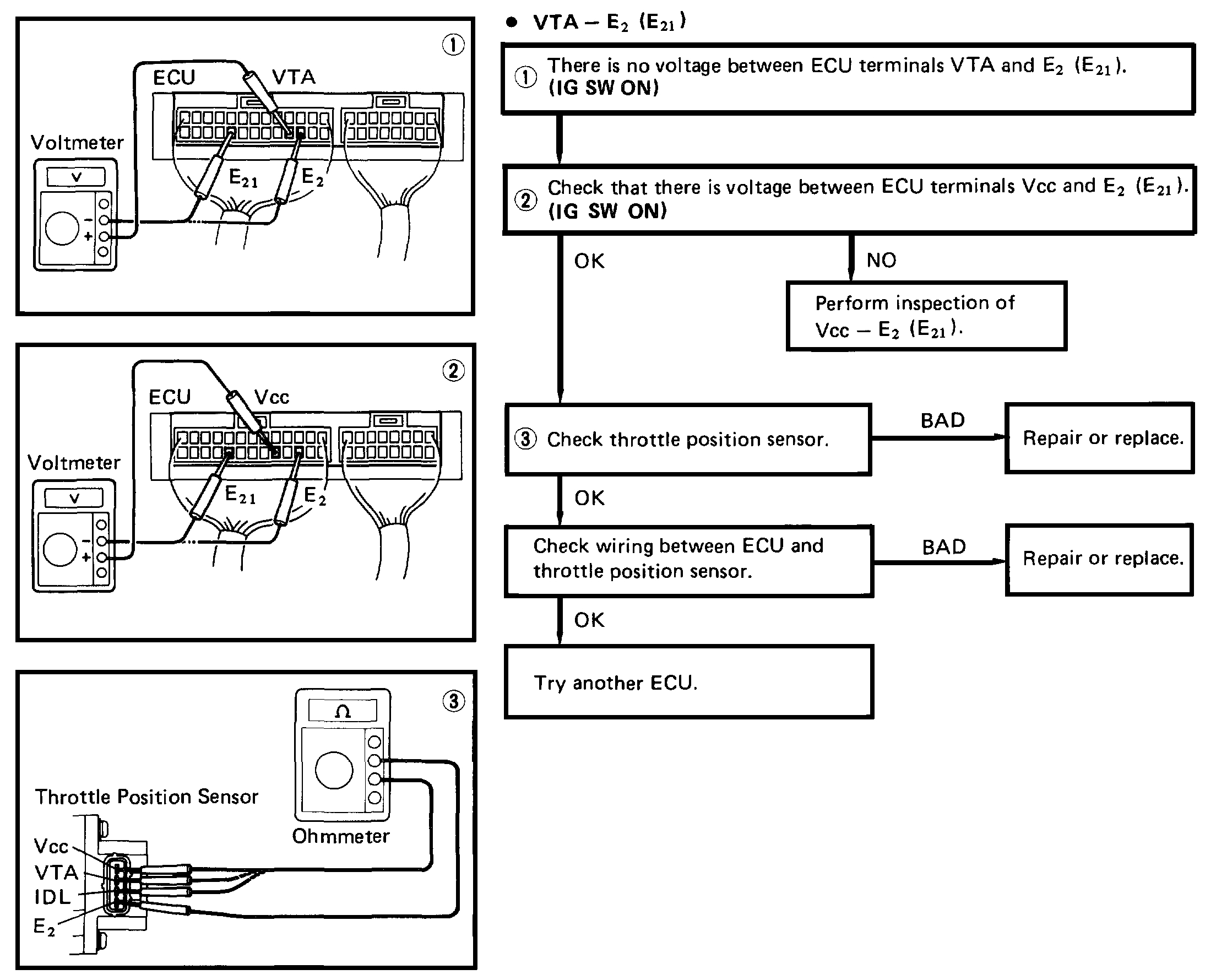

if the timing is over advanced, you will hear valve ping under a load. As far as having it retarded, that will cause a loss of power.
Do me a favor, Take a look through these diagnostics. They explain what to check when it comes to a 41 (TPS) issue.
1993 Toyota Truck Pickup 2WD L4-144.4 2366cc 2.4L SOHC (22R-E)
Chart 2
Vehicle Powertrain Management Computers and Control Systems Testing and Inspection Component Tests and General Diagnostics Circuit Test Charts (For Trouble Code Diagnosis) Chart 2
CHART 2
# 2. Throttle Position Sensor
# 2. Throttle Position Sensor (IDL - E2 [E21])
pic 1
# 2. Throttle Position Sensor (Vcc - E2 [E21])
pic 2
# 2. Throttle Position Sensor (VTA - E2 [E21)
pic 3
Throttle Position Sensor (VTA - E2 [E21])
pic 4
Wiring Diagram / Condition
___________________

Background refresh: Truck starts and runs. Runs perfectly good on acceleration, but anytime the throttle and RPM's are kept steady, at any rpm including idle, it loses power and randomly misses and cuts out like crazy. Son said it started happening all at once. We retarded the distributor as far as it would go and it fixed the miss and it ran fine (except for a very slight single miss now and then) for a couple of weeks then it started missing the same with new dist. position. Could not get a good read on timing light. Way advanced and jumping around (son says he hears a pinging but I do not).
Son had already put on new TPS and nothing changed. We do not know how to adjust it. But it did not change anything with TPS at all adjustments and even with its wires disconnected - nothing changed. We took the old TPS apart and it looked OK and continuity checked out on all points so I think it was working.
I checked the codes like you said and it came up TPS circuit fault - code 41. You then suggested the following checks per pics below.

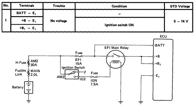

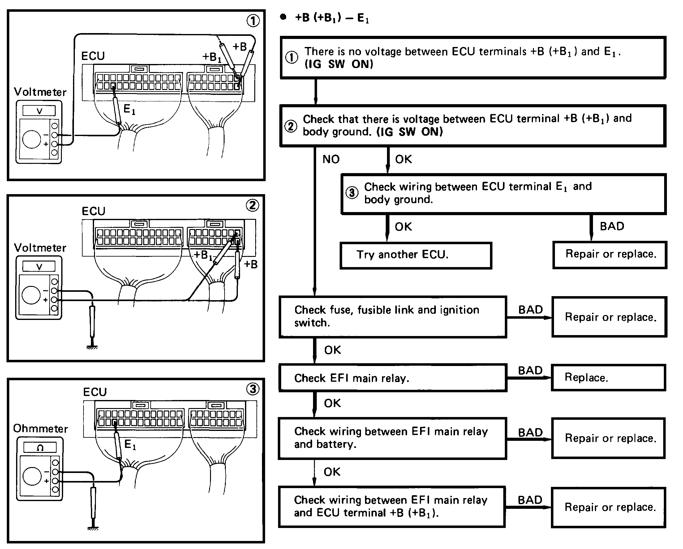

I guess I'm in over my head: Per your pics I took wires off ECU and stuck multimeter probes into the wire terminals per pics with key on and throttle open on the one required. (pics show the terminals on the bottom row (except for the 2 B's) when hooked up so when remove and turn over terminals from ECU to then face me to get to them, they become the visible top row - right?) For 'body' ground when called for I scraped off the paint on body for good ground on car body.
And I checked all the things from the pics below that you sent and I got no volts or anything from any of them. (it looked like my probes were making contact in the female terminal holes). Checked my multimeter and it did show 12 volts straight from battery so, its working. I must expect the new TPS is good but I got no ohms from TPS ( I did not have anyone yet to move the throttle for me but I expect to get nothing).
As said, looks like I'm in over my head; surely I should have gotten some kind of volt reading on something??? I noticed the pics said try the ECU power supply main relay test maybe? But need to know how on that.
Can anything else not working result in TPS circuit fault code?
Thanks for all your help.
Nov 16, 2020 at 11:30 AM
  • 110,194 POSTS
Good to hear from you. I don't think you are over your head. You are on the right track. As far as the no voltage, the throttle should be open. See if that chances anything.

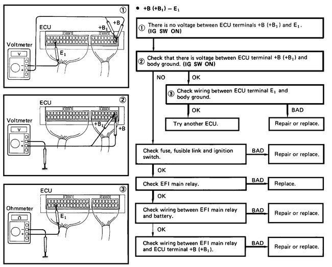

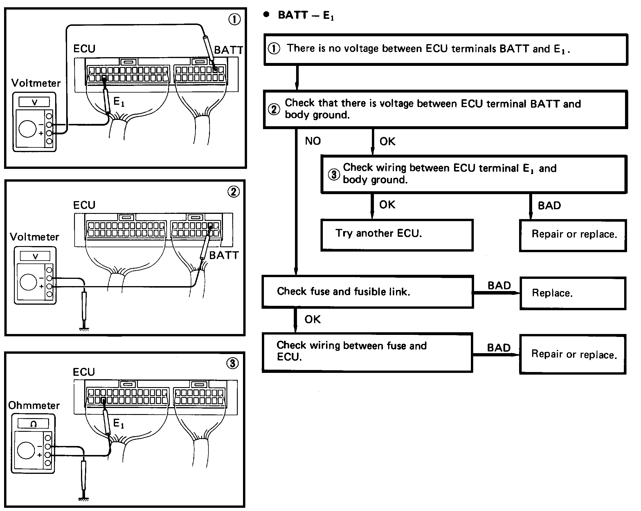

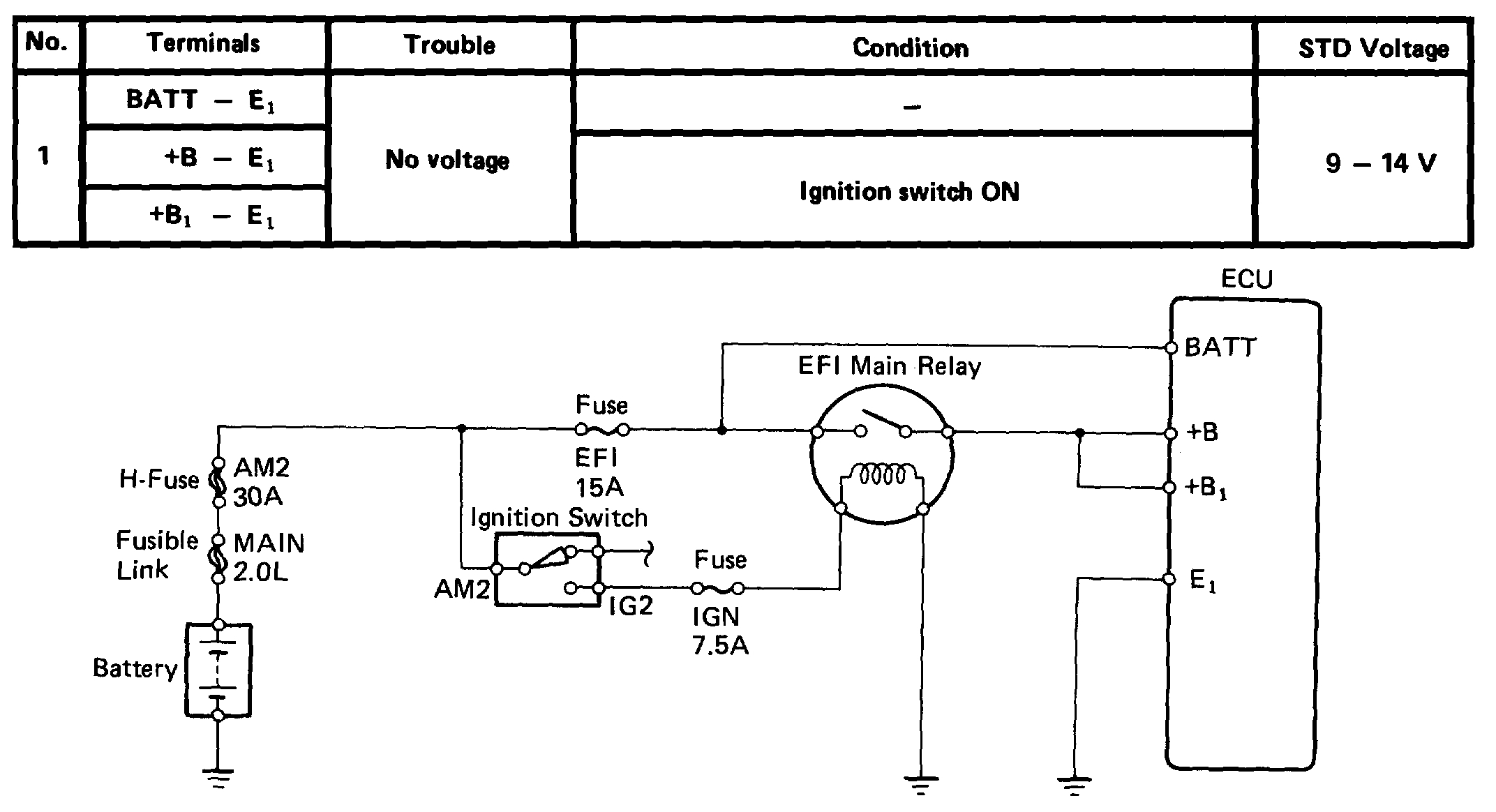

As far as the ECM power control relay, here are the directions for testing it. I almost feel bad sending this simply because it is more testing, but this is the nature of the beast. Confirm there is power and let me know what you find.
_____________________________________
# 1. ECU Power Supply
Vehicle Powertrain Management Relays and Modules - Powertrain Management Relays and Modules - Computers and Control Systems Engine Control Module Testing and Inspection Component Tests and General Diagnostics ECM Power Source Circuit 2 WD # 1. ECU Power Supply
# 1. ECU POWER SUPPLY
# 1. ECU Power Supply / Main Relay
# 1. ECU Power Supply / Main Relay (BATT - E1)
Pic 1
# 1. ECU Power Supply / Main Relay (+B [+B1] - E1)
Pic 2
Pic 3
Let me know what you find.

Still no change.
I checked per pics below (both with analog and digital) and I got no volts at all on anything (that is if I am getting the right ones and good connections in those tiny terminal ports (I'm shoving the probes in there?). But, it seems that if I'm getting no volts at all to ECU, then truck would not start or run at all??
So, then (from the black box on the inside fender well of the passenger side) I pulled the "EFI fuse" and it was good; and then, pulled the "EFI" relay and I got continuity between 2 of the poles (but not the other 2 red ones).
(the EFI relay came right out with a slight tug by pliers but when I put it back in and tried to get it out again, it would not come out and so the casing broke very easily. So, I was hoping maybe it was not in good first time so checked all again but still got no volts. How do these relays come out? I can't get it out now or see how they come out? Got to get a new one now.

So, I feel that it is a timing issue, and getting worse which indicates mechanical cause. But stumped as to why it accelerates fine????
On the other hand, most other causes seems to not likely catch all of the symptoms:  i.e., getting progressively worse, problem began in an instant, acceleration is good.
The TPS may then just be along for the ride.

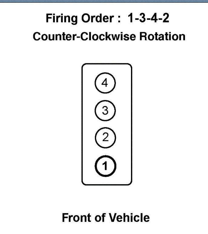

I attached a pic below of the firing order. Let me know what you find.
Procedures
Vehicle Powertrain Management Ignition System Distributor Service and Repair Procedures
PROCEDURES
REMOVAL:
1. Disconnect negative battery terminal.
2. Disconnect primary distributor connector.
3. Remove distributor cap retaining screws, distributor cap and spark plug wires.
4. Remove hold down bolt and remove distributor.
INSTALLATION:
1. Install a new O-ring to the distributor housing and apply a light coat of engine oil prior to installation.
Distributor Installation Timing Marks
pic 1
2. Turn crankshaft pulley until the timing mark is aligned with 5° BTDC mark.
3. Ensure rockers on cylinder #1 are loose. If not, rotate crankshaft 1 full turn and re-align timing marks.

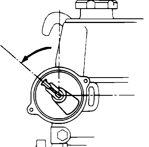

Distributor Rotor Alignment
pic 2
4. Install distributor rotor. Begin insertion of the distributor with rotor pointing upward and mounting hole centered with bolt hole.
5. Install distributor hold down bolt and tighten by hand. Remove rotor.

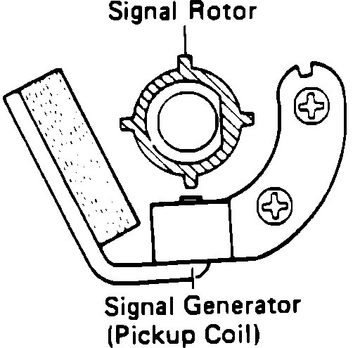

Crankshaft Position Sensor Showing Signal Rotor Alignment
pic 3
6. Align the signal rotor tooth with pickup coil projection.
7. Torque distributor hold down bolt.
Torque: 19 Nm (14 ft.lb)
8. Install rotor and distributor cap with spark plug wires.
9. Reconnect primary distributor connector and negative battery terminal.
Firing Order: 1 - 3 - 4 - 2
10. Warm engine up to operating temperature and adjust ignition timing. See: Ignition Timing > Adjustments > Ignition Timing

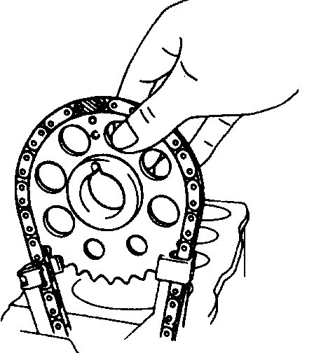

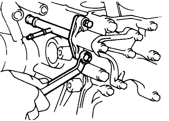

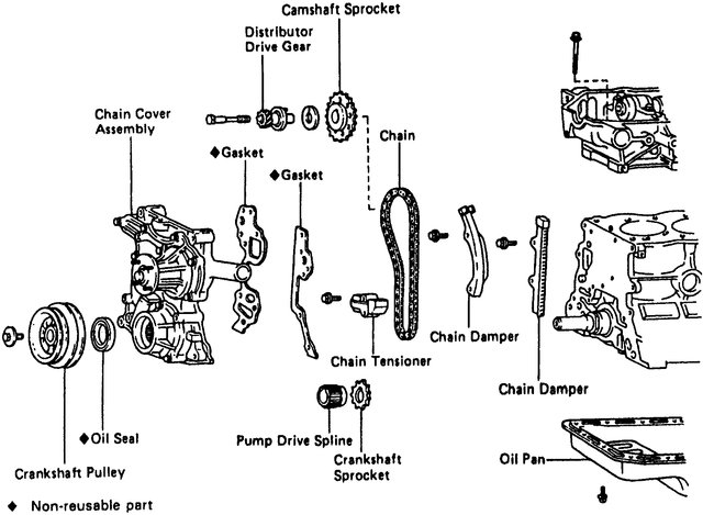

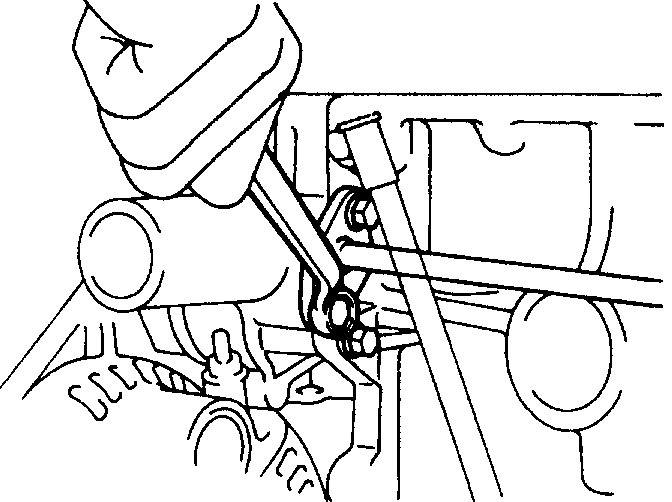

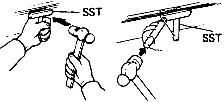

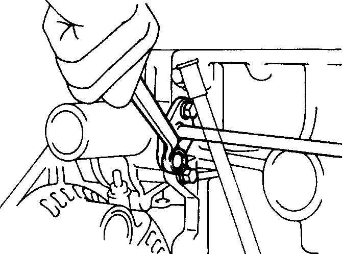

If you decide to put the chain on, here are the directions. The attached pics correlate with the directions.
__________________________________________
Procedures
Vehicle Engine, Cooling and Exhaust Engine Timing Components Timing Chain Service and Repair Procedures
PROCEDURES
pic 1
PREPARATION FOR REMOVAL OF TIMING CHAIN
1. REMOVE CYLINDER HEAD
2. REMOVE RADIATOR
3. 4WD: REMOVE FRONT DIFFERENTIAL
4. REMOVE OIL PAN
(a) Remove the engine undercover.
(b) Remove the engine mounting bolts.
(c) 2WD: Place a jack under the transmission and raise the engine approx. 25 mm (0.98 in.)
(d) Remove the 16 bolts and 2 nuts.
pic 2
(e) Using SST and brass bar, separate the oil pan from the cylinder block.
SST 09032-00100
HINT: When removing the oil pan, be careful not to damage the oil pan flange.
TIMING CHAIN REMOVAL
1. with PS: REMOVE PS BELT
2. with A/C: REMOVE A/C BELT, COMPRESSOR AND BRACKET
pic 3
3. REMOVE FLUID COUPLING WITH FAN AND WATER PUMP PULLEY
(a) Loosen the water pump pulley set bolts.
(b) Loosen the belt adjusting bolt and pivot bolt of the generator, and remove the drive belt.
(c) Remove the set nuts, fluid coupling with fan and water pump pulley.

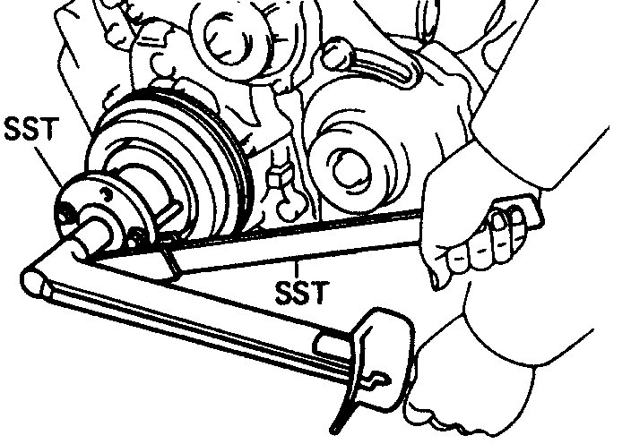

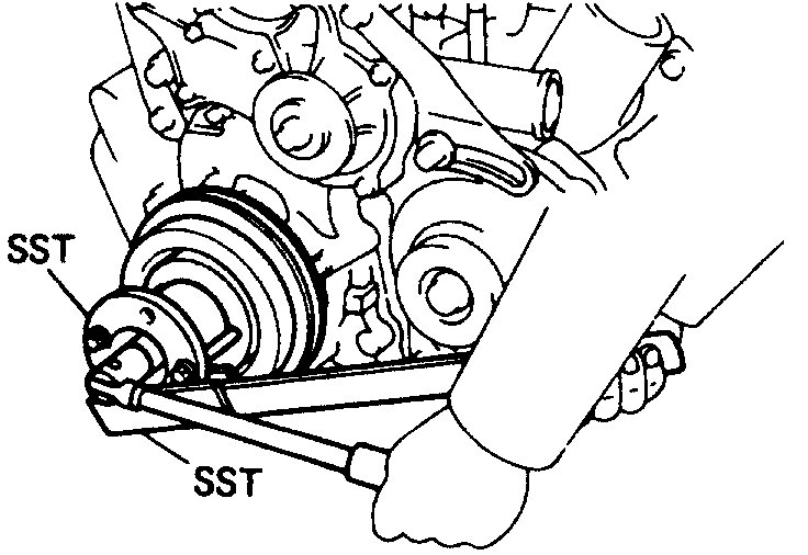

4. REMOVE CRANKSHAFT PULLEY
(a) with A/C (without Air pump) or with PS (with Air pump): Remove the No.2 crankshaft pulley.
pic 4
(b) Using SST to hold the crankshaft pulley, loosen the pulley bolt.
SST 09213-70010,09330-00021

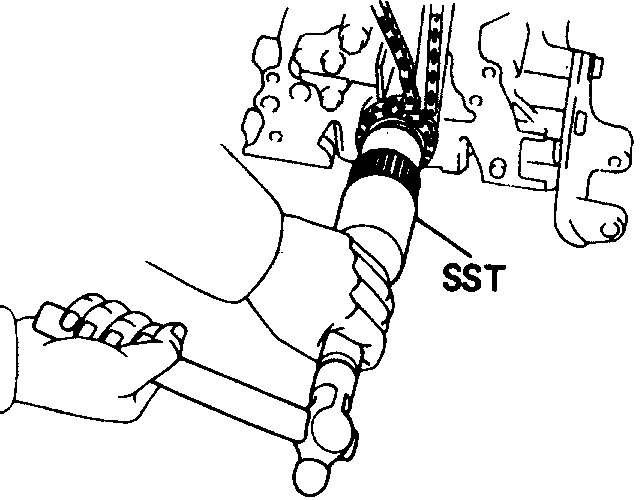

pic 5
(c) Using SST, remove the crankshaft pulley.
SST 09950-50010
pic 6
5. REMOVE NO.1 WATER BYPASS PIPE
Remove the 2 bolts and pipe.
pic 7
6. REMOVE FAN BELT ADJUSTING BAR
(a) With PS: Remove the bolt and PS lower bracket.
(b) Remove the 3 bolts and bar.
pic 8
7. DISCONNECT HEATER WATER OUTLET PIPE
Remove the 2 bolts, and disconnect heater water outlet pipe.
pic 9
8. REMOVE CHAIN COVER ASSEMBLY
(a) Remove timing chain cover bolts shown by the arrows.
(b) Using a plastic faced hammer, loosen the chain cover and remove it.
pic 10
9. REMOVE CHAIN AND CAMSHAFT SPROCKET
(a) Remove the chain from the damper.
(b) Remove the cam sprocket and chain together.
pic 11

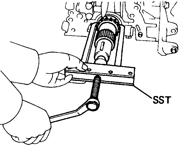

10. REMOVE PUMP DRIVE SPLINE AND CRANKSHAFT SPROCKET
If the oil pump drive spline and sprocket cannot be removed by hand. use SST to remove them together.
SST 09950-40010
11. REMOVE GASKET MATERIAL ON CYLINDER BLOCK
COMPONENTS INSPECTION

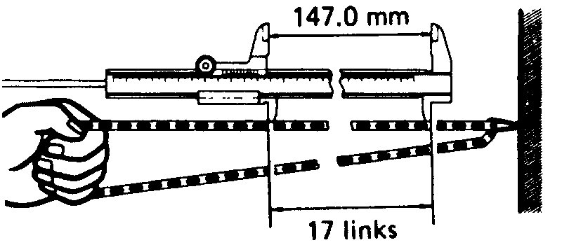

1. MEASURE CHAIN AND SPROCKET WEAR
pic 12
(a) Measure the length of 17 links with the chain fully stretched.
(b) Make the same measurements at least 3 other places selected at random.
Chain elongation limit at 17 links: 147.0 mm (5.787 in.)
If over the limit at any one place, replace the chain.

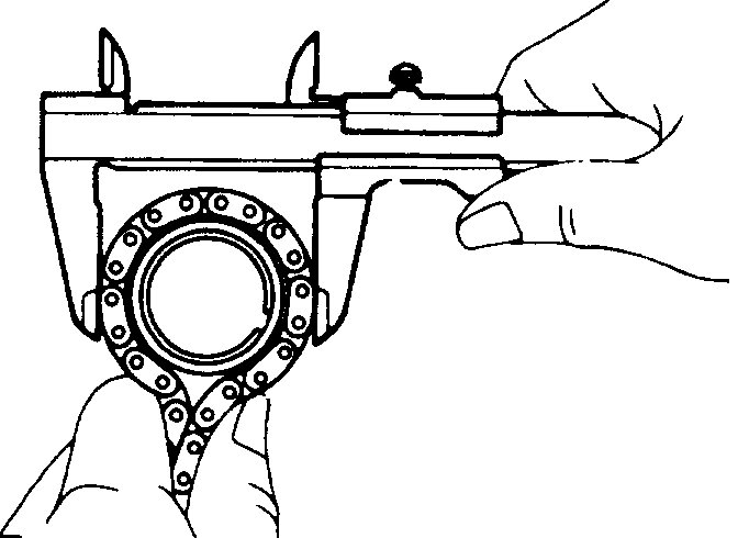

pic 13
(c) Wrap the chain around the sprocket.
(d) Using a caliper gauge, measure the outer sides of the chain rollers as shown. Measure both sprockets.
Minimum crankshaft sprocket: 59.4 mm (2.339 in.)
Minimum crankshaft sprocket: 113.8 mm (4.480 in.)
If the measurement is less than minimum, replace the chain and 2 sprockets.
pic 14
2. MEASURE CHAIN TENSIONER
Using a caliper gauge, measure the tensioner as shown.
Minimum tensioner: 11.0 mm (0.433 in.)
If the tensioner is worn or less than minimum, replace the chain tensioner.
pic 15

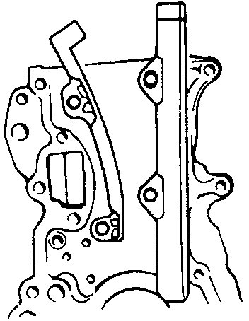

3. MEASURE CHAIN DAMPERS
Using a micrometer, measure each damper.
Limit damper wear: 0.5 mm (0.020 in.)
If either damper is worn or less than minimum, replace the damper.
TIMING CHAIN INSTALLATION
pic 16
1. INSTALL CRANKSHAFT SPROCKET AND CHAIN
(a) Turn the crankshaft until the shaft key is on top.
(b) Slide the sprocket over the key on the crankshaft.
(c) Place the timing chain on the sprocket with the single bright chain link aligned with the timing mark on the sprocket.
pic 17
2. PLACE CHAIN ON CAMSHAFT SPROCKET
(a) Place the timing chain on the sprocket so that the bright chain link is aligned with the timing mark on the sprocket.
(b) Make sure the chain is positioned between the dampers.
(c) Turn the camshaft sprocket counterclockwise to take the slack out of the chain.
pic 18
3. INSTALL OIL PUMP DRIVE SPLINE
Slide the oil pump drive spline over the crankshaft key.
HINT: If the oil pump drive spline is difficult to install by hand, install using SST.
SST 09608-35014 (09608-06040)
pic 19

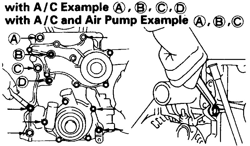

4. INSTALL TIMING CHAIN COVER ASSEMBLY
(a) Remove the old cover gaskets. Clean the gasket surface. Install new gaskets over the dowels.
(b) Slide the cover assembly over the dowels and pump spline.
(c) Insert the bolts as shown and torque them.
Torque:
8 mm bolt: 13 N.m (130 kgf.cm, 9 ft.lbf)
10 mm bolt: 39 N.m (400 kgf.cm. 29 ft.lbf)
pic 20
5. INSTALL FAN BELT ADJUSTING BAR
(a) Temporarily install the adjusting bar to the alternator.
(b) Install the adjusting bar to the chain cover and cylinder head.
Torque: 13 N.m (130 kgf.cm, 9 ft.lbf)
pic 21
6. INSTALL HEATER WATER OUTLET PIPE
Connect the heater water outlet pipe to the timing chain cover with the 2 bolts.
pic 22
7. INSTALL NO.1 WATER BYPASS PIPE
Install the pipe with the 2 bolts.
pic 23

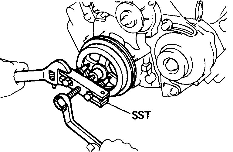

8. INSTALL CRANKSHAFT PULLEY
(a) Install the crankshaft pulley and bolt.
(b) Using SST to hole the crankshaft pulley, torque the bolt.
SST 09213-70010 and 09660-00021
Torque: 157 N.m (1.600 kgf.cm, 116 ft.lbf)
(c) with A/C: Install the No.2 crankshaft pulley.
pic 24

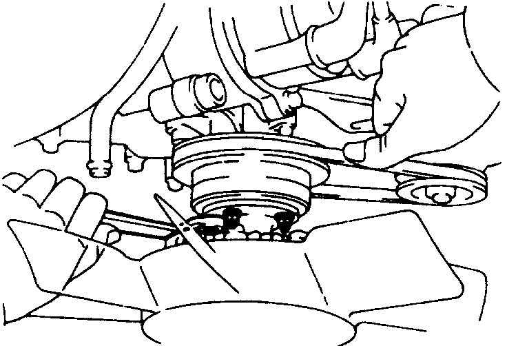

9. INSTALL WATER PUMP PULLEY AND FLUID COUPLING WITH FAN
(a) Temporarily install the water pump pulley and fluid coupling withfan with the 4 nuts.
(b) Place the drive belt onto each pulley.
(c) Stretch the belt tight and tighten the 4 nuts.
10. ADJUST DRIVE BELT TENSION
11. with A/C: INSTALL A/C COMPRESSOR BRACKET, COMPRESSOR AND BELT
12. with PS: INSTALL PS BELT
13. INSTALL OIL PAN
(a) Remove any old packing material and be careful not to drop any oil on the contacting surfaces of the oil pan and cylinder block.
^ Using a razor blade and gasket scraper, remove all the packing (FIPG) material from the gasket surfaces.
^ Thoroughly clean all components to remove all the loose material.
^ Clean both sealing surfaces with a non-residue solvent.
NOTICE: Do not use a solvent which will affect the painted surfaces.

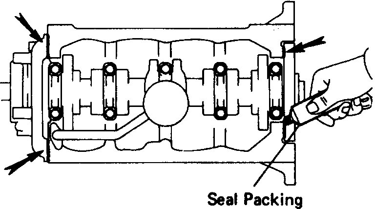

pic 25

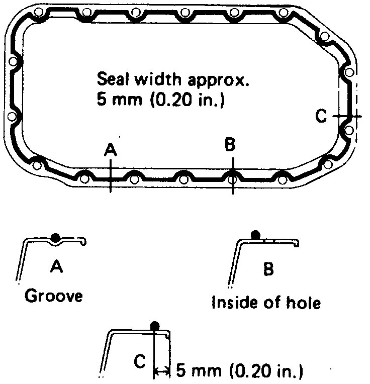

(b) Apply seal packing to the joint part of the cylinder block and chain cover, cylinder block and rear oil seal retainer.
Seal packing: Part No.08826 - 00080 or equivalent
pic 26
(c) Apply seal packing to the oil pan as shown in the illustration.
^ Install a nozzle that has been cut to a 5 mm (0.20 in.) opening.
HINT: Avoid applying an excessive amount to the surface. Be especially careful near oil passages.
^ If parts are not assembled within 5 minutes of applying the seal packing, the effectiveness of the seal packing is lost and the seal packing must be removed and reapplied.
^ Immediately remove the nozzle from the tube and reinstall the cap after using the seal packing.
(d) Install the oil pan over the studs on the block with the 16 bolts and 2 nuts. Torque the bolts and nuts.
(e) Lower the engine and install the engine mounting bolts.
(f) Install the engine under cover.
14. INSTALL RADIATOR
15. INSTALL CYLINDER HEAD
16. 4WD: INSTALL FRONT DIFFERENTIAL
___________________________________________________
Let me know if this helps.

Thanks for directions and pics. A real help. If you're still on board: on questions, let me know if I just need to dismantle some more to check more first.
I went ahead and figured whatever forced me to move distributor back one gear (Or, moved it one gear ahead) is still broke regardless of whatever else is also wrong; and, that leaves only distributor gears or chain or chain gears.
Finally I got truck in garage late today and took off few things and the valve cover to look in there. Have not taken front chain cover off yet to see crank gear.
Things are not looking right in there to me:
Update and questions:
Distributor gears looked okay to me (can't see how they could have skipped); Chain was loose on both sides till tightened it up on guide side (right) at #1 cylinder TDC; But, I think on the tensioner side (left) all seems loose but not sure how tight its supposed to be. I can also lift the chain up off the cam gear very slightly (about a 1/16 inch). Further down at tensioner it did seem to be some tighter. I didn't see any shiny chain link so far.
But observed 2 things at #1 cylinder TDC: (if I did it right - I put the only pulley mark at 0 mark on plate and distributor is pointing to #1 cylinder terminal. Let me know if there's more to it).
1. All the rockers on the left side facing engine (incl. #1 cylinder) (don't know if intake or exhaust) are tight with no gap even those not on any cam lobe like #1 cylinder; and, #1 cylinder and all not on lobe on the right side are properly loose or gapped. Can't figure that out?
2. The cam timing chain gear had no timing marks I could see on the side facing out (me) so, I looked and found them on the inner back side facing in the engine (so looks like someone put it on backwards??? - I can tell it has had a chain put on it in the past.) And, the biggest concern is that at #1 cylinder TDC these cam gear timing marks were not pointing to the top but were well past top towards the right. I'd say clockwise about the middle between 12 o'clock and 15 degrees after.
Questions:
Shouldn't both rockers on #1 cylinder be loose and all others not on cam lobe on left side?
Shouldn't these can gear marks be on the outside (does it make any difference?)
Should these cam gear marks be pointing to top if engine mark is at #1 cylinder TDC? Or should the be pointing down and I just can't see them yet? The 2 marks I see on back side look exactly like the ones in pic 17.
Should there be this, or any, play in the chain and tensioner or should the tensioner hold all tight at all times?
Does any of this indicate any problem since moving the distributor back one gear kind of fixed it.
Thanks.
Dec 9, 2020 at 5:38 PM
  • 110,194 POSTS
The timing is done by identifying the bright chain link location is aligned with the marks on the sprockets. See pics 1 and 2. Now, it isn't odd that you can move the chain a bit. However, it is odd the marks are on the rear of the chain.
See if the links line up. See the attached pics for directions for setting the engine timing.
Dec 9, 2020 at 8:30 PM
