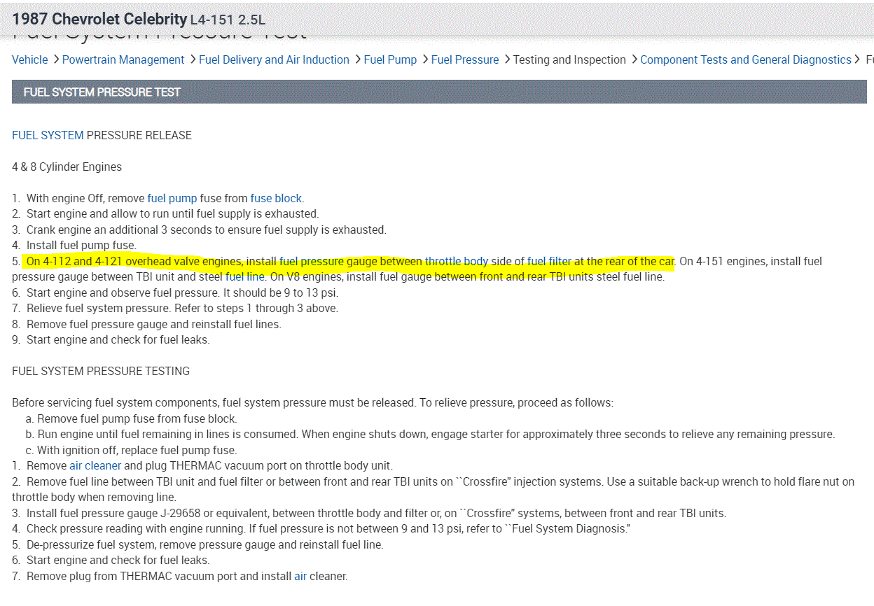

What you described sounds more like a fuel pressure drop-off. Basically, pressure drops when the engine is off and then takes longer for the pump to build enough pressure for it to run.
This vehicle only requires fuel pressure between 9 and 13 PSI, so it's not extremely high, but still, it needs that amount. If the pump is weak or losing its prime, this can happen.
So, here is what I want you to try. Do this each time you start the vehicle to see if it starts normally.
1) Turn the key from off to the run position (engine off) and count to 5.
2) Turn the key off and repeat step 1 four more times.
3) On the fifth time, see if it starts normally.
Try this and let me know the results.
Also, I attached the directions for this vehicle when checking fuel pressure. The tester will need to be between the fuel filter and the fuel tank.
See pic below.

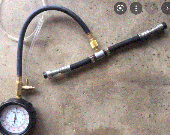

To double check: Does the gauge go in between the throttle body and the filter; or does it go between the pump (in the gas tank) and the filter (at the tank)? i.e., Does the test include or bypass the filter?

If I'm reading it correctly, it will go between the throttle body and filter. The gauge will need a hose that connects to both sides and has a Schrader valve in the middle for you to connect to.
I found a general pic from the internet so you have an idea of how it will look. You will need to determine how each side will connect to the line on the vehicle.
See pic below.
