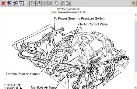

Car quits, speedometer shuts off, have to re-start to get speedometer to work, engine will surge at idle, have changed speed senor control, did not make a difference. What else could it be? Could it be the map sensor?? If you know what it could be, could you explain where I would find the part on the engine as well.
Thank you for taking the time to answer my question.

Check the fuel pressure and also the idle air control valve /throttle position sensor.
https://images.2carpros.com/forum/automotive_pictures/12900_iacv_3.jpg

Once I replace the Idle Air Control Valve and/or the Throttle Position Sensor does the car then have to be hooked up to a computer to reset automatically?
Mar 24, 2008 at 2:18 PM
  • 75,992 POSTS
Don't be throwing parts to it -inspect/clean/test it-who knows it might not be it. these component are probable causes-to reset just disconnect the battery.
