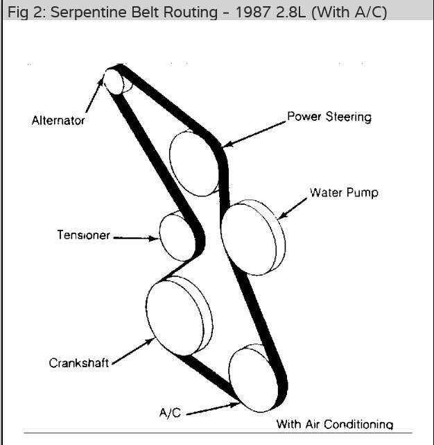

I lost my timing belt and I hope to know the size of it.

it is the fan belt not timing belt. yours has a chain under timing cover front of engine.
