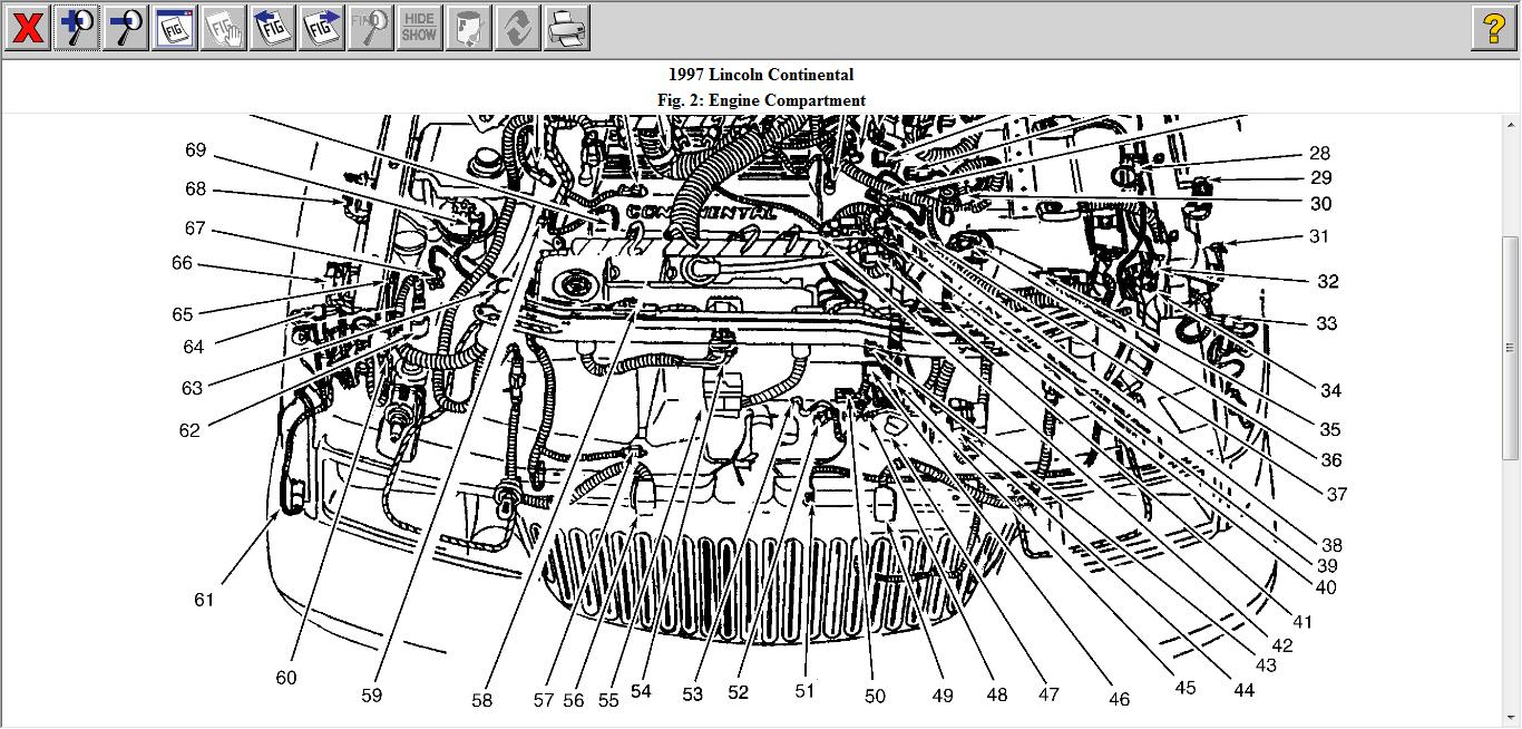

I have seen a lot of complaints about the crank position sensor causing no start issue. Where is it on my conti?
Tuesday, April 25th, 2017 AT 11:46 AM (Merged)
  • 75,992 POSTS
The CPS On lower right side of engine. See item no.59

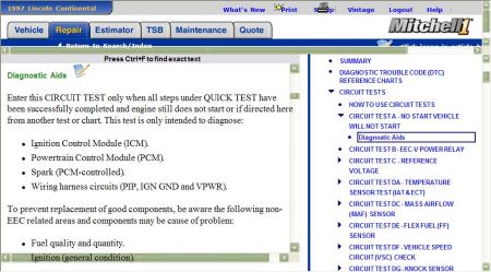

Lets do below for a start to determine if its fuel or spark related issue and get back asap.
Get a helper disconnect a sparkplug wire or 2 and ground it to the engine atleast 3/16 away from ground-have helper crank engine over-do you have a snapping blue spark? If so-you have a fuel related problem, check the fuel pressure to rule out the fuel filter/fuel pump/pressure regulator and listen to the injector/s are they pulsing or hook up a noid light. No snapping blue spark continue to troubleshoot the ignition system-power input to the coil/coil packs, coil's resistances, distributor pick-up coil, ignition control module, cam and crank sensors and computer Note: If it doesn't apply disregard it
