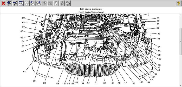

SNOSAINT
  • 76 POSTS
Drove home parked it for the nite, no start in the morning. Tried a couple of different times over a couple of days and charged up the battery but no luck.
Swapped pcm relay. no change. Have not given the gas tank a whack yet to jog the fuel pump if that is it.
I have an extra crank sensor(friend did it on my sons 97 conti even though it didnt need it when it needed for a cam sensor)
I need to know where to find it and the quickest way to change it...it is single digits out there.
If you have other ideas about what else to check let me know

SNOSAINT
  • 76 POSTS
Have pressure at rail schrader valve, unable to test now.
I am by myself and cant hear the fuel pump pressure up though and wacking the tank with the key on did not produce any additional noise or result.
Also, locked and unlocked the door with the key and the combination code with no result.
Still want to know where the crank sensor is exactly as it is something i can do while waiting for my brother to come, it eliminates one more thing if it doesnt solve the problem.

SNOSAINT
  • 76 POSTS
I also think that if the CPS is faulty i may not get spark and or fuel thanks to a feedback circuit. I am not sure about that, but if true, the other tests mean i need to check/change it anyway.
Apr 25, 2017 at 11:46 AM (Merged)
SNOSAINT
  • 76 POSTS
Replaced it with the spare and the car started up immediately.

SNOSAINT
  • 76 POSTS
I have seen a lot of complaints about the crank position sensor causing no start issue. Where is it on my conti?
  • CERTIFIED EXPERT
  • 75,992 POSTS
The CPS On lower right side of engine. See item no.59
SNOSAINT
  • 76 POSTS
Car did not start on multiple attempts on friday afternoon. Sunday morning i had a chance to go back with tools and info. Very first thing was to put jumper cables on it to boost up the cranked down battery. Then i popped the trunk and checked the fuel shut off-not popped & shut off the sir ride so i could hear the pump-maybe. I then checked fuse 11 inside the car and the fuses,diode & relay under hood-swaping them for identical matches in the fusebox. Then i pushed on the bleeded on the fuel rail, it spit and ran a little. then i popped tha gas cap & asked my wife to listen for fuel pump when i turned key on-she didnt & neither did i, but then i went one farther and the car started and then ran fine for 20 miles to my brother in laws shop. I am considering doing the fuel pump and the crank pos sensor. Any other ideas?
