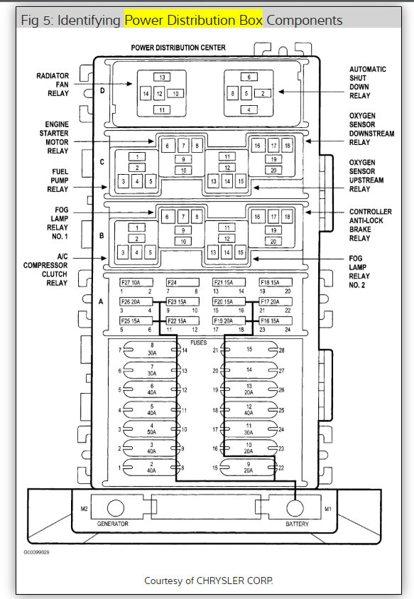

Where is the cooling fan relay located and how do I change it. My fan quit running and I know the fuse is good. I had this problem 3 years ago and the relay was replace then at the dealer. I would like to do it myself but cannot find it. Any help would be appreciated.
Saturday, April 13th, 2019 AT 2:09 PM (Merged)
MPH49R
The fan relay in the 2001 cherokee is in the relay box which is located in the engine compartment on the pass side of the motor in a long black plastic box. On mine it is right next to my coolant overflow bottle. The relays for many parts are located there and the relays are labeled on the top of the box which comes off the bottom part. Many of the relays are interchangeable so you can remove the fan relay and try another 5 prong relay to see if that is your problem.

Where is Fan Relay located? Do we replace Fan Assembly to correct idle overheating?
Tuesday, April 16th, 2019 AT 12:54 PM (Merged)
  • 75,992 POSTS
Here is a guide to help you test the relay and the relay location below.
