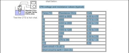

I checked all those things seem to me working properly no leaks new thermostat new water pump almost new radiator so I change the temperature sensor from the dealership but still the problem. How calibrate the coolant temperature sensor?

I used an ohmmeter and gave me almost 8000hms when is cool. Stars warming up (temperature incleases) the resistances stars to decreases and when gets normal temperature (195 F) the reading is about 600 F. What that meas?

For engine coolant temperature sensor testing, first disconnect the sensor wire and attach the red lead of the DVOM (Digital Volt-Ohm Meter) to the sensor terminal. Now attach the black lead of the DVOM to the ground. Set the meter to the 20K scale and observe and record the reading. Run your engine for two minutes and observe and record the reading again. The minimum difference must be more than 200 ohms.

The first reading was 199 Ohms after the 2 minutes running was 205 Ohms

Test the coolant temperature sensor again and compare to typical values below if its out of specs replace it.
https://images.2carpros.com/forum/automotive_pictures/12900_cts_39.jpg
